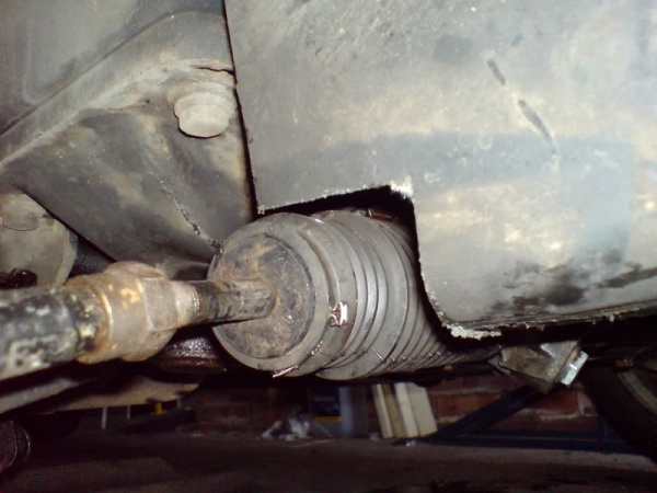

If you've chased down a leak to the flexible rubber gaiters on the steering rack itself then it is very likely the seals in the rack have failed and you'll need to be fitting a replacement steering rack.

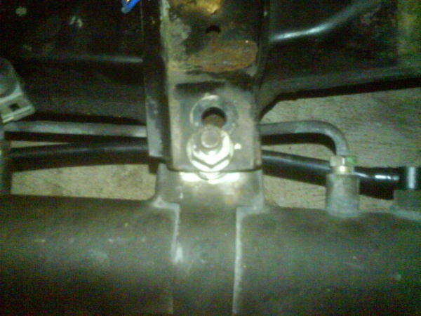

Now all that is left is removing the rack from its mounting on the crossmember. The rack is held to the crossmember by two 15mm nuts and bolts; simply undo and remove these. Then to remove the rack the bottom tabs need to be bent out of the way which then allows the room to simply drop the steering rack off the car.

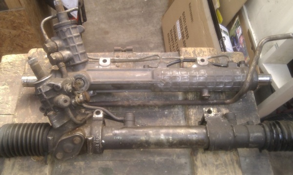

The Z3, E36 & E46 racks all bolt straight into position on the subframe like the standard rack so it's just a case of following the process above. However they do need 8mm of spacers as they are thinner than a E30 rack. You can keep their original track rods as well if you desire but certainly with the Z3 and E36 versions they can cause clearance issues if you are running larger than standard brakes. For the spacers you can have custom ones made up, but many have simply used thick washers; three head bolt washers are perfect.
Be aware that the rest of the install isn't quite so simple due to the different angles of the pinion gear and positioning on the pinion of the PAS feed and return pipes. You can bend your existing pipes with some trial and error, and hope that you don't kink or split them, but we recommend buying custom pipes. Either message E30Zone user DanThe for these as well as his custom steering linkages, or have a local hose specialist make you some.
The other issue can be fouling of the steering linkage on the exhaust downpipes/manifold on 6 cylinder engines such as the M20, again due to the angle of the pinion gear. This is dependent on the engine and manifold you are using. You can either make a custom steering linkage like the one in this guide or one can be purchased from DanThe which involves the use of E34 steering UJs, one of which has to be stripped down and mated to an E30 UJ.
The difference between an E30 (front) & E36 rack.
