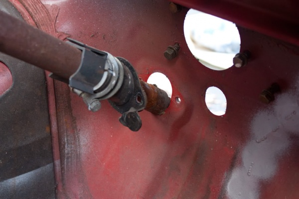

Start by undoing the two bolts in the firewall and also the one on the clamp which can be seen below:

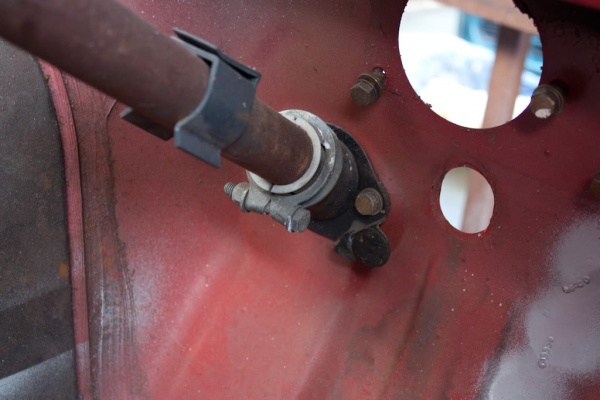

Give it a few taps with a hammer and slide it up the column

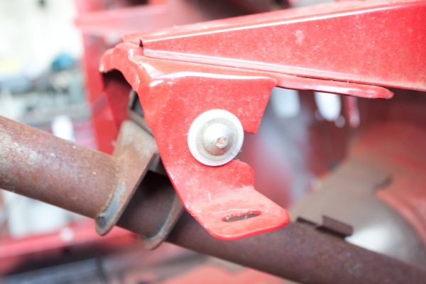

Here you can see the shear bolt and the slot it is in

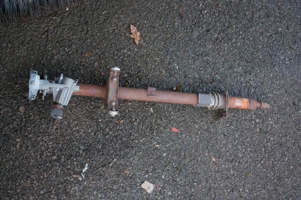

A few taps with the hammer and your left with this
