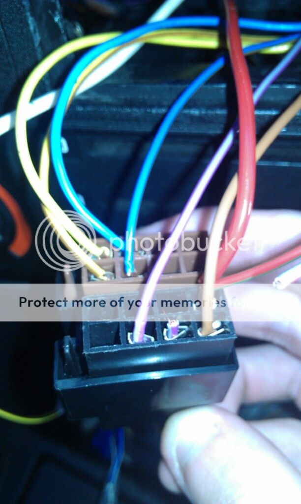

What would you recommend doing mate? i want my new HU in on tuesday so trying to order everything i need now!
Posts: 14100
Post Sun Oct 13, 2013 12:07 am
You could use a multimeter, or test lamp to verify the power connections in that terminal block, and add in-line fuses as required, then add the adaptor loom to it.
Testing the speakers is a case of briefly connecting a small 1.5V watch battery across the pair of wires (e.g., the pair of blue ones then the pair of yellow ones) and listening for the click as the speaker sounds - that will also identify which speaker is which.

get a standard iso female and solder it in, just gotta play chase the wires

Speedtouch wrote:You could use a multimeter, or test lamp to verify the power connections in that terminal block, and add in-line fuses as required, then add the adaptor loom to it.
what adapter loom?

DaveyB wrote:get a standard iso female and solder it in, just gotta play chase the wires
one of these mate?
http://www.ebay.co.uk/itm/16-Pin-Female ... 3ccb41c0c9
