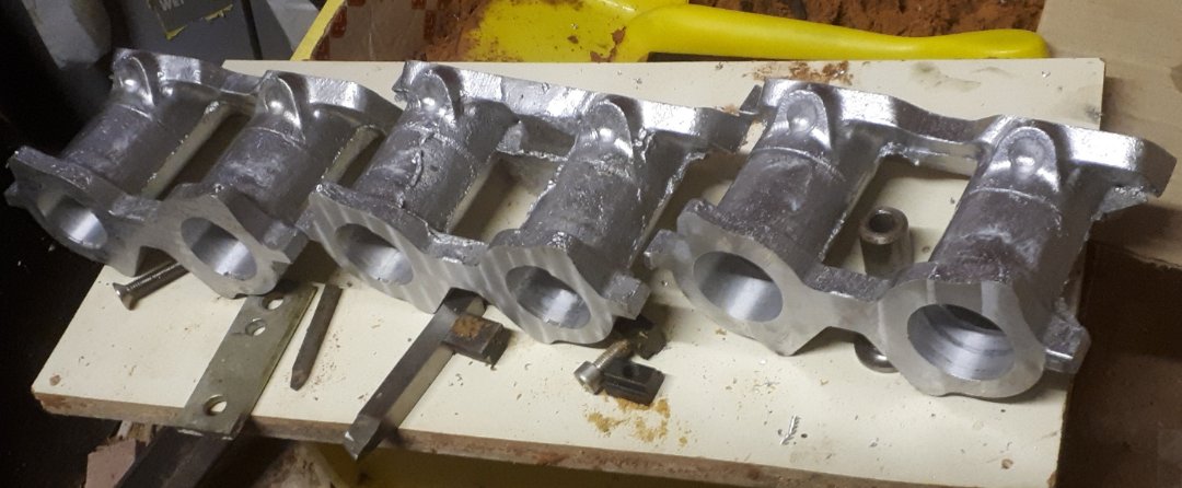

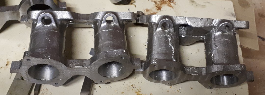

Made a couple of castings last weekend. Left is the central manifold with the crank case breather. This went wrong somewhere, you can see daylight out of the wrong side:-( On the right is what appears to be a usable casting:-)

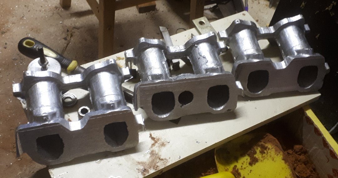

Needs a bit more of a skim,want to get them all to the same state then do one more pass so they're all the same length.

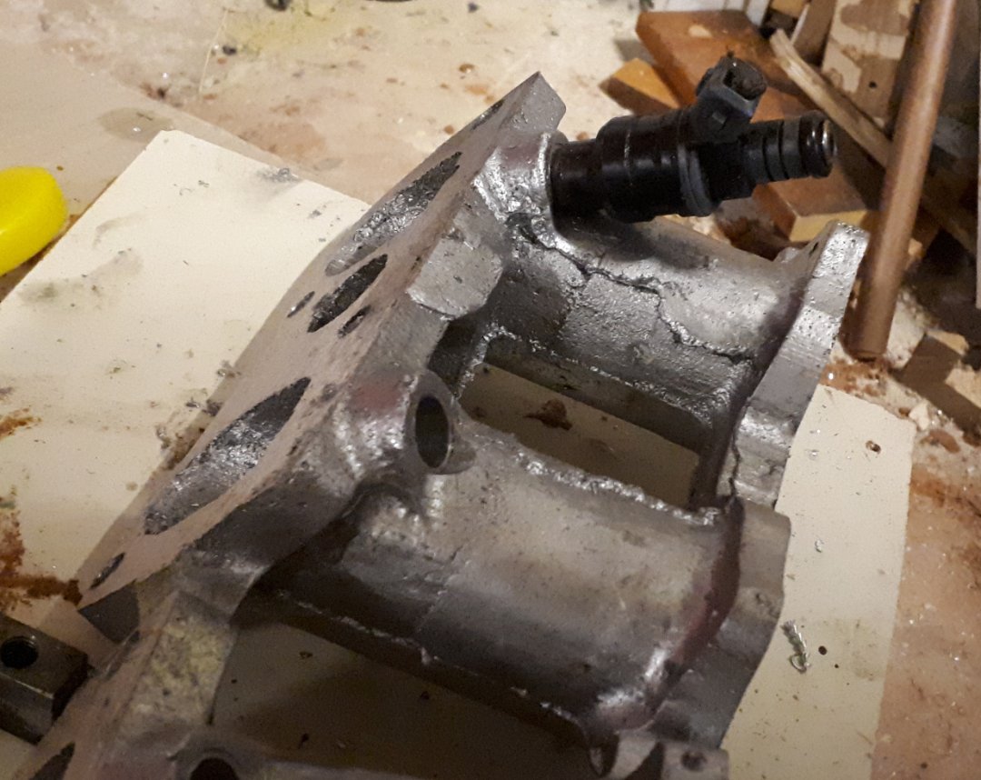

Injector holes nearly done, even found a 14mm cutter, which is convenient! :-)

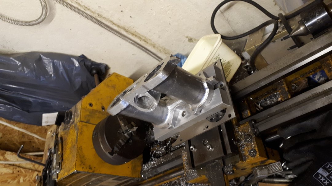

Taken about three hours to get the fixture that far! Just need clamps and I can do the spindle bores!
