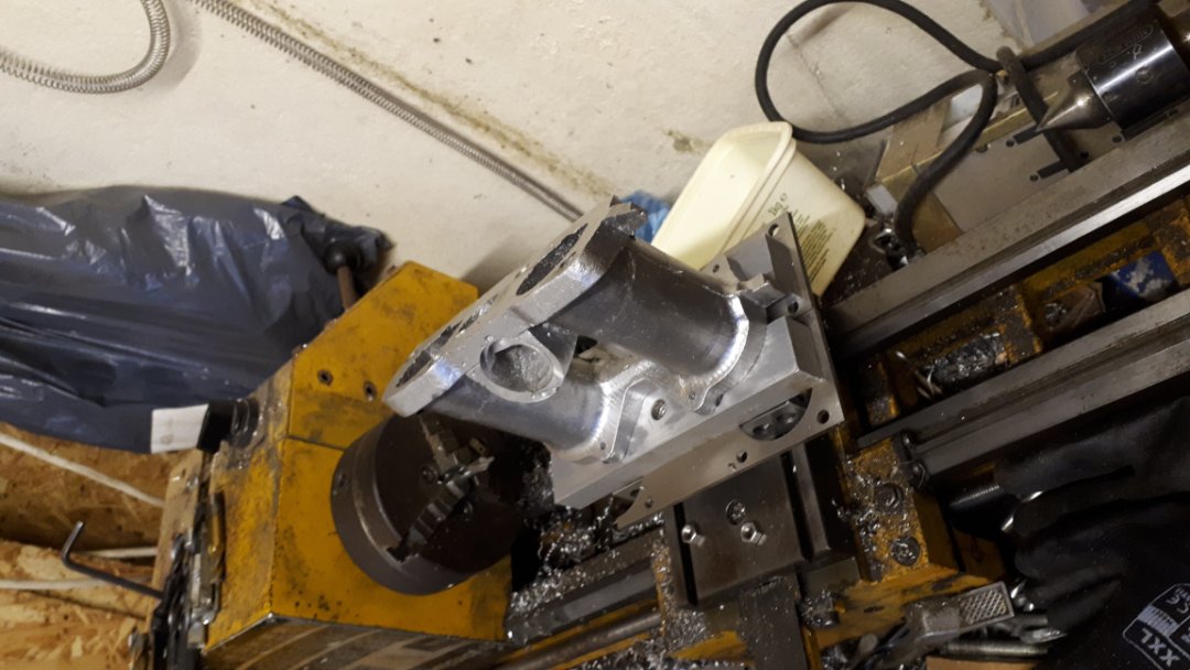

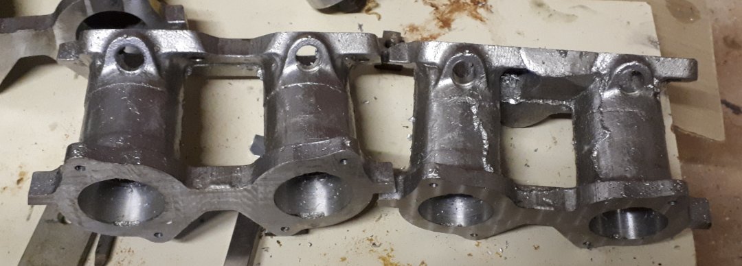

Sun Nov 24, 2019 9:42 pm
Made a couple of castings last weekend. Left is the central manifold with the crank case breather. This went wrong somewhere, you can see daylight out of the wrong side:-( On the right is what appears to be a usable casting:-)

Sat Jan 04, 2020 5:34 pm
Machine went horribly wrong so no video unfortunately:-(

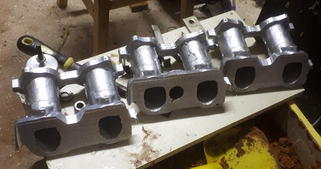

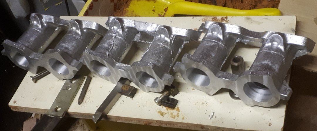

Sun Jan 19, 2020 9:38 pm
Needs a bit more of a skim,want to get them all to the same state then do one more pass so they're all the same length.

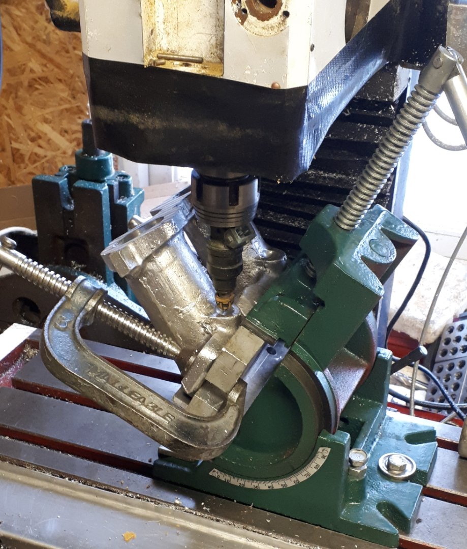

Sat Jan 25, 2020 4:19 pm
Next up, injector holes and spindle bores!

Sun Jan 26, 2020 8:45 am
Got a few pieces of the CNC puzzle:
CAD is ProE Creo 6 (actual legit and fully licensed version! )
Toolpaths generated using AutoDesk Fusion 360 (hobby licence)
Motion controller is a DDCSV3.1 which is a Chinese standalone CNC controller and has some weaknesses.
Machine is some unbranded mill which I converted to CNC by fitting ball screws and closed loop stepper motors.

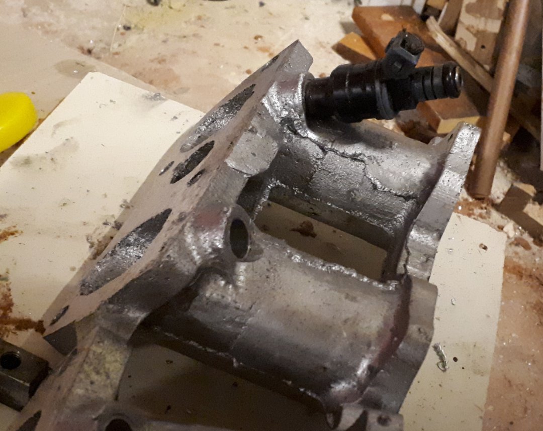

Sat Feb 01, 2020 6:39 pm
Injector holes nearly done, even found a 14mm cutter, which is convenient!

Sat Feb 01, 2020 7:09 pm
Drilled the holes for the trumpets, once the last injector holes are done there's just the spindle bores and oil breather left
