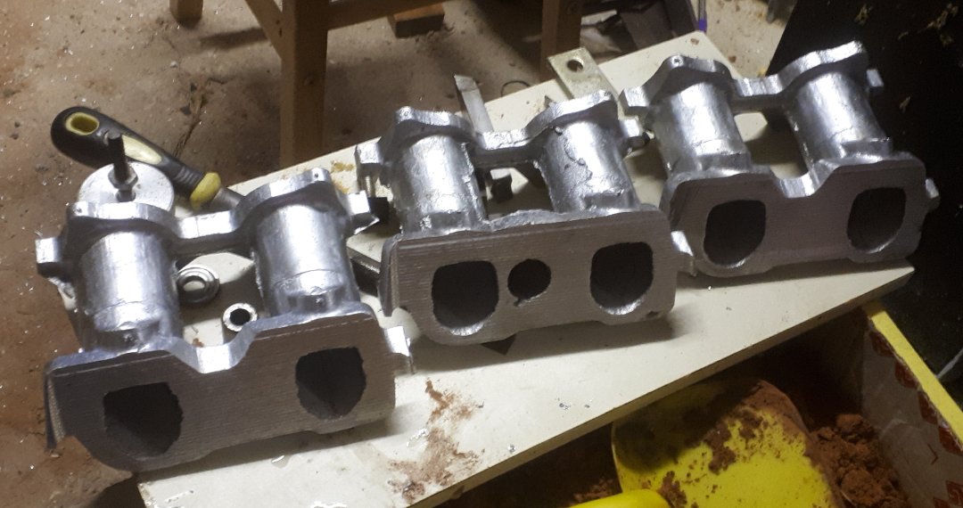

Sun Nov 24, 2019 9:42 pm
Made a couple of castings last weekend. Left is the central manifold with the crank case breather. This went wrong somewhere, you can see daylight out of the wrong side:-( On the right is what appears to be a usable casting:-)

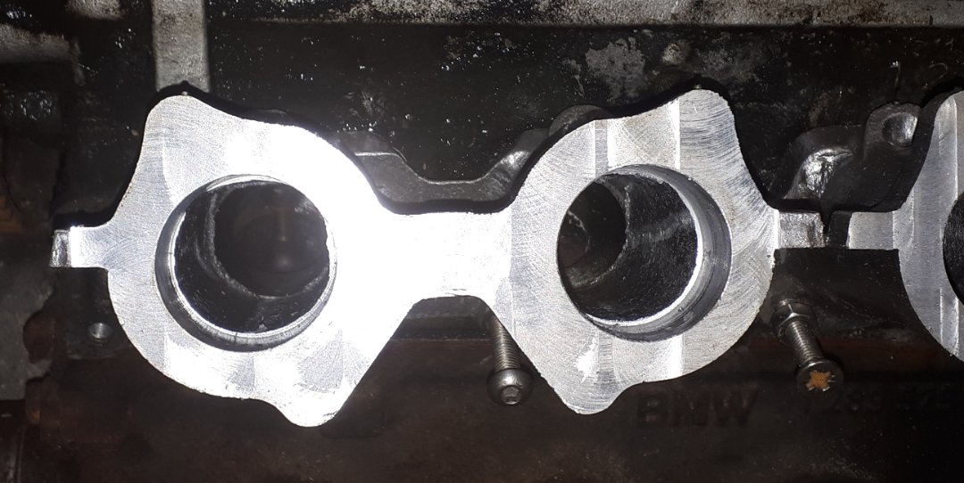

Sat Jan 04, 2020 5:34 pm
Machine went horribly wrong so no video unfortunately:-(

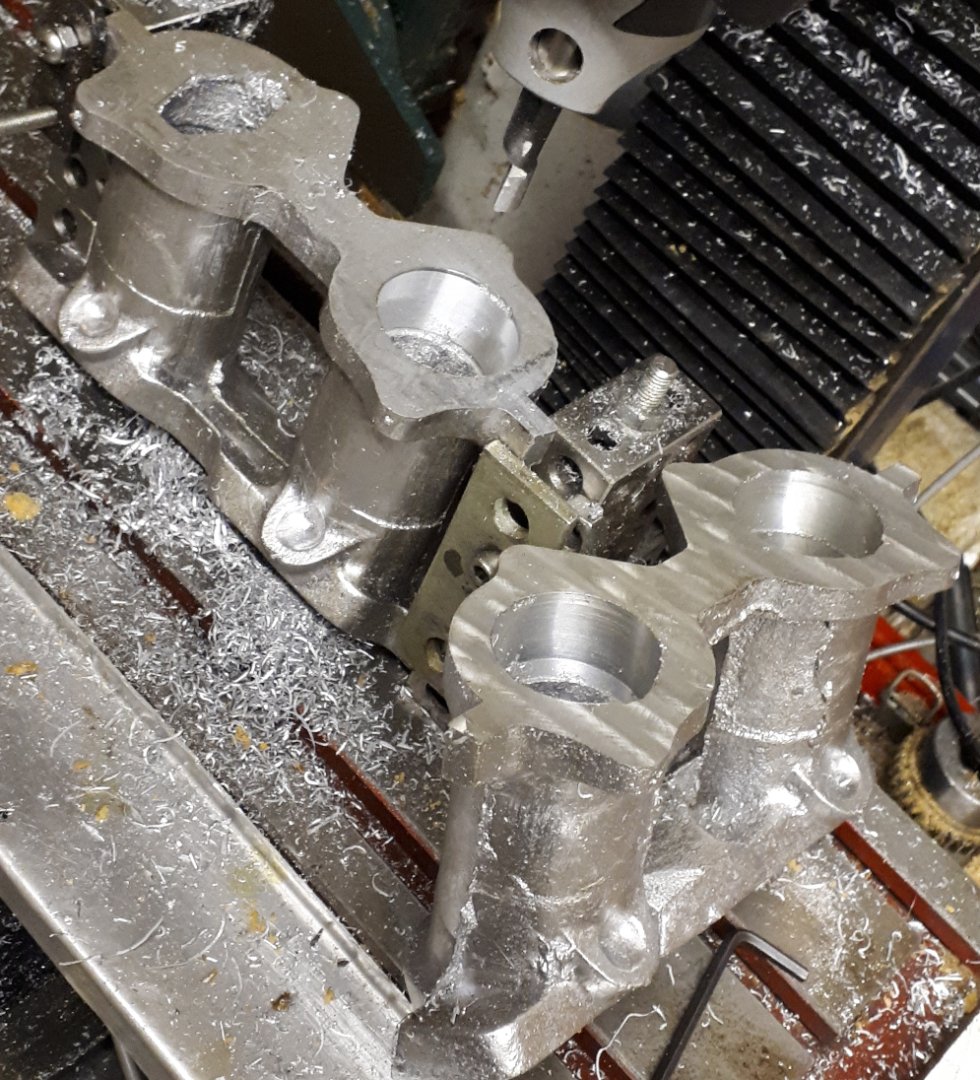

Sun Jan 19, 2020 9:36 pm
325i Twin Turbo (until 10am 01/12/07 :( )
www.air-in.co.uk free M20 exhaust and inlet flange
Turbo-Brown
Boost Junkie
Posts: 4705
Joined: Tue Feb 15, 2005 11:00 pm
Location: Aldershot, Hants
Sun Jan 19, 2020 9:38 pm
Needs a bit more of a skim,want to get them all to the same state then do one more pass so they're all the same length.

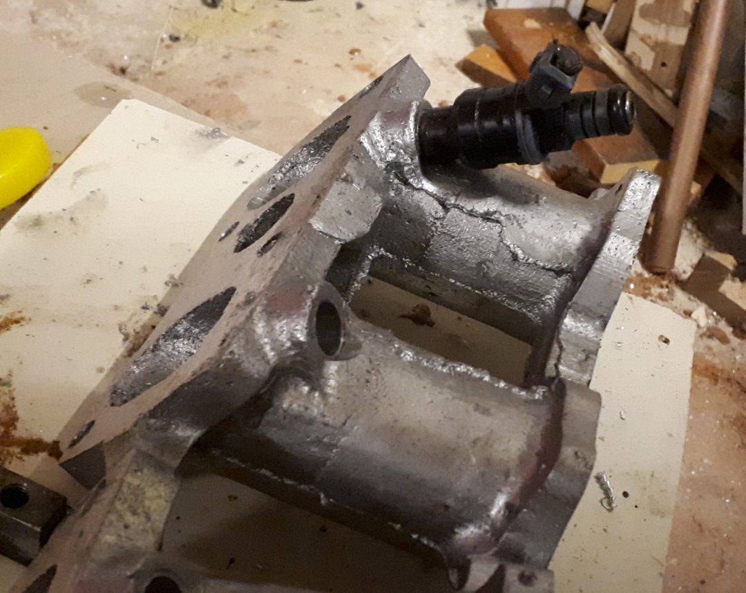

Sat Feb 01, 2020 6:39 pm
Injector holes nearly done, even found a 14mm cutter, which is convenient! :-)
