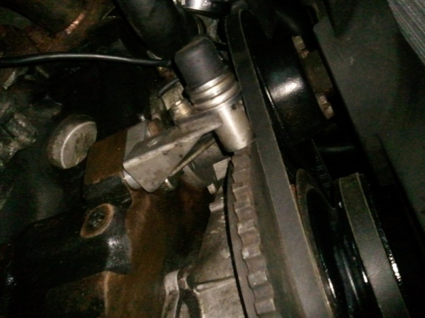

Crank Position Sensor
The Crank Position Sensor is a single unit that tells the ECU the engine is turning. Without this signal, none of the Fuel or Ignition circuits will run, so it's therefore essential to get this fitted and working.
The Motronic 1.3 CPS replaces the two sensors you currently have in the bell housing of your gearbox. You will not need to remove your existing sensors, but since you are removing the engine loom, they will be disconnected. In their place, you will be fitting a single sensor to the front of the engine with a mounting bracket, as well as a toothed wheel for the sensor to "read".
The most involved aspect is fitting this toothed crank wheel. This involves removing the radiator and the fan before you can access the existing pulley. Once you've got those off you need to remove the fan belt and water pump pulley then undo the bolts holding the existing crank pulley, pull it off and fit the toothed pulley in place of the old vibration damper, this has a locating pin so can only go on in one position, then slide on the original pulley and bolt back together.
While you've got all those cooling parts removed, you'll find it easier to mount the CPS bracket. The bracket is held in place with two M8 bolts, low down on the block on the exhaust side. With the bracket in place, the sender can be fixed to it, and the wiring routed around the front of the engine. The plug should be mounted under the ICV, where it will connect to the main engine loom.

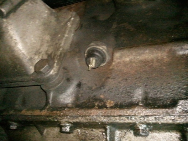

Oil Pressure Switch
This is located on the exhaust side of the engine block, this is vital as it's linked to the instrument cluster and if it comes on you want to be turning the engine off ASAP! Jetronic and M1.0 use a spade connector whereas M1.1 and M1.3 use the same type of multipin plug other engine sensors use (although still only using one wire). The function of both types is identical. There are two simple options to get this working, either chop the plug off the new loom and use a spade connector or for the more professional job swap the switches over.
