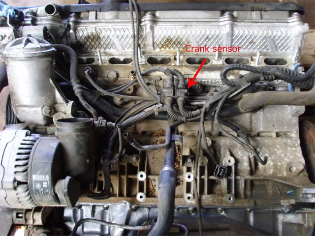

You can see the 4 holes where the mount was removed on this engine

The arms fit roughly in the middle of the engine, looking at the picture I posted above you can see the mount arm fixing holes either side of the coolant hose

I trying to fit the inlet side mount and one of the bolts won't go it.
The one i'm talking about is the bottom right hole in the picture below.
It's like it doesn't have a thread? Is this normal?
Stu

- Posts: 28649
- Location: Staffs
It does have a thread, but its full of rust. You need to run a tap down it
