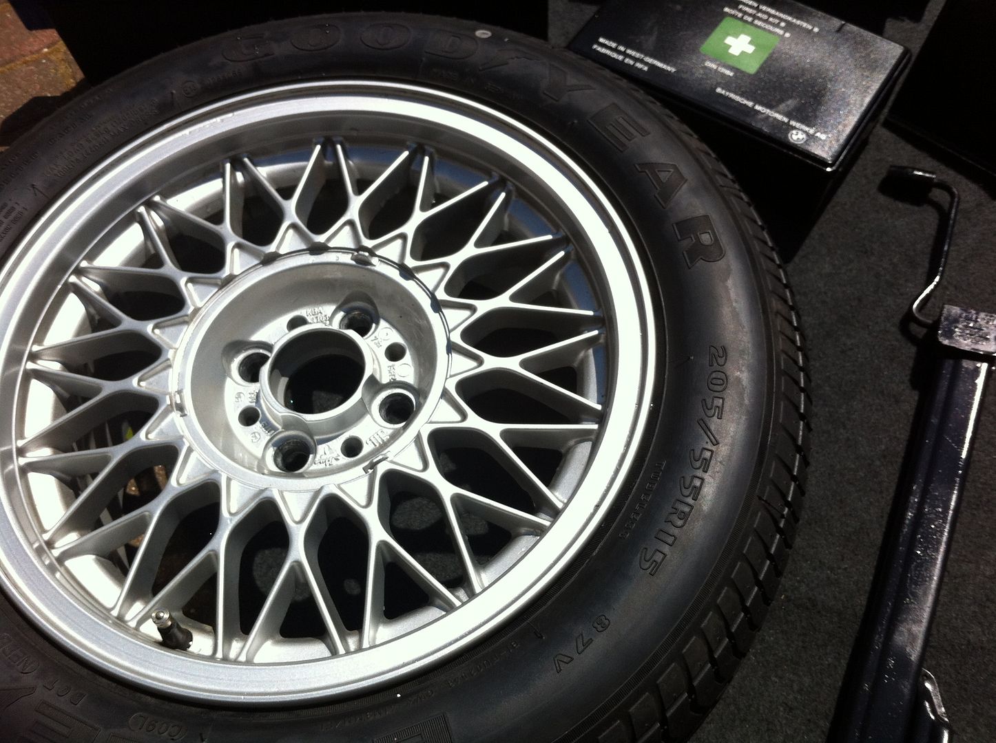

thought i would chop the rear pipe down today as it was sticking out a mile sprayed the battery box i had welded in and cleaned the rear end up.
Anyone know if this is original Tyre on the spare its brand new
Posts: 18168
Post Mon Jun 23, 2014 5:52 pm
Yes, that is an original spare. Them NCTs are period correct and were quite a tyre, twenty five years ago ! :)
