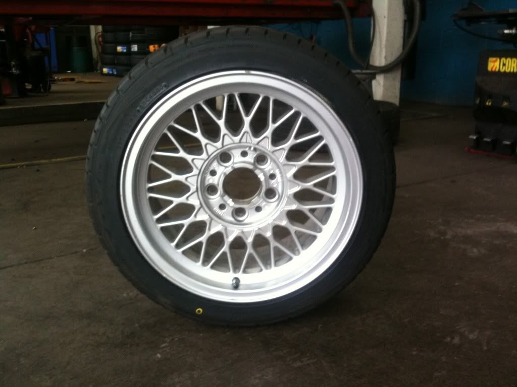

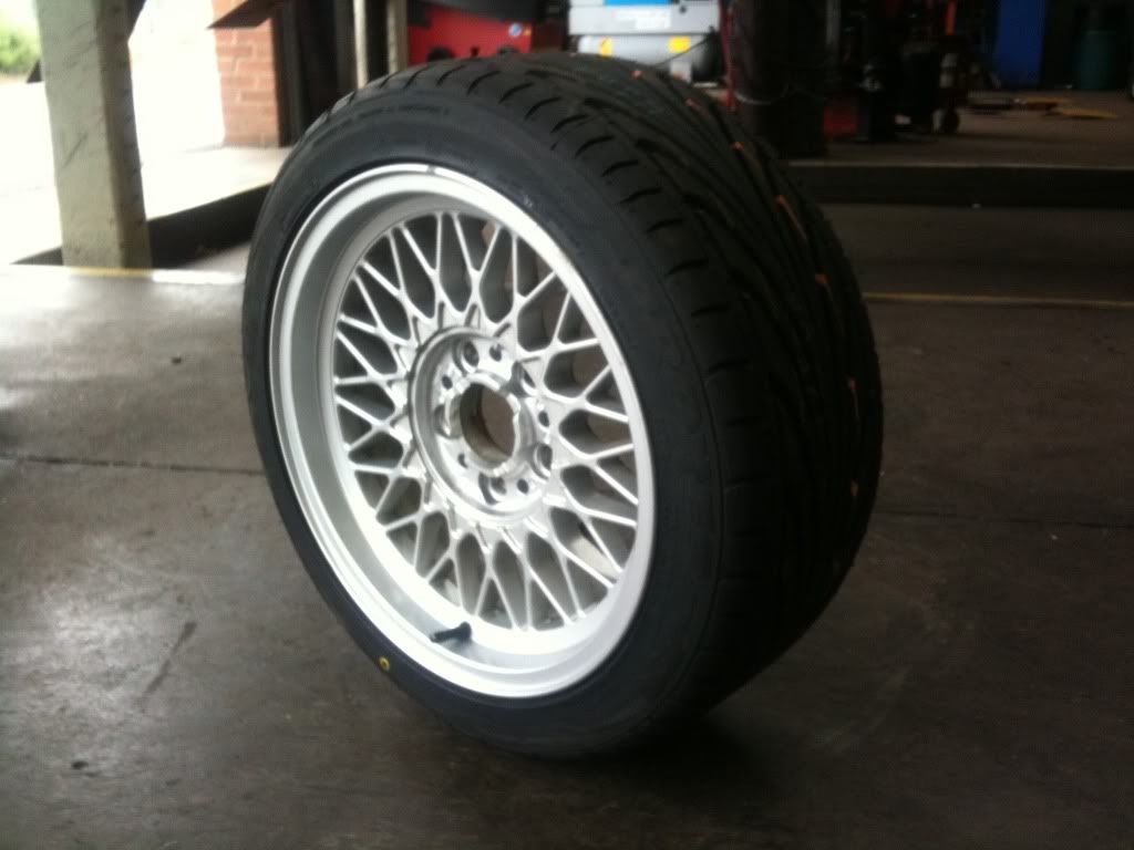

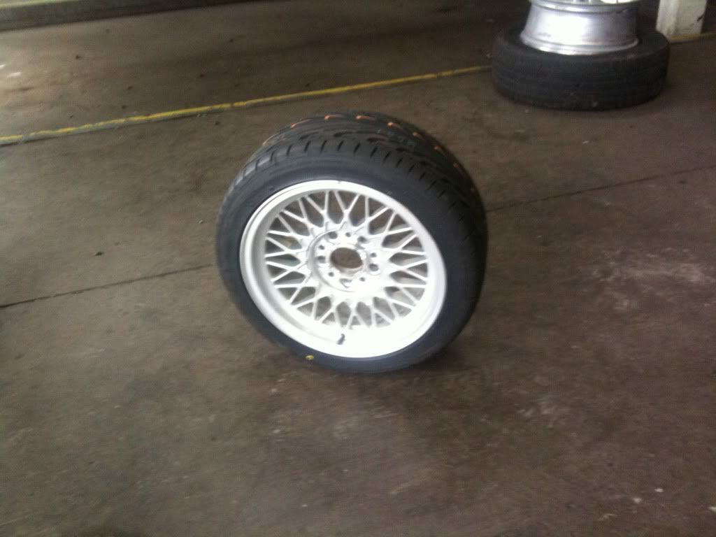

Pics tyred up for anyone thinking of Tyres.

Thats does look good. 225/40s?Dezzy wrote:

225,40x16 mate
They are about 6mm smaller that 205,55x15 so you should be ok unless it's the width that's an issue. As the 55's are a ballon I reckon they will be better on the car than standard size.
