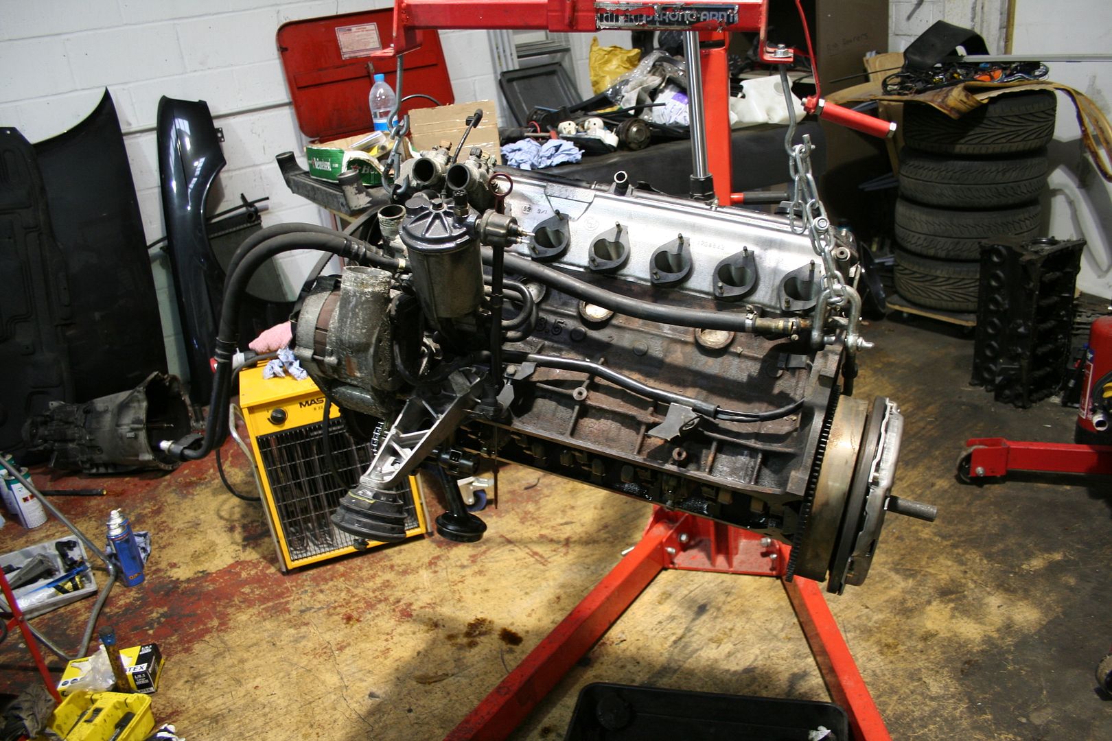

Some bits of note as I've had a couple of eves after work at it
Clutch can be bolted on, new disc doesn't say which side is gearbox which is handy. It does only fit one way round though!
The pressure plate disc is a dark colour? hinting at its power to suppress the mighty torque? Normally they are shiney
Trevor kindly repainted theses bits and the oil filter housing cap

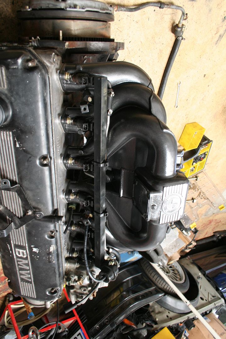

Inlet built back up and ready to bolt back on engine, injectors have been refurbed. Their flow rate was not far off normal but the spray pattern was beginning to suffer. New hoses for the various bits hanging off it.

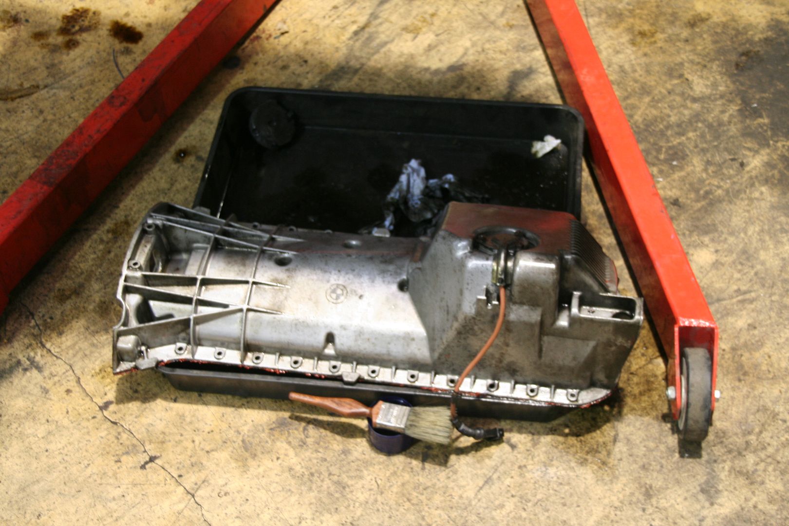

Doing the sump gasket is a must at this stage. Its all very clean looking. Didn't take much to clean the sump up in the parts washer

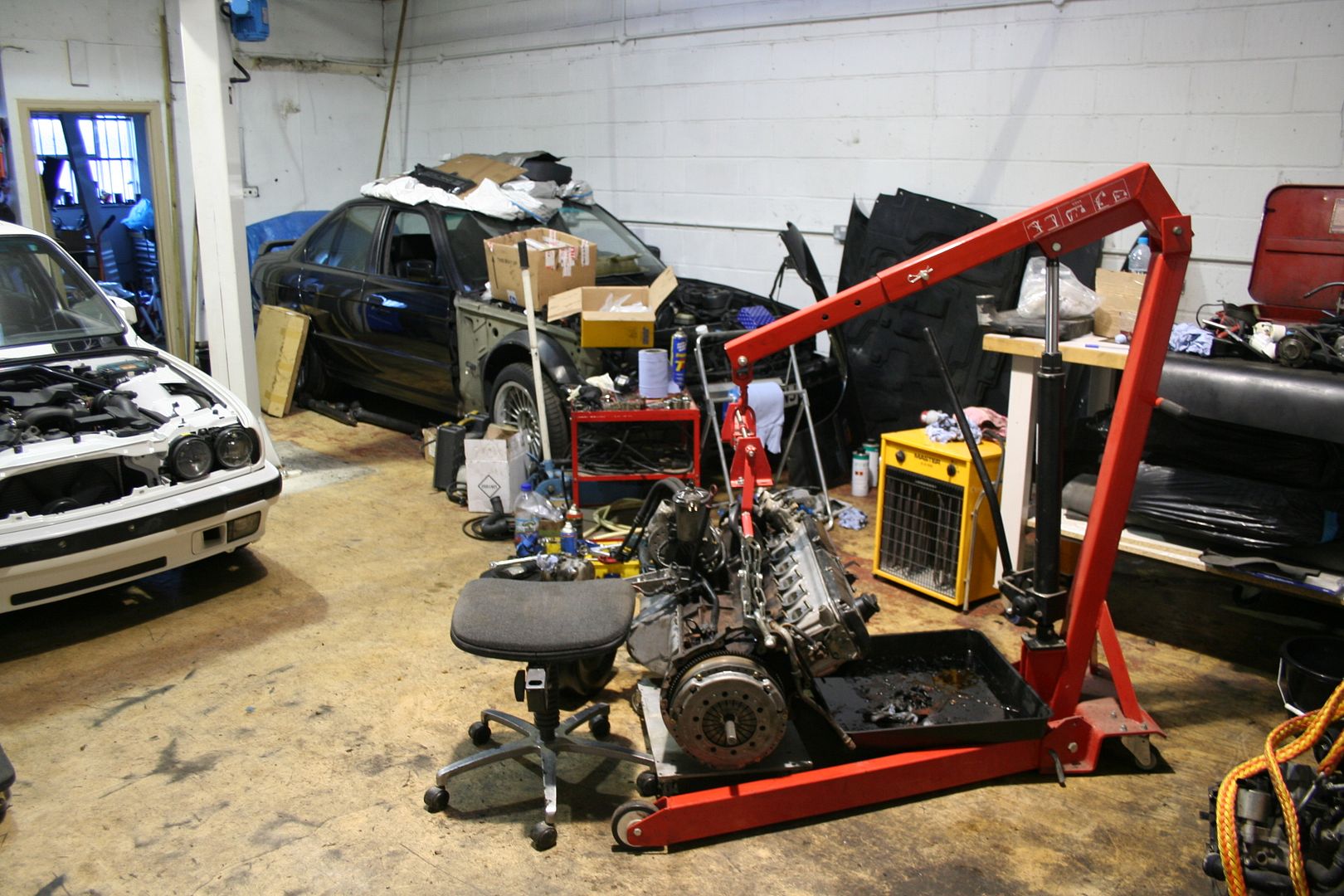

I've been giving the mill a bit of a clean up while its out.
Current mess, its orgainised really!

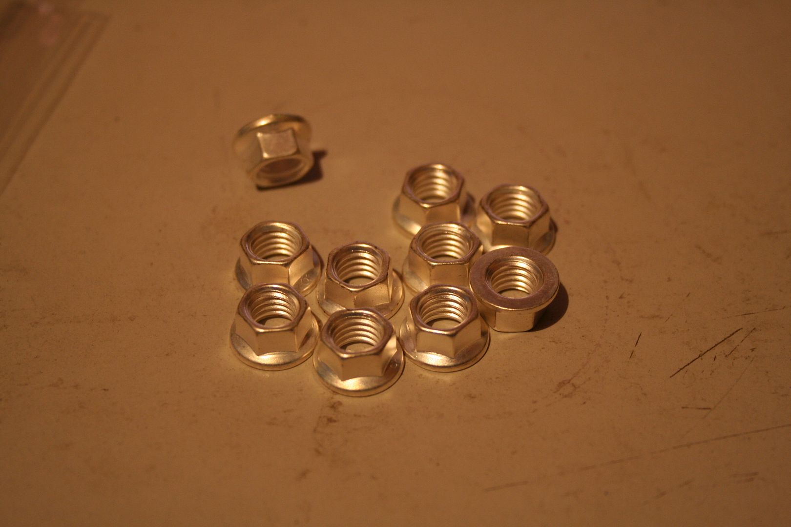

If I said these 10 new nuts where £46 delivered and that's the cheapest deal I could find!

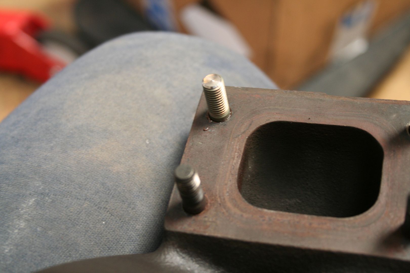

For the turbo area. To replace lost, missing, damaged ones.
I've bit the bullet and ordered some various studs from alpine for a lot of monies! So that's going to hold me up from getting turbos back on just yet.

Si, that rocker cover and inlet man look the business, RESPECT !!

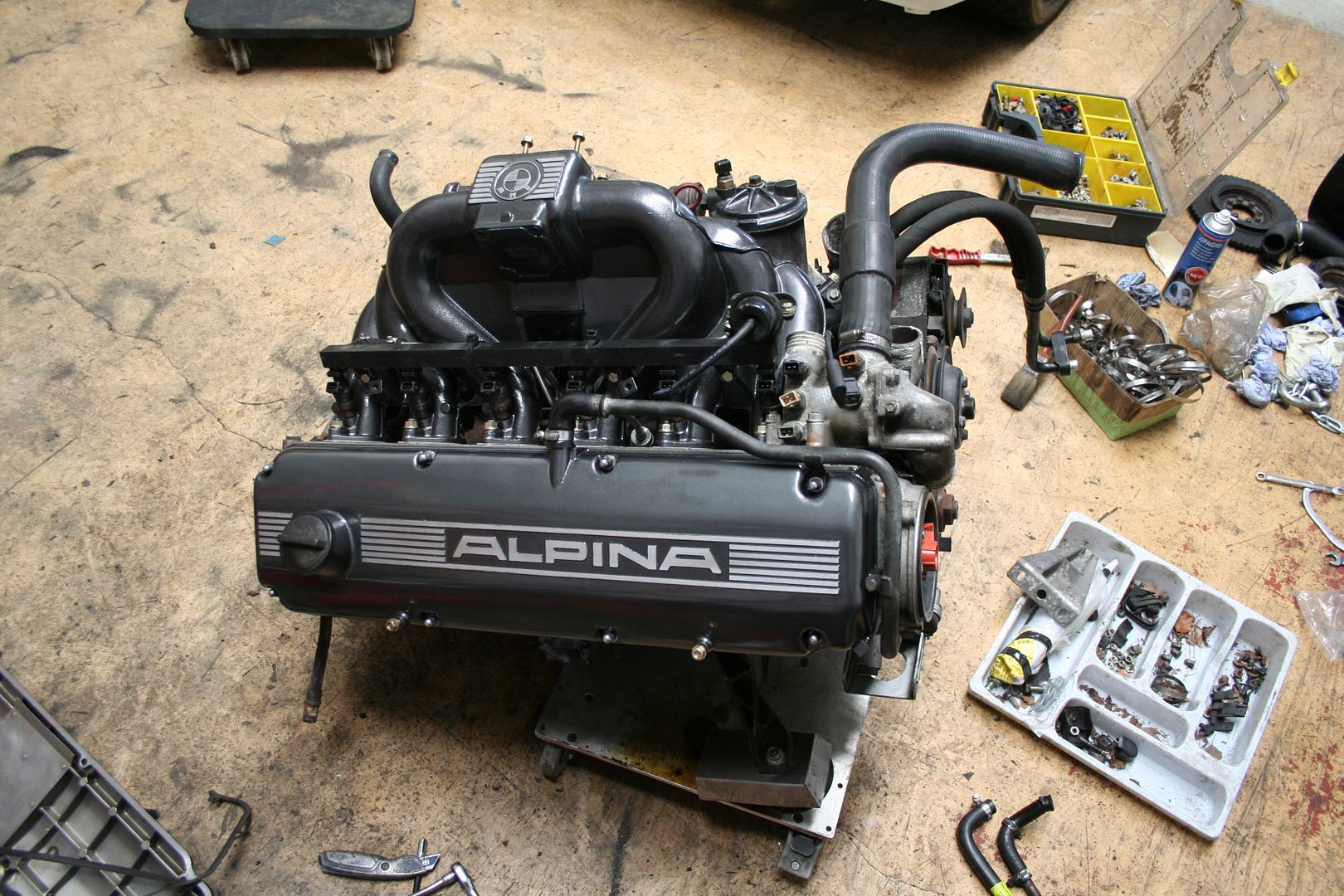

I got a free afternoon today which seems to be rare at the moment!

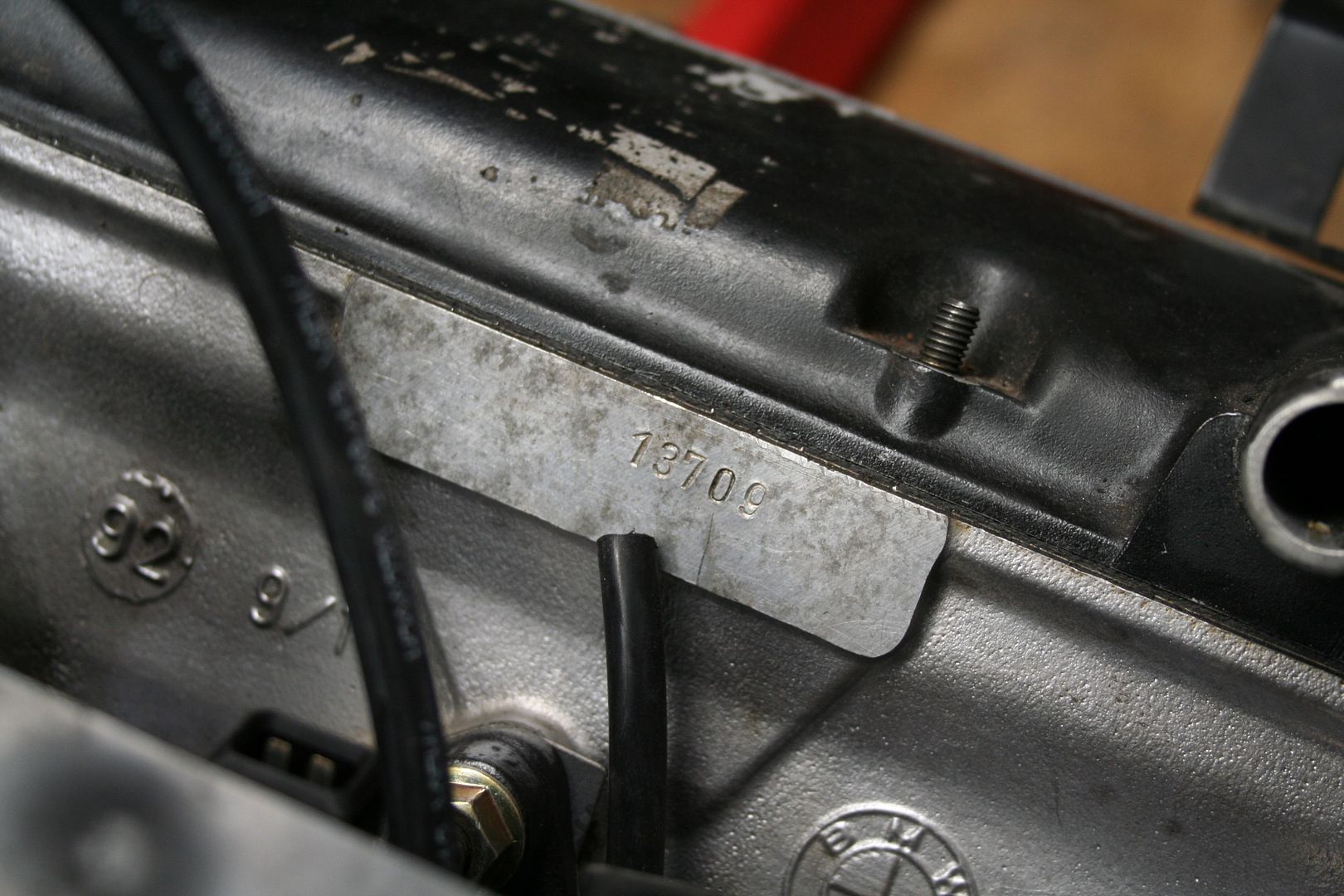

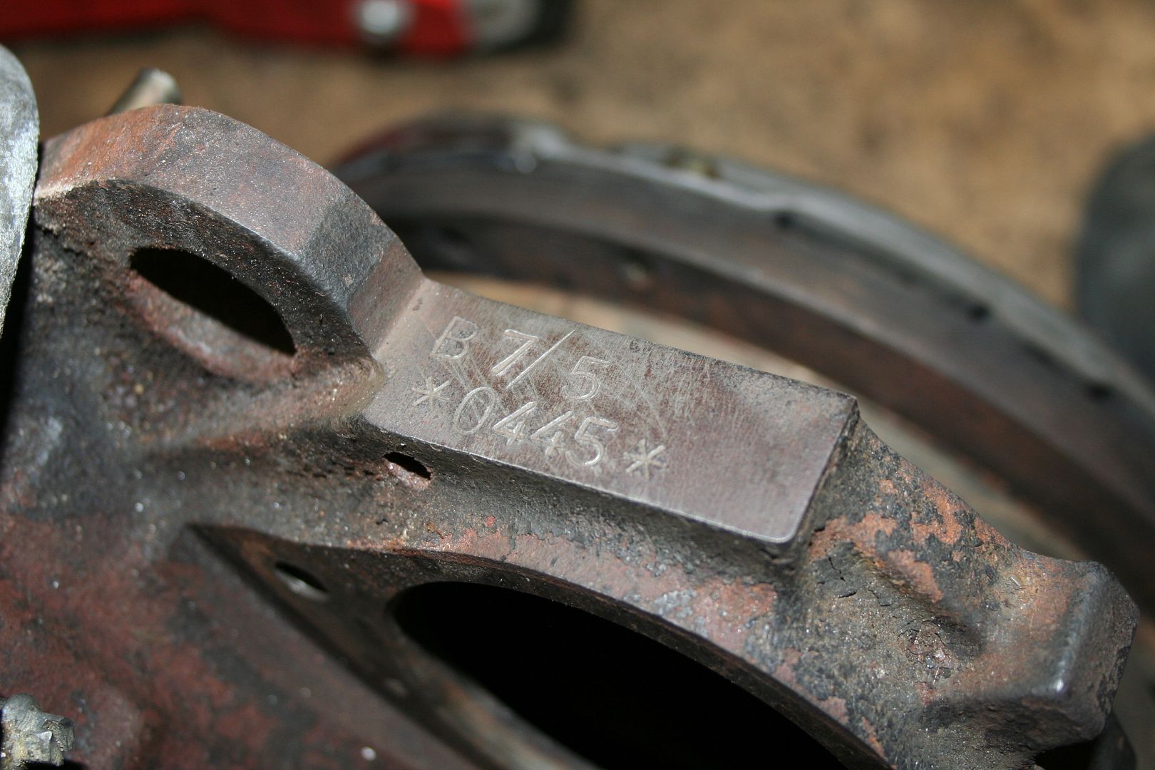

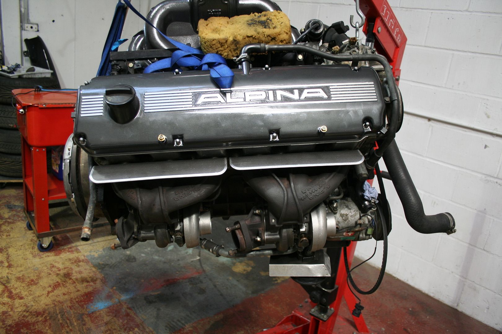

they're imaginative when it comes to the engine numbers! Car no. 445 will have engine number...... makes sense to be fair
Heads stamped up from alpina, shows its the original head looking at the casting date

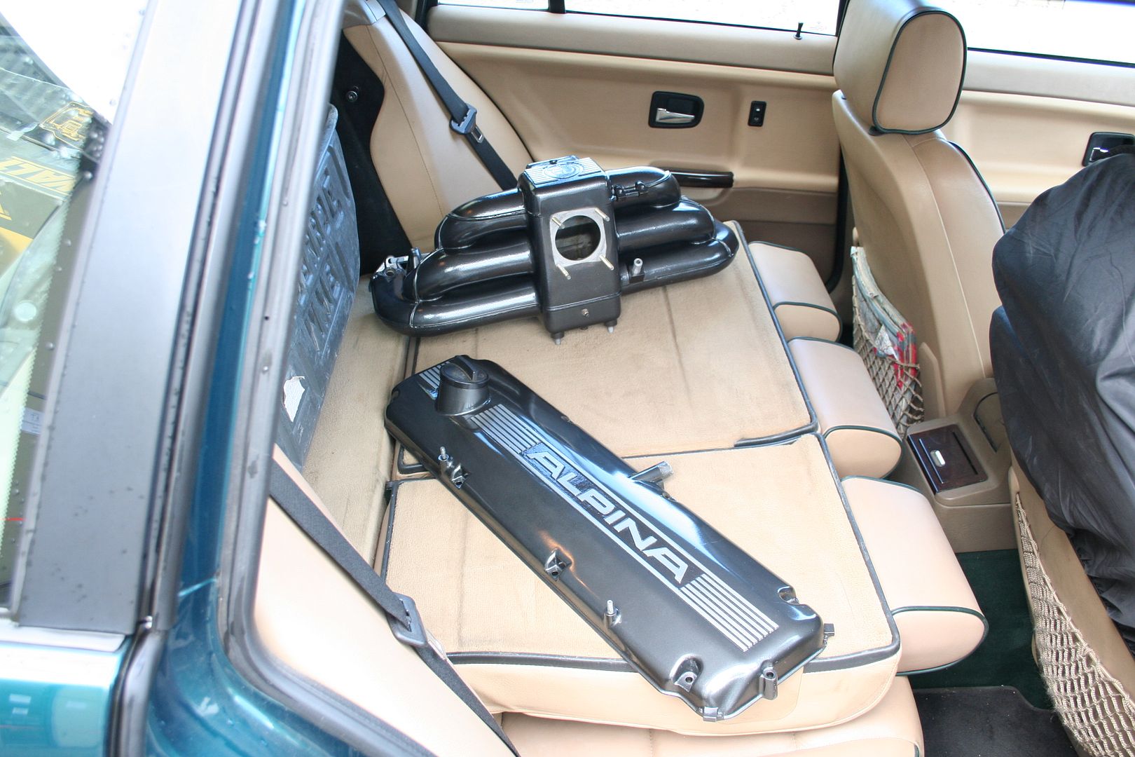

Shiney inlet back on, the lower nuts you need to be special to get to them, no room
Rocker on, I bought new domed nuts, but they aren't very shiney like the originals were. Any ideas where I can get better ones?

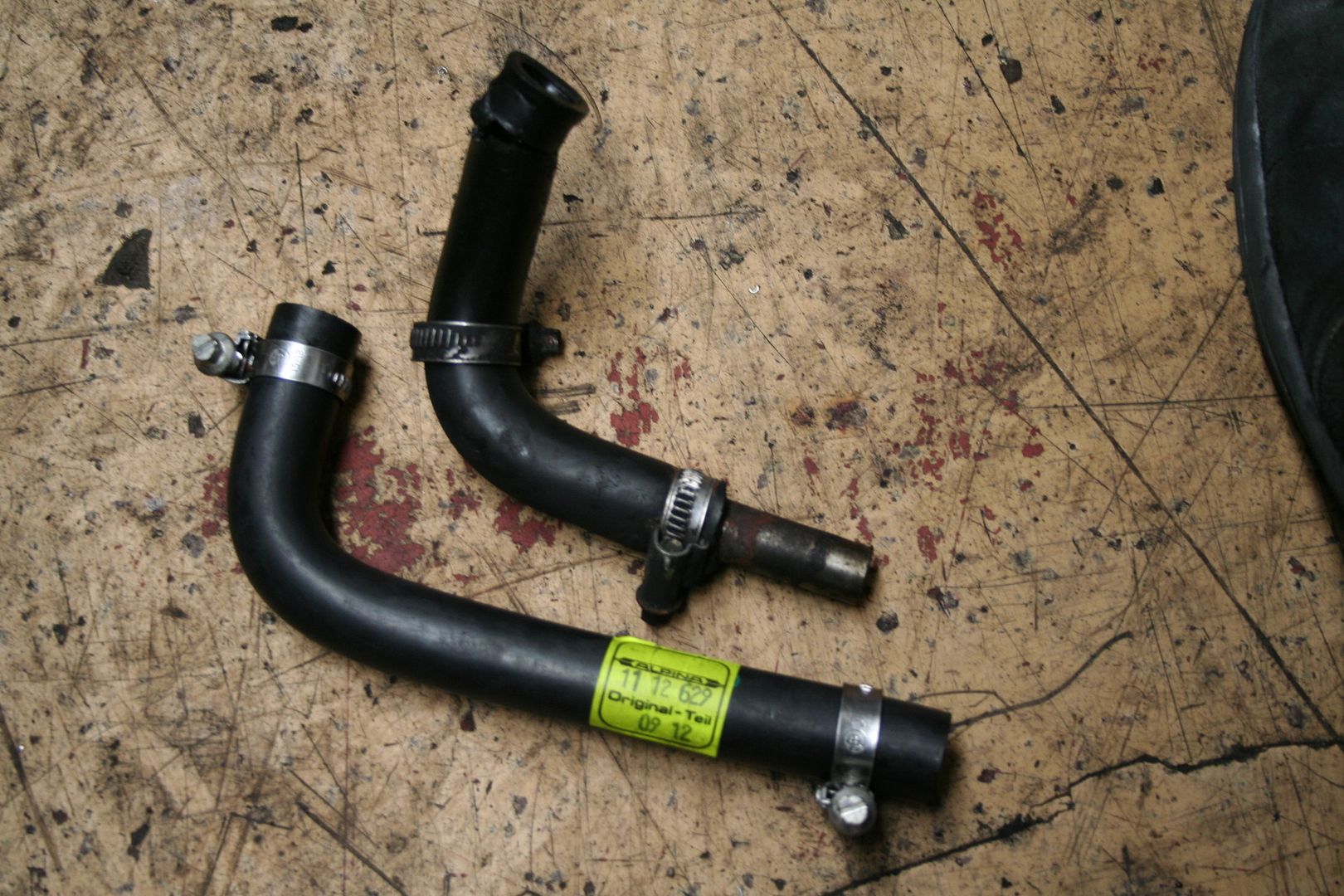

This is the breather pipe off the rocker, its all alpina stylee here, I ordered the pipe to replace this previous effort. It was £18 pound though

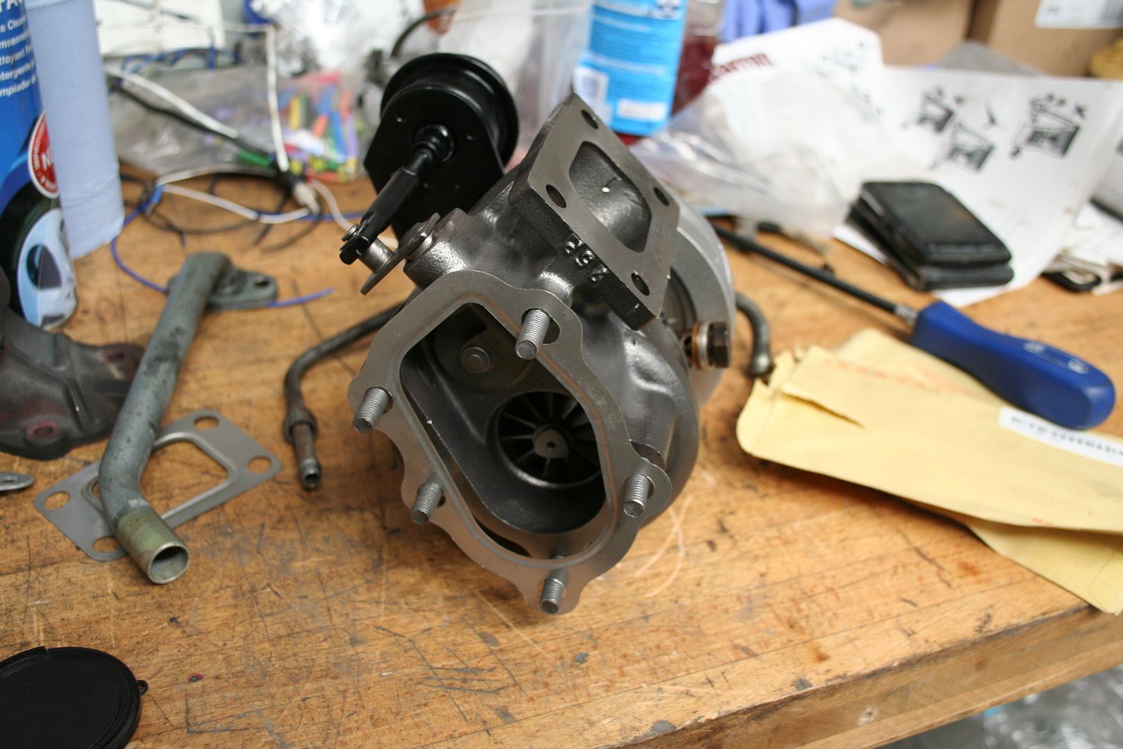

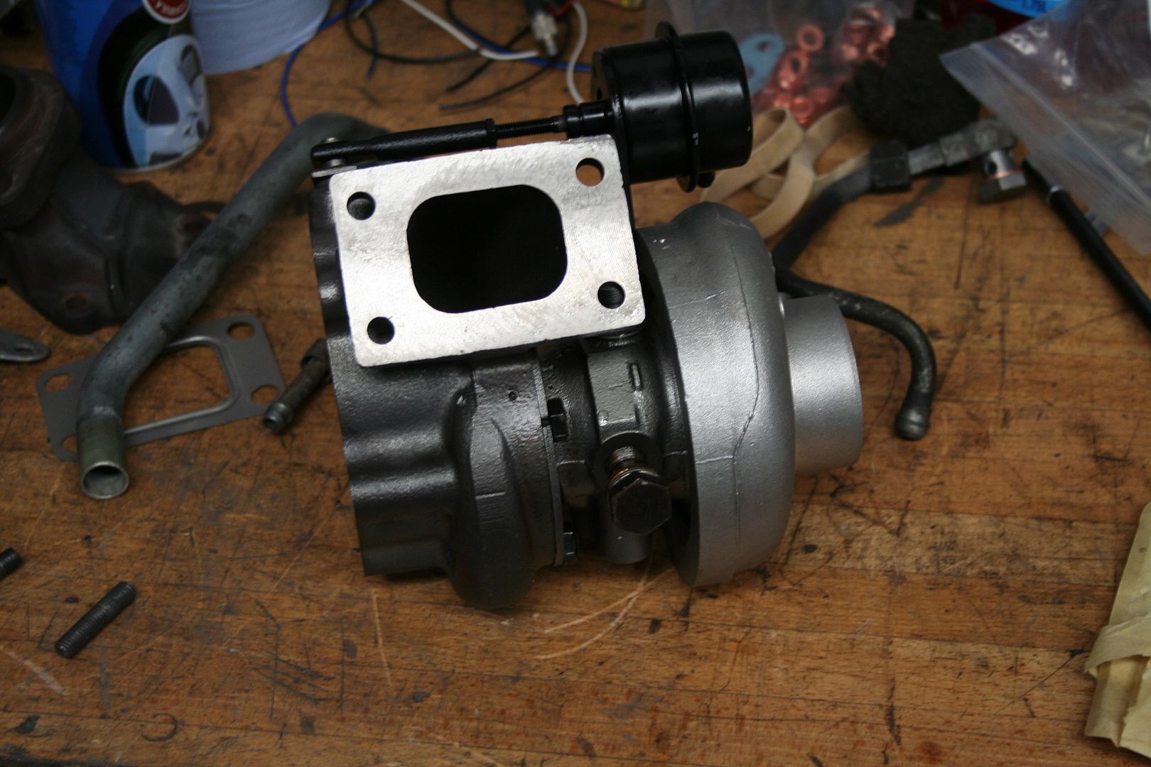

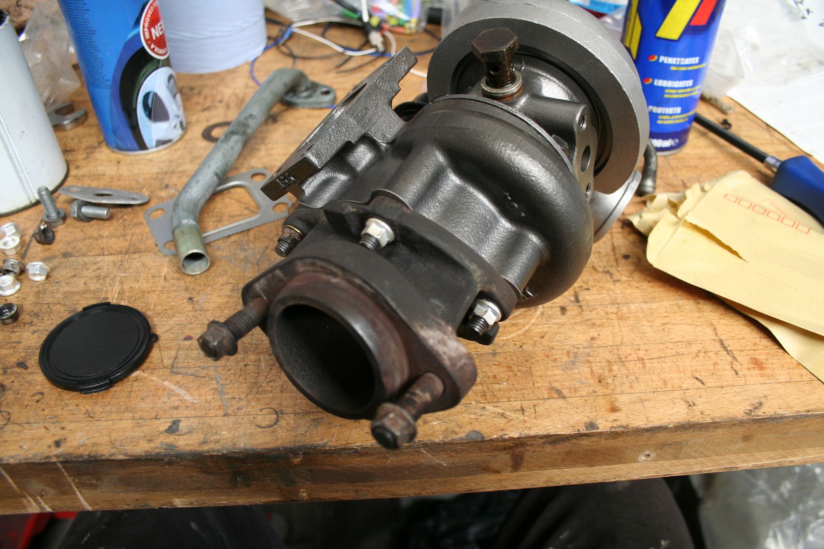

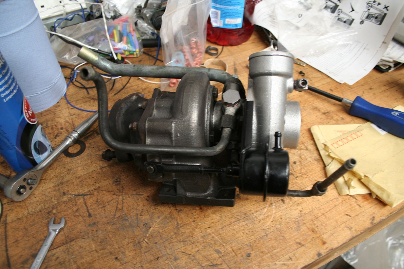

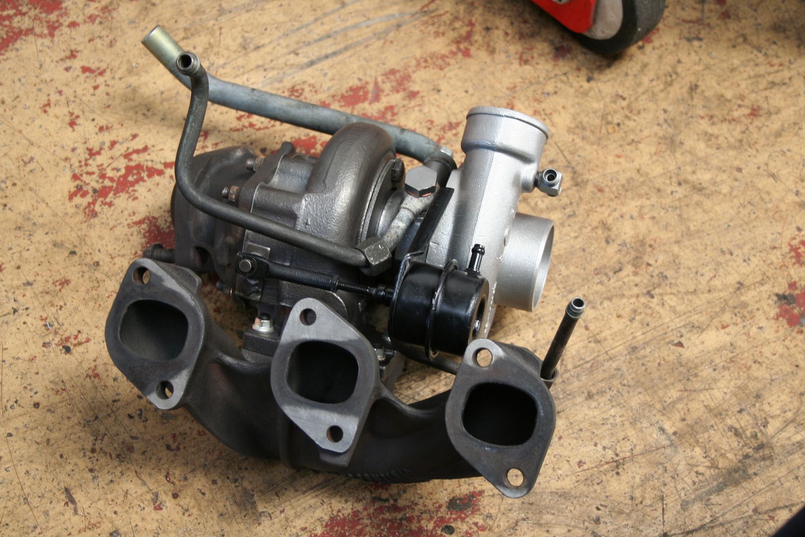

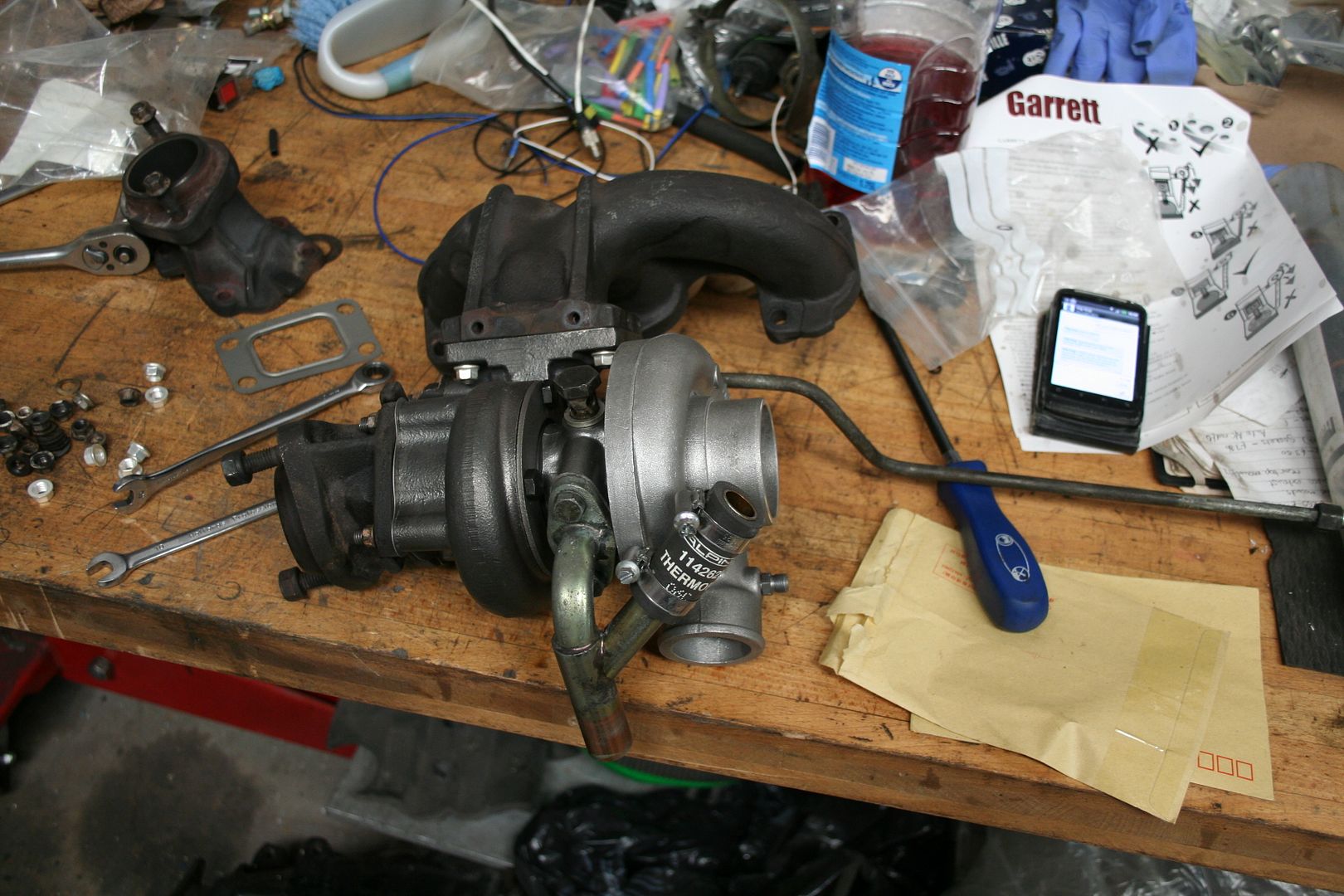

Heres the rear turbo all built up and ready to bolt on

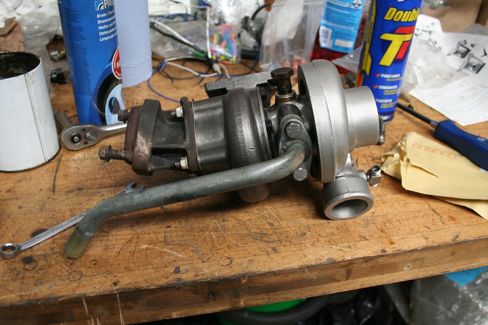

Front turbo bare
Heres the gasket that was missing from both turbos from when I stripped it down. Who ever was here last time didn't bother with them and it was blowing before, so they must be needed!
bolted on
oil return pipe (to block) on
All built up, oil feed and coolant pipes bolted on. I can't go any further as i'm waiting for studs from Alpina now to replace some bent/damaged ones.
Once they arrive I can bolt these two badboys back on

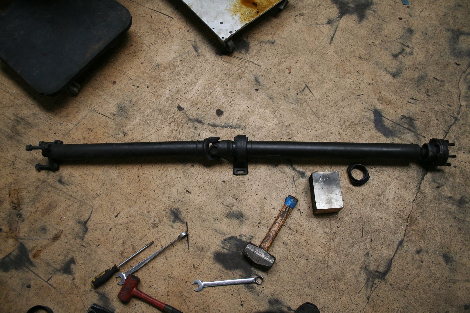

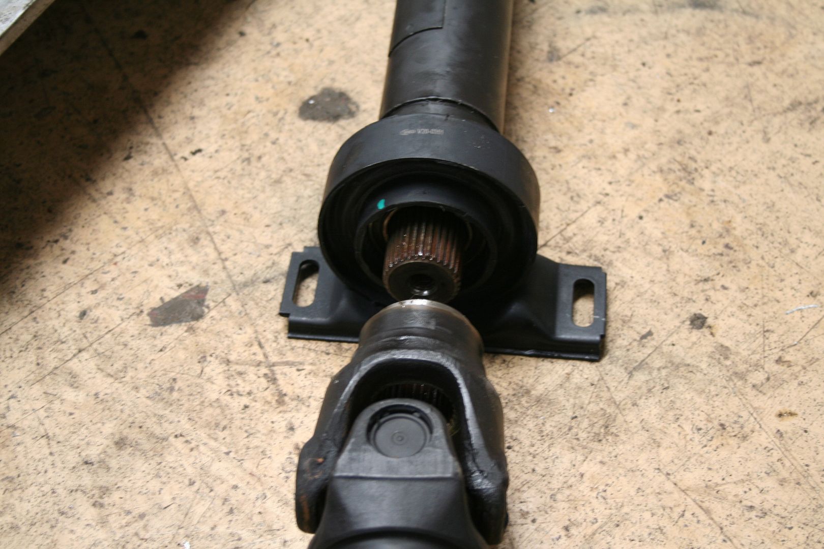

New centre bearing mount, the bearing itself is fine and also as said before a unique item, you can buy a bearing in this size but its got smaller bearings! Alpina only
Heres the prop now ready to go back on when the time is right. This is also unique to the bi-turbo also. Luckily the one knackered part was the bmw one! £11 cheapest fix on the car so far

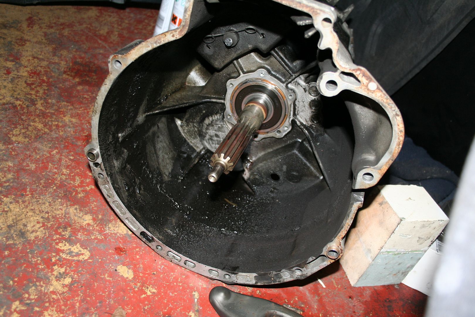

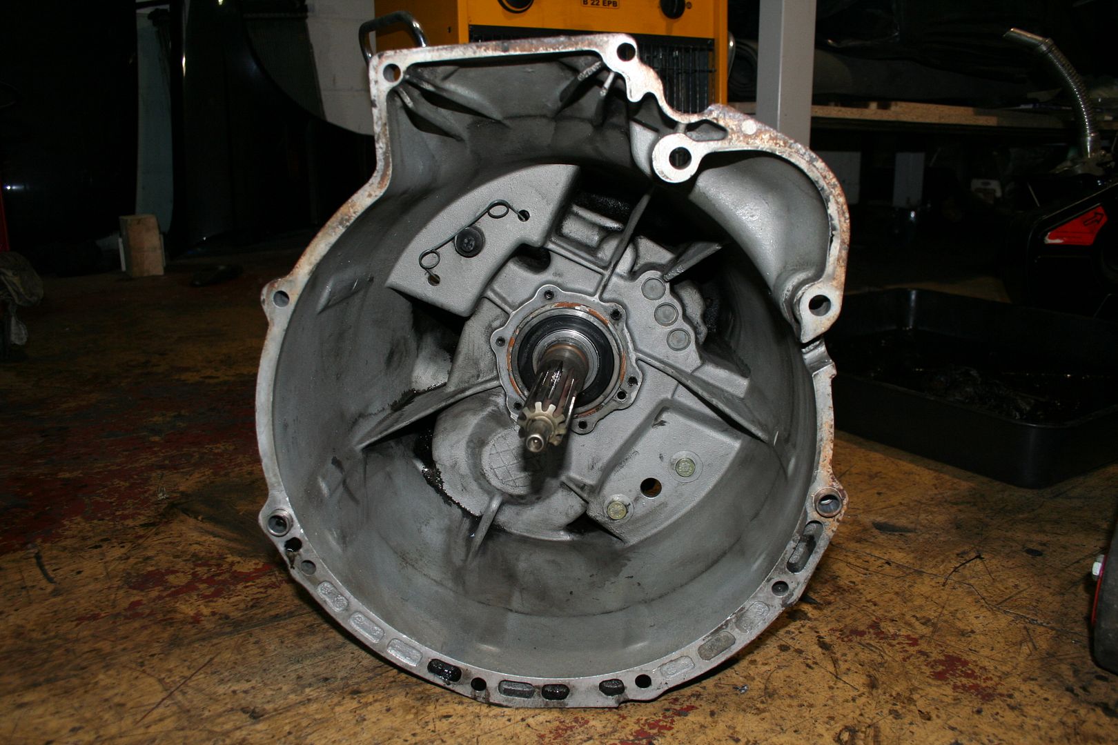

this is the gearbox input oil seal. Which on intial looking appeared alpina only, as they list their own part number for it. Its NLA. But the e34 M5 one isn't, after checking the sizes they're the same. So same as the getrag 280 gearbox, phew
Been leaking some time I would guess
A good clean out,
Once I have the seal I can bolt the box back onto the engine ready for the re install
A good clean out,

3 studs, £97 please
2 smaller studs were for the front manifold
Front turbo built up ready to go
Rear turbo back on.....

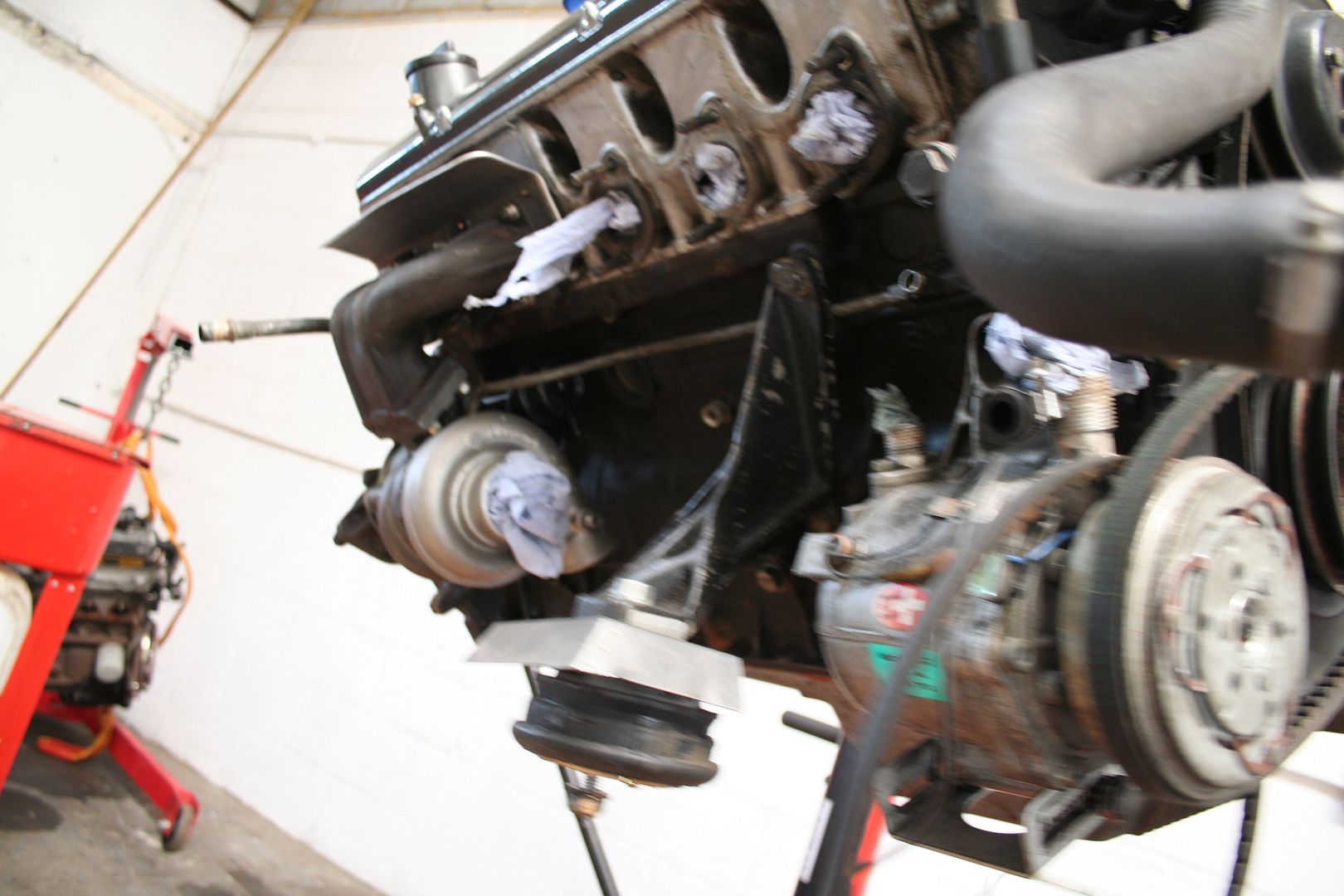

front one on, so i'm really cooking on gas now. The gearbox and starter can be bolted on and the whole lot re fitted into the car!
Bolting the turbos and pipework back on was fiddley with it hanging in the air. I'm not sure how I unbolted them on my driveway before on a frosty afternoon/evening!
I stopped there as I couldn't remember how all the heat shields went and the pipework!
This weekend should see some real progress!
