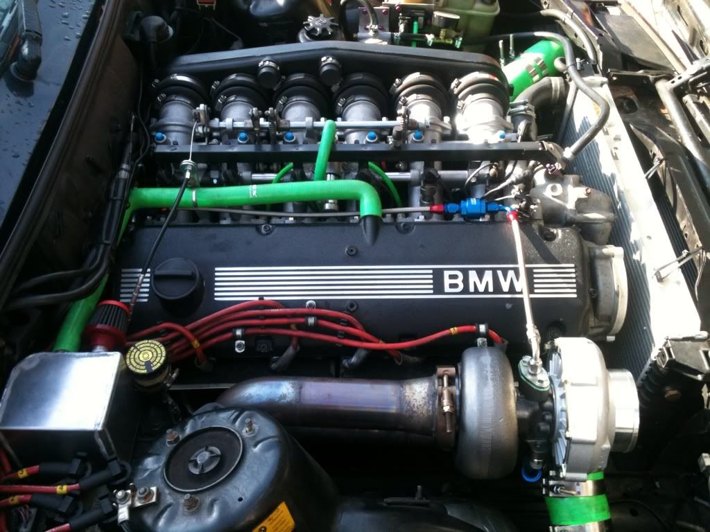

Thought id put a few pics up of her now shes been on the road over 2 months!
This is just after I fitted the new gearbox.
Running 10psi for now and its holding nicely. Fitted the oil catch tank and a few other bits.
Pulls like a train at the min so I have good expectations of future power.

Any more pics of the engine? looks proper lush

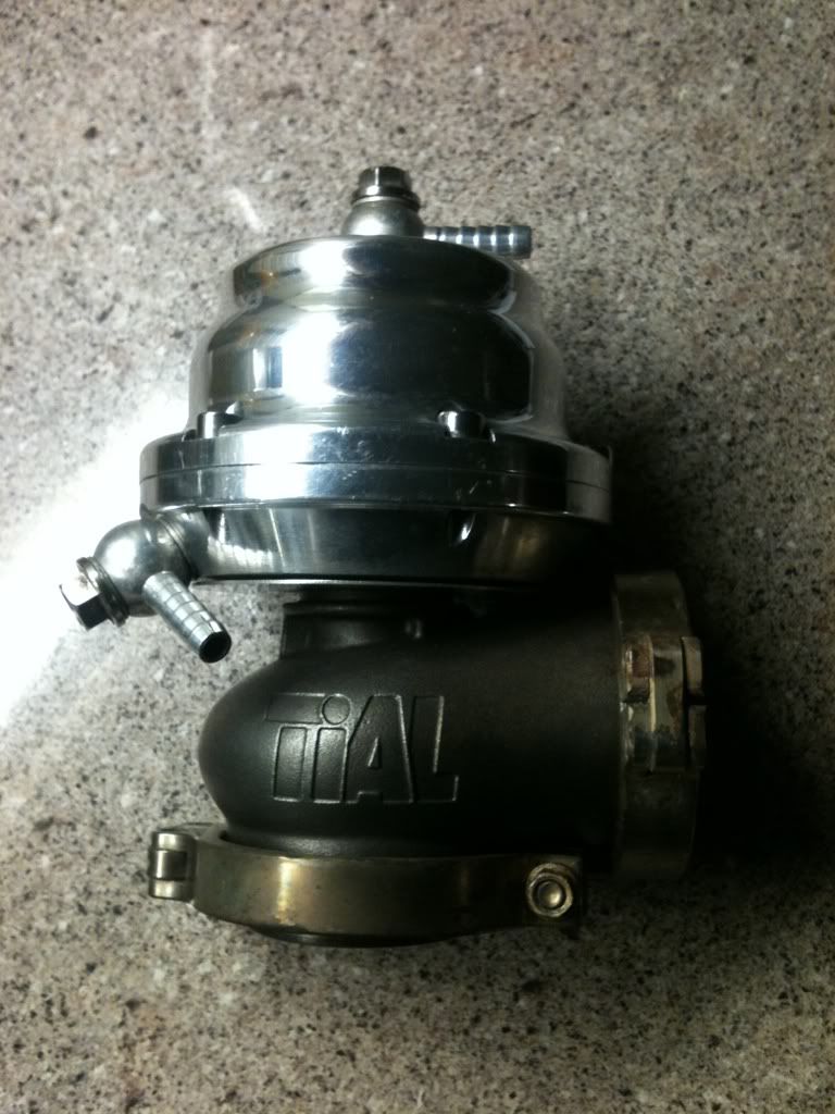

New tial wastegate,
and a new turbo on the way as mines fooked!
I have fitted the engine mounts - what a massive difference. Also had a new exhaust fitted the old one was to loud. After the wastegate and turbo are fitted ill have the map checked the get it on the rollers!

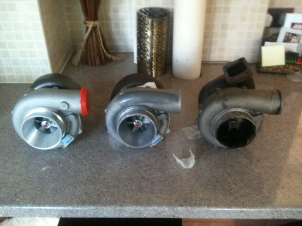

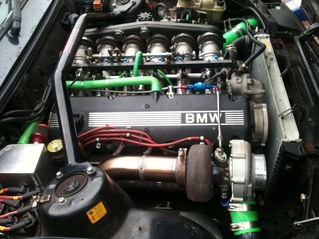

Got a few good things done today, a much needed, new turbo oil feed. Along with a new turbo and oil/filter change.
Spot the broken one!
All done, abit tidyer.

Dont know if ive said it before but that engine bay looks proper
Whats all the black stuff on the turbo on the right? isnt that where air gets sucked in.

Thats oil from where the seal has gone due to shaft play. Its been getting worse for the past few days.Whats all the black stuff on the turbo on the right? isnt that where air gets sucked in.

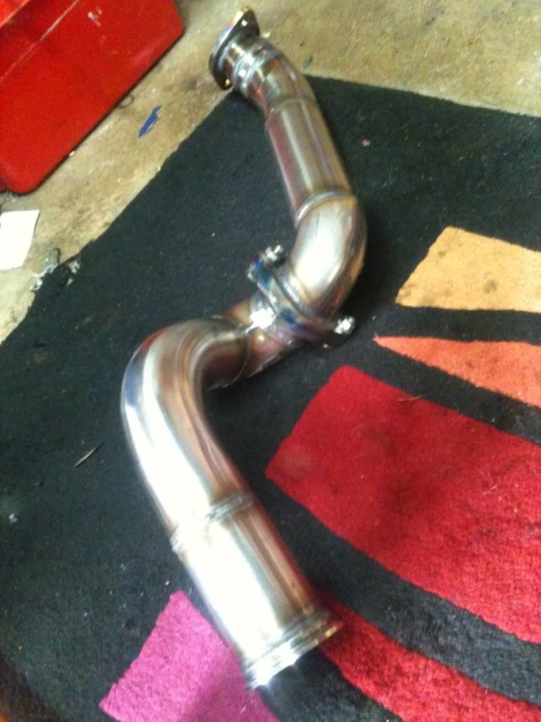

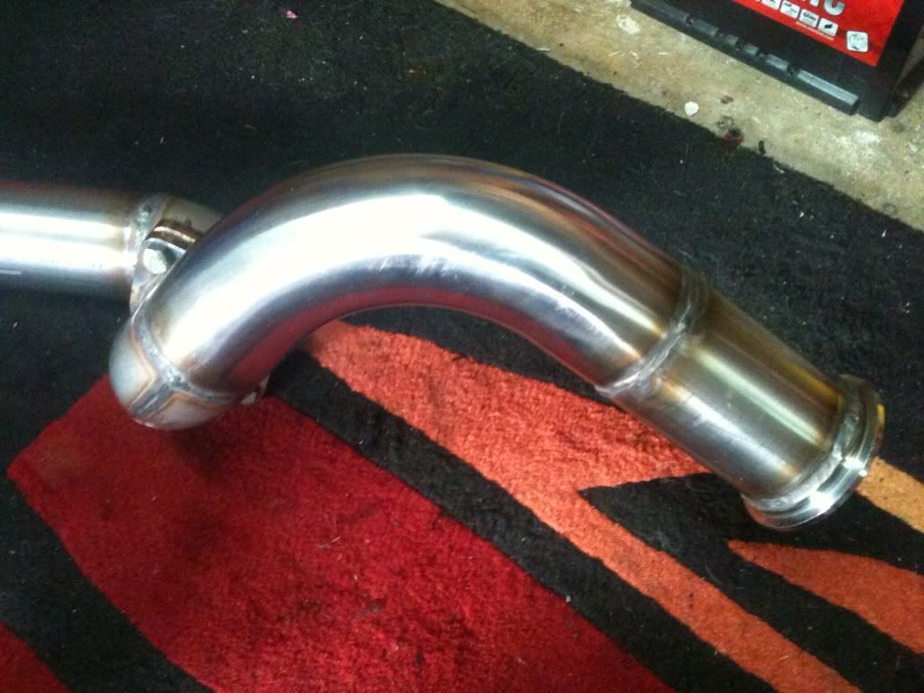

Ive been busy making a 3" down pipe. Hopefully let it flow a bit free-er.
leeparkes
- Posts: 9538
- Location: Black country
That looks much better.
Do you know how much power its got?
