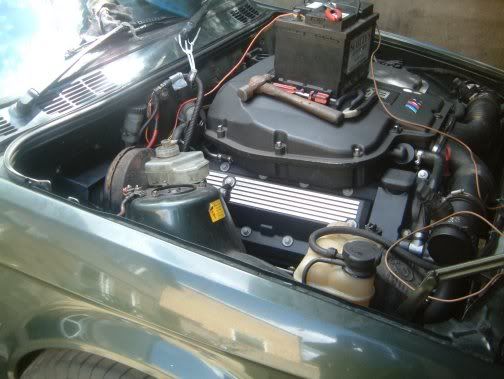

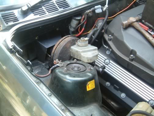

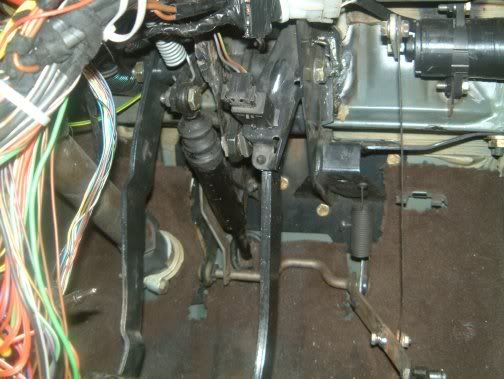

got the servo/master cylinder on today, had to use an escort servo as the e30 one was too big. have to tidy it up a bit, then i'll put up a pic or two.

good work there again!
i was wondering though when u plumb the brake pipes in ure gonna have pipes going towards the engine cam cover cs of the was the pipes come out thte master... u just gonna make em turn back on themselves as soon as the exit the master?
u got any better shots of how u did the linkages from the brake pedal into the servo..

widge, i had to put the battery there for now cos' the brain cant be disconnected from power for more than an hour cos' it loses its settings.
and then when you restart it, it over-fuels until its at running temp and the brain relearns its new settings

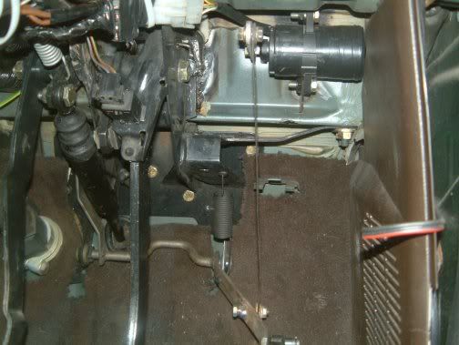

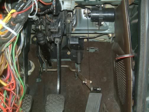

karan, here's a few more pics, its the best i could do for now.
what i did as a linkage was, modified the plunger arm out of the servo with an eyelet off the link-bar that runs from rhd to lhd, and used the short link piece with the double eyelet to reach/connect.
sounds complicated but you might see better in the pics

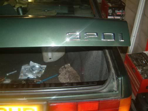

thought i'd have a play around with my badge today as it was a bit too wet to go lying around on the garage floor. (or is it my age!!).
it's not the finished thing, but thought i'd leave it like that for a while to see if i like it.
i made the '?' out of the '2'
