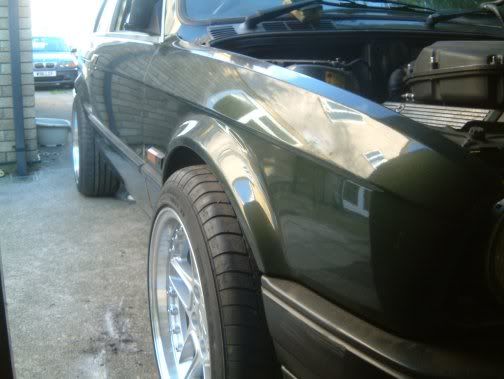

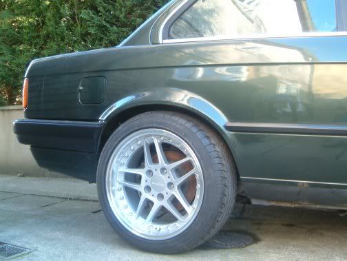

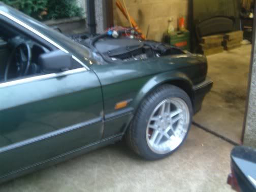

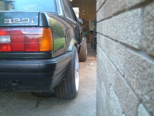

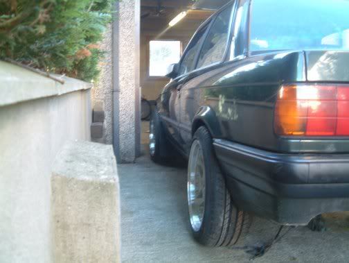

i needed a break from exhausts and manifolds, so this afternoon
decided to put one of the e36 m3 legs on.
took a couple of shackey pics just as the light was fading.
not to happy with clearances.
Andy335Touring
- Posts: 7144
- Location: Long Eaton,Nottingham
Think i read a post on R3V that you need the E36 M3 Evo TCA and the e30 M3 off set TCA bush to get the hub to sit in the right place.
The other thing that was talked about was to use the Tree House rear TCA mount thing,may be worth giving them a ring/email ?
http://www.treehouseracing.com/
BTW those wheels look cool !
HTH
Andy
HTH
Andy

thanks andy, those treehouse rear tca mountings look perfect for what i need, just the job, i will ring them in the next day or two and price them up.

need to sort that positive camber you have there as well dude

jhonno, the camber is actually negative, the photo's are a little deceiving,
and it's just been lowered off a trolley jack, so the bottom of the tyre has yet to spread and settle, will take a better pic of the both sides on the weekend.

this afternoon i got the old 320 axle off and put the e30 m3 axle on
dont know how long the diff will last but we'll have and see
diff is 3.25:1
diff is 3.25:1

wheels look great dude!
What size tyres are you running on the 5 stud wheels?
glenn
- Engine Transplant Services
- Posts: 2196
- Joined: Sat Jan 29, 2005 11:00 pm
- Location: blackwood, south wales
andy,
the wheels are 8.5x17, tyres are 225/45x17,
tyres are not really wide enough for the rims, but they came as a package,
i will put 245's on the back when they wear out (which wont be long me thinks )
