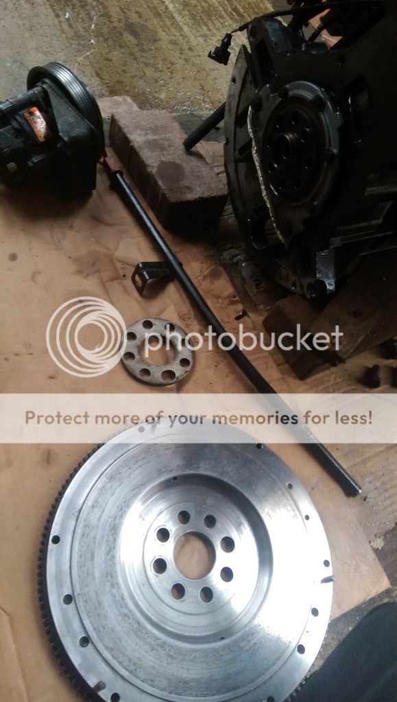

Ok so i'm putting the m20 fly and clutch back on the car and i'm just double checking where the round plate in the middle of the first picture goes or if it's even needed?
I've looked on realoem but unsure if i need to look at the e36 328i or e30 325i, there is also a large rectangular or triangular plate i don't have either and i'm not sure if it's needed.
Thanks
Ash

The plate goes on the front of the flywheel, the bolts for through the plate before flywheel.

The plate goes between flywheel and the bolt heads, think of it like one big washer for all the bolts. And yes it's needed.

Okay so the order is flywheel, plate, bolts and then the clutch assembly can go straight on? There's nothing else needed after or before the flywheel?

That's correct.

Large rectangular/triangular plates not required on a manual car.

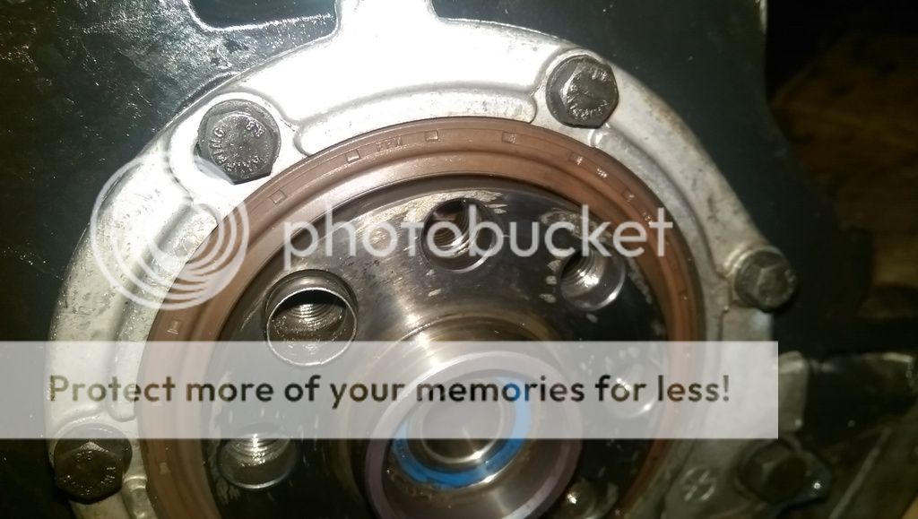

btw the white goop on your sump gasket isn't the best stuff to use...
Brianmoooore
Posts: 49360
Post Sun Jan 10, 2016 10:23 am
mark_i wrote: btw the white goop on your sump gasket isn't the best stuff to use...
That (excess) white goop will be breaking off on the inside, and gradually collecting in, and blocking, the oil pick up gauze.

It's being redone, the white goop is genuine VW stuff. What would people suggest that's better?

I would also change the long bolts which will be tight against the flywheel to hex bolts as removing them later on will be a pain if there isn't enough clearance.

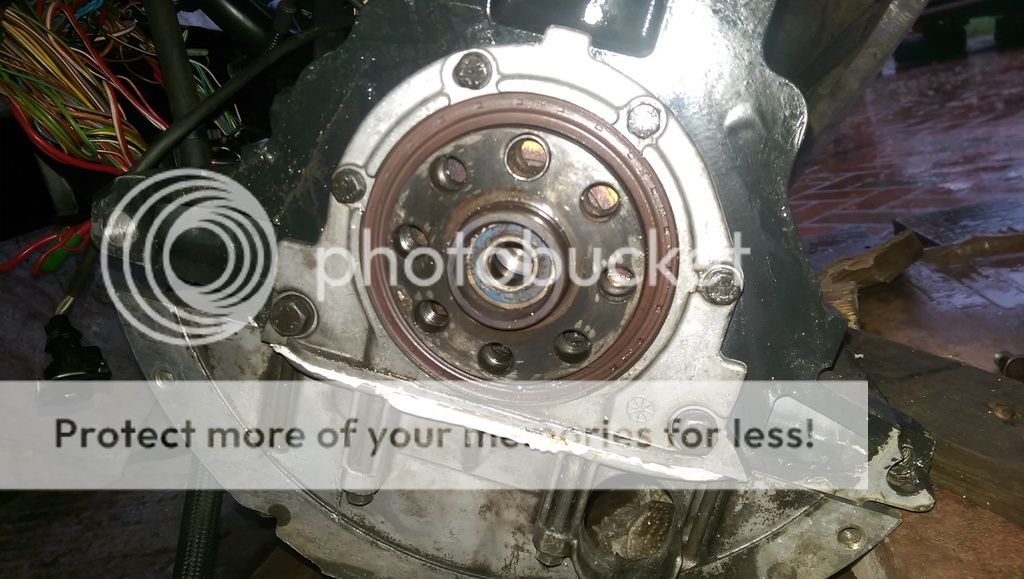

Okay so this was niggling me so i had another look tonight.
The flywheel is sitting flat and is not fowling anything.
Flywheel = 10mm thick
Washer Plate = 7mm thick
Bolts = 28mm
But there is a gap in the crankcase from where the flywheel sits to where the thread starts.

After a brief search i think i'm trying to use a shim from an auto setup rather than a manual, the auto ones appear to be thicker

So i pulled another spreader plate from an m10b18 earlier, same P/N as m20 manual. Its definitely thinner and has made a difference.
I'm now at 4.25 turns by hand until it stops, at which point it's right up against the plate.
I believe the issue is fixed as the max the bolt can go in is about 6 turns (without the flywheel fitted) so by the time i torque up i'm nearly there.
The back of the bolt to the plate distance is 7mm at the start point, so for whatever reason these bolts are designed to go in less distance than a normal bolt.
