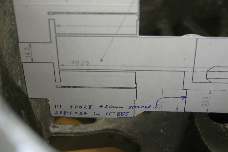

I've updated the wheel vs WMS brakes list in post #1, I've found that for those with a spacer fetish you CAN fit the 298.5x24mm kit behind the 15" BBS (tested on the FPS casting version), but you need 20mm minimum and really 21/22mm.
So if that's your thing, it will fit! Here's the profile in the wheel, with a "20mm" spacer:

I thought I'd mention that this is possible with a spacer as a it turned out a competitor was saying their kit "fits under the BBS" - but needed a huge spacer which is far from obvious!
So the point is that if you are happy to run spacers (so a like-for-like comparison) we out spec them in terms of what's possible so I thought I'd make that clear.
