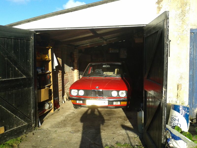

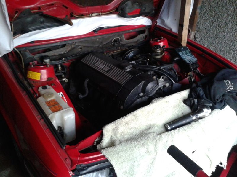

here it is, a lovely little 518i. not mint or concours but presentable and rot free (as far as i can check without a full strip down!)
but what's this?
and an M50 manifold and e34 sump? surely not?
:D winkeye

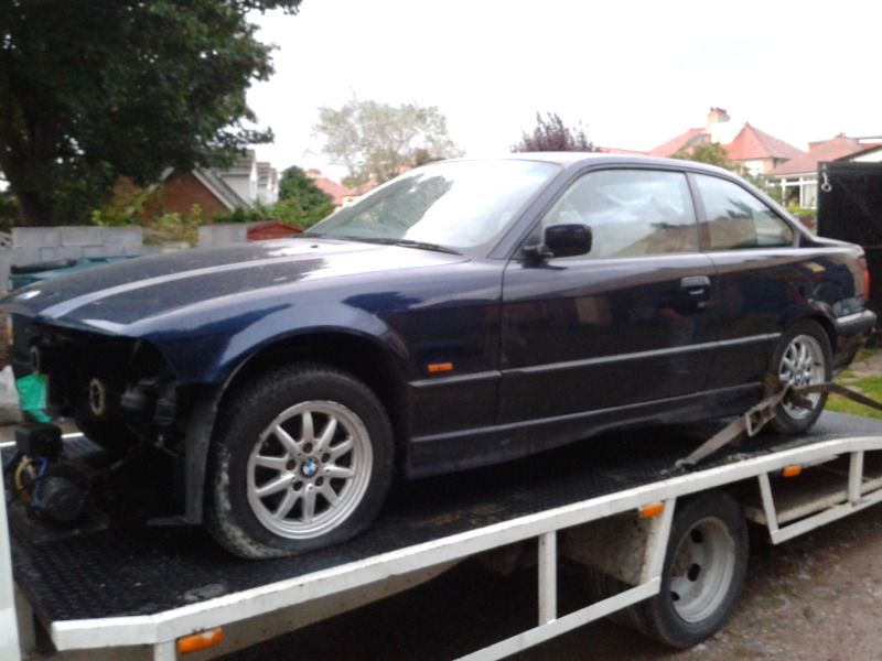

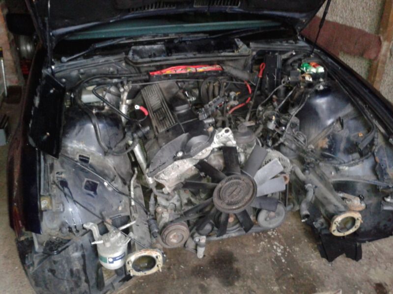

i've bought this e36 from a chap who had started to strip it with the intention of putting it in his E30 rally car. he'd got as far as removing the inlet manifold and an alarm before he'd decided to go for a vauxhall XE engine to put him in the 2-litre class. therefore i haven't heard this run, which i admit is taking a risk and is not something i'd usually do. i do trust the chap though and if he says it's good i believe him.
he also had a E34 M50 sump, pickup and dipstick and M50B25 inlet manifold, which he included in the sale.
i've never done any work on M5x engines or E36's so there's a fairly steep learning curve; but with the knowledge of the zone what can go wrong! :D
anyway, enough of the excuses, more pics:

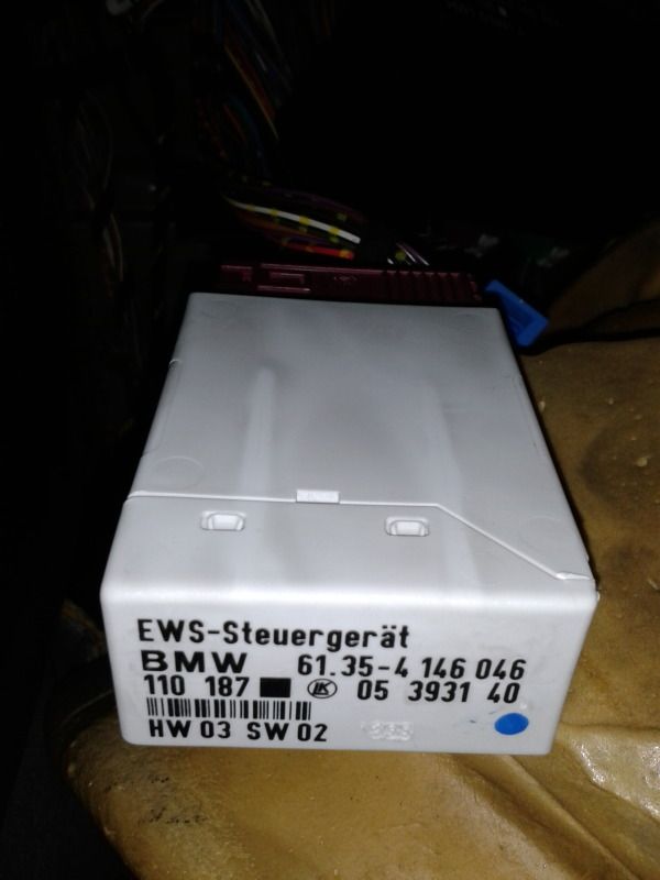

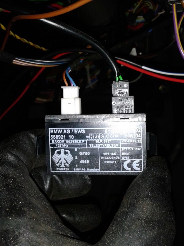

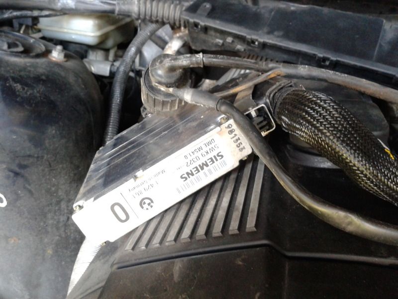

EWS: i've looked at the threads in the swaps section so i think i've located all the bits i need.
ECU
controller
send/recieve module
ring antenna
key

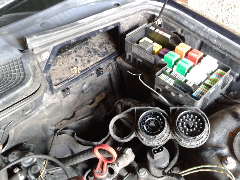

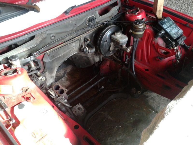

can anyone advise me how much of the wiring to extract with the components? do i need it all or should 6 inches or so be sufficient?
i've unplugged all the engine loom from the connectors, i cant' seem to remove the fusebox, any hints?

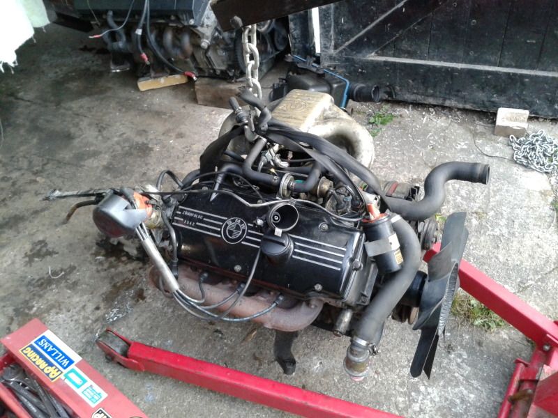

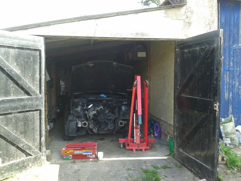

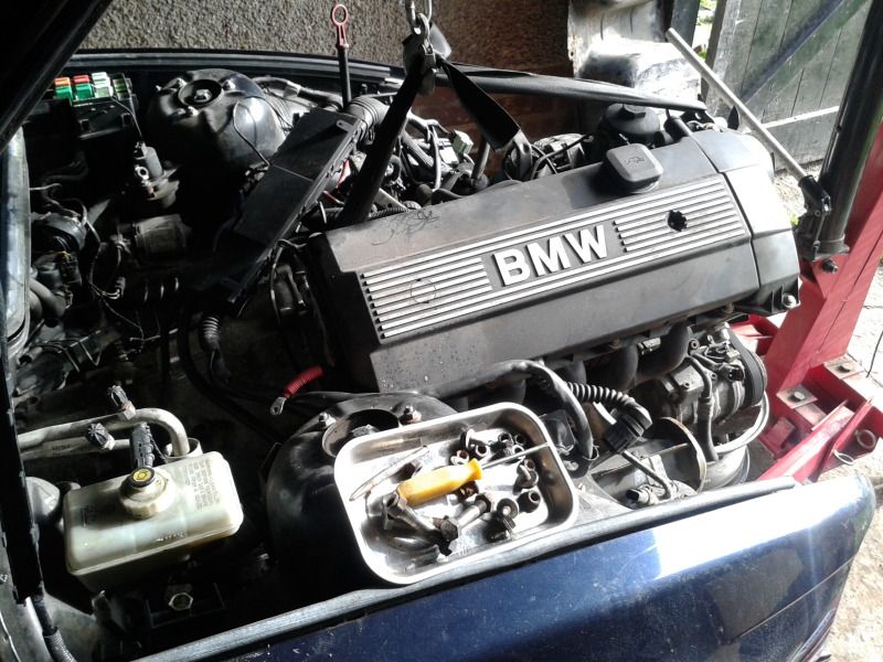

engine liberated from the bay!
that's it for now.

The fuesbox is screwed down - it'll be obvious with the engine out and top cover removed.

Why do you need to remove the fusebox? Let me know what ABS unit it has, I might come and buy the complete loom off you/have a nose etc :D

DanThe wrote:Why do you need to remove the fusebox? Let me know what ABS unit it has, I might come and buy the complete loom off you/have a nose etc :D
i was going to remove most of the loom just in case i missed something i needed for the conversion before the shell goes for scrap.

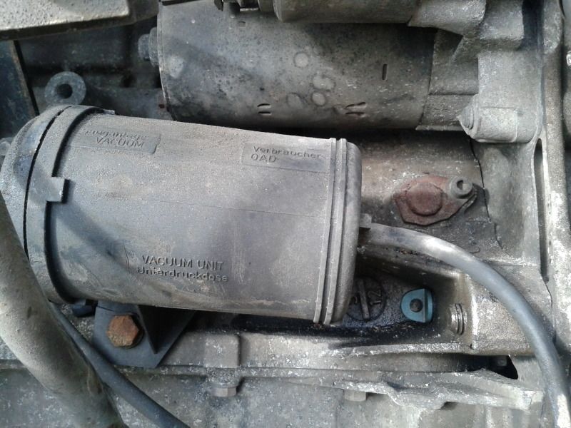

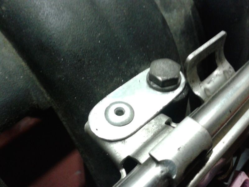

as i said earlier, i'm not familiar with these engines, can someone tell me wht this is loacted near the starter? it's some vaccum device and the little tube goes to the fusebox. can it go in the bin?
also, the tab that identifies nikasil/alusil/steel linered is next to it, can anyone remeber what it means?
Posts: 24532
Post Sat Sep 01, 2012 8:25 pm
The vacuum an accumulator for the vacuum operated exhaust flap on 328i's. It can go with the vacuum supply blanked.
The metal pear shaped tab indicates that it has had a steel liner block replacement for the original nikasil block.
No such thing as alusil blocks on M52's! Common misconception!

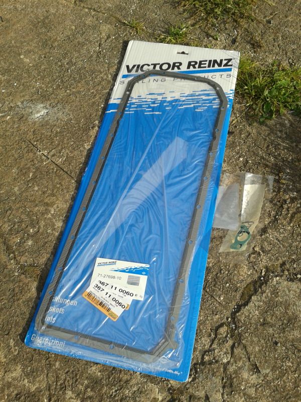

there hasn't been any progress on this really over the last couple of weeks. im currently waiting on a mate to move the shell but his car transporter is out of action, i've promised him the car as payment for moving it from anglesey so can't just get rid. hopefully it'll be gone in a few weeks.
bought a sump gasket and a gasket for the oil pick up so i can change them over while i wait for the shell to go.

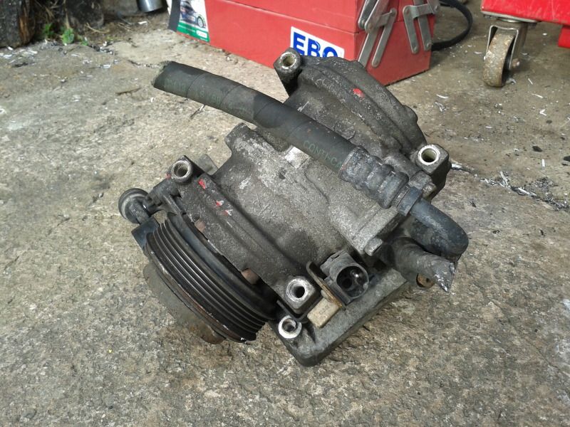

took the aircon pump off the engine and, er, that's about all!

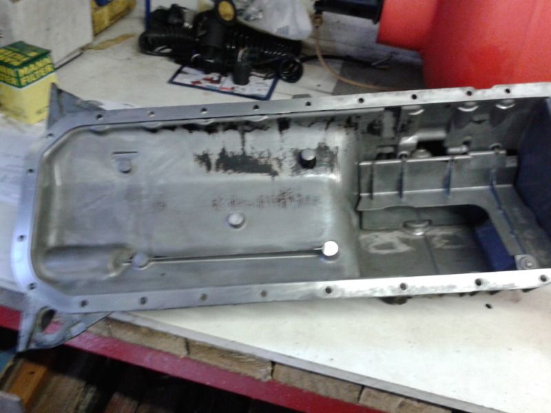

i removed the e36 sump and oil pick up from the engine and fitted the e34 pickup.
i then hit a bit of a snag, the sump i have from (what i assume) the e34 has a windage tray riveted to it, and the m52 has one bolted on, so i removed the one from the engine assuming that the e34 sump with the built in tray would fit fine. not so.
it is fouling against the block on the 3 protrusions at the top of the picture.
this is the e36 windage tray that has a bracket for the oil pickup on the underside.
has anyone come across this problem before?
i see two solutions:
A. trim the protrusions on the e34 tray to make it fit.
B. drill the rivets out and remove the tray from the e34 sump and use the e36 one with the bracket for the pickup removed. (this would seem the simpler but as the e34 tray sits on 'towers' cast into the sump it is possible the sump could foul on something even after the tray has been removed.)
suggestions?

ok, i've just found this in the zone wiki:
To fit the E34 sump to an M52 engine, you will need to remove the internal baffle plate (see pic). The plate unbolts, but it is also necessary to drill or grind down the mounting columns so that the bottom of the dish is flat.
can someone just confirm that this is the way to go before i ruin a perfectly good sump?

drilled out the rivets and then ground them down to remove the windage tray from the sump. this is now bolted up to the engine.

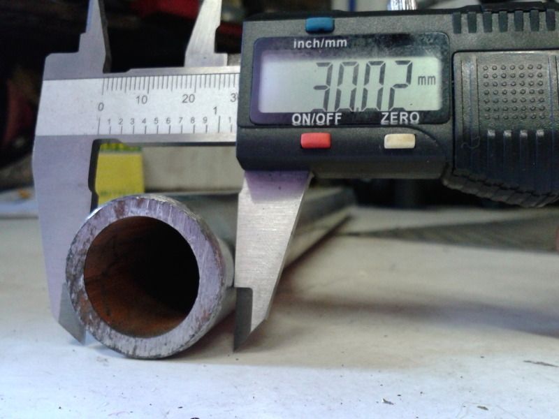

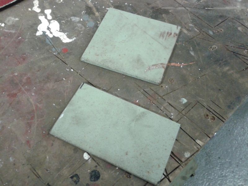

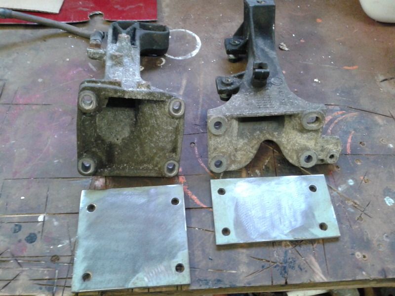

found some heavy plate and seamless bar to use for the mounts. it's gonna take a more serious welder than mine to penetrate this stuff!

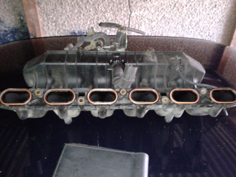

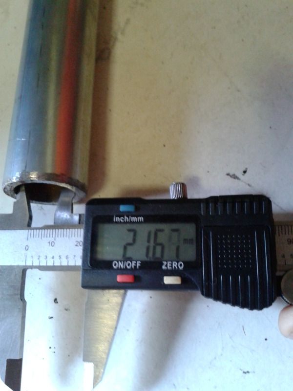

i fitted the m52 fuel rail and injectors to the m50 manifold and made up some small ali brackets to bolt it to.
i also started sorting out the pipework on the manifold using the very good guide in the sticky here: http://www.e30zone.net/modules.php?name ... 24&start=0
i found some 5mm steel plate for what will become my home brewed engine mounts
these will bolt to the block and then i'll eventually weld the bar to them.

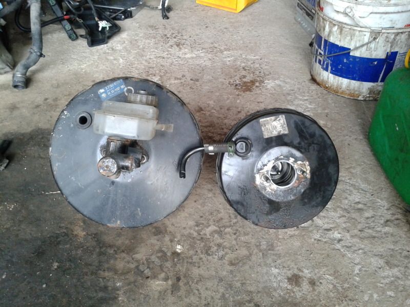

also, to head off any potential servo clearance problems, i went and got myself a clio servo (on the right) :D if anyone has to remove one from a clio themselves, they come off the bulkhead fine but you cant get it out past the engine without undoing the drivers side engine mount and prying the engine forward!

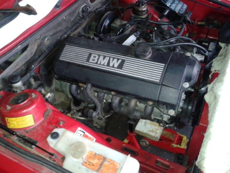

m10 out.
empty bay.
m52 in.

The sump might need a baffle installed / welded inside, to stop the oil going towards the back of the engine under hard acceleration, and starving the front mounted oil pick up of oil....
http://www.e30zone.net/modules.php?name ... c&start=25
alan1272
Posts: 414
Joined: Sat Mar 04, 2006 11:00 pm
Location: dyserth, north wales
Post Sun Oct 07, 2012 11:55 pm
Das_BMW_E30 wrote:I don't want to chuck a spanner in the works, but....
hmm, can't see it needing a baffle like in that link, it's only a m52b28. it's never going to see a track or any nonsense like that so it'll be fine. :D
Andyboy
Alpina Colada
Posts: 12580
Location: Notts
Post Mon Oct 08, 2012 8:43 am
It should be okay, but the winding tray is there for a reason.....
What box/diff are you using?
