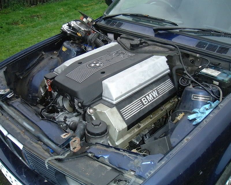

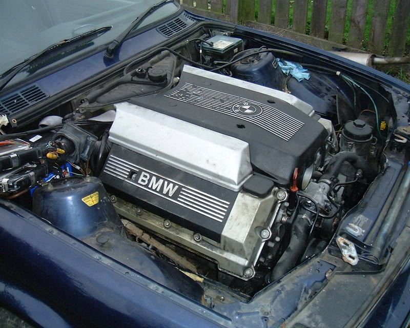

Dropped engine and autobox in today to see what the clearances are like
engine clearance from front to back are sweet but side to side is a bit tighter but still ok.
Exhaust manifolds should be interesting to say the least.
Looks like some tunnel bashing rqd to get the box into correct position.
Looks great though :D

Fits in there nice. Has it got to ECU's ?
bigdek
Posts: 1115
Joined: Thu Feb 10, 2005 11:00 pm
Location: Fife Scotland
Post Sun Oct 15, 2006 3:59 pm
one for the engine and one for the auto box m8.

is the header tank just resting there?, as it looks a little high.
keep us posted though mate.

glenn wrote: is the header tank just resting there?, as it looks a little high.
I think the ECU position also needs a little adjustment :lol:
Got to agree with Glenn though - V8s :drool:

Glenn its just all literrally dumped in at the mo.
Just wanted to see it in and what clearance issues.
the bonnet does shut ok though as it is
