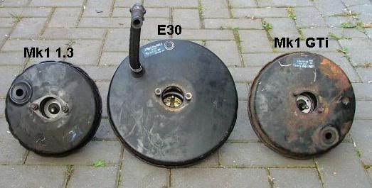

Yeah the Mk1 Gti servo fits without the spacer, but it does need the linkage at the back to be drilled out to accept the E30 linkage pin.
The Mk1 non-Gti servo will fit, but its to small for the E30 - the brakes on the Mk1 1.3 Golf were bad enough. Its not something Id want to use on an M50 converted E30
As has been mentioned, finding a Mk1 Gti servo isnt going to be easy now. I think they can still be bought new, but wont be cheap.
The Mk1 non-Gti servo will fit, but its to small for the E30 - the brakes on the Mk1 1.3 Golf were bad enough. Its not something Id want to use on an M50 converted E30![]()

well im hoping with the Z3 rears and E36 front brakes i should be able to stopThe Mk1 non-Gti servo will fit, but its to small for the E30 - the brakes on the Mk1 1.3 Golf were bad enough. Its not something Id want to use on an M50 converted E30
Did feel pretty damn good going round the block. Maybe thats cause they were already half on
The brakes will be fine, they must work without the servo, but it all depends on hard you want to press on the brake pedal.
With the smaller servo, you will need to press harder.
(if Ive got that right

jmc330i wrote:The brakes will be fine, they must work without the servo, but it all depends on hard you want to press on the brake pedal.
(if Ive got that right)
yep thats right

I fiteed a Mk 1 Golf GTi servo to my E30 today.
It does fit without modifying the spacer to the cylinder.
But , I did find that when I swapped my end on to the shaft, it was to short!
the GTi Servo seems to have a slightly shorter shaft!
I got round this by using the E34 end as they are extra long and you can cut the m down to fit.
