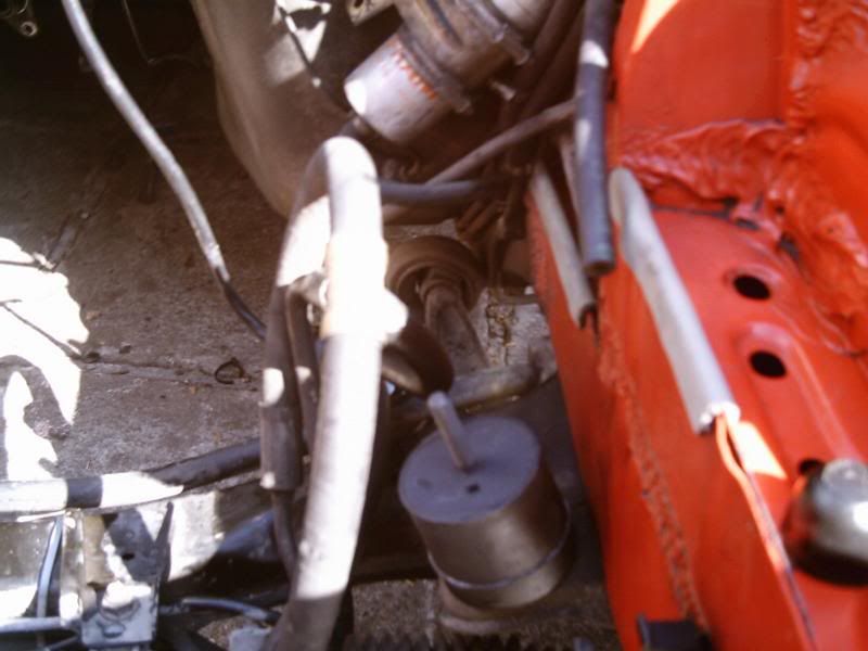

do the mounts look right?

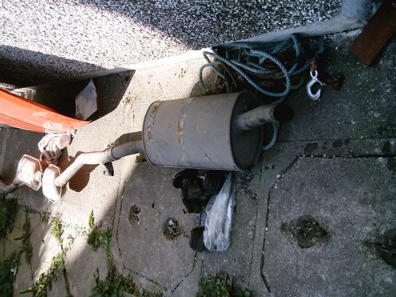

exhaust is off

the exhaust, powersteering pump and two mounts..thats all i can do for today..my poor girlfriend is being neglected over the car so i ave to go for a spin and stuff..think i might drop it in tomorrow night to start messin with my manifolds

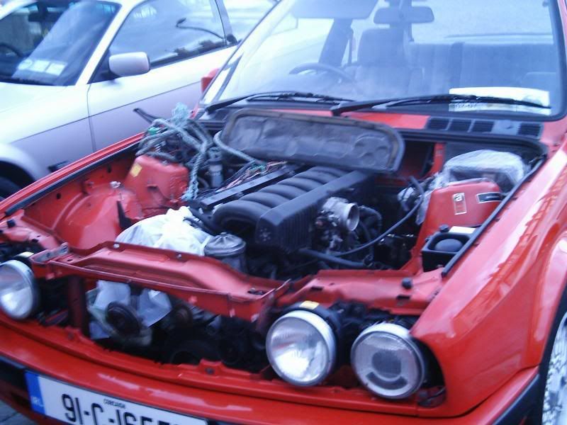

m50 is in..not sitting on mounts yet but in..
i think one of my mounts might be inside out ..engine is very far over to driver side when close to mounts..
plenty of space for heater pipes..

Plenty of space for heater pipes = less space for steering shaft and exhaust pipes. There are various ways the mounts can fit in the subframe.

say the passenger side mount..should the threaded bar be on the outside or inside when looking up from under subframe??
Mon Apr 09, 2007 9:26 pm
Both of mine were fitted to the outer holes, as are others ive seen

My notes (written a year or two ago) say: "LH mount is fitted reversed. i.e. stud in slotted hole and locating peg in round hole.
RH mount is fitted stud in round hole and new 10mm hole for locating peg drilled 17mm towards centre of car."
That was for standard M20 rubber mounts.

im using e28 m5 mounts..and by sonds of it i reversed the passenger side mount beknown to me..i only noticed when puttin on nut coz it was harder to get at

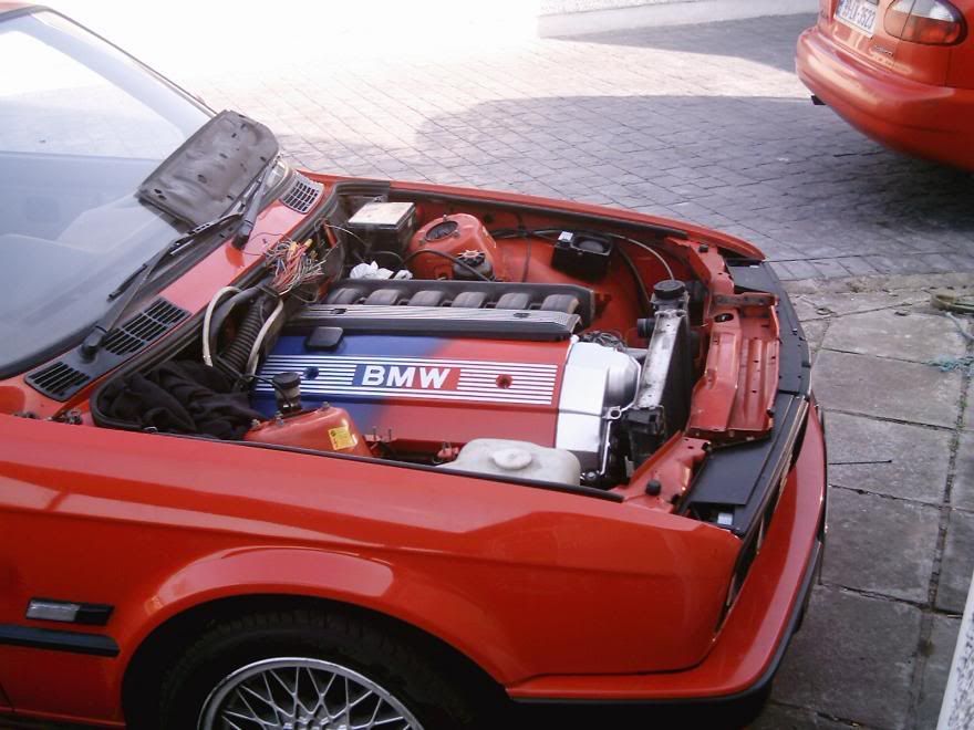

cover was recked so i said id clean it up..primed and painted silver...gonna finish colours tomorrow

tonight i got the engine sitting in its mounts..tomorrow im gonna test fit my m52 e/manifolds after i chop and tack em
Left to do:E36 325 prop,gearlinkages
gearbox mount,
cooling
wiring
and all small ancillaries
lot still to do but im happy

itll be ok like this till i get money to buy new standard one..didnt like it with all scratches and stuff....
Thu Apr 12, 2007 11:05 pm
The red and blue look good but I would black the cam cover again 8)

Prefer all Black!

i gonna put a darker blue /purle in the middle..see wat it looks like then if i still unsure itll be goin back to black..can ya buy a c101 new??
