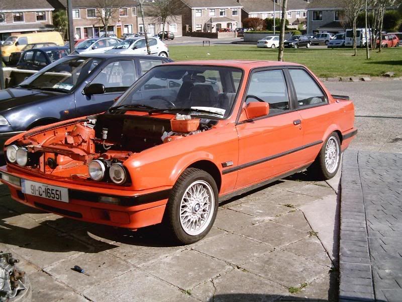

i had a bit of an incident while taking out the m50..anyone spot what i done?? never mind the loom that is being replaced by the fella i bought it off
here is some pics of the e30 in return for ye're advice
You may aswell take the M42 PAS pump out now,you wont be needing that!

Good progress here mate, bit of a crazy time to be doing it with uni exams coming up though, fair play fella!!!
I got my M20 ready to be lifted out yesterday, just waiting for my mate to get here to give me a hand then it's up the scrappy to get the oil pick up pipe then prepare to fit my M52 :)
Very nice car by the way!

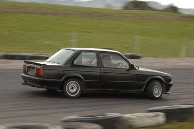

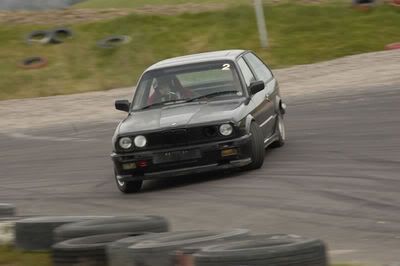

thanks eko..i got pics of me driftin my other e30..has nothin to do with the conversion just said id share em..it was my first round so no angle or smoke but still sideways

Cool pics Brian,looks like good fun :cool:
