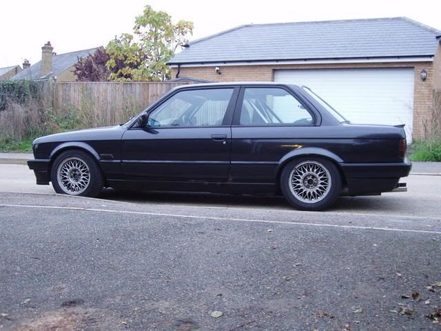

Just an update!
As some of you following this thread might know I bought a G-Max -60mm suspension kit from a fellow zoner recently. I got it fitted this week and so far I'm quite impressed. The car looks so much better at it's new ride height and it is now level! It is a little stiffer than the other Dutch crap I got off Ebay but isn't too harsh for me on bumpy roads, for myy preferences it's just about right.
While I was at it I fitted it with E46 rear top mounts from BMW.
Also looks like I've sorted my oil leak tonight. I had a slighly leaky oil pressure switch and I was a bitt too cautious when I bolted the sump on not to crush the gasket. I tightened the sump bolts a little and it seems ok so far!
Today I also ordered Powerflex rear beam bushes (one of mine is clunky) and a set of Powerflex trailing arm bushes. Then the back end will be just about sorted.
All in all a productive week and weekend for me!

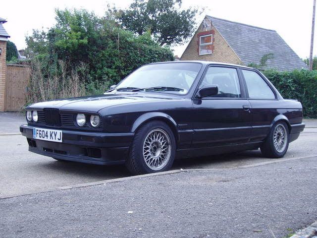

Here's what it looks like now -
Gareth - if your'e still thinking about getting a G-Max kit I could come down and take you for a spin sometime if you wish.?
