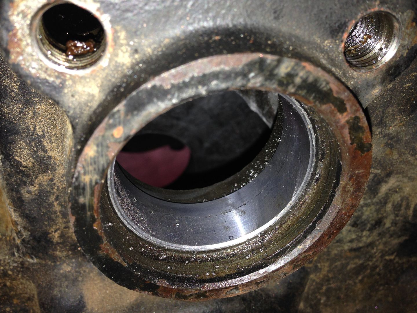

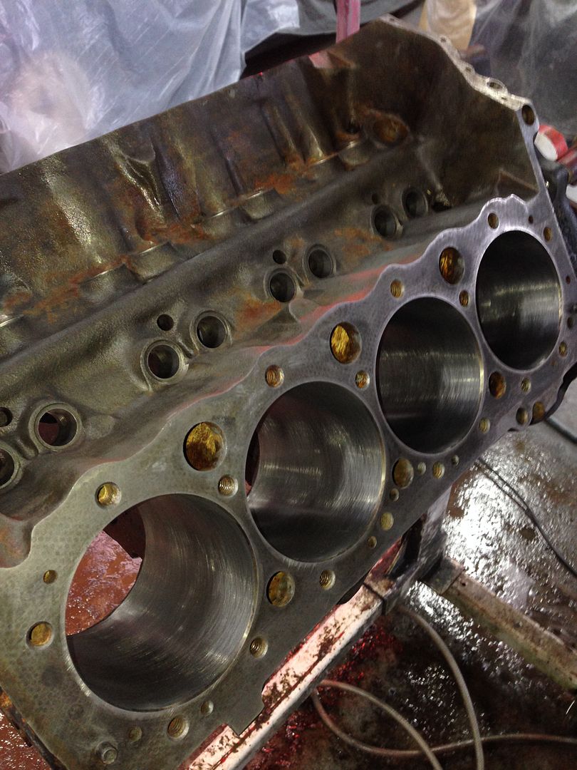

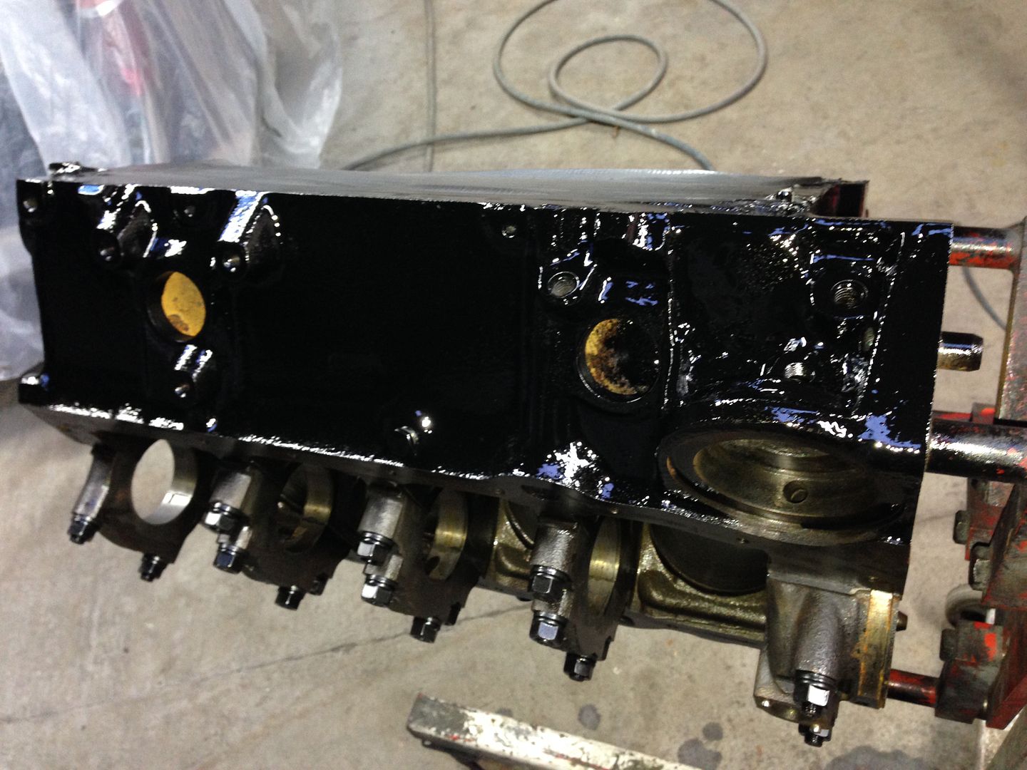

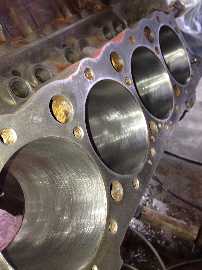

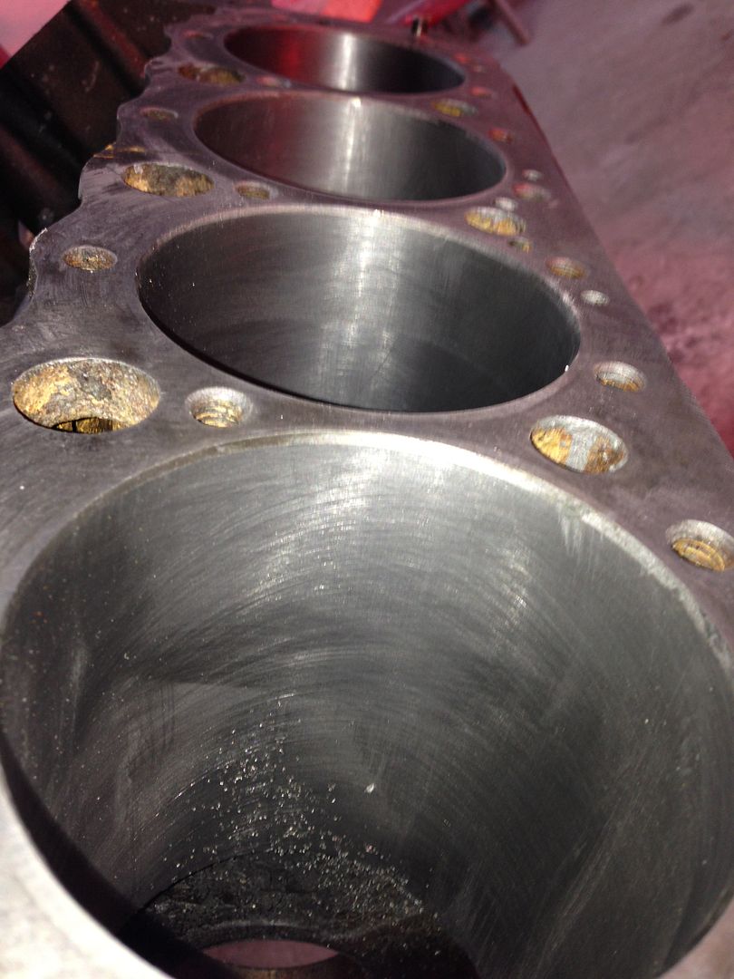

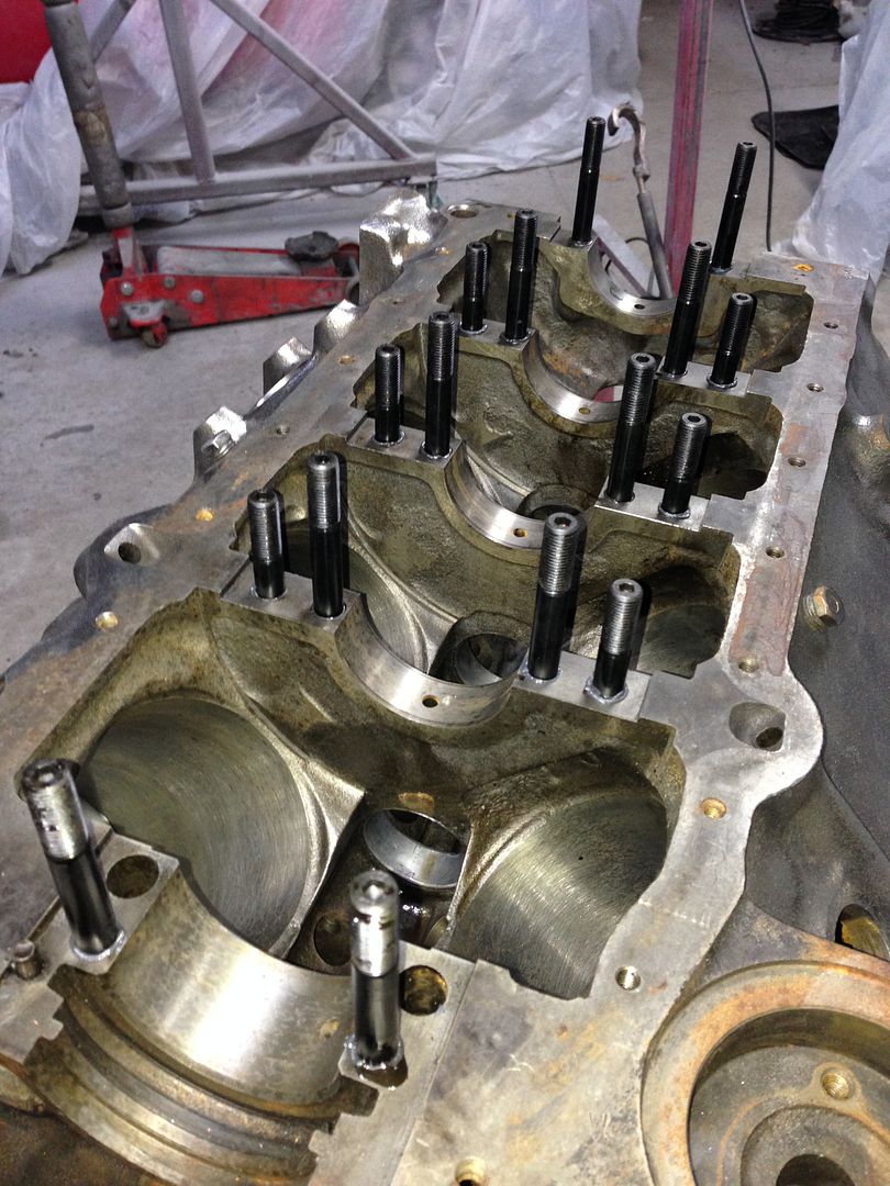

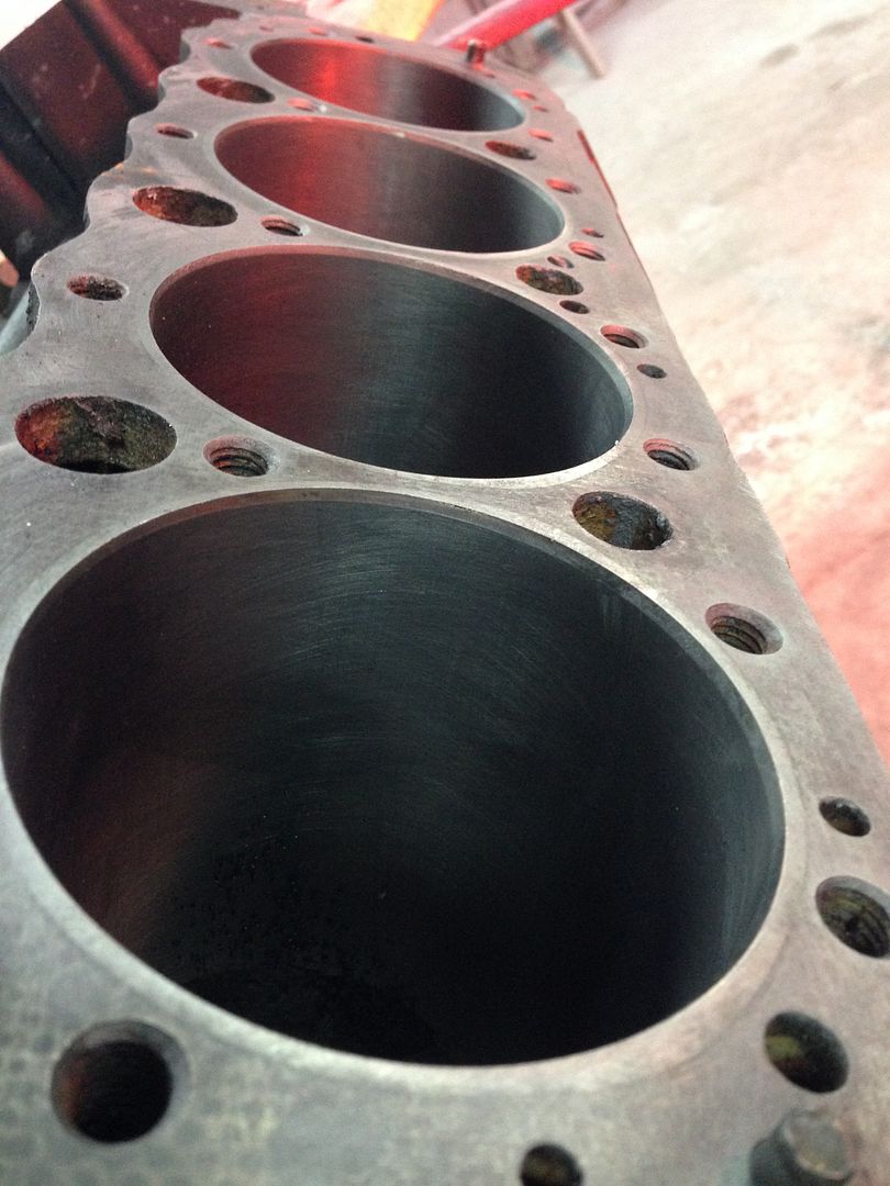

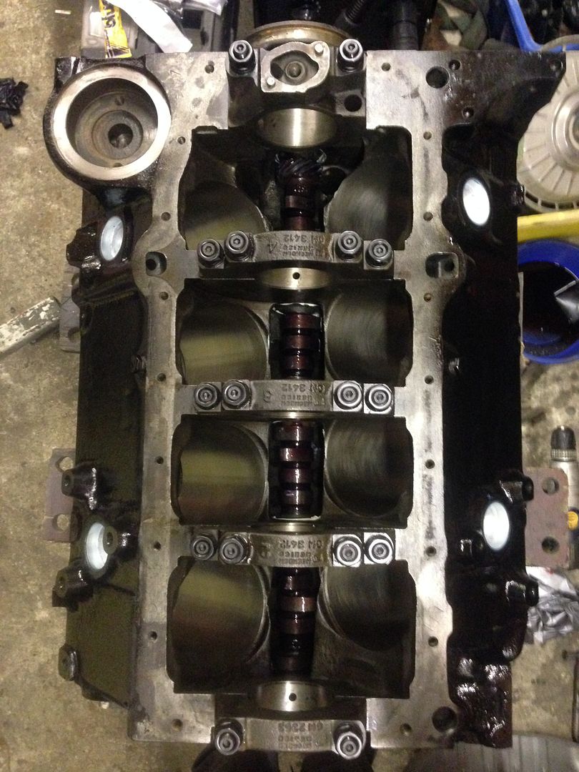

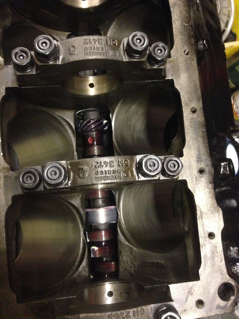

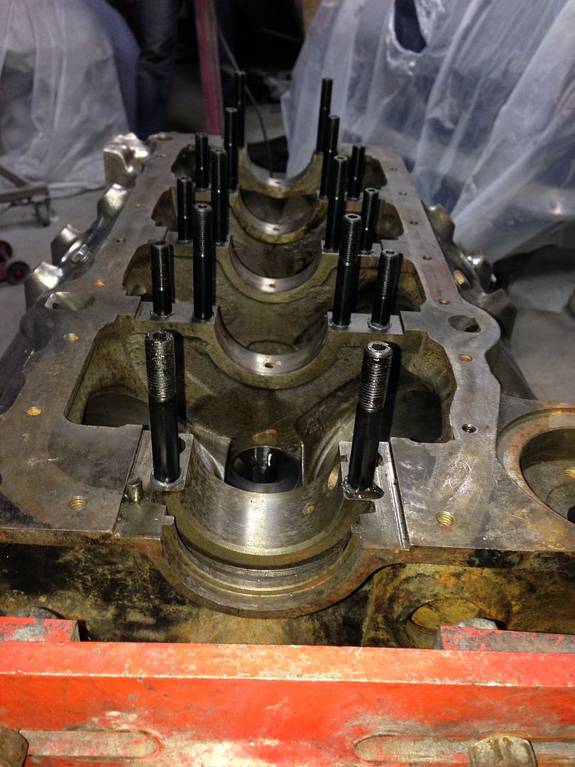

well I picked the block up today and got straight on to cleaning it

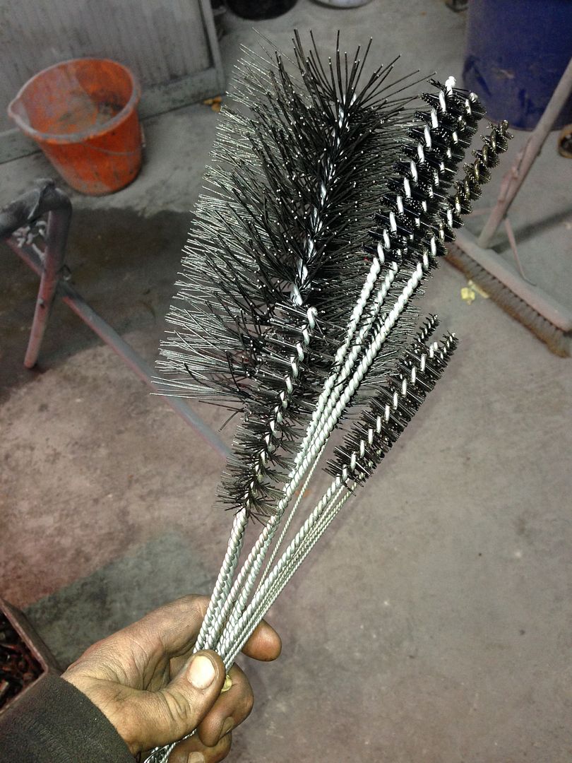

bought my self some nice cleaning brushes
and got some assemble lube to built it too

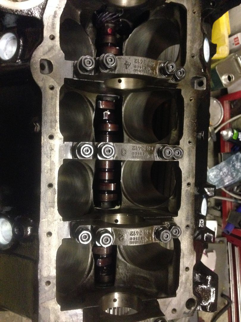

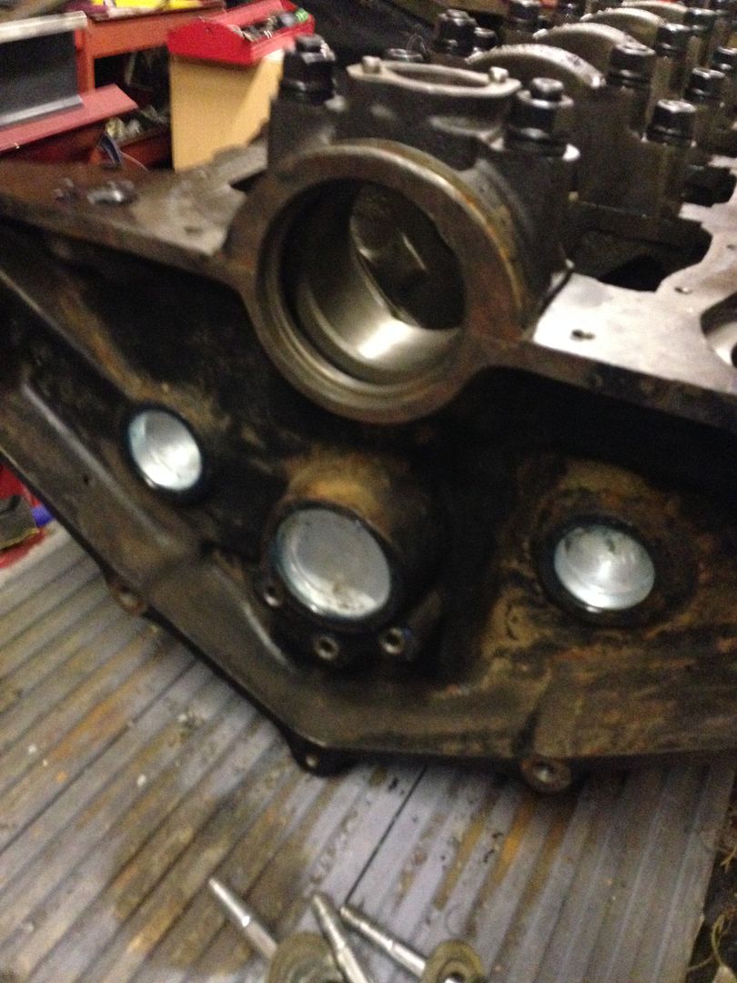

got the cam bearings in
what it started like
after alittle clean
and then started the out side
just got to give it a lick of paint now but I'll do that tomoz
let the fun begin.

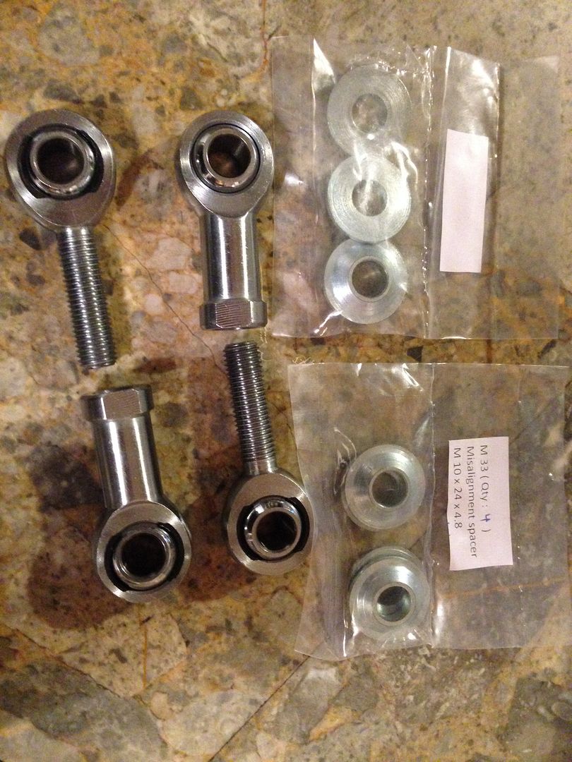

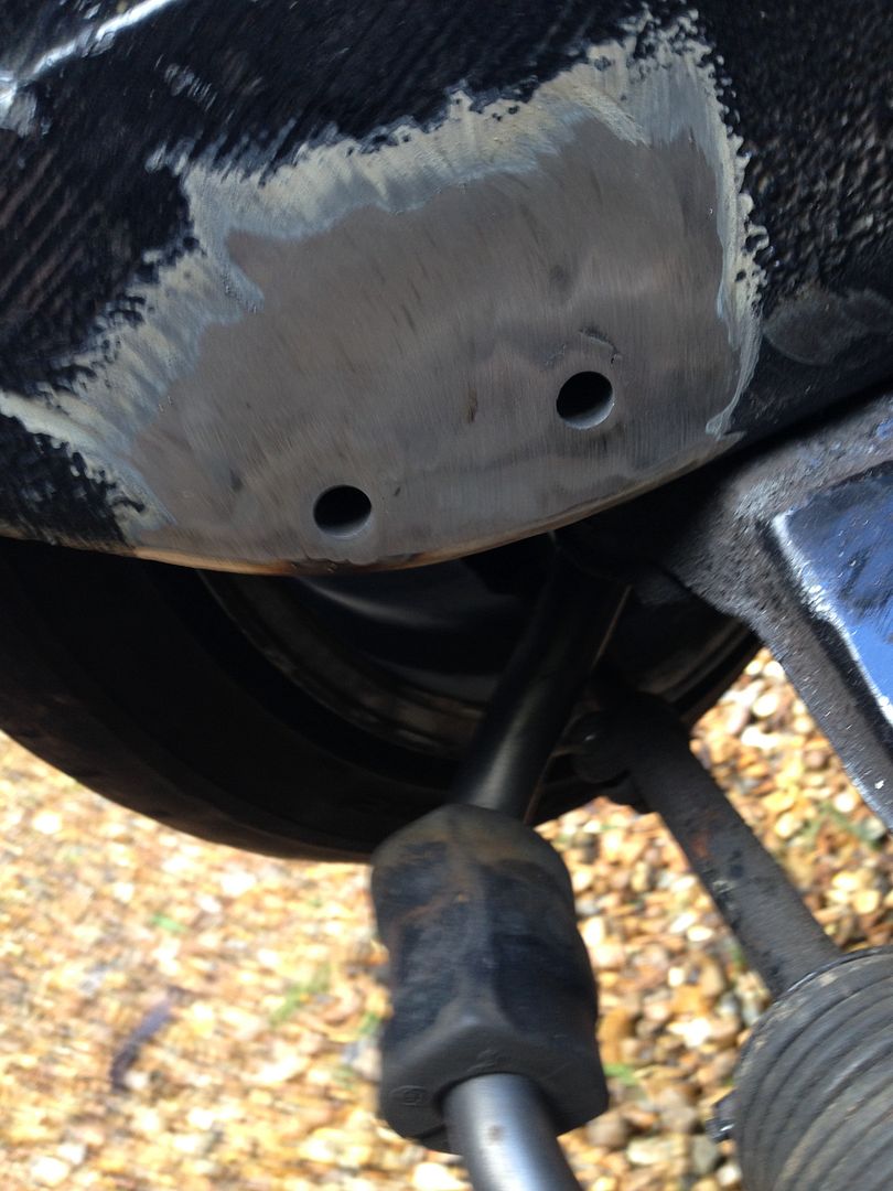

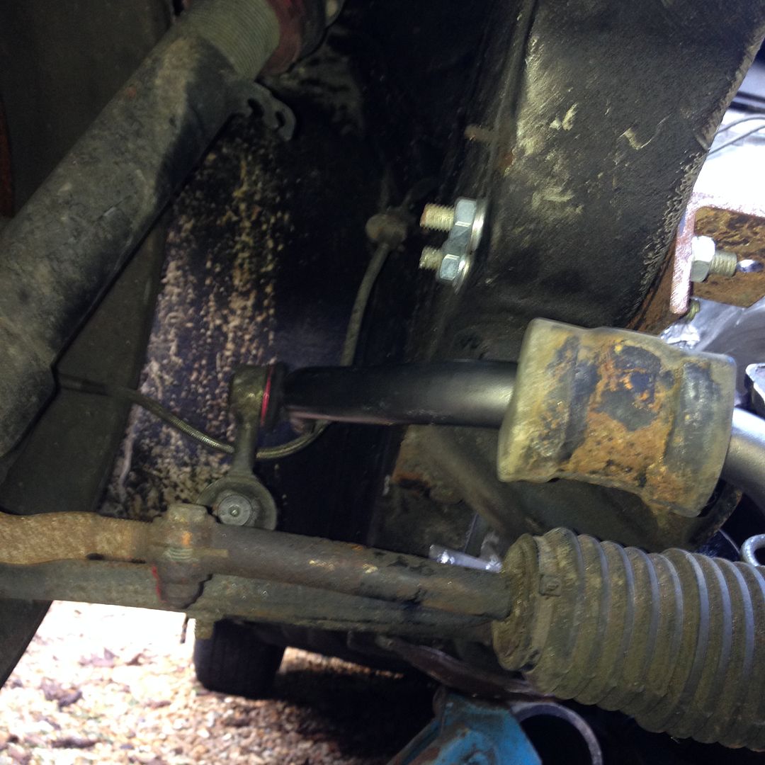

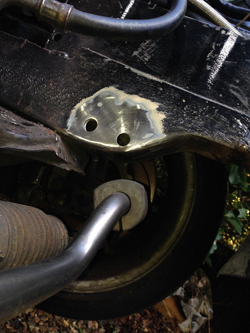

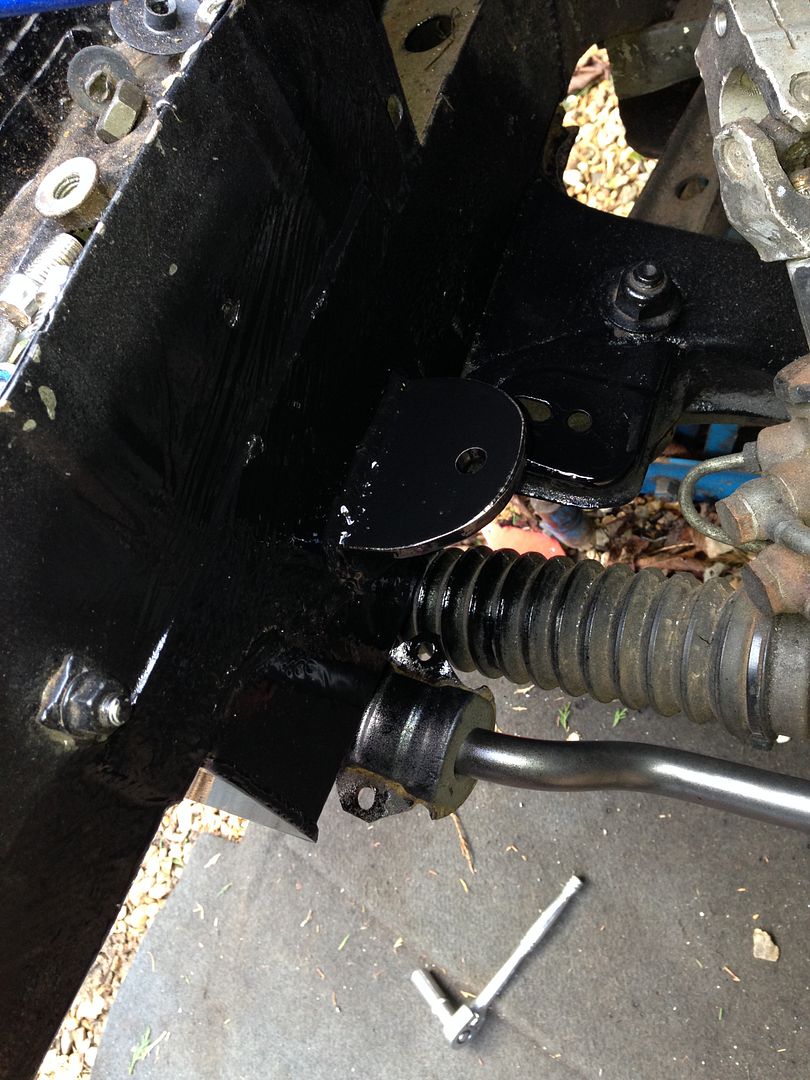

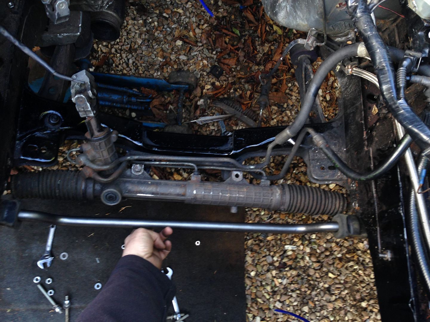

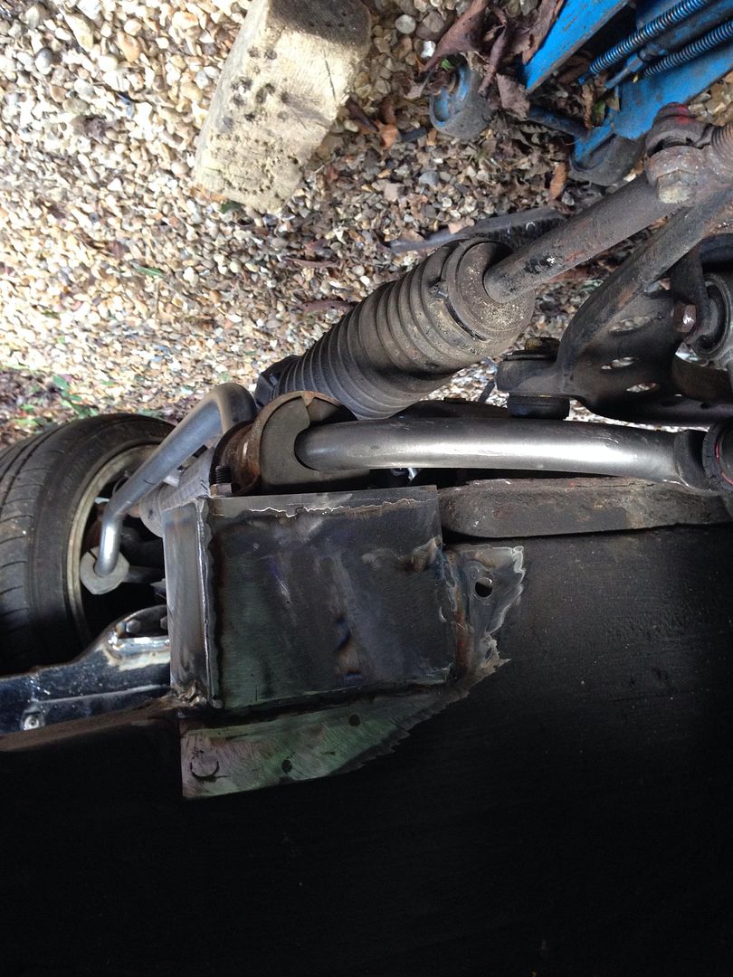

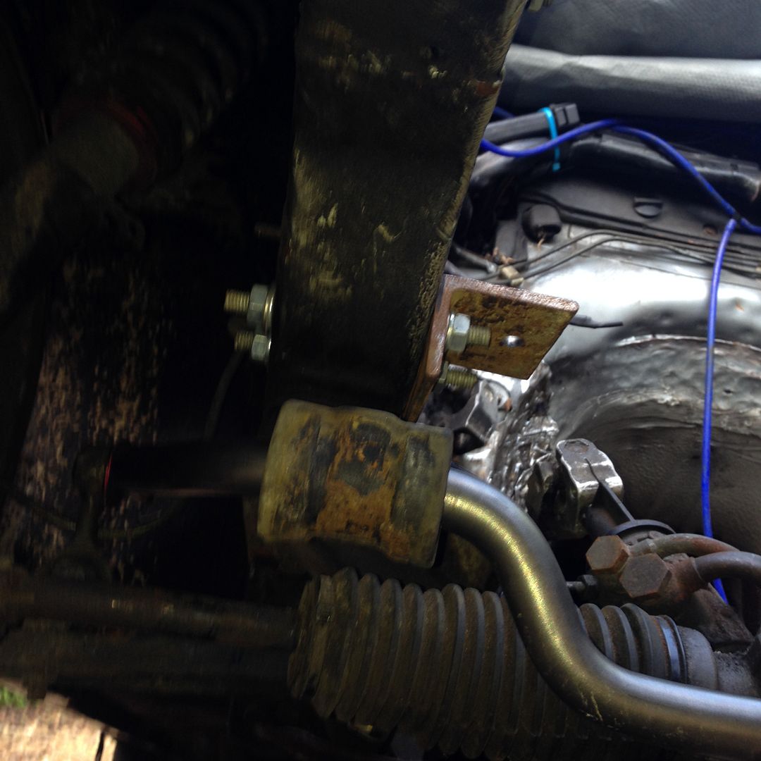

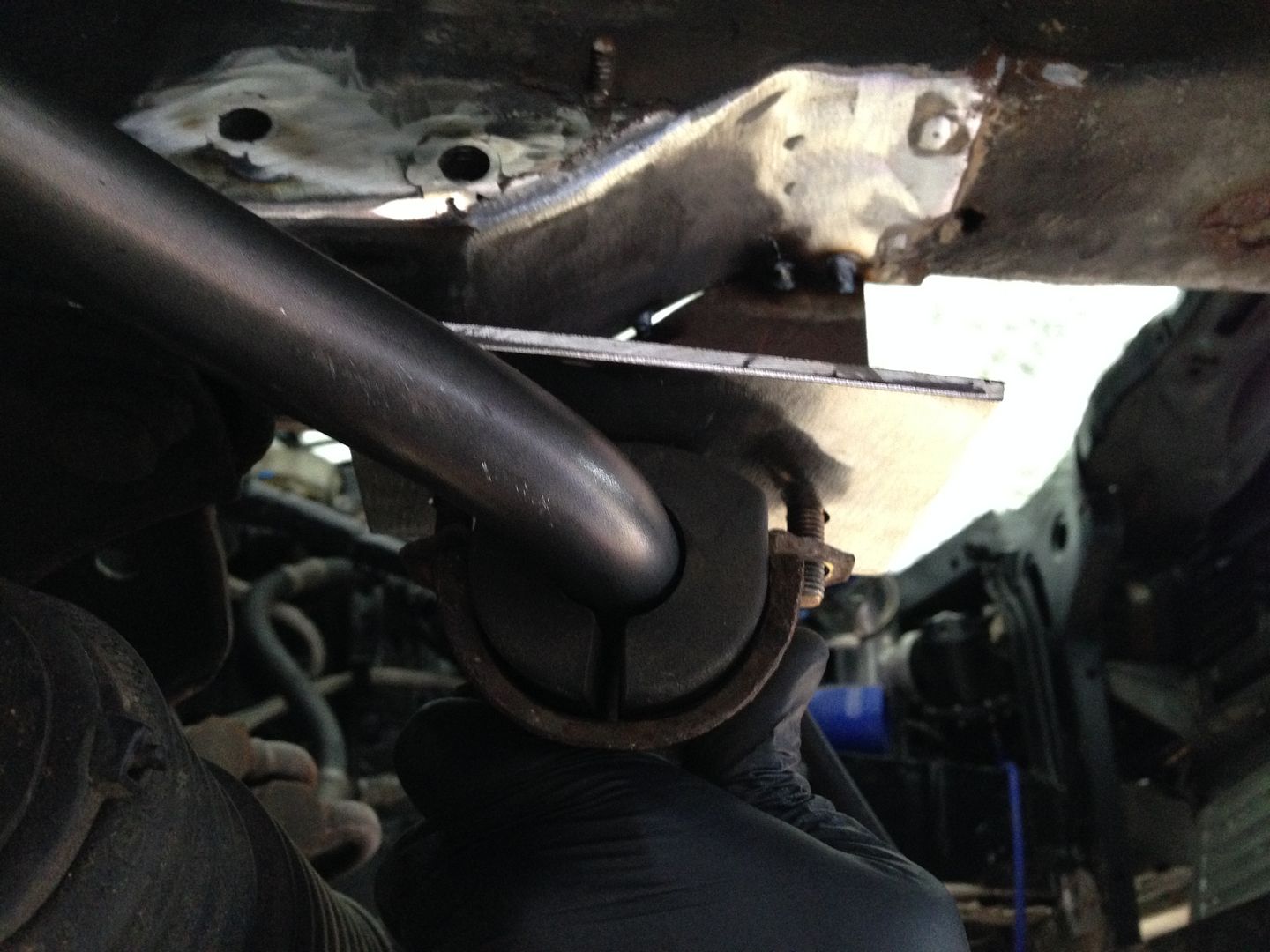

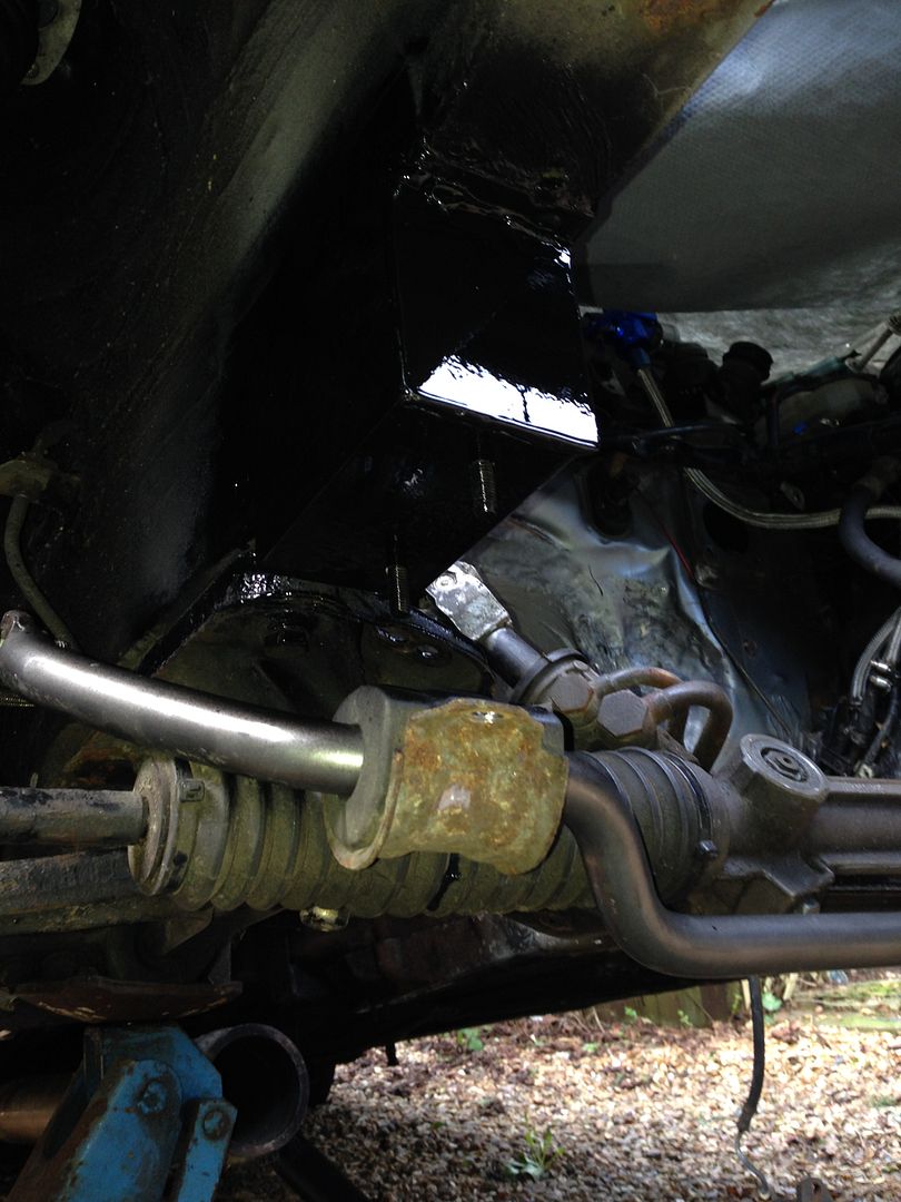

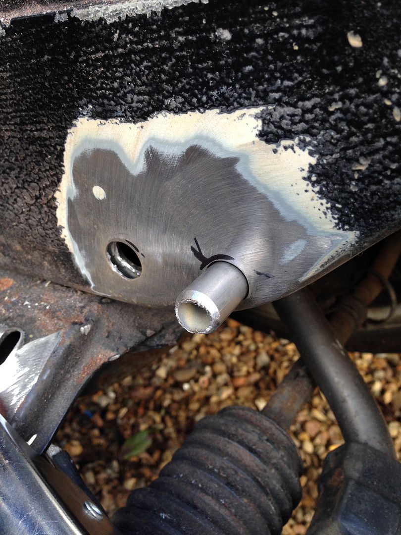

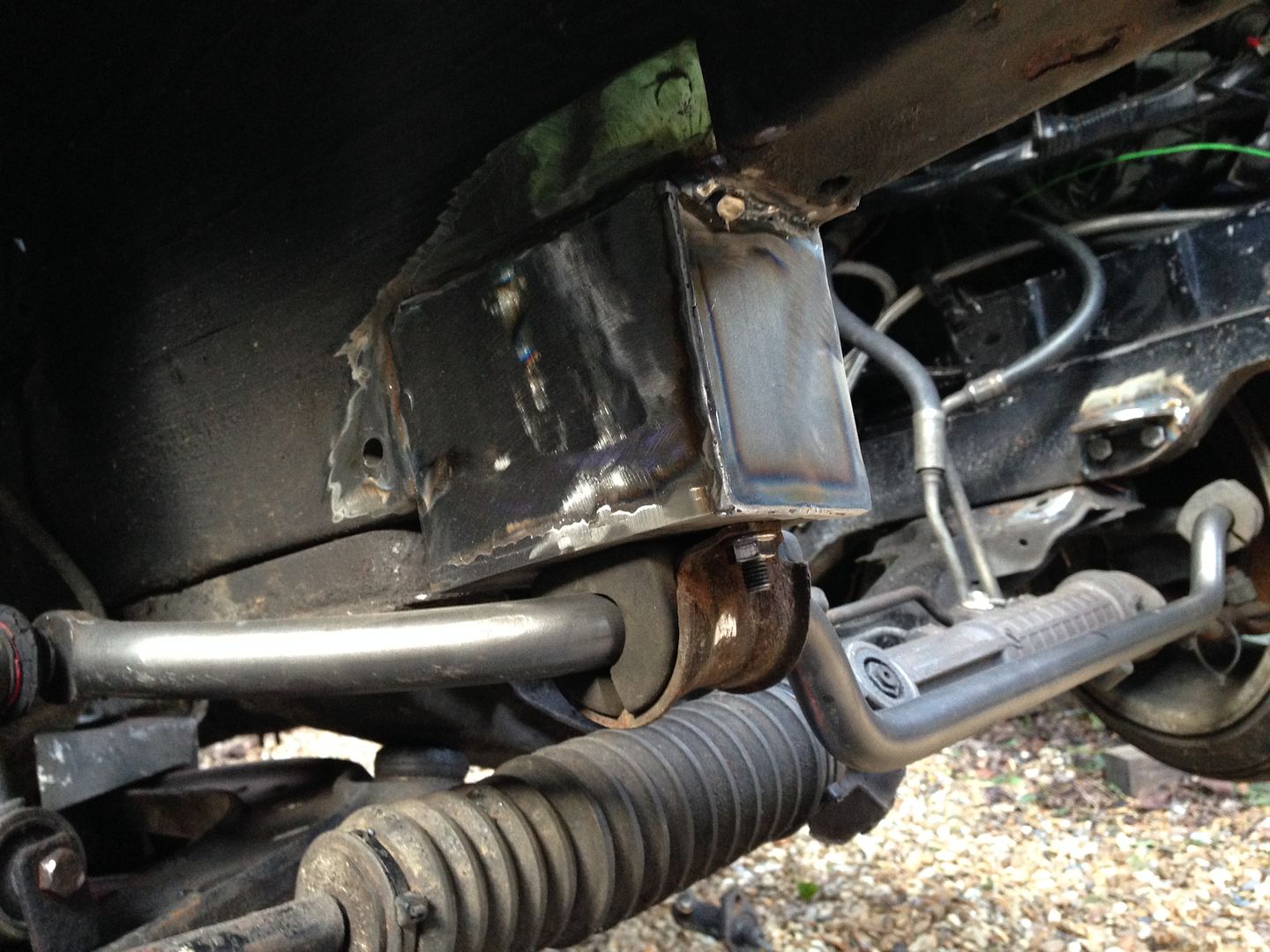

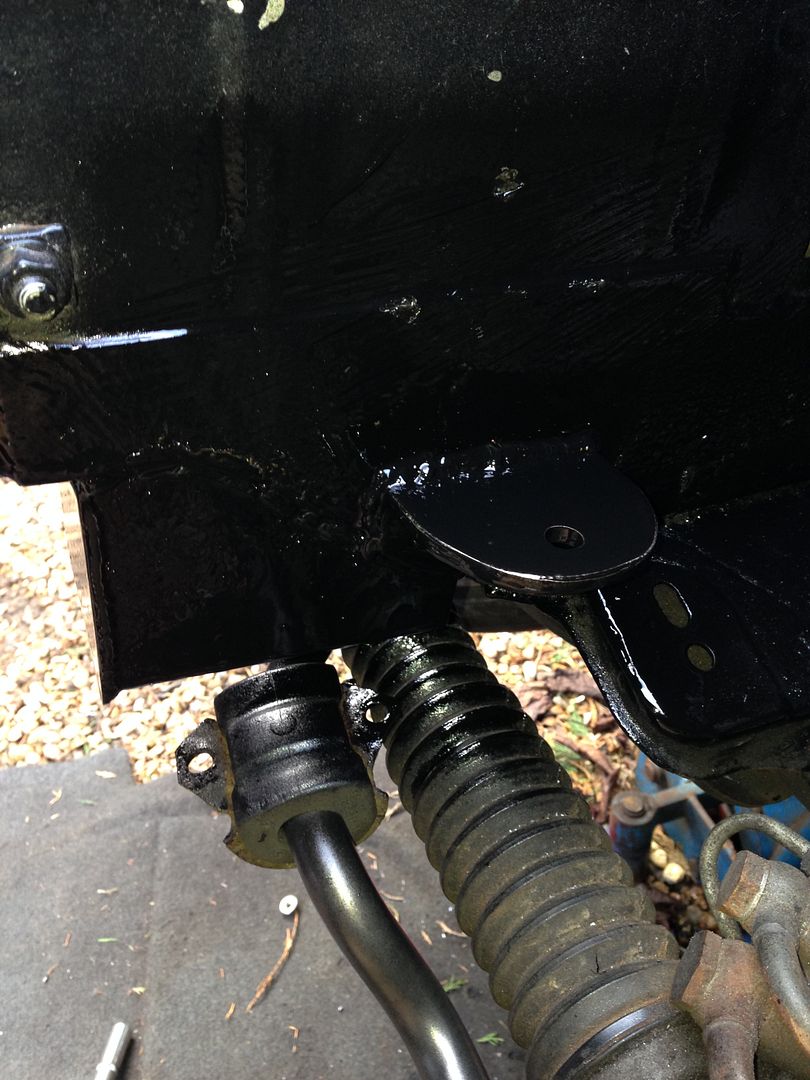

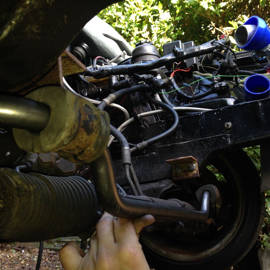

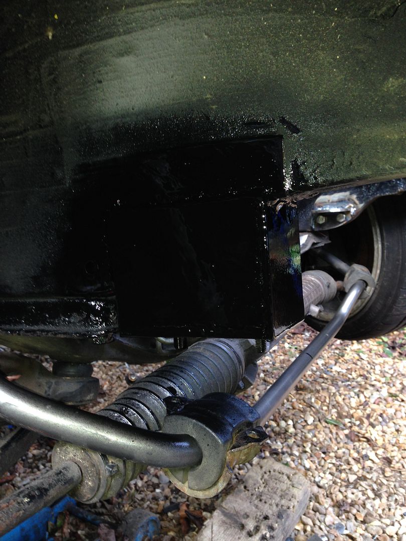

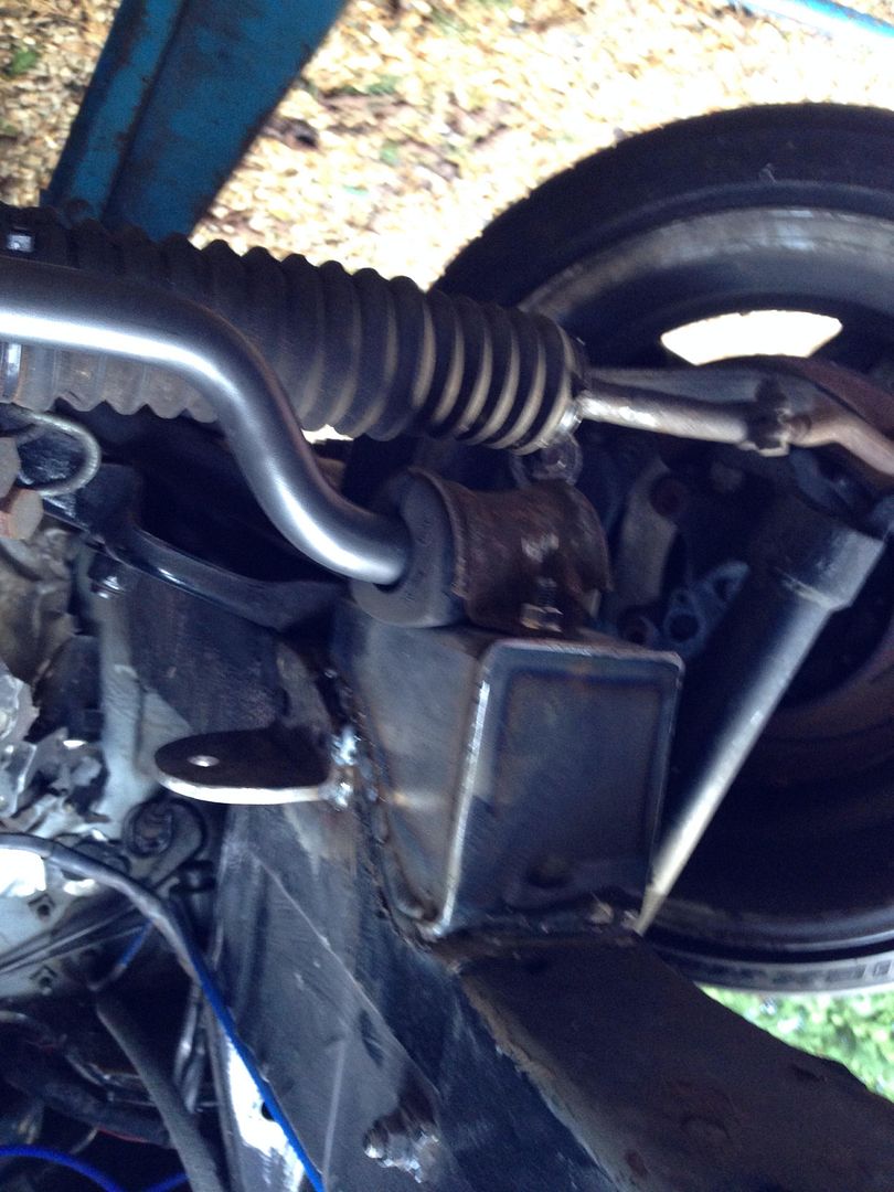

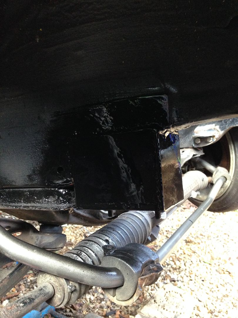

as you might have noticed on previous pics i took the anti roll bar out as there is no room for it behind the subframe due to this engine having a rear deep sump unlike the m20 which is at the front
so i thought and done some research the only thing that is some what near to a e30 is a e36 i looked at lots of pics of them and noticed they have a nice cranked down section to clear the sump but this still wasnt going to work on the rear as the cranked section hits the wishbones so theres only one other place for it
put it on the front........ of corse it will have to have some sort of mounting made for it but as you can see it fits pretty well
please ignor the bulk head
as ive found that the e36 arb is not as wide as the e30 not by much
the bushes dont quite line up with the chassis so im going to have to make some box mounts for the bushes to sit on but have them angled in slightly
but i cant see any reason why it wont work it doesnt fowl on anything so looking good to be

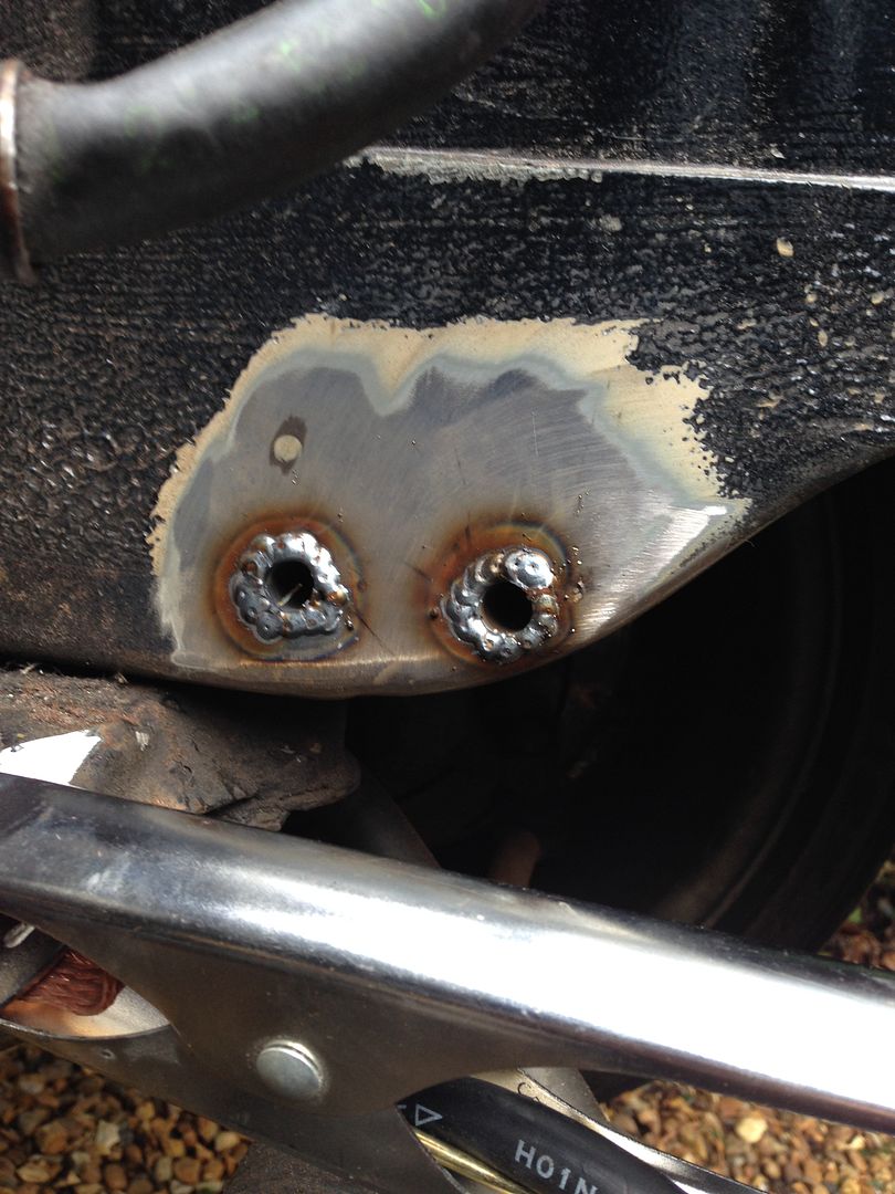

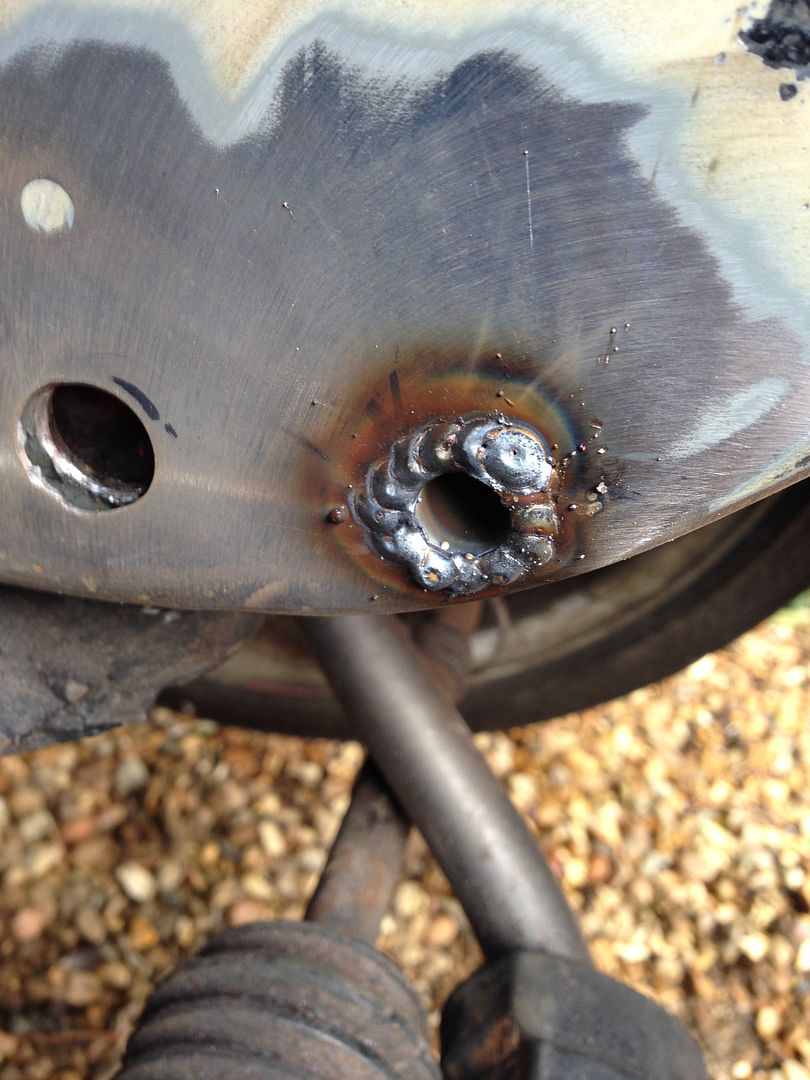

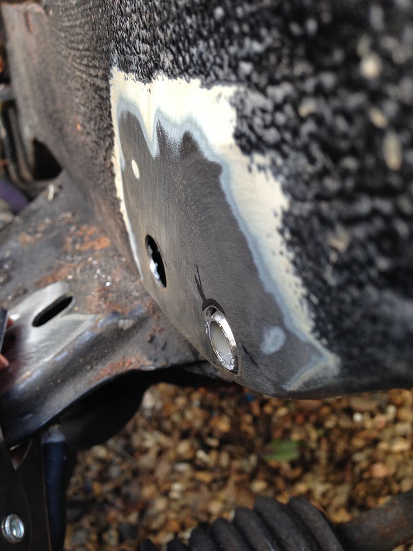

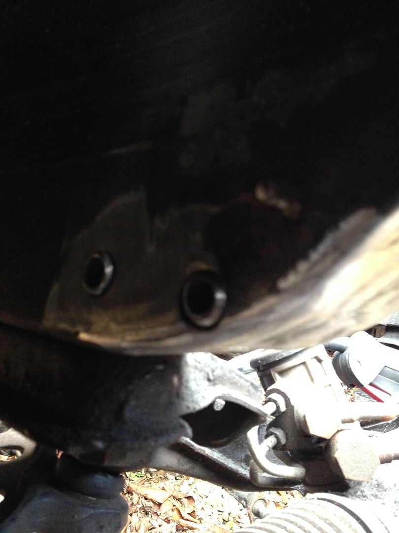

ive also took the engine mounts off and drilled the chassis alittle bigger as im going to weld 2 14mm tubes in the chassis for the bolts for a bit of strength other wise i could imagine the engine pulling them thro at some point and im also going to weld the mount to the chassis rail for abit more strength ive got the material on order so ill update this later in the week when thats done

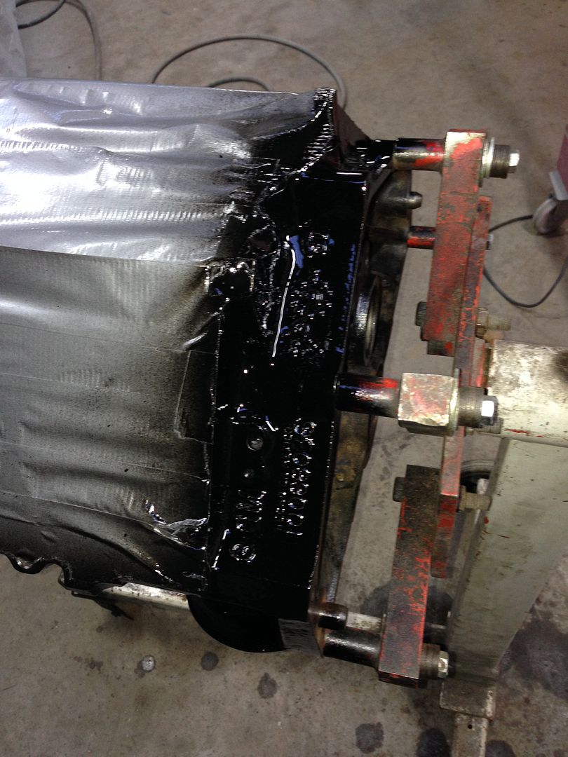

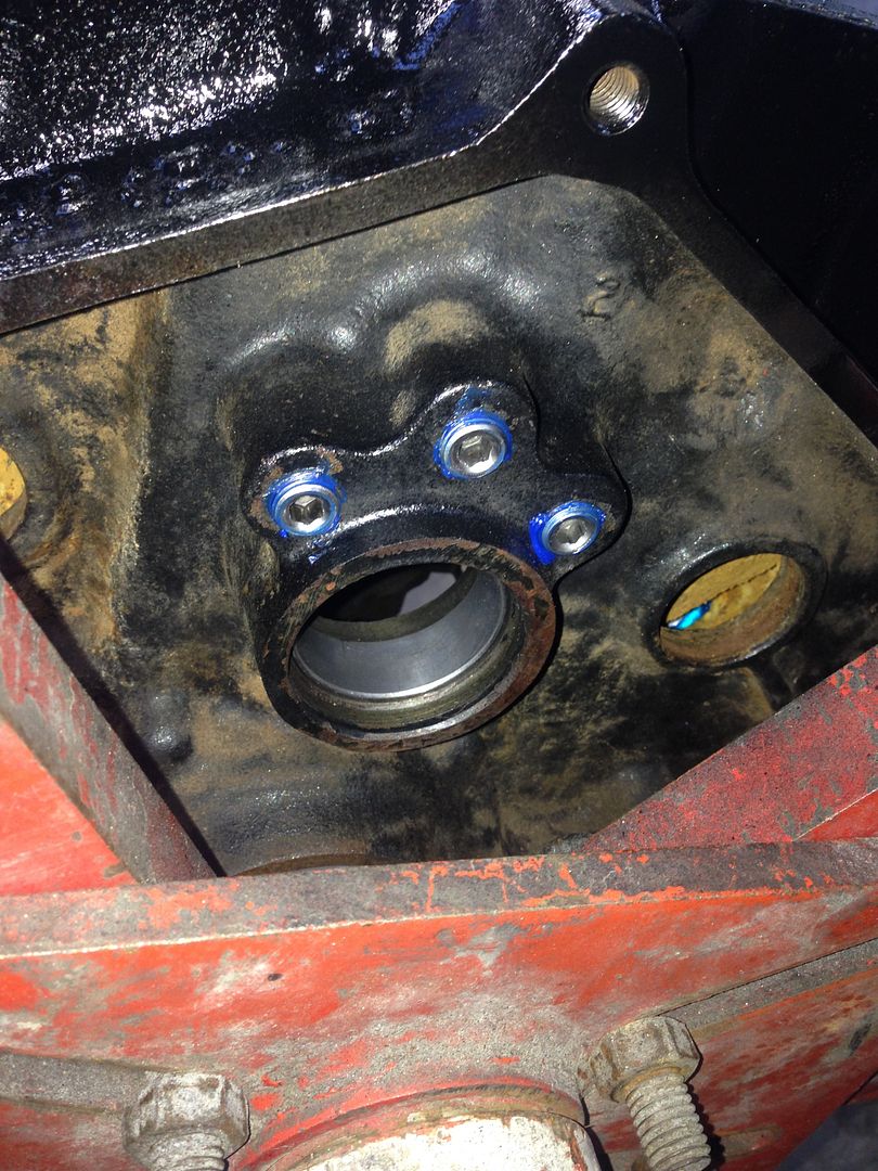

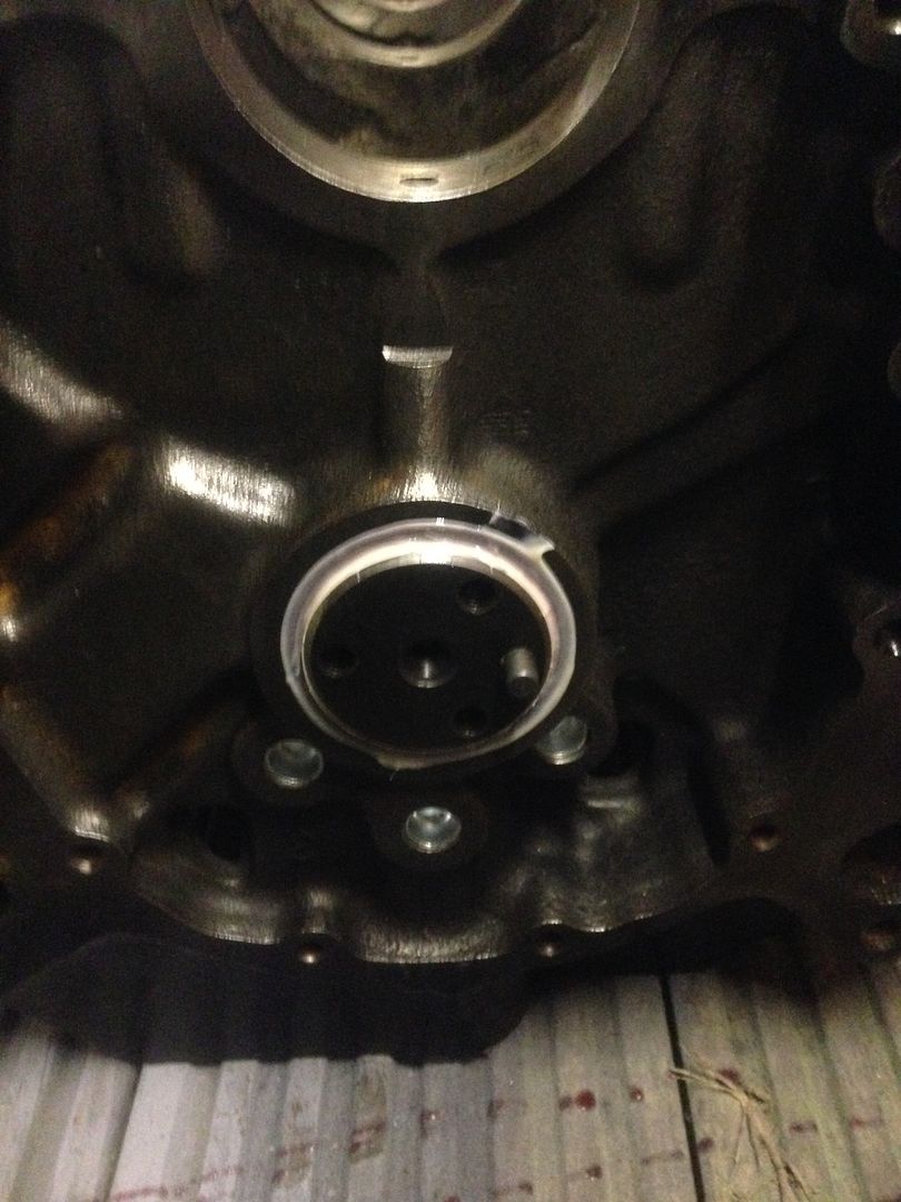

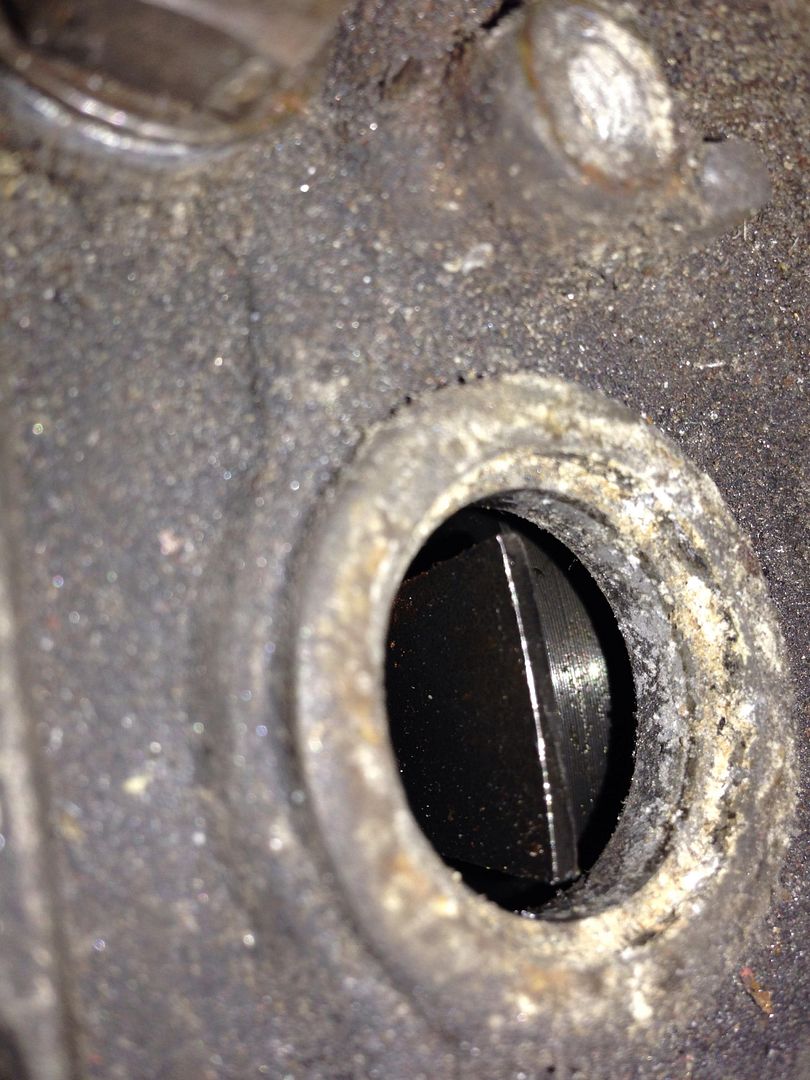

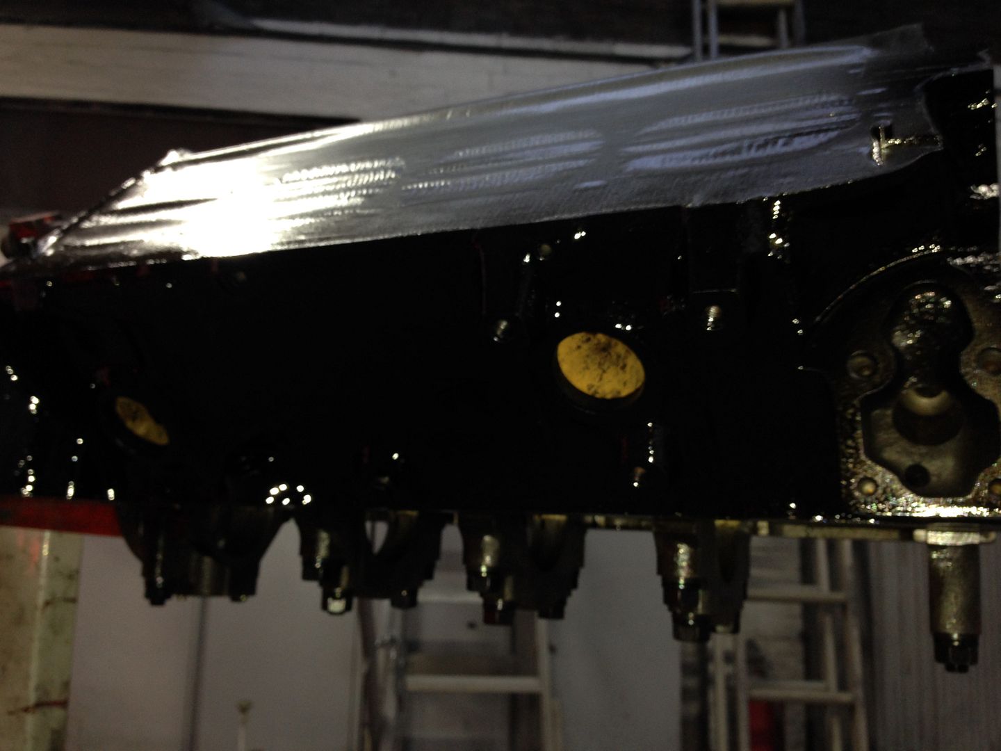

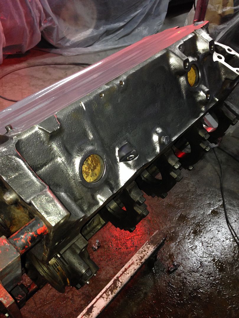

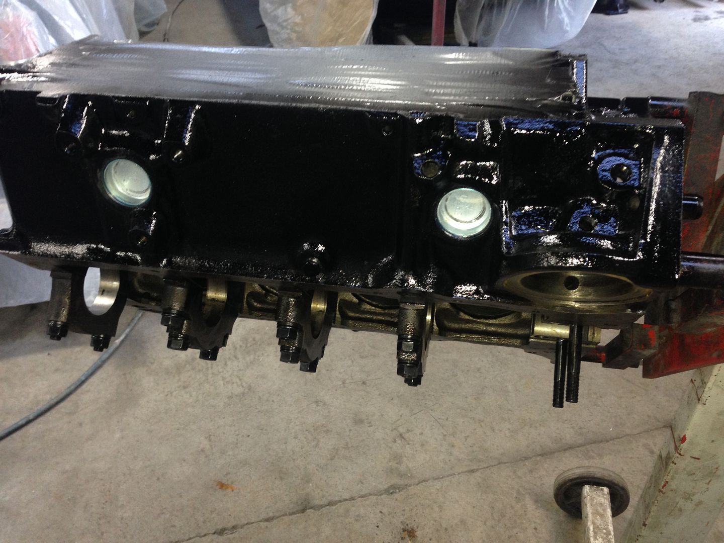

just a coulpe more bits i done today fitted freeze plugs and oil gallery plugs on the block after paint is dry
still have to fit the rear ones but cant do that till engine is off the stand

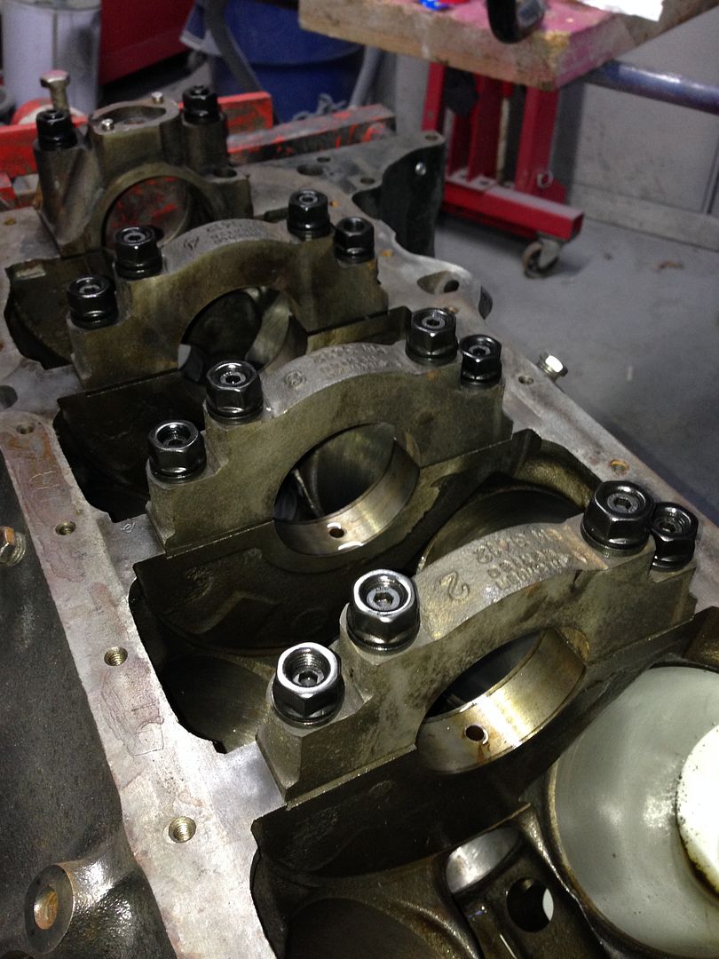

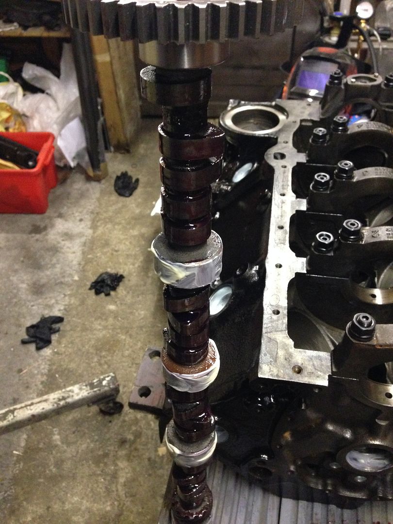

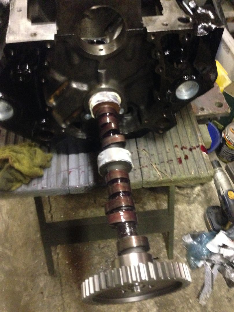

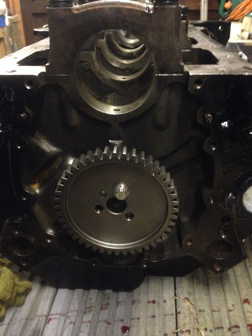

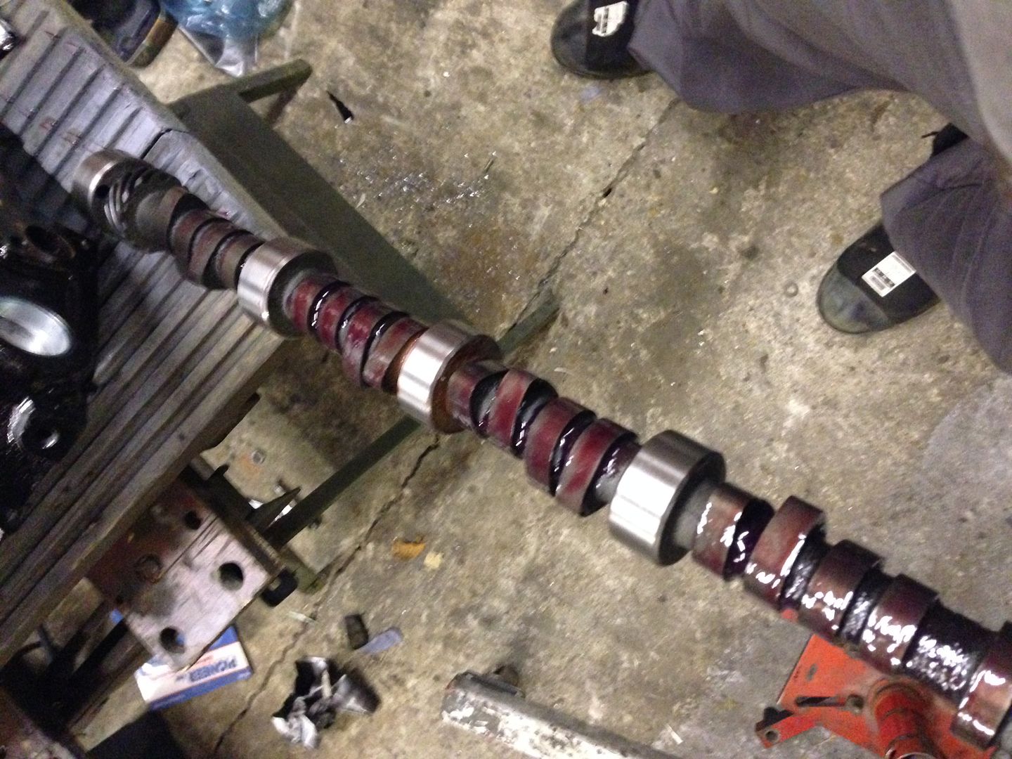

well got the rear core plugs in tonight
and fitted the cam I used the pulley to help fit it as it's something to hold onto while sliding it in
nice bit of lube
cam going in
and it's In
easy as that
nice bit of lube
cam going in
and it's In
easy as that

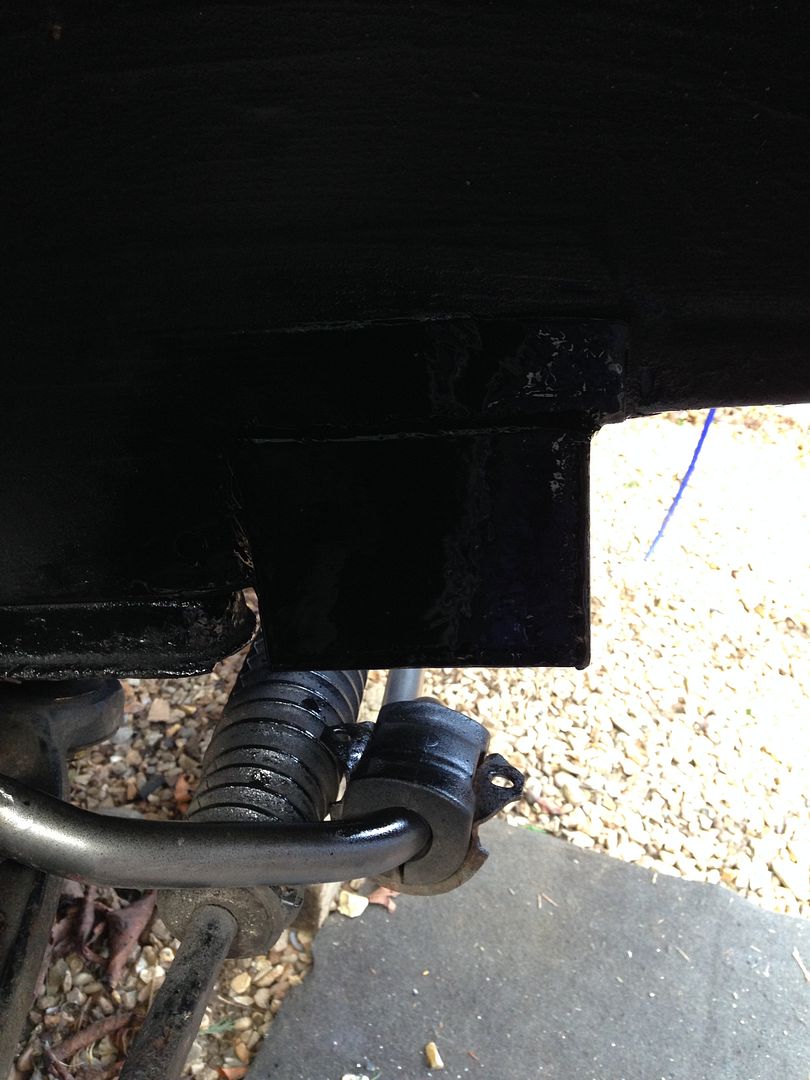

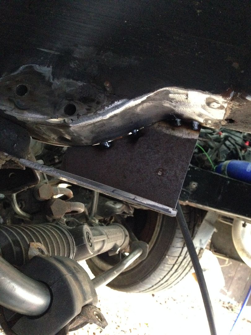

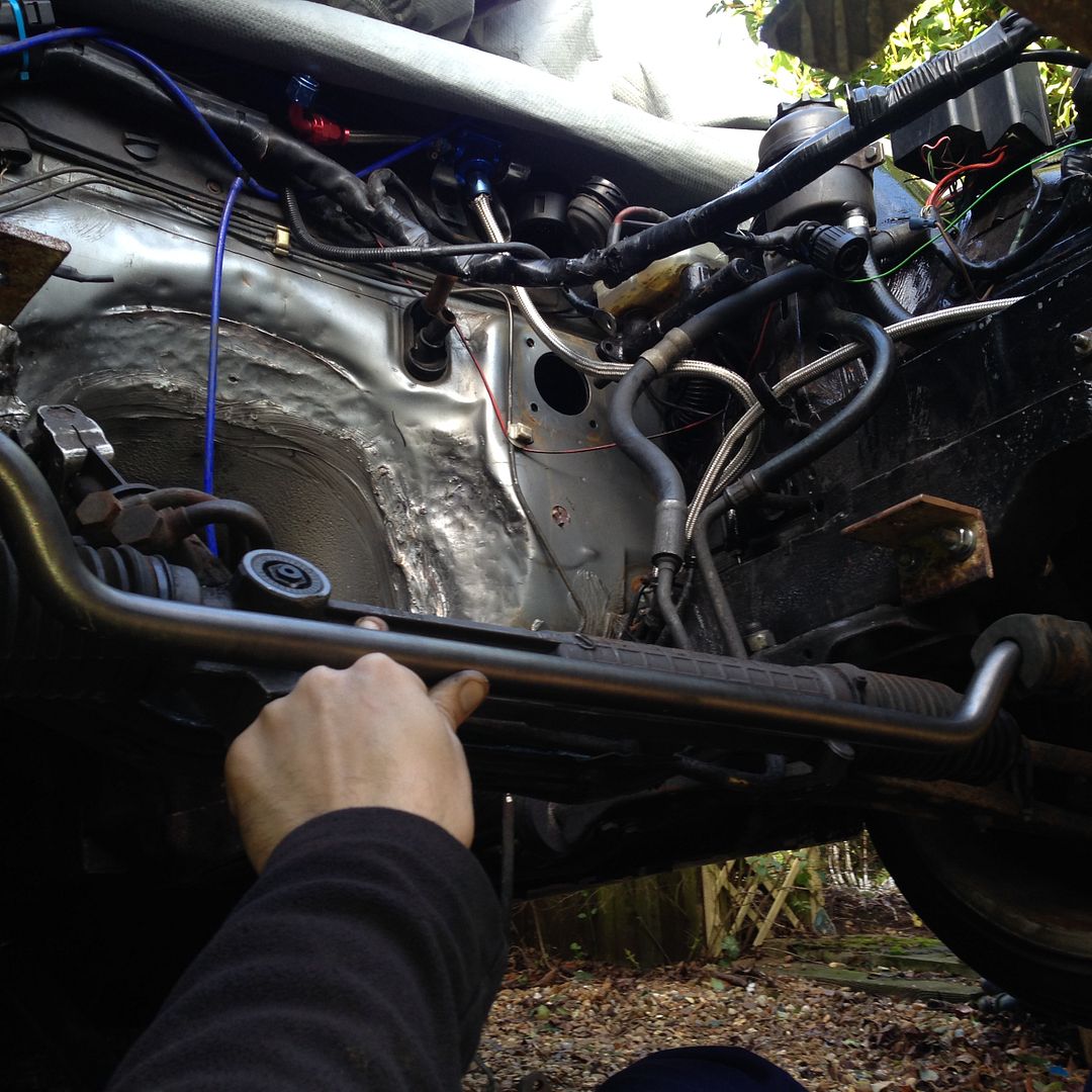

well although I've been feeling pretty bad this weekend I've dragged my self up the garage and done some work

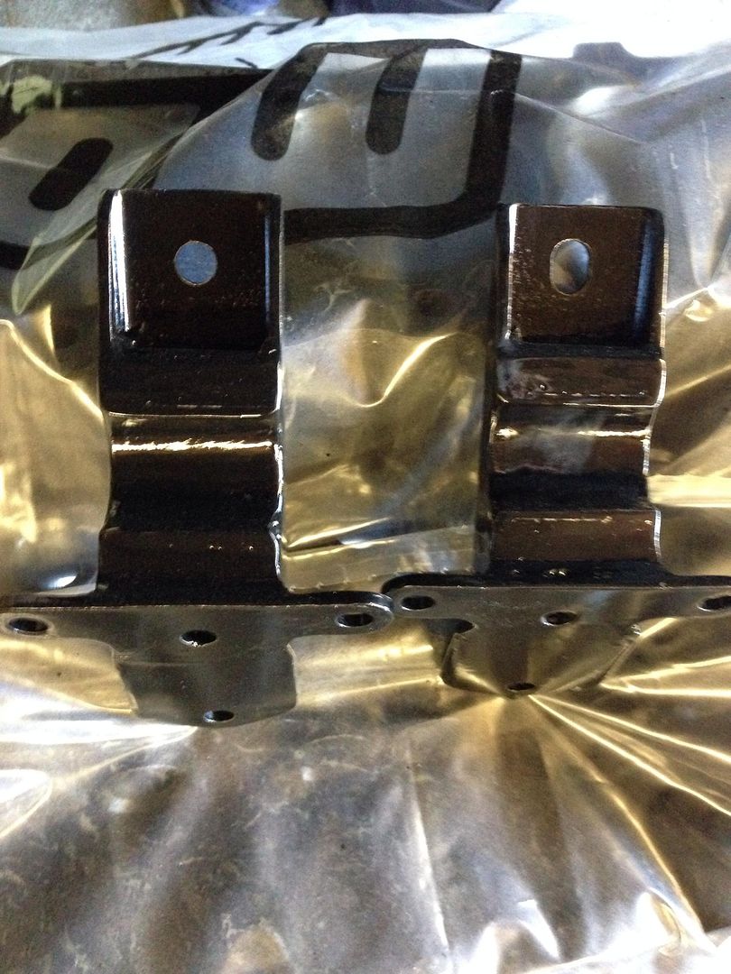

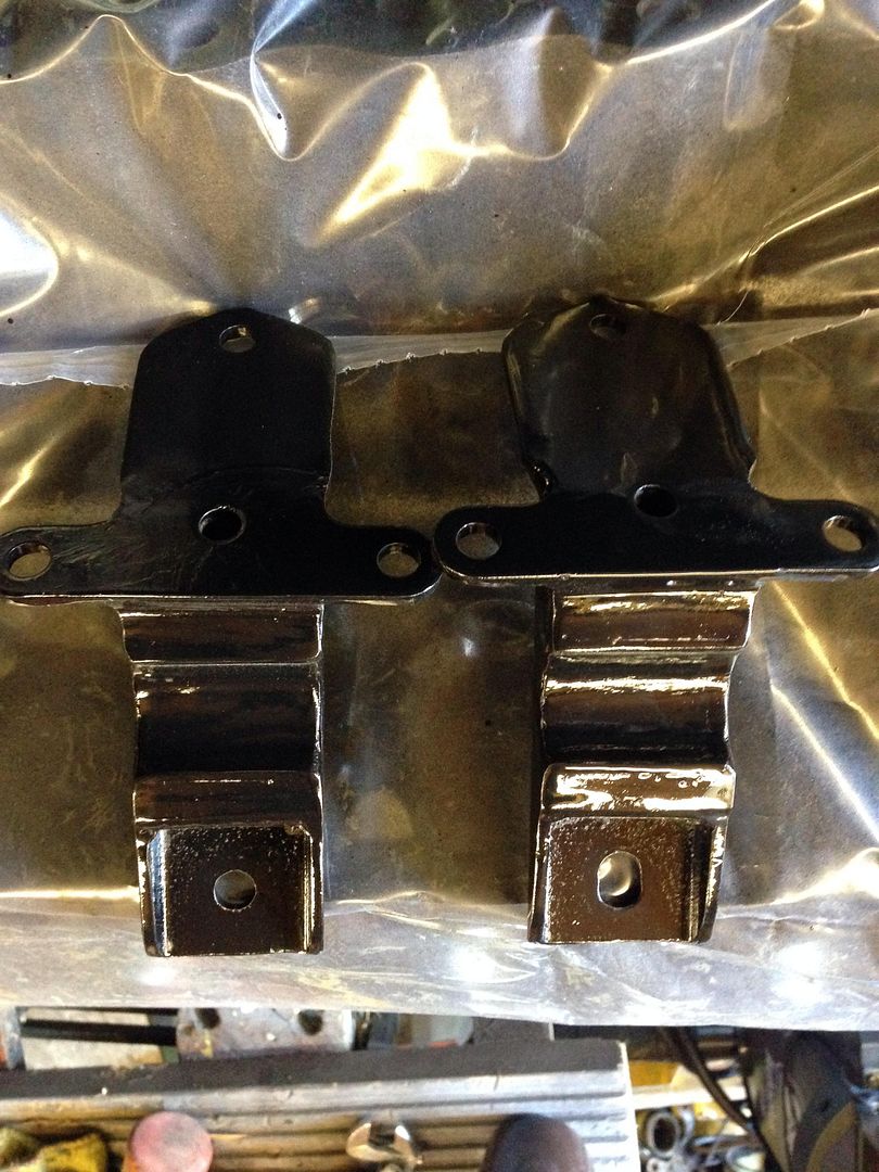

managed to get the chassis ready for the engine mounting points I've welded the tubing in the chassis to give it some strength
also got the engine mounts finished
also finished the new mountings for the e36 front anti roll bar fits quite nice

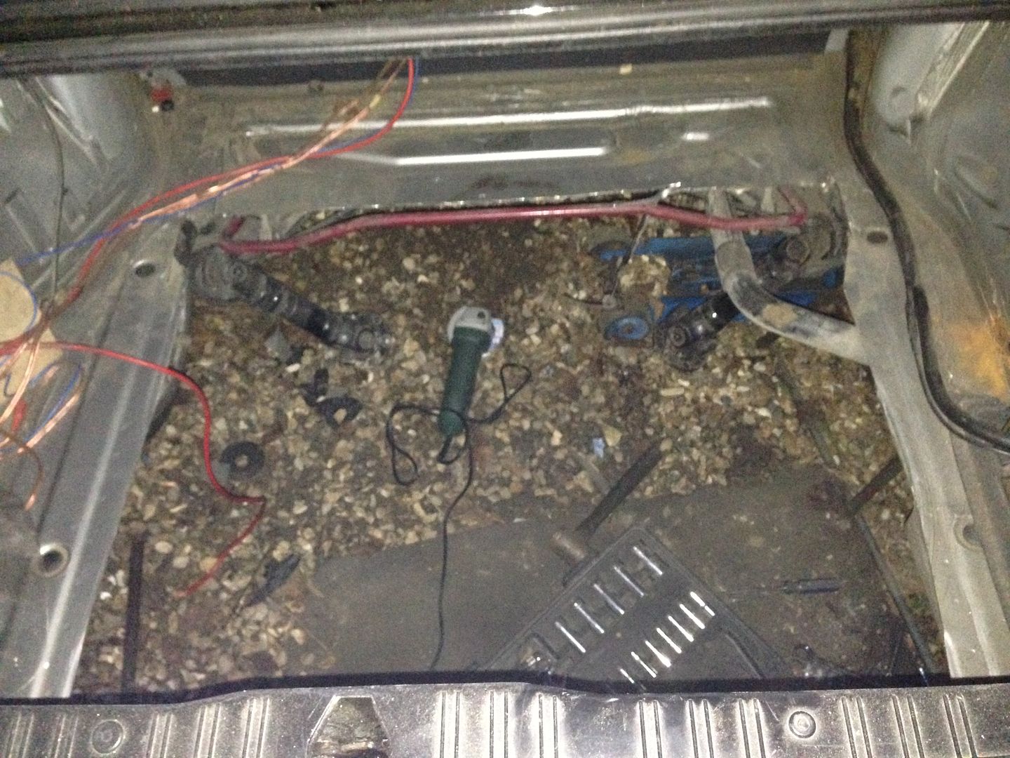

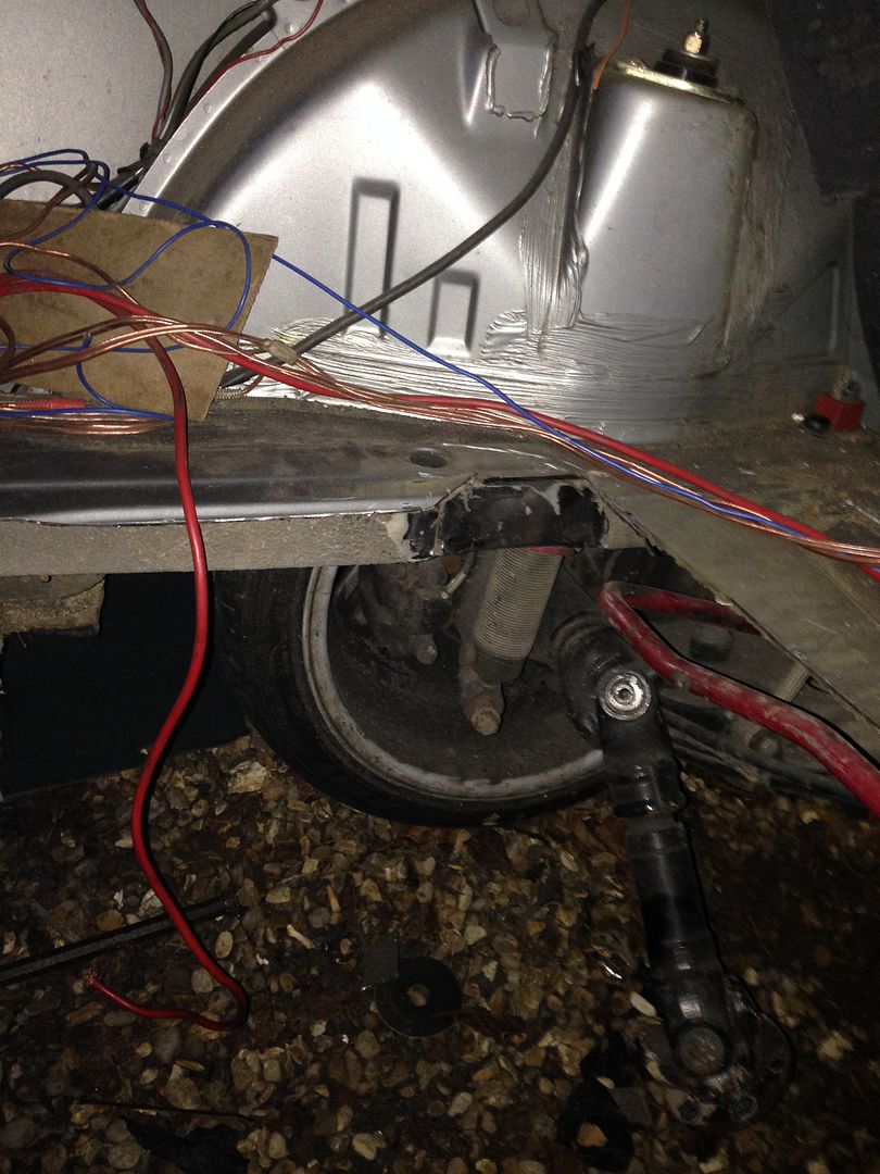

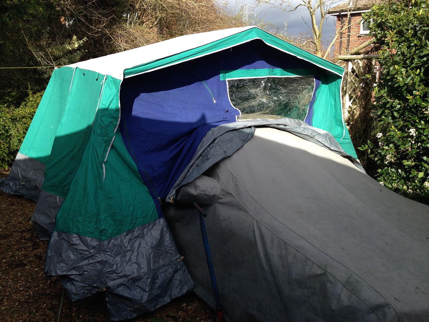

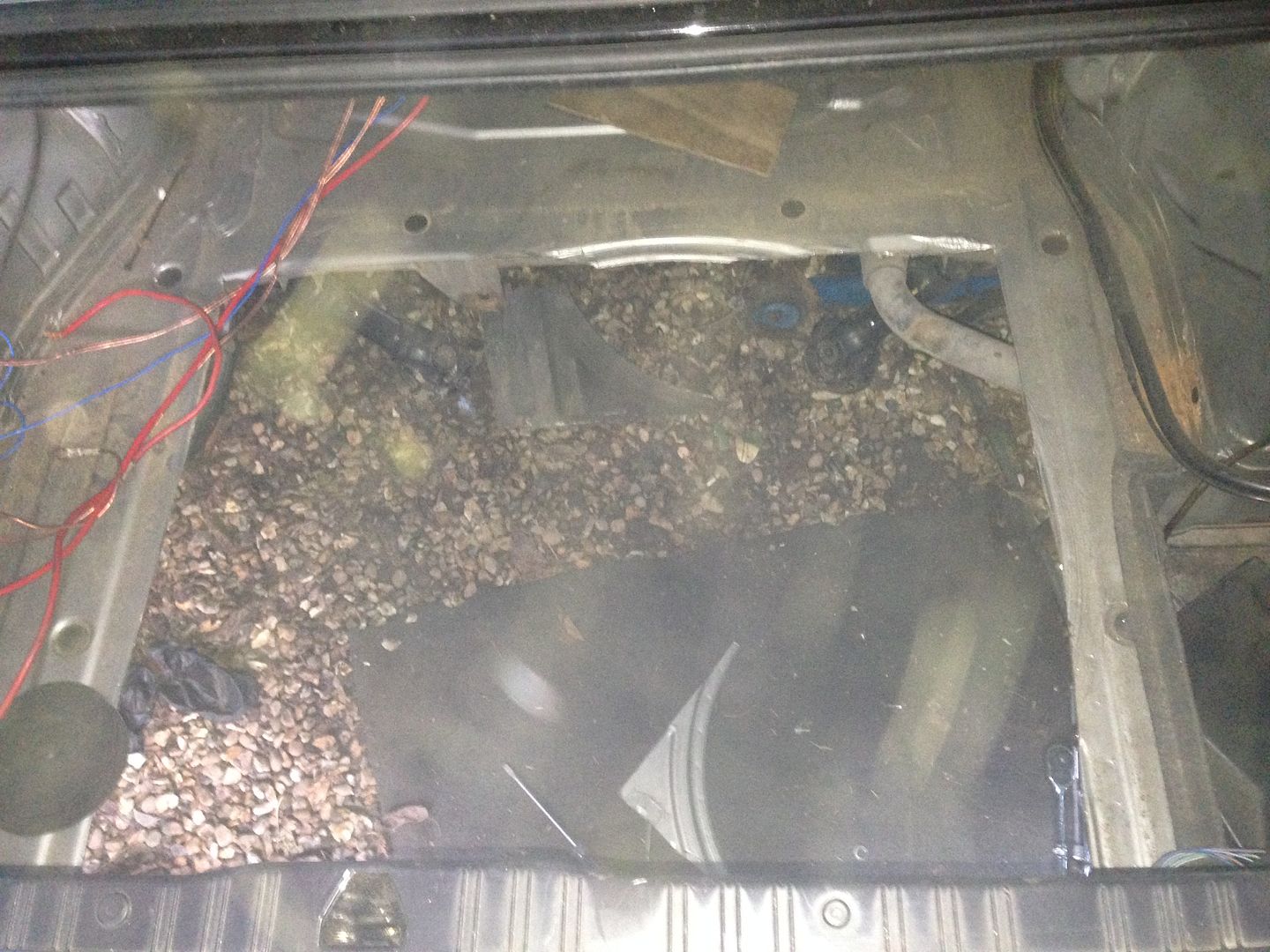

well seeing as i keep moaning about the rain i thought id do some thing about it ................ my solution

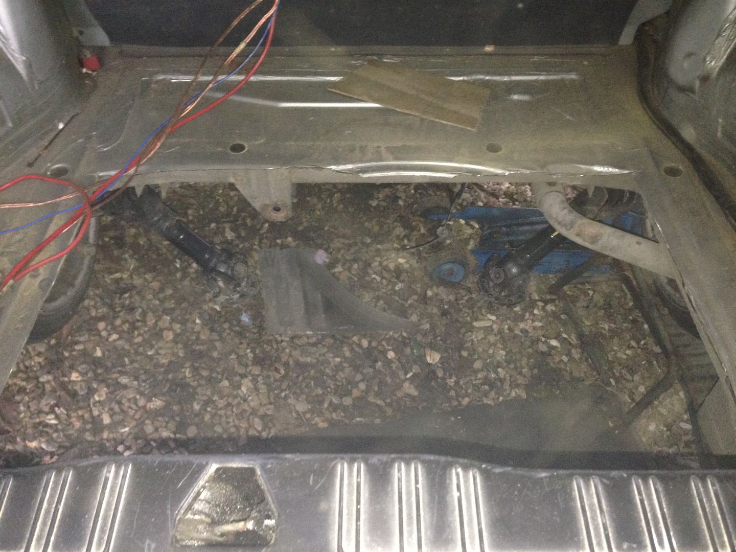

now as thats done and the front anti roll bar is all done i thought id start to tackle to rear first things first get the grinder out
no going bk now after undoing the drive shafts and taking the diff out i started to cut the rear cross member out that holds the diff cover
with the cross member out
and started to clean the pads up where the new cross member will be attached
but sods law i ran out of gas for the welder so will have to wait till monday now to get some more
im going to fit the new diff first to get the correct postion for the cross memeber first them the whole rear beam will come out and be swapped for my new one
more fun and games

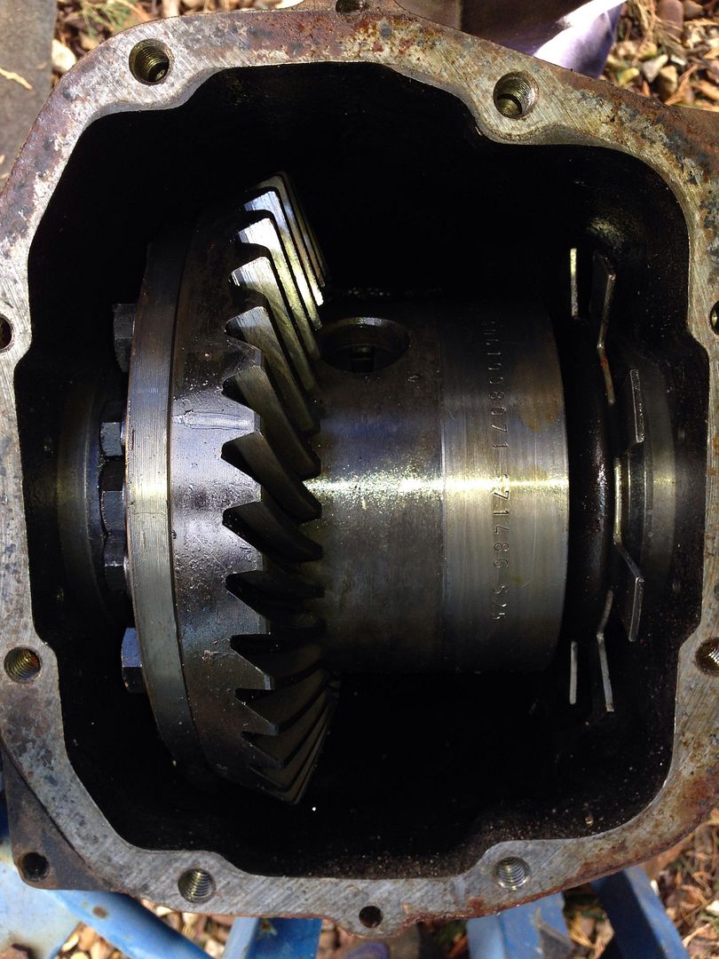

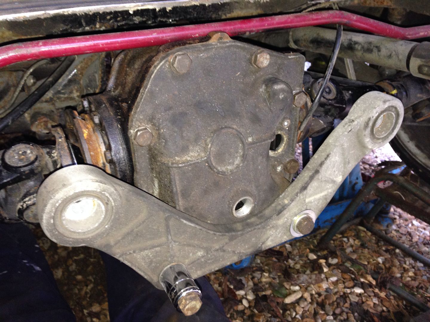

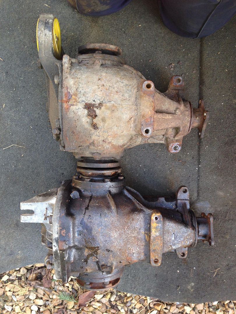

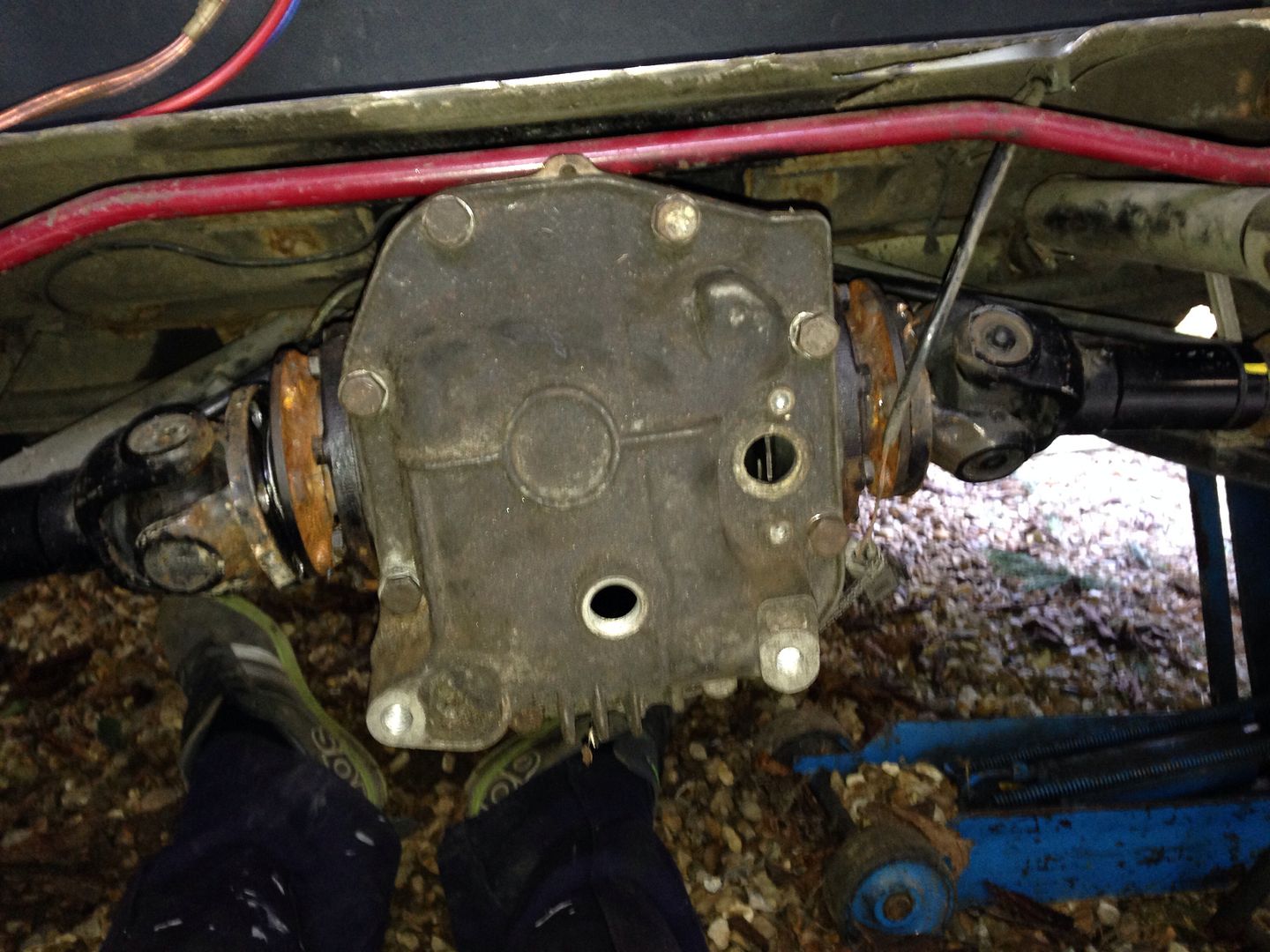

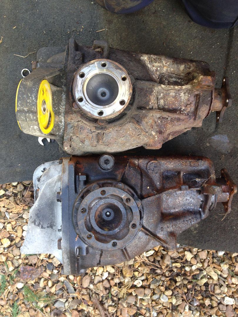

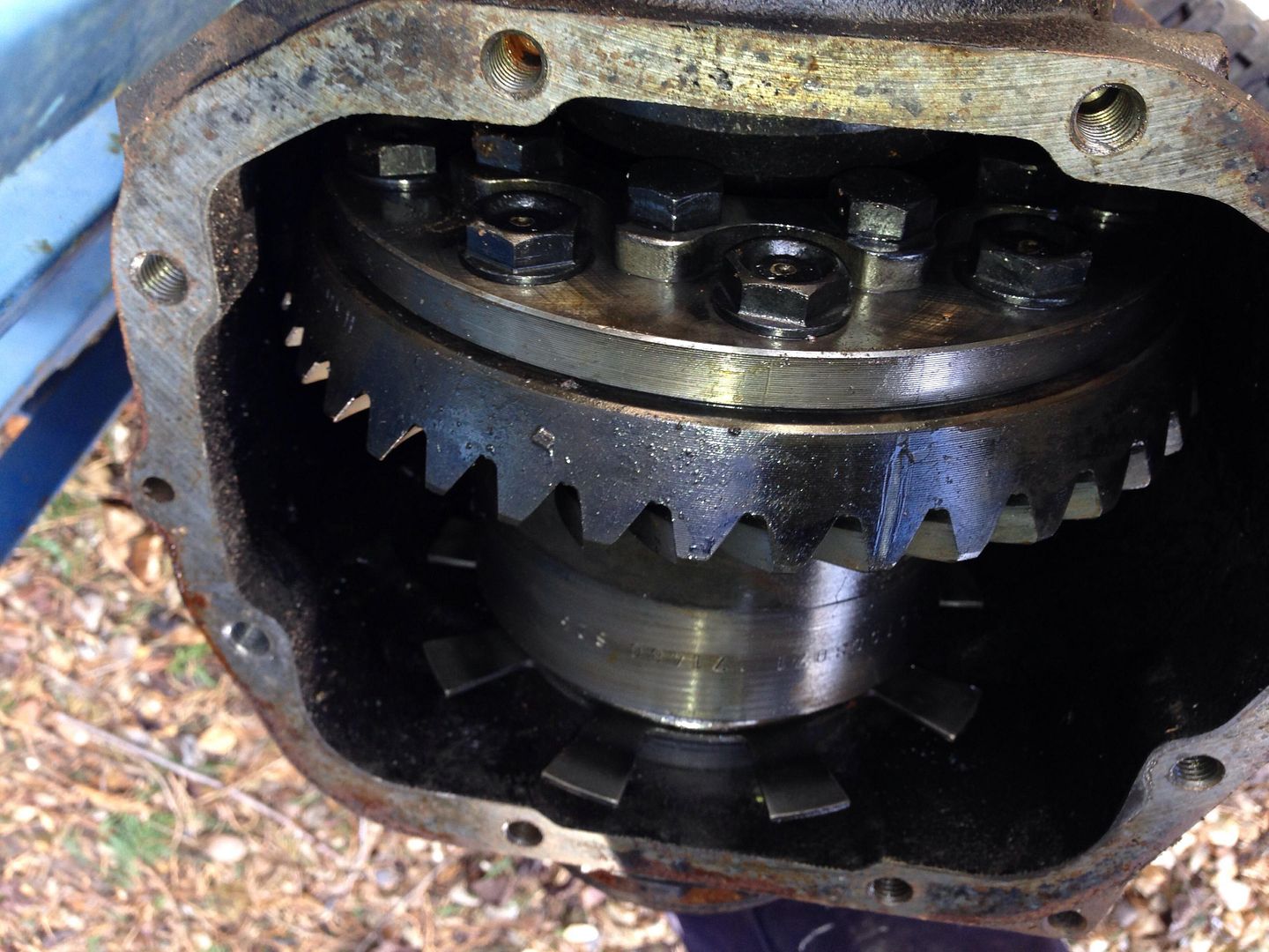

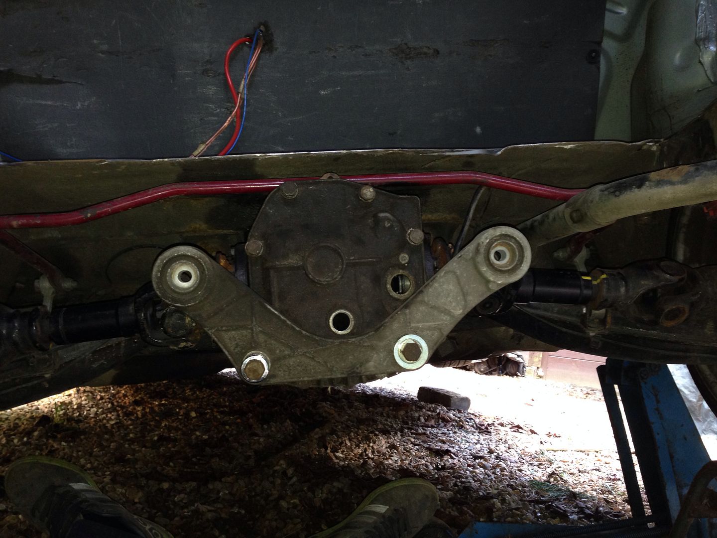

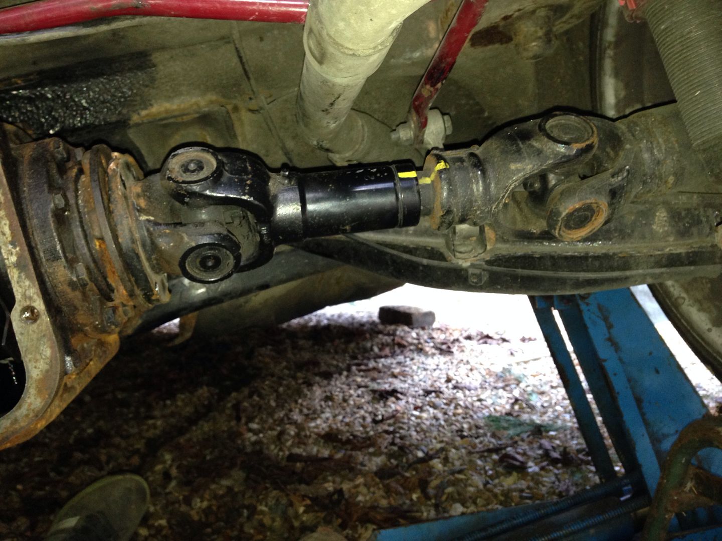

continuing from yesterday i got the new diff in its all mock up at the mo so it will all come back out and be done properly at a later date but here the beast in question
one on the left is the medum case one on the right is a large case from a e28 m5 3.07 ratio lsd
this is a big lump i can tell ya

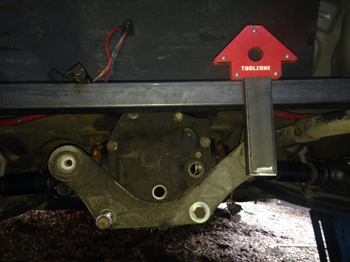

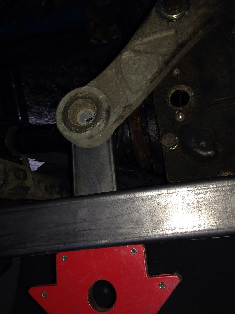

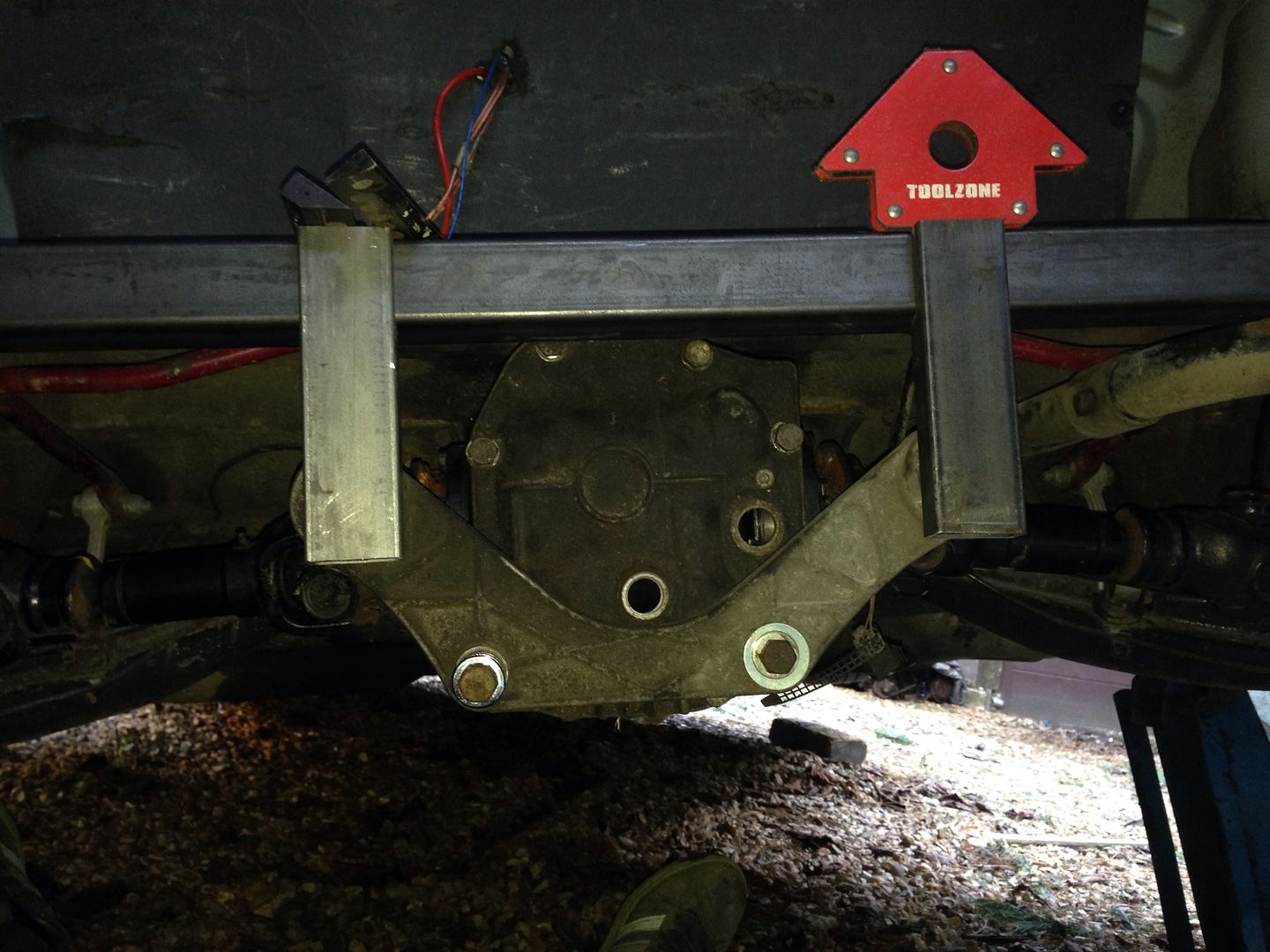

well got it bolted up to the exsisting beam to start with so i can get the new cross member mocked up before i take it all out
and like normal ran into the first problem not thinking that my great idea of using a rear cover from a 750i wouldnt work it dont shit
well saying it dont, it fits, bolts straight on crown wheel is fine but the speed sensor fins are too big where the speed sensor slots in,on the new cover its machined flush with the bolt face,on the original cover the hole for the speed sensor is pulled bk by about 10 mm so it looks like this when bolted on
so what to do i could cut out the old location on the old cover and get it welded in but that would just make a mess so ive decided im going to make a 10mm spacer to pull the whole cover bk 10mm out of a sheet of ali so cant do much more on that till the material arrives
anyway that still didnt stop me cutting things ready for when its sorted
no more commentry ill let ya just look at the pics
im still debating on wether to put the drop links behind the cover or in front
