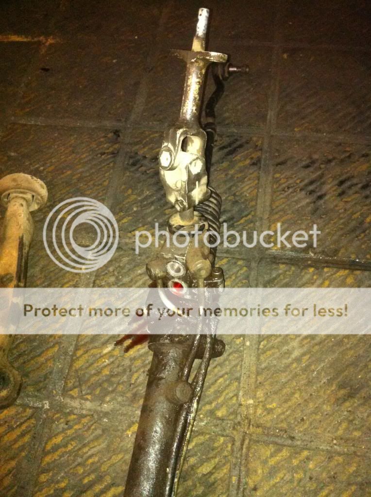

Putting up a few pictures. They are mostly about all the things that have gone wrong (almost everything

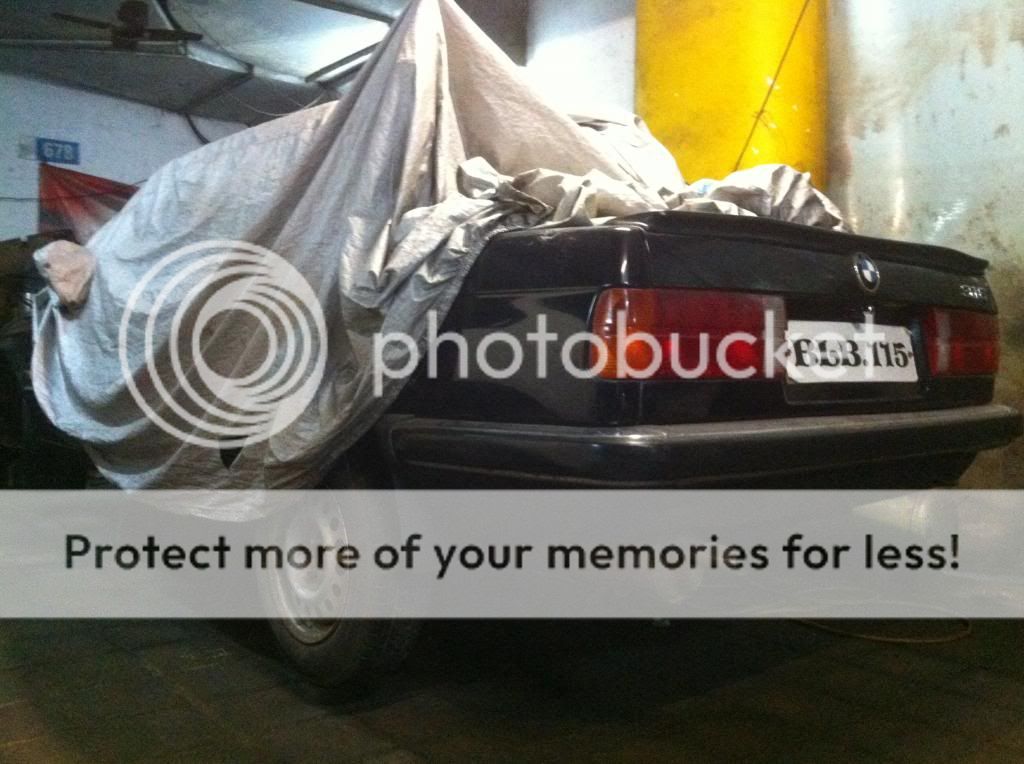

Bought it on 2nd April 2013 and the last few months have been spent poring over various rebuilds, asking questions, and collating as much info as I can cram in a short span of time.
After about 15 days of careful driving, the last 2 months it is on stands awaiting parts.

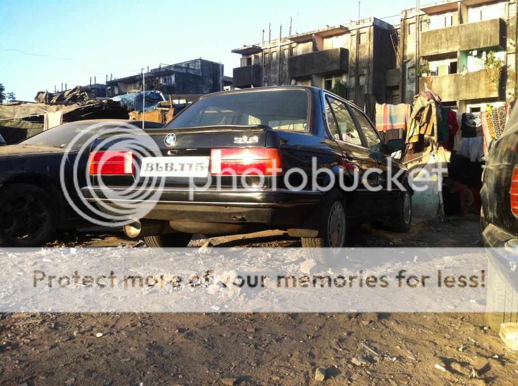

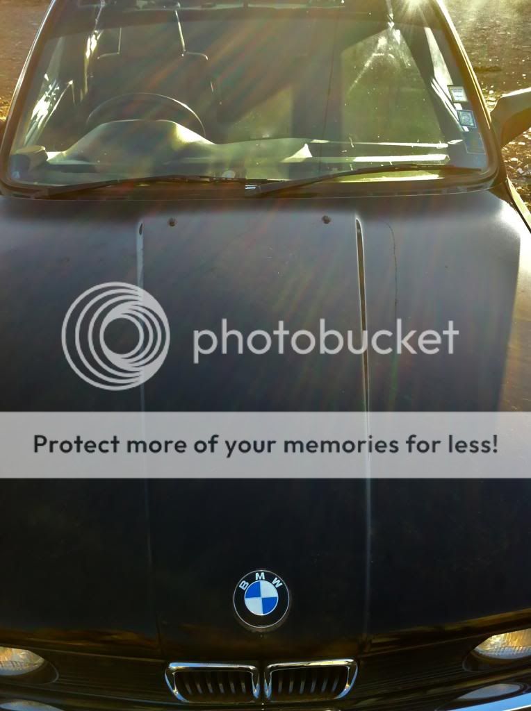

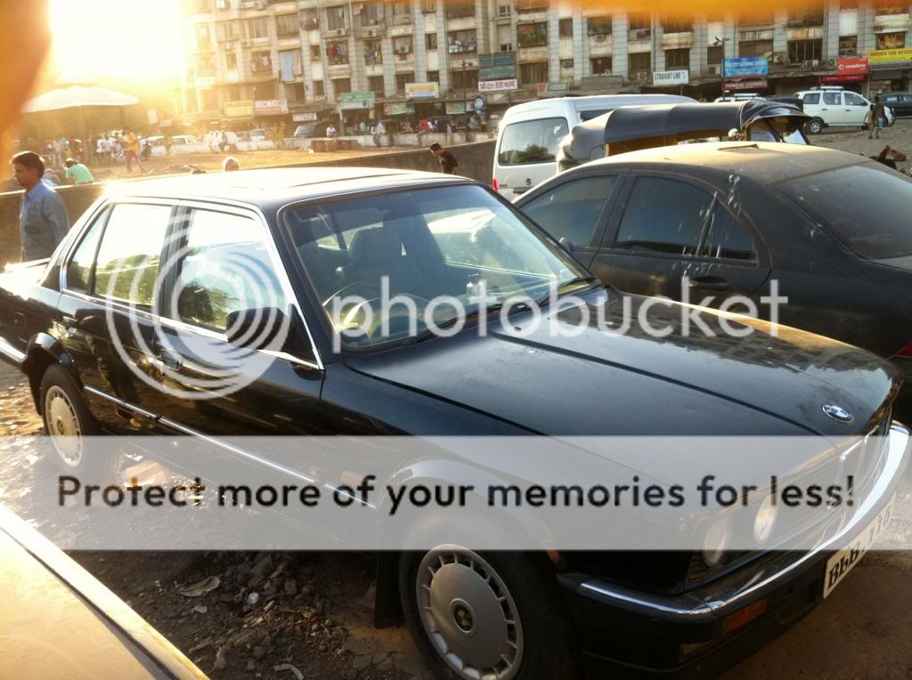

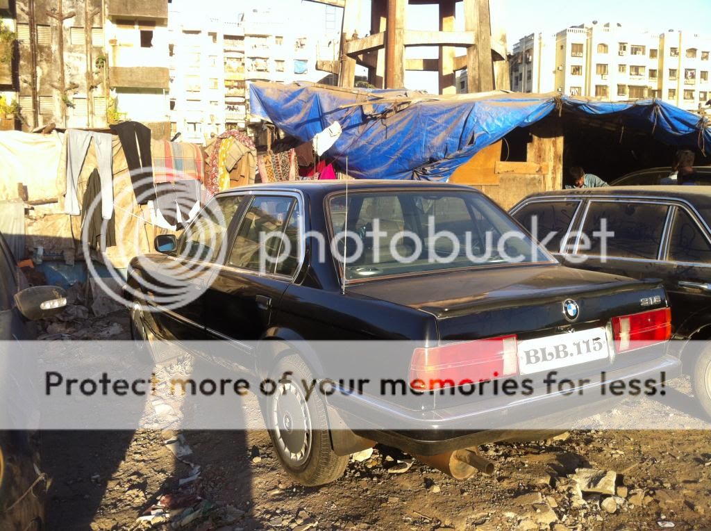

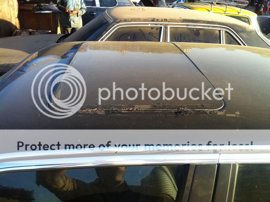

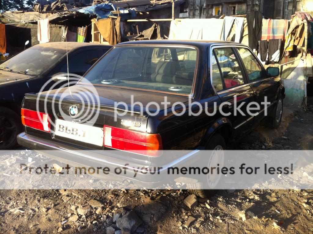

As I found it, in a dump, literally. Seeing its condition, not surprising.
A few other pics:

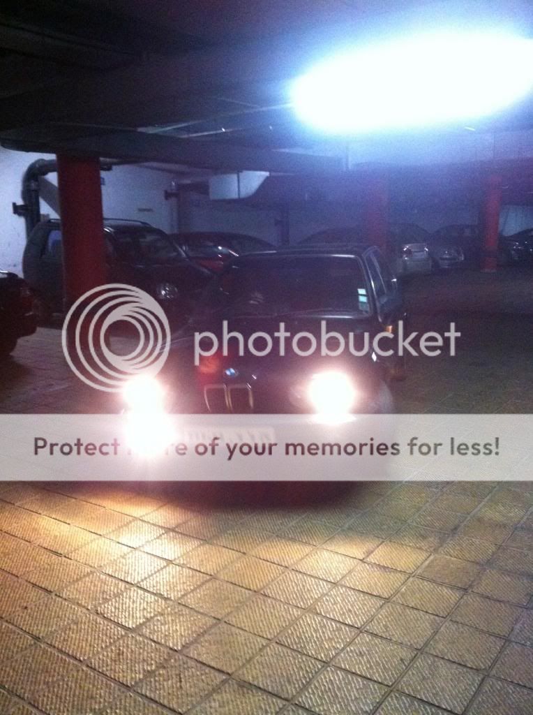

Drove it home after closing the deal and getting it registered to my name:

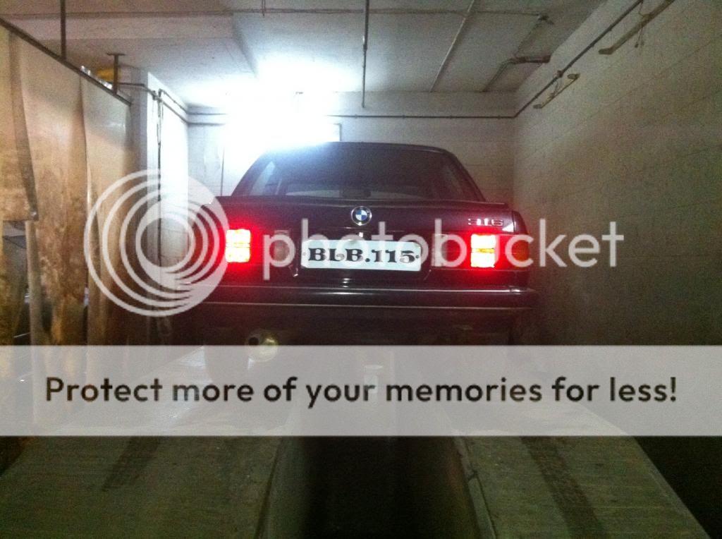

And then to my garage to get it on the ramp for an inspection.
Yes, I checked it after I bought it.

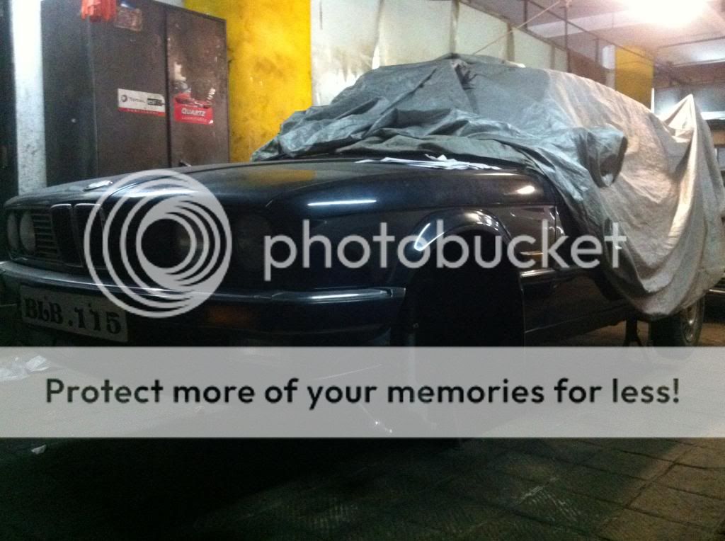

Up it went on stands

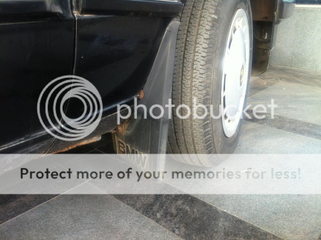

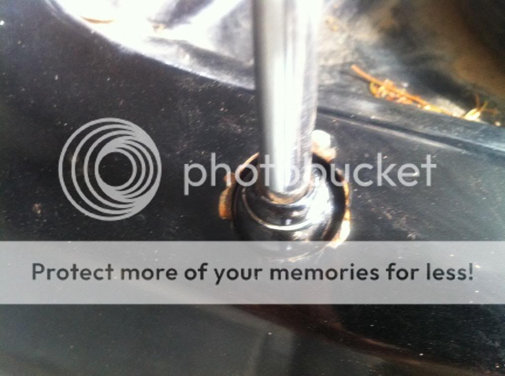

Flaps: but didn't get any. The right bottom is the mother-load of rust. Fist sized or more.

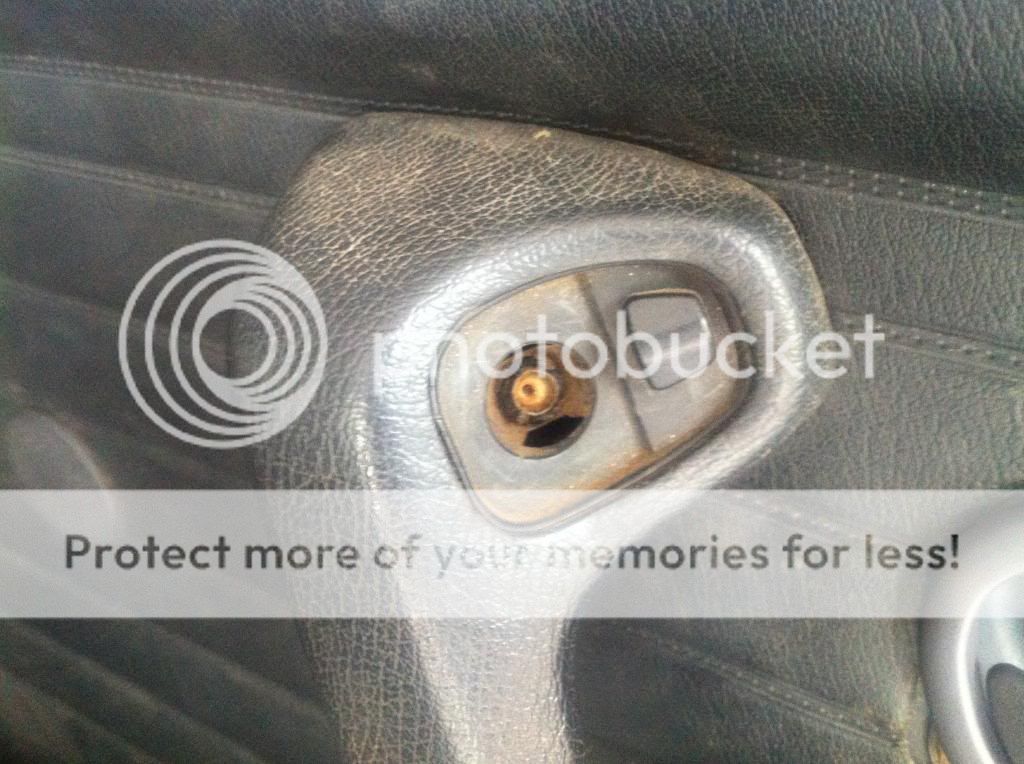

The handle and the electric mirror switch

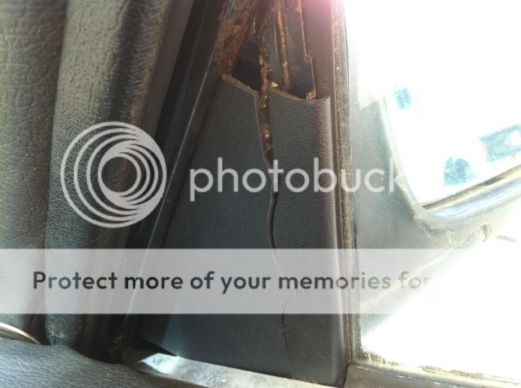

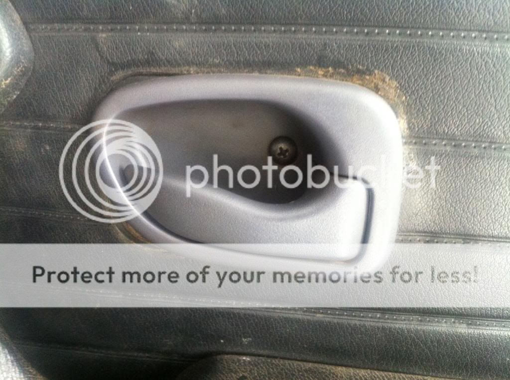

Original door latches instead of the Hyundai Santro stuff:
Rubber surround for the window, above the door card.

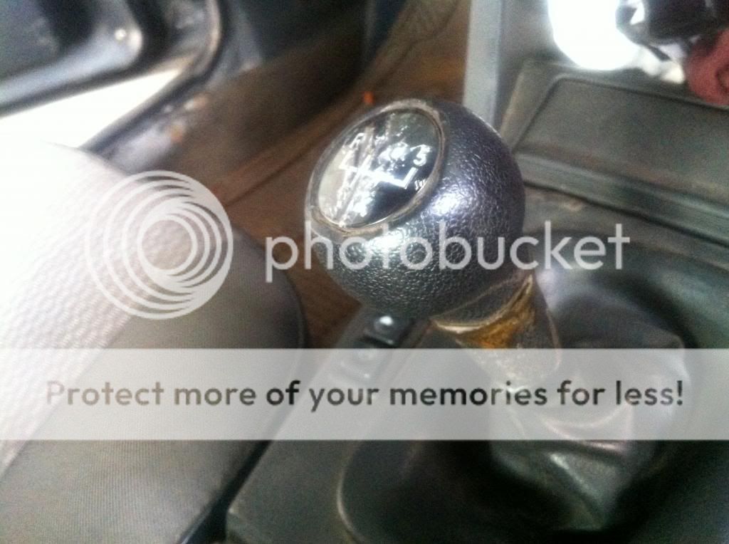

Cracked old gear knob:

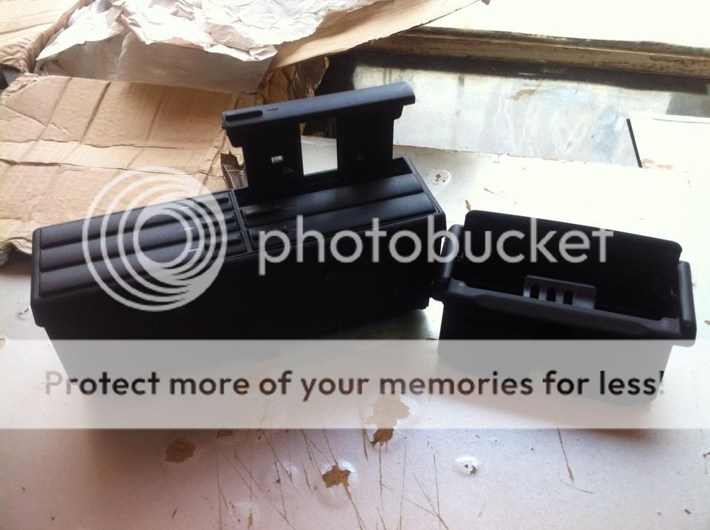

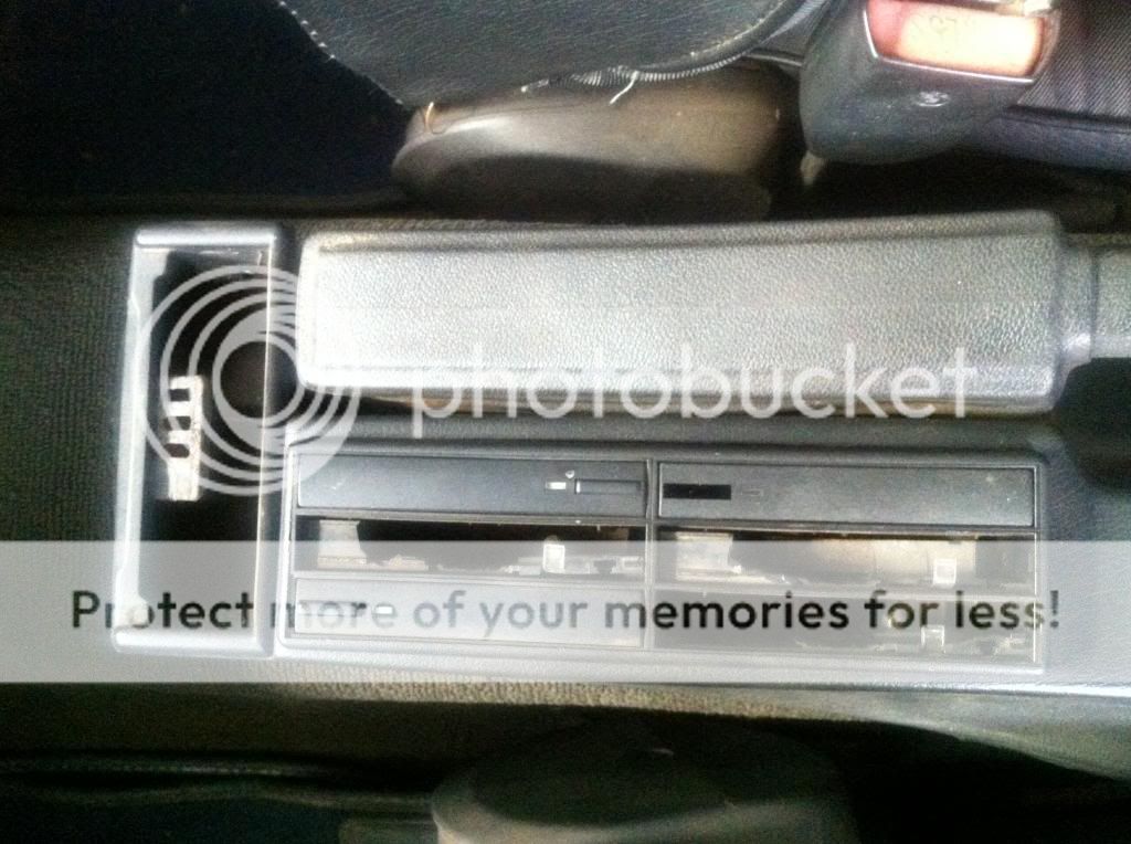

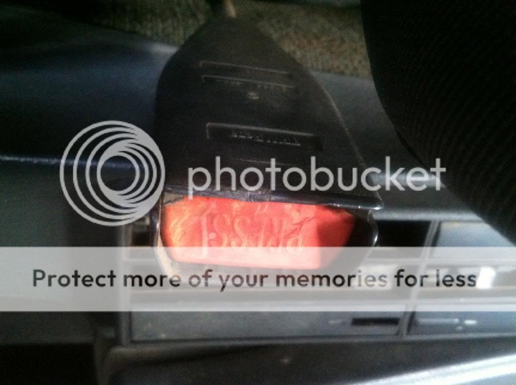

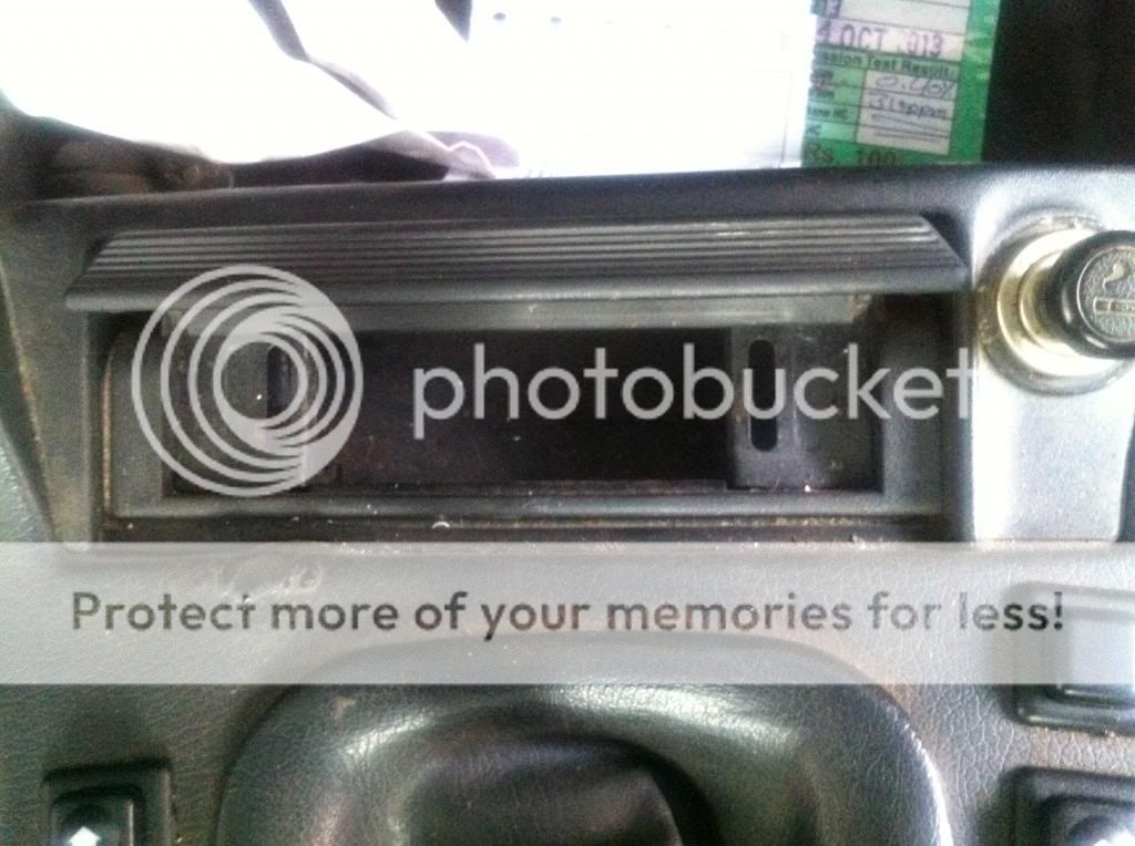

Front ashtray has a burn mark. Would require advise on how I can repair/restore this.
The rear is broken

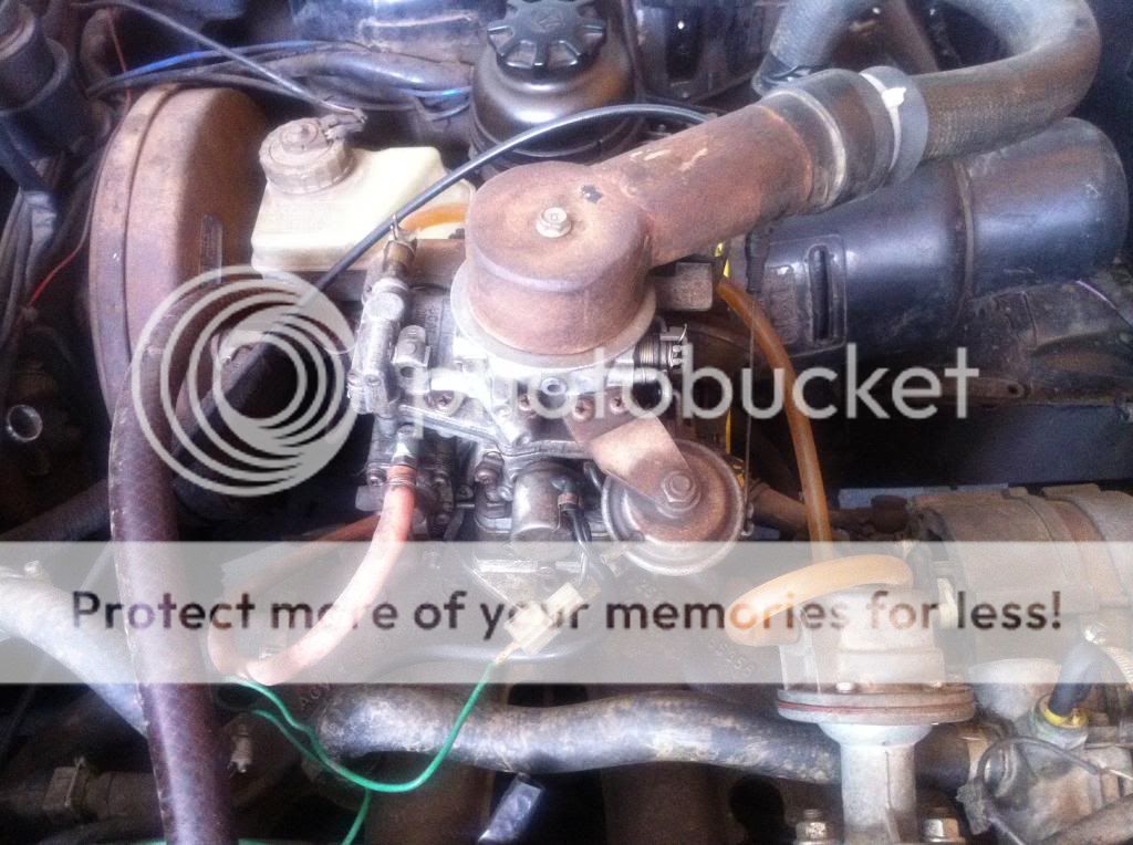

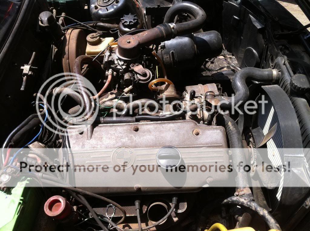

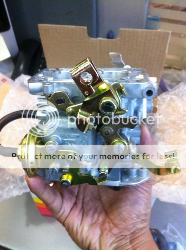

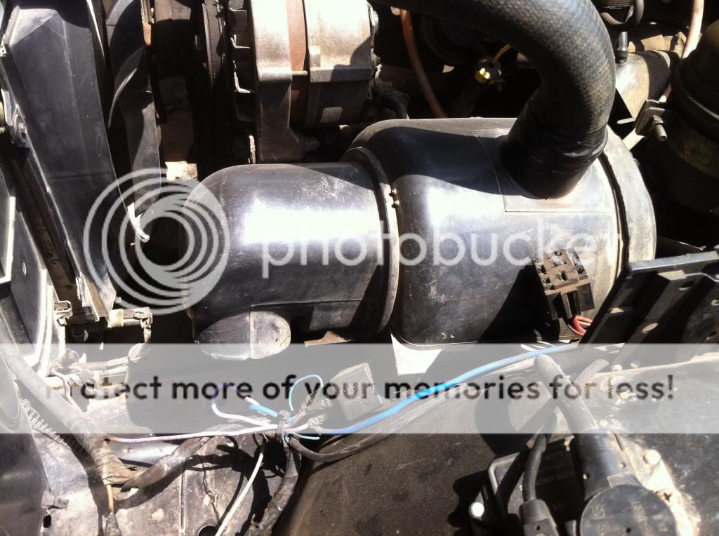

The Carb as is. Suspected to be a Suzuki carburetor. Discovered that all the E30 Carb car owners in Thailand are running old Honda Accord carbs as they are the 'best'. Or most of them have dumped the M10 for a Nissan 2.5L engine.

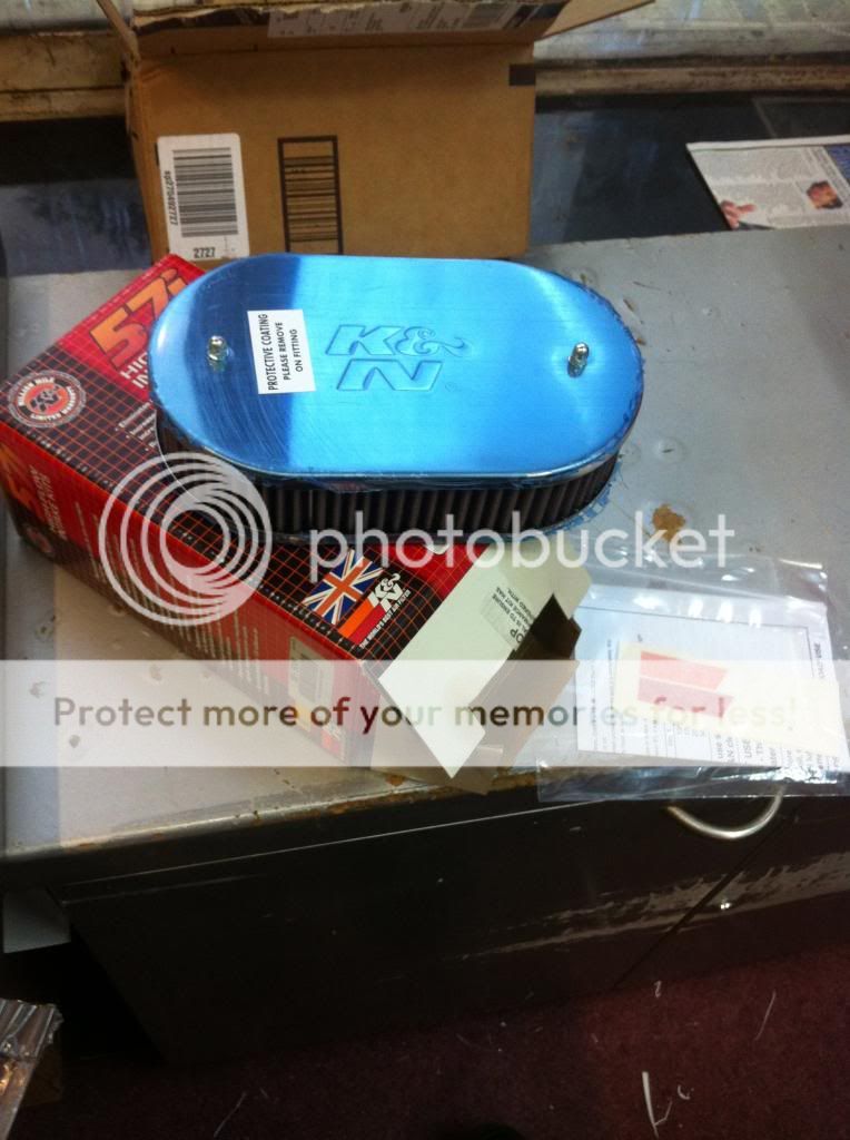

And while on it, this is the Suzuki Jimny 410 Air box:

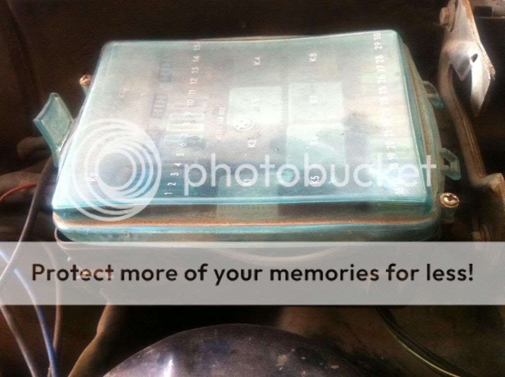

The fuse box cover has warped. Heat?

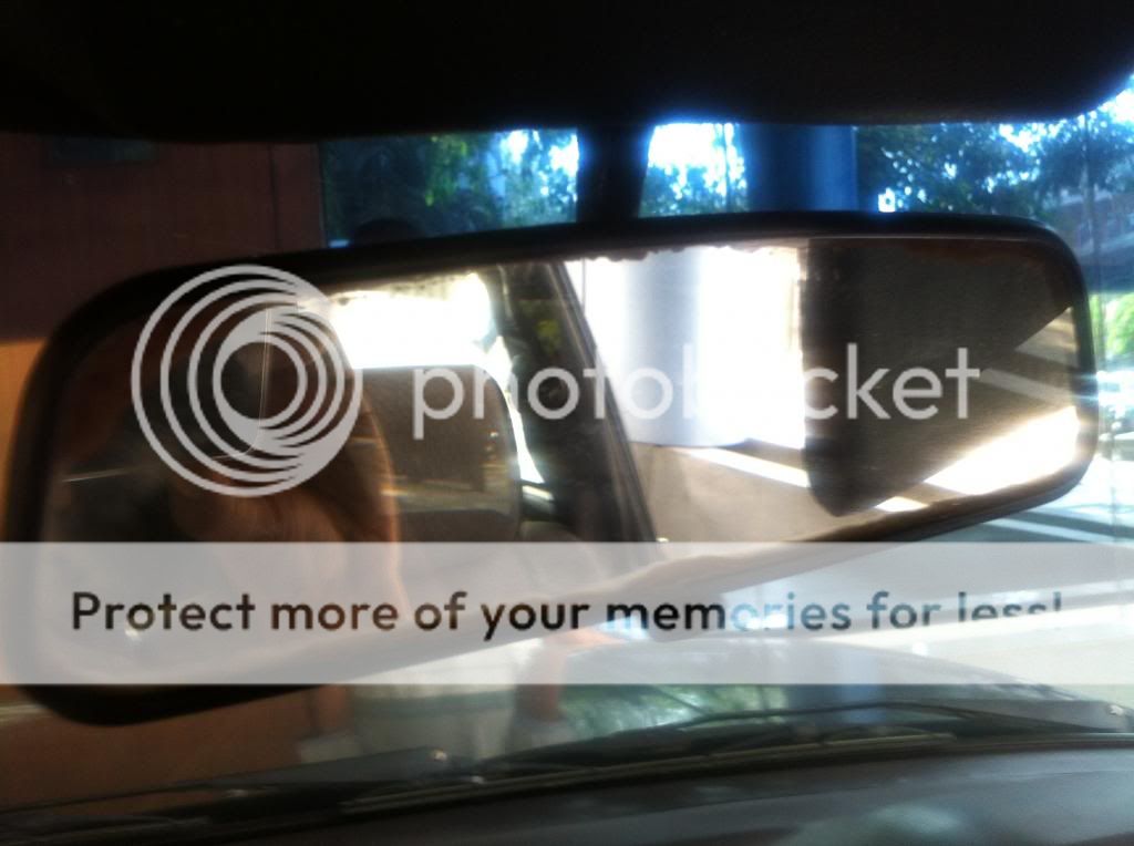

The rear view is the same:

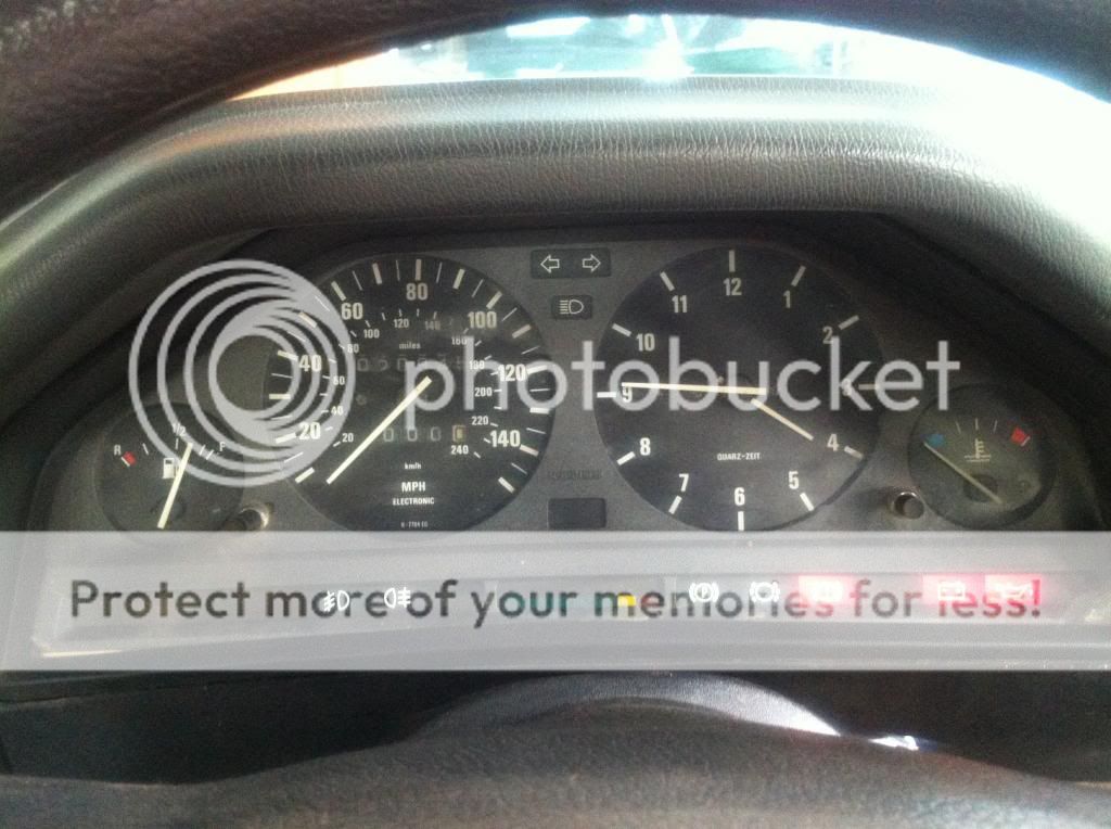

The temperature gauge doesn't work, so got a new one. Along with a temperature sensor.
The seller has tampered with the odometer and has clocked it back by 20-30000 miles.

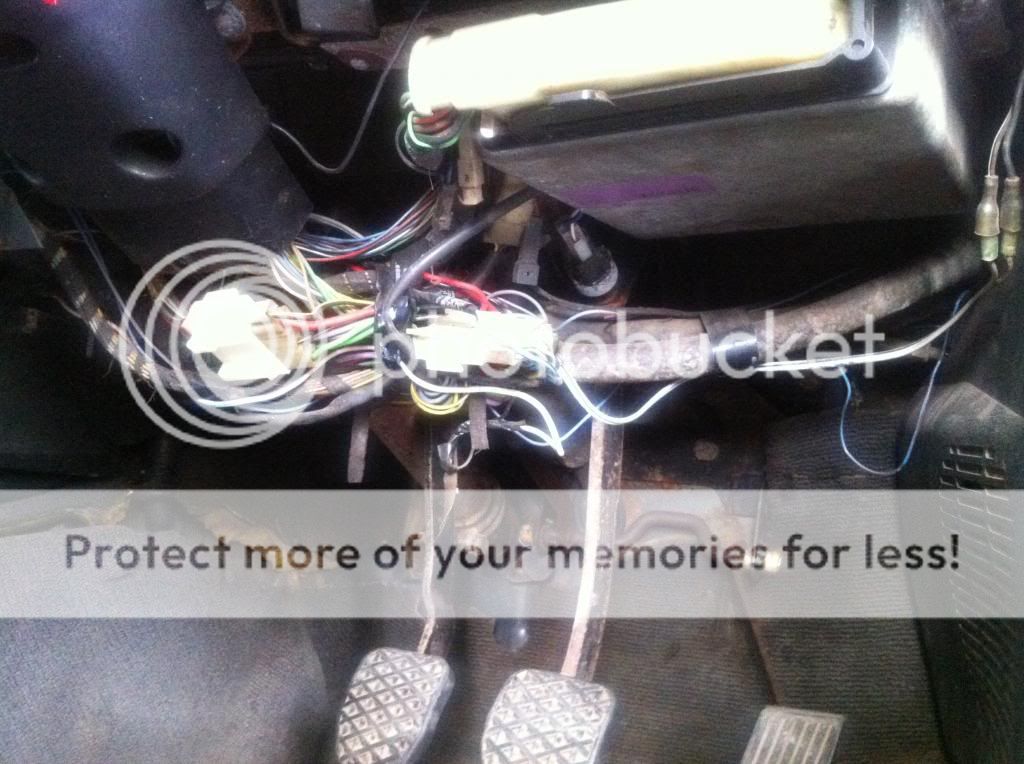

The central locking doesn't work or the fuse is gone, we will check that. Soon.

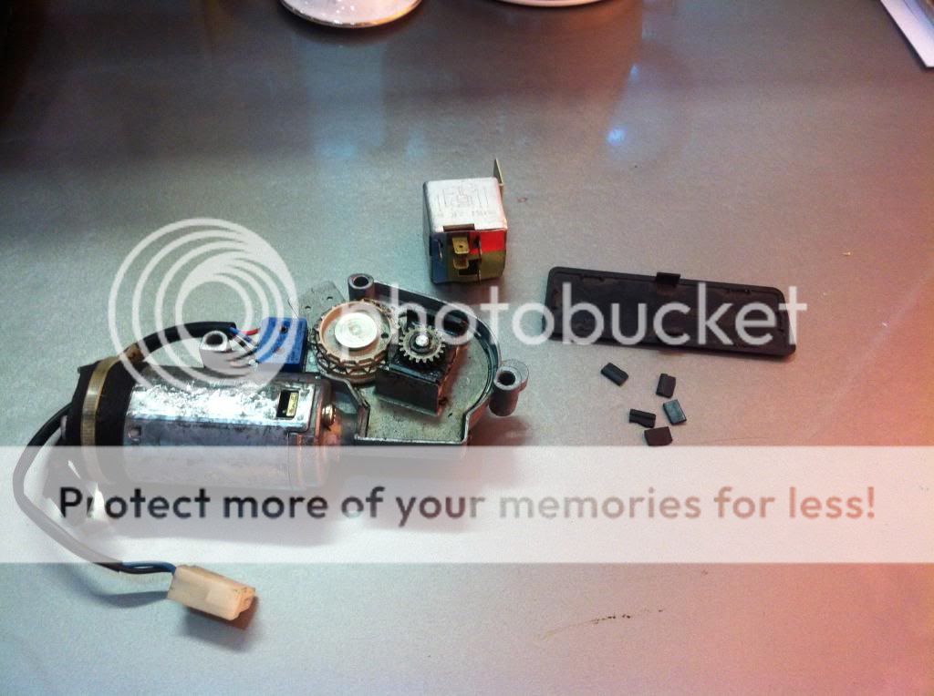

Electric Antenna is jammed

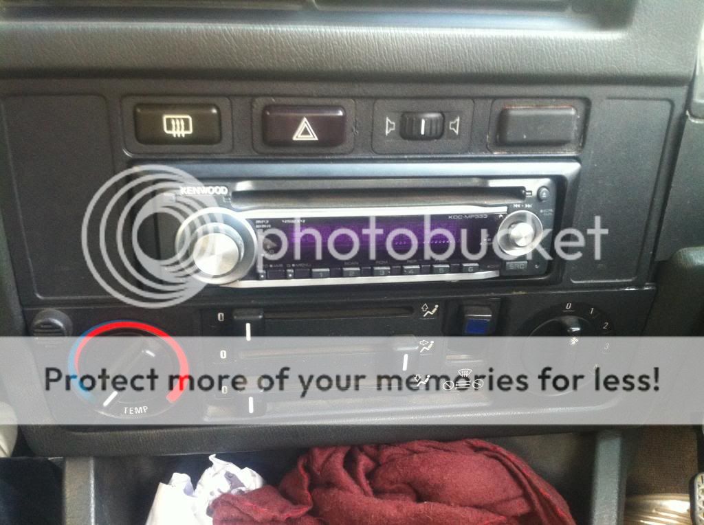

Radio doesn't work or maybe again a question with the electrics/fuse.
The AC switch is again from either Hyundai or Suzuki. Not sure. Don't care.
The leather surround for the gear knob is cracked/torn. Have got that and a new knob, and the bushing and rubber gaiter.

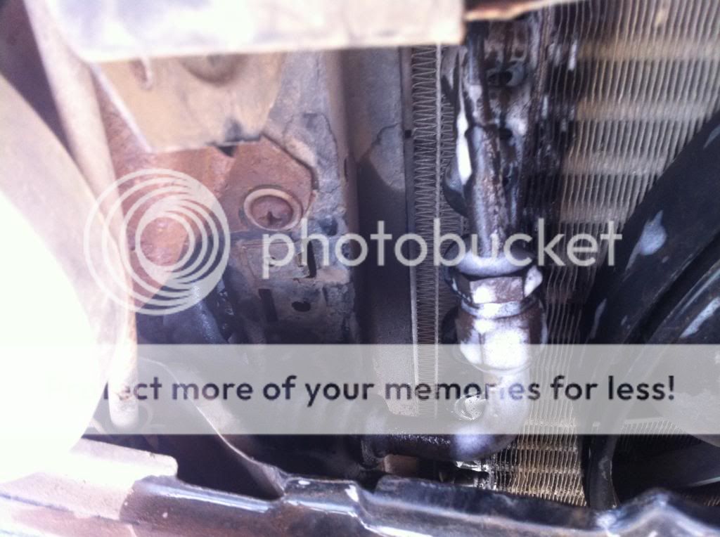

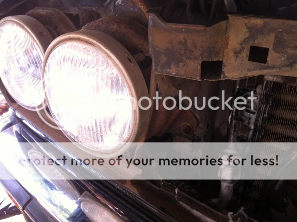

Rusted headlight brackets. And no leaks in the lines.

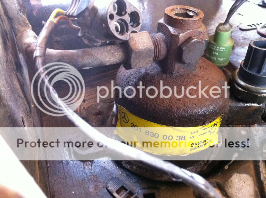

Discovered that the AC is now 'direct'
And a Mercedes 190E part powers it

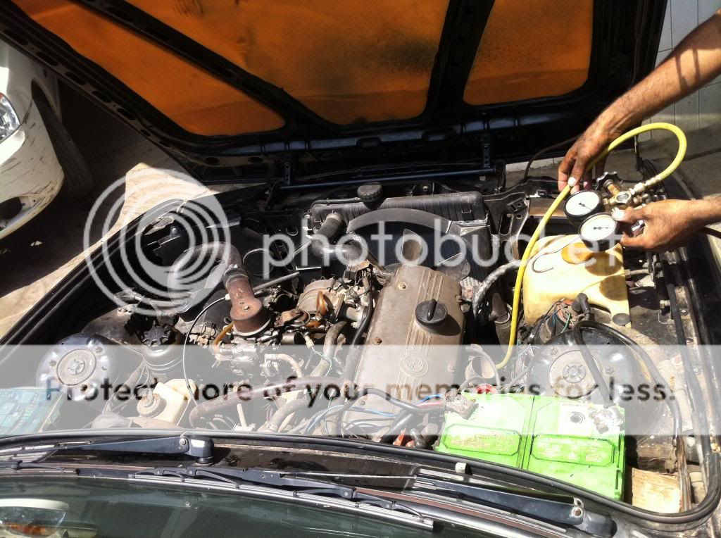

The AC guys hard at work, trying to decode the mysteries:

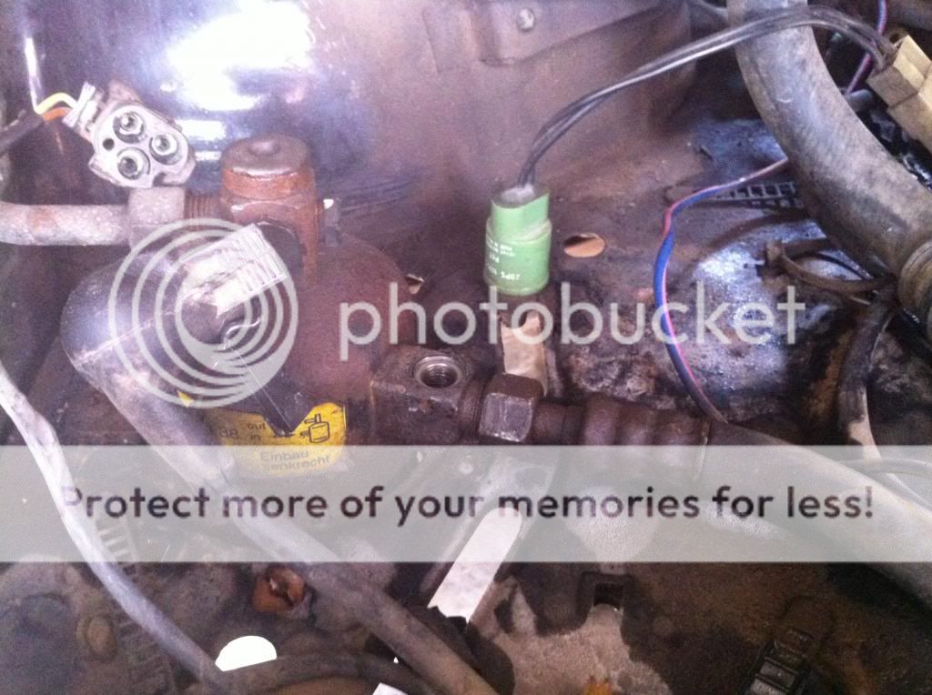

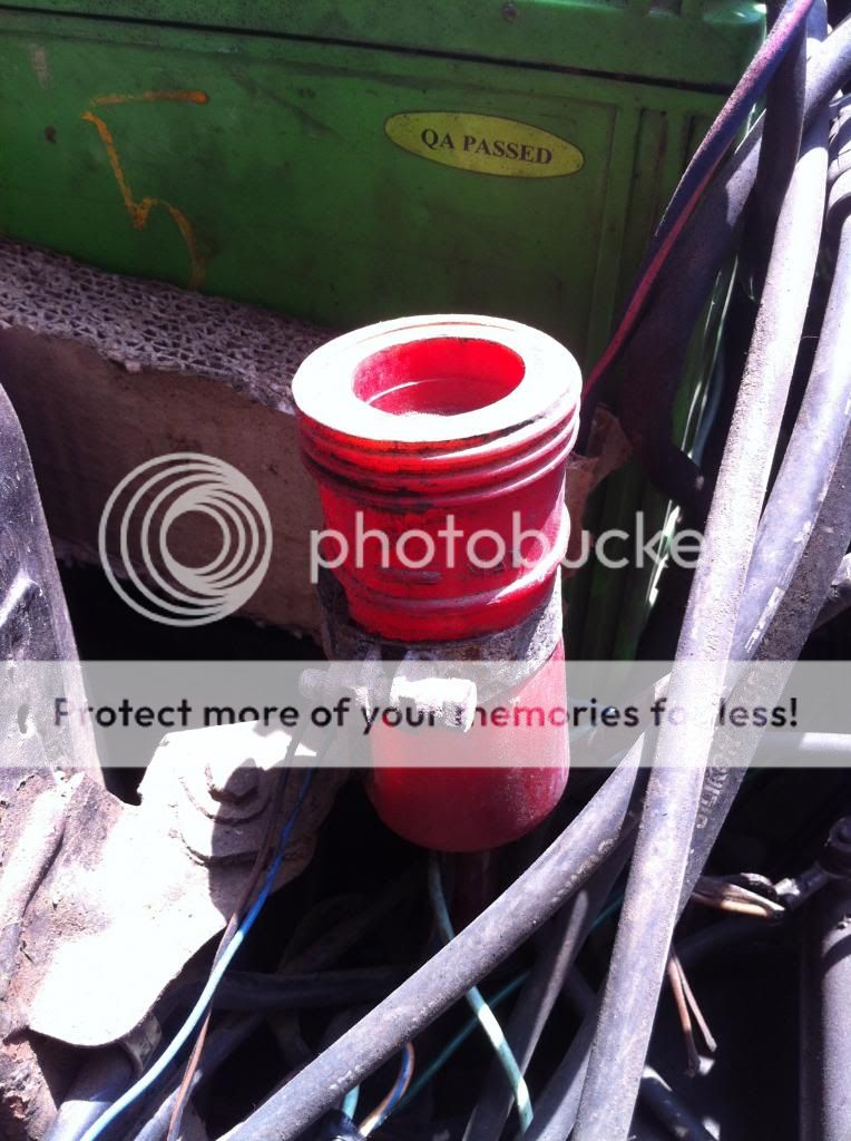

The expansion valve is so rusted that he said if I touch it, it will break off.
And when I wrote to Pelican parts, the advice is quite detailed and confusing.
Can anyone help me with parts for a AC system changed to R134-A. The compressor is Ok. The expansion valve, the dryer/receiver and the switch need to be changed.

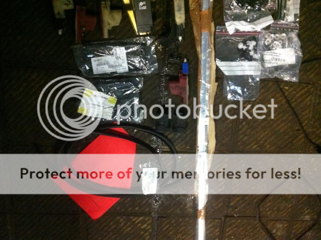

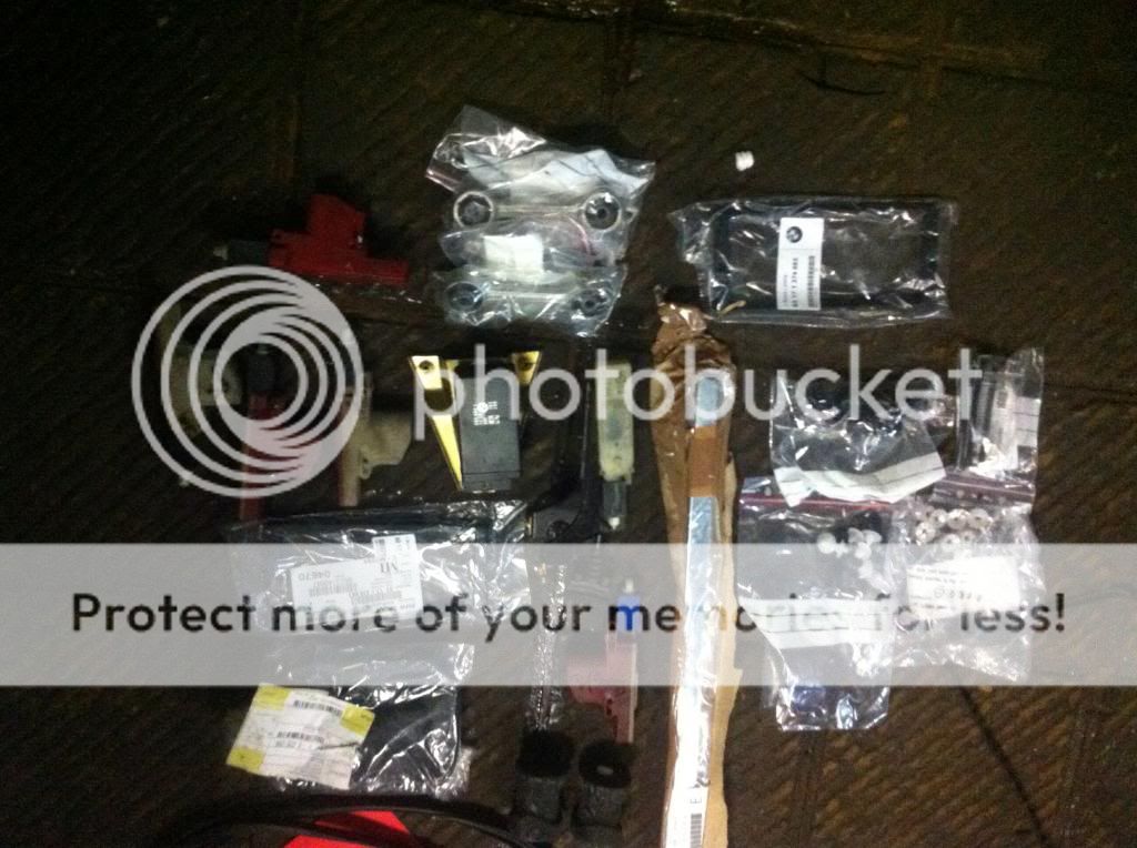

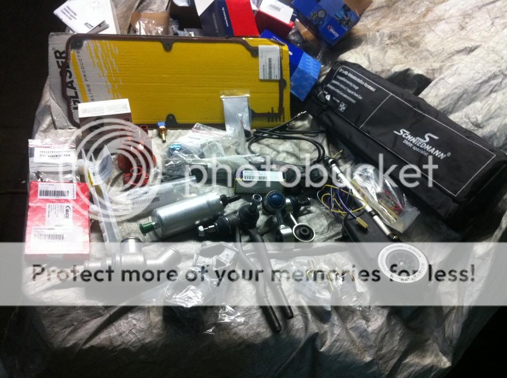

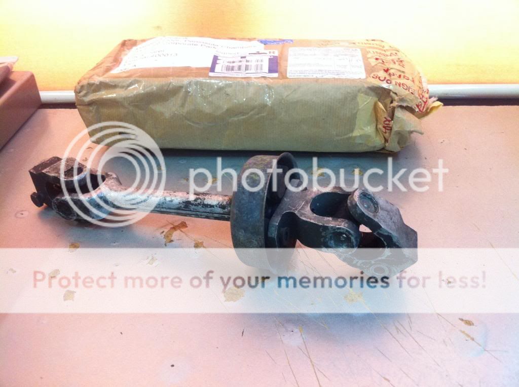

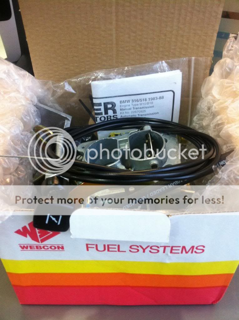

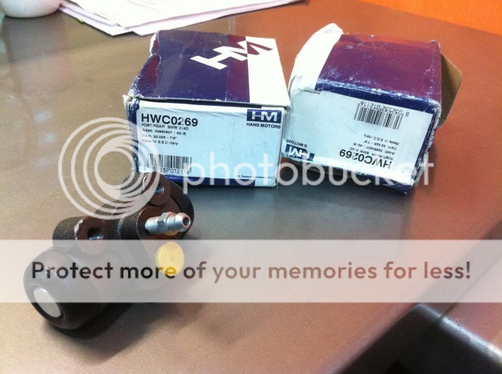

Three shipments have arrived.
Smaller stuff is coming via our forum members HJG-E30 and Hennared323i.
Ebay.co.uk is proving to be a boon. And those things are trickling in as fast as Royal Mail can handle.
