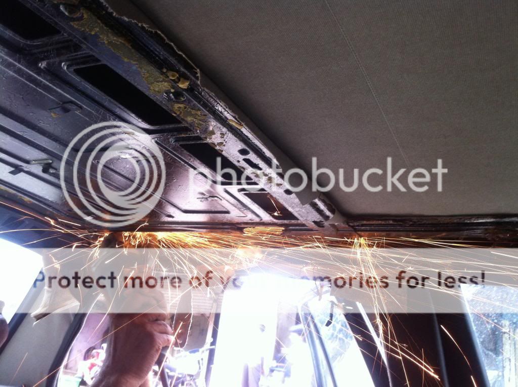

So we did the surgery today. Felt like I was watching a relative on the operating table.
The factory apparently welds the front of the cassette tray to the roof with 8-9 weld spots and had to be cut away.
Deepawali (The Festival of Lights) came a couple of months early.
Going at it, er, hammer and tongs.
Cutting it at the rear weld spots and brackets
The front had to be drilled and pried open like a can.

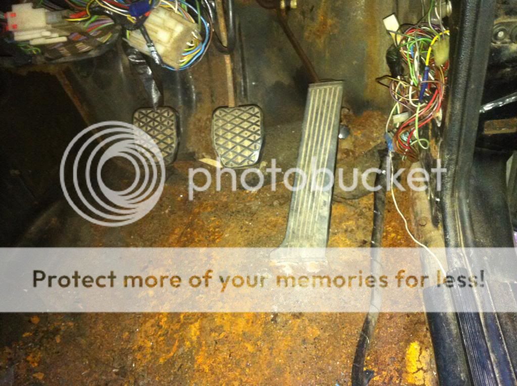

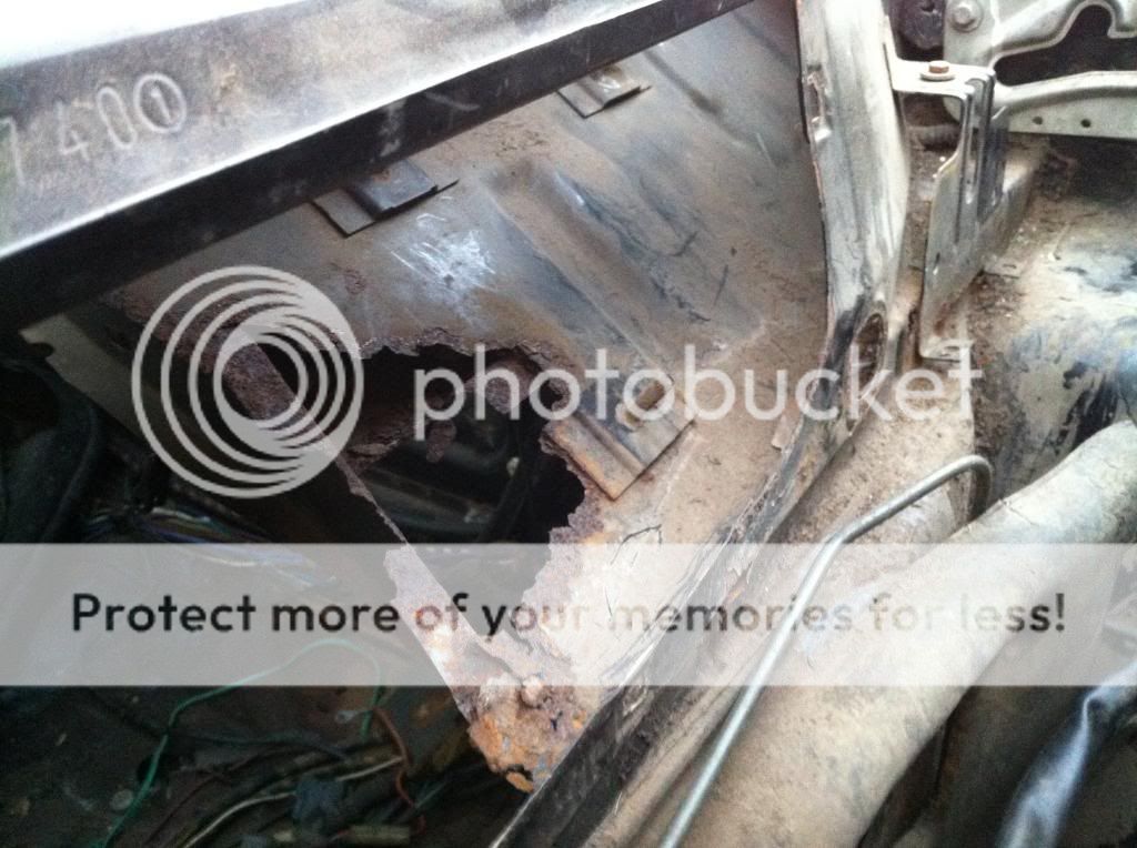

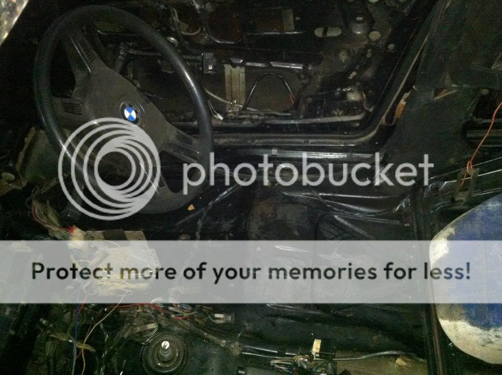

And if I thought the sunroof tray was bad, here is the worst side of the 316.
Left passenger floor. This is the good side. The rust is mostly colour from damp carpets. The metal seems solid. Where the water came in from has to be investigated. There were some damping / rubber sheets on the floor, which have turned crusty and came off in pieces.
Left passenger door sill has a couple of spots.
Right driver's side is the worst.
A lot of the rusty bits are also pieces of the sunroof which have fallen all over the floor.
A clean up and some scrubbing will help us see the real story.
Some thing under the accelerator pedal. Please tell me what it is?
The camera flash doesn't help. Makes the rust come out really well :)
Close up in natural light of the busted area underfoot.
With some strips of black stuff that I ripped off.
Wish me luck and if anyone share the design of the metal floor pan, it will help replicate the metal piece closer to what it was.
cheers!

Posts: 14014
Thu Oct 03, 2013 8:07 pm
Looks pretty crusty, and a bit curry-like to look at!
I suspect the object under the throttle pedal is a throttle-stop, to prevent you pushing it down too far and snapping the throttle cable, or wearing out the carpet. :wink:
Automaton
Posts: 448
Joined: Wed Apr 03, 2013 11:00 pm
Location: India
Thu Oct 03, 2013 8:33 pm
Ah! That must be it. Will have to get it welded back to the correct place.
I will vacuum the floor and click a snap just to reassure myself :) that
it's not a balti chicken spill, or whatever north-west Indian food is called there.

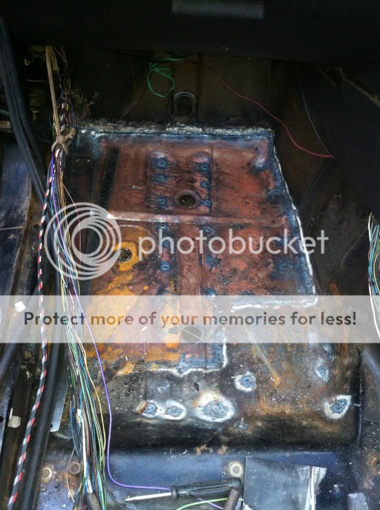

We have made slow progress. It's been close to 4 months since I said the floor rust would get tackled in a couple of weeks. Famous last words.
The welder found a sheet that had been welded on to existing rust :) Chucked in the back. And you can see Hyundai Santro door opener, with a metal piece added to fit it.
Soon the twin layers of rusted metal were hacked off.
The welder claims the chassis underneath is fine :mad:
Anyway, he sorted that out, before making a pattern from the pics that I supplied from your collated pictures from various threads.
After much head scratching on how he got stuck with this job, he and his mate got down to it. It was Diwali time in 1st week of November by the time welding and chopping started in earnest.
Placed to see if it fits in the yawning gap.
And finally, welded in. The running board had also got the blight. so that was tackled on both sides of the floor.

The bracket to keep the accelerator pedal from pushing down too much was also recreated and fitted.
The sunroof tray was gone. But these guys saved me ton of money, by doubling the effort to rescue it.
After a long exile at the welders' the tired old thing was back in the garage.

After I discovered that the electrician had chopped the loom when the welding work was going on, since he didn't pull out the entire loom out, we sourced some connectors and got them fitted under the main fuse box. So now fuse box is plug in and plug out.
That's where we are today. The sunroof tray has gone to the sunroof guy to fit in the slider mechanism I ordered.

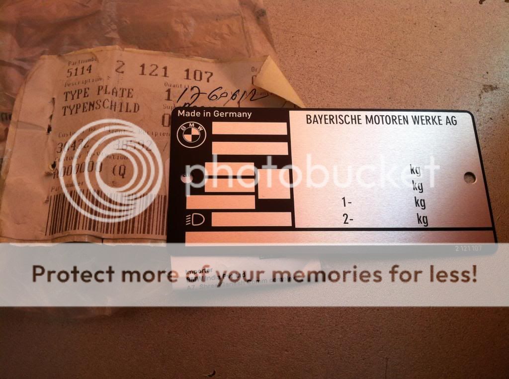

Missing VIN plate from Germany: (surprised after all the details they took to order it, didn't come stamped with my car specifications. will have to get someone to laser etch the numbers)
