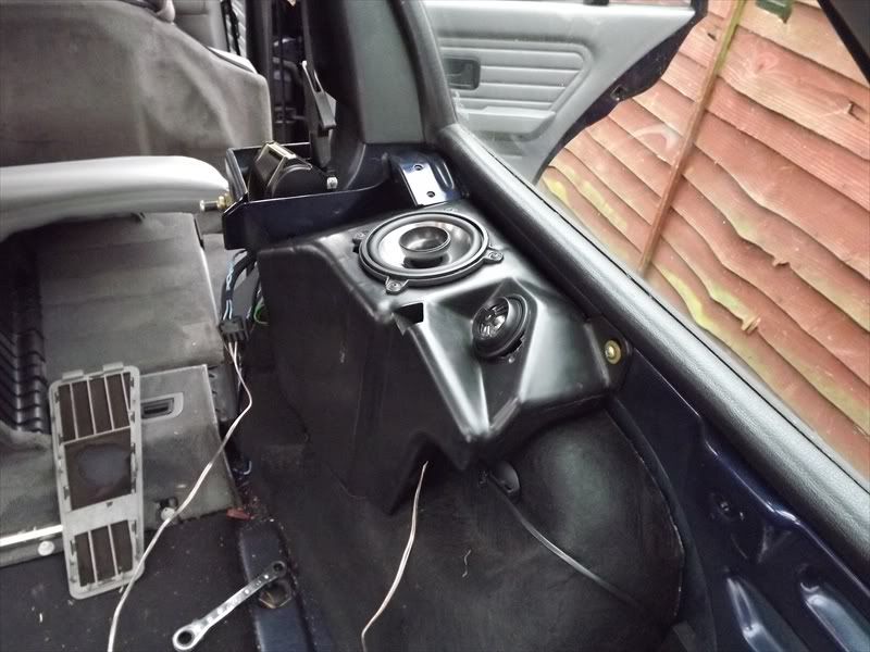

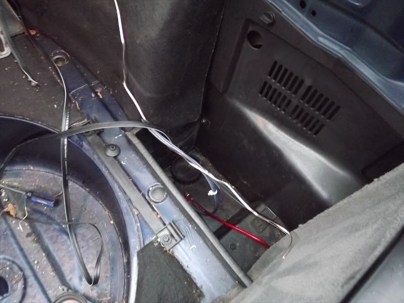

Started fitting some car audio, unfortunately the standard set-up isnt good enough for me
The setup is as follows
Nakamichi CD-400 Head unit
Loudest.com 90w RMS 4" components in Rear
Vibe Black Hex 75W RMS Components in Front
Vibe 4 Channel AMP 4x 100W RMS
So Plenty of power.

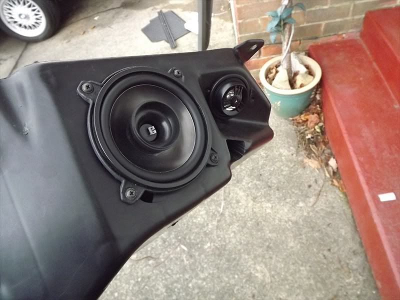

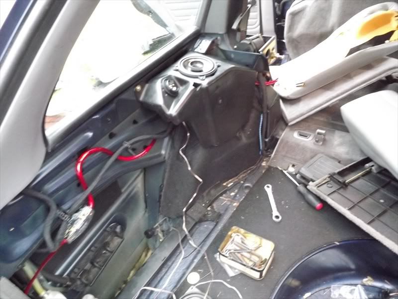

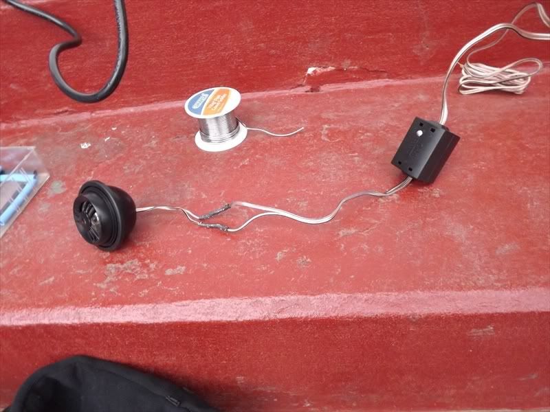

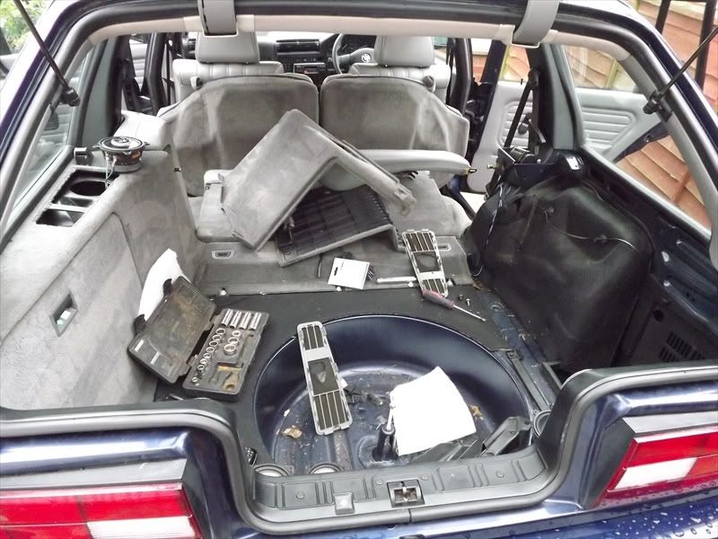

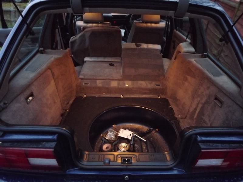

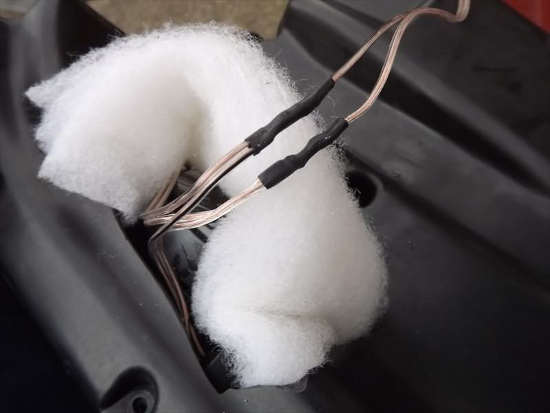

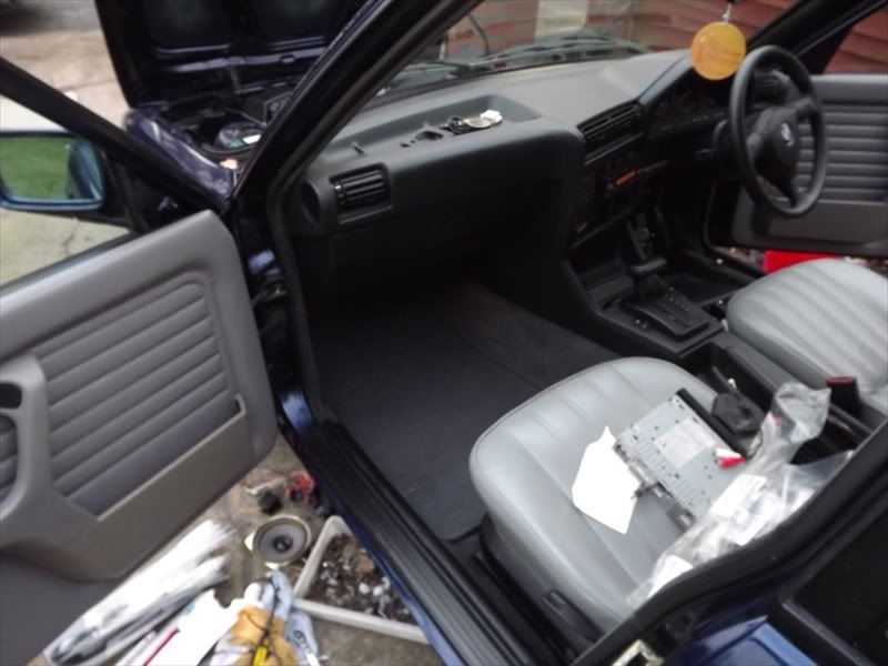

took about 3-4 hours to do what seems like not a lot but i wanted to do everything properly using heat shrink etc.
started by removing rear panels in the touring, pain in the arse these.

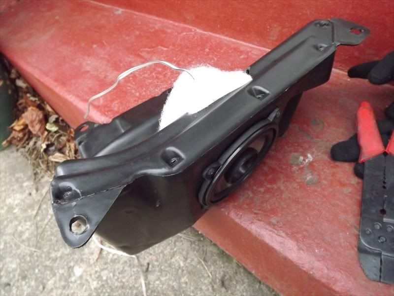

first problem was when i removed the speaker pods, the speakers that were going in wouldnt fit depth wise, so had to be creative and smash a hole in the bottom for the magnet to stick out, i used the original foam inside to cover the hole i had made for the magnet. aswell as that the speakers seemed very slightly wider than stock so had to do some trimming to the hole. but got there eventually.
no block connectors this time
excuse the excessive trimming
this is where the amp is

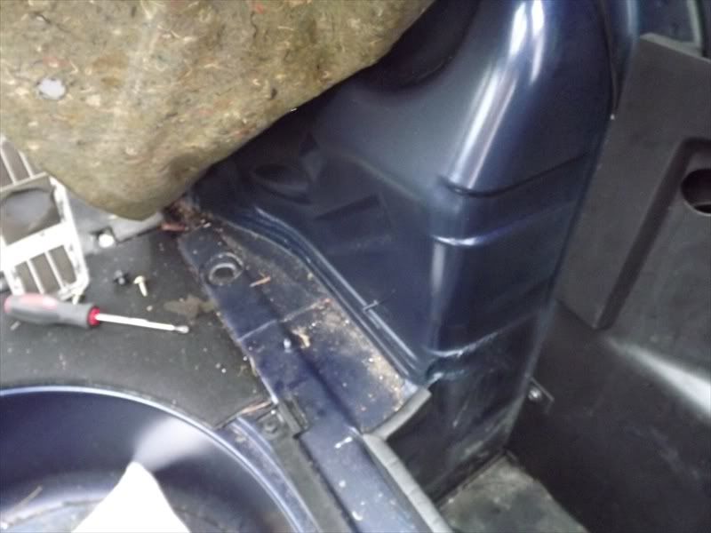

The only e30 ive owned where there isnt a tiny bit of rust where the fuel filler goes.
Back together
after plenty of swearing i managed to get it back together along with all the wiring from front speakers to back of the car, earth, power lead, rca and remote cables.

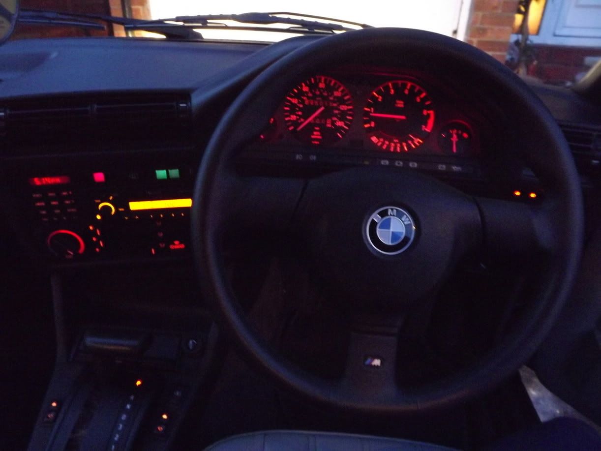

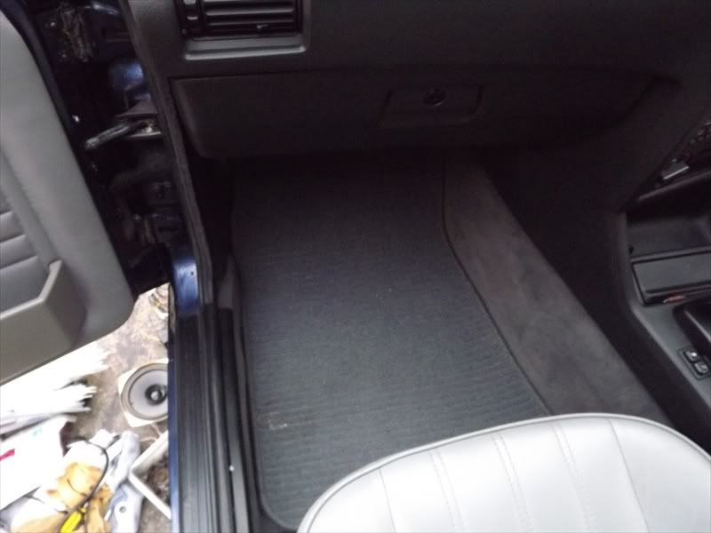

today i fitted front comps and connected the amp up in cubby compartment, also fitted my nakamichi head unit. only thing i need to do now is modifiy the tweeters for the aftermarket ones and connect them up. although this is the only pic i have
at last i have a glovebox and all trim in on the passenger side. to be honest this was a fooking pig to do as there was slight damage to the footwell so i had to remove foam from the carpet and trim the speaker panel down ever so slightly but you would be non the wiser now.

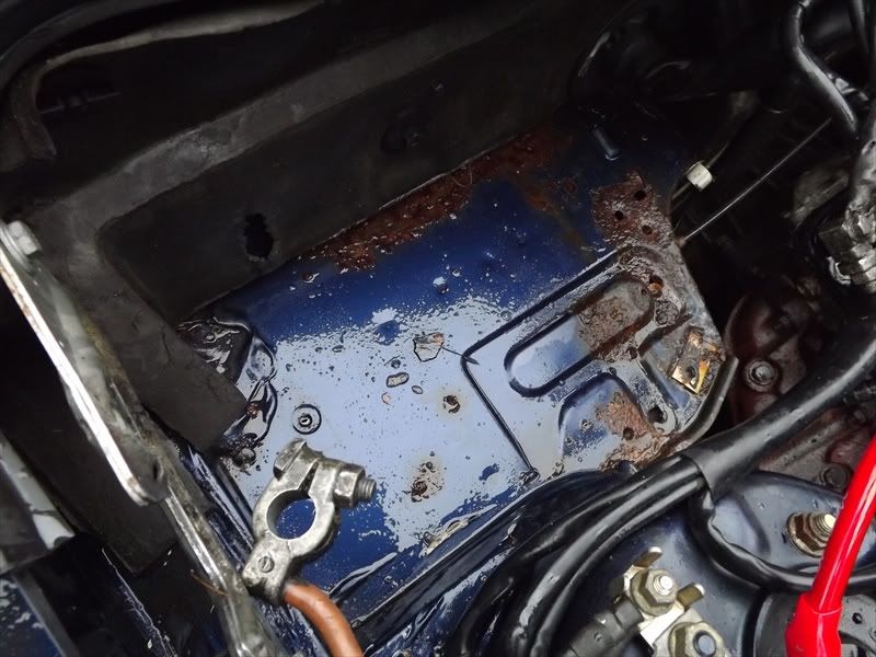

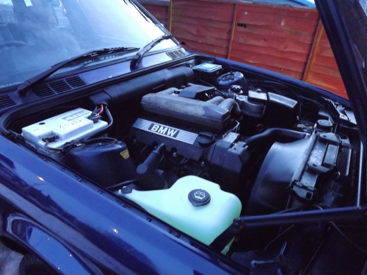

while the battery was on charge i used a wire wheel to remove any loose crap from the battery tray and soaked it in loads of krust for 3 hours then gave it a coat of zinc primer, not a permanent fix but should slow it down for now.
krust
Zinc primer
Ready for a coat or three of mauritus blue

Alex get a sh1tload of waxoyl on that battery tray before the battery goes back in
If its started to go a bit in the engine bay check the other side too :
Mine seemed OK but I got the wire brush on it and smoothrited/waxoyled it to be sure

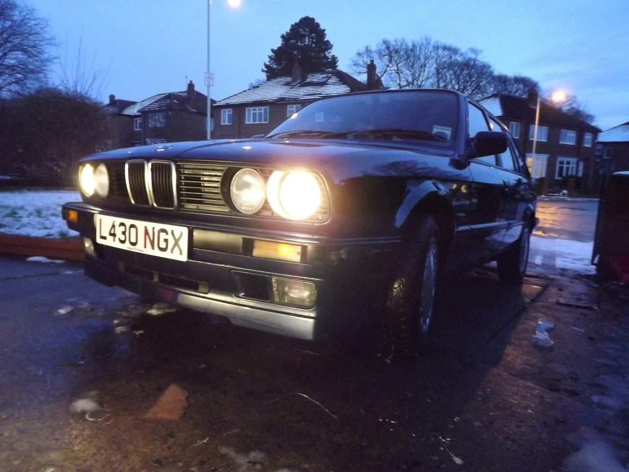

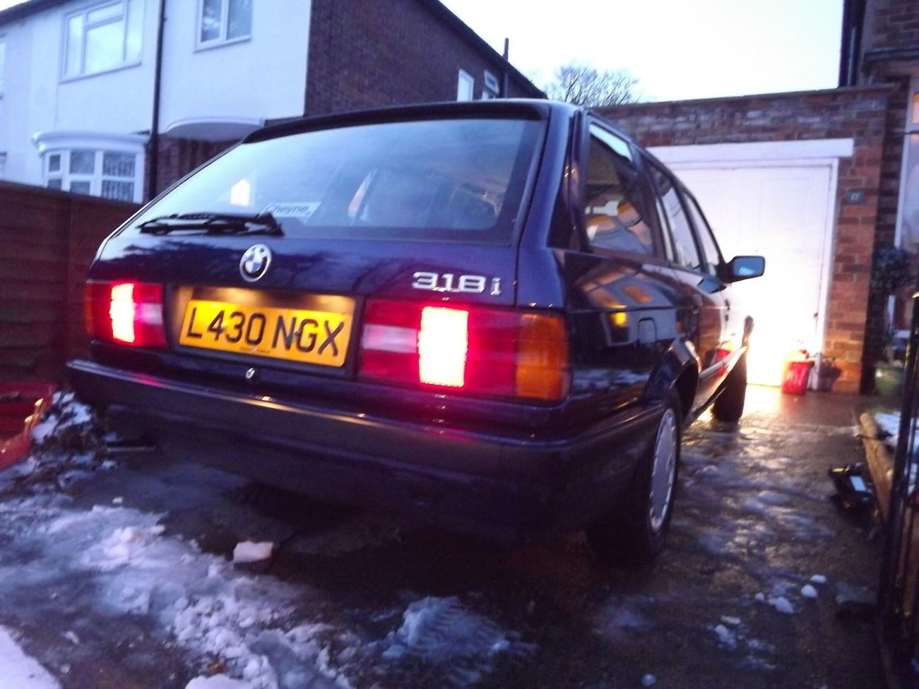

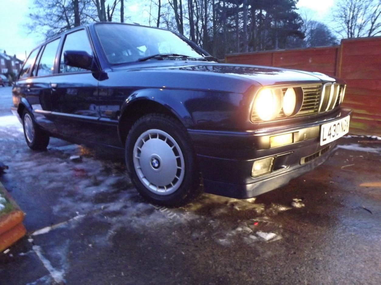

Getting Insured and Taxed tomorrow cant wait.

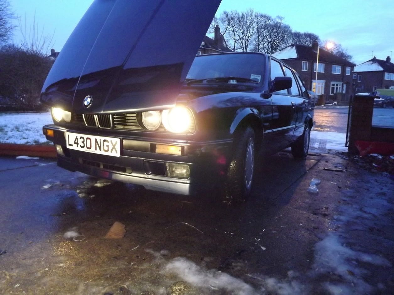

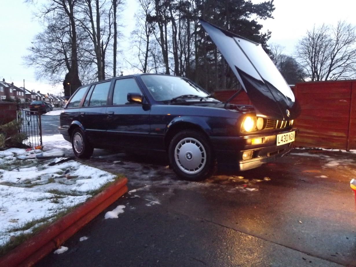

Finished the car audio off today, the only thing i need to do is fit tweeters but the wires are all connected. Also fitted Snow tyres, mainly because the bbs need 4 new tyres. Kinda like the pov spec look
Got all the interior back together and tweeked about with the headlights to raise the aim a little. fitted the mats out the e36 as i dont want the e30 ones getting ruined.
Everyone must of thought i was mad working in the snow but surprisingly it was warm with the sun out, had to take some layers off
So here it is finished for now, kickdown works correctly now and will rev to the red line before changing up, private road obviously

Looked at the battery tray underneath too, was perfect not a spot showing through

Is that your rear wash wipe switch glowing when not in use? My bulbs must have gone.
- Posts: 22666
Cheers Rav
and yes it is
