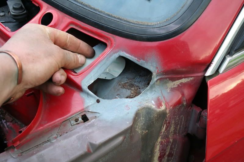

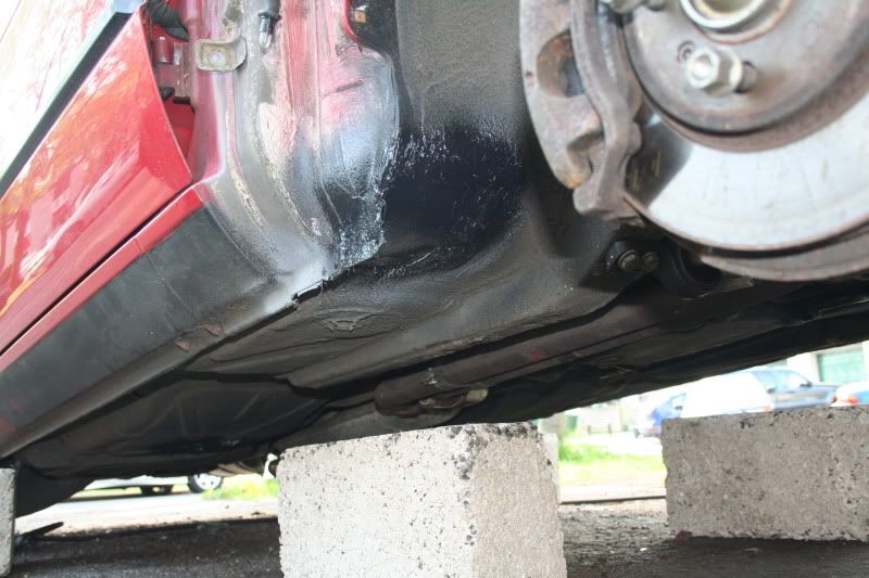

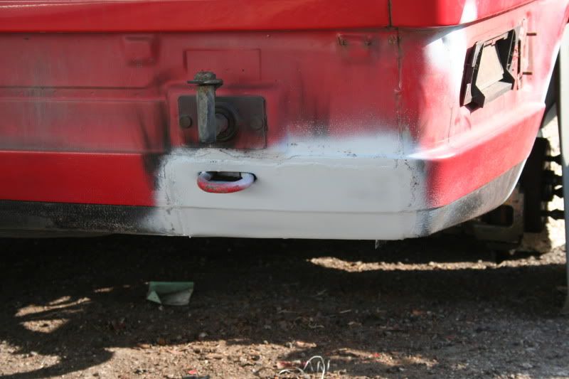

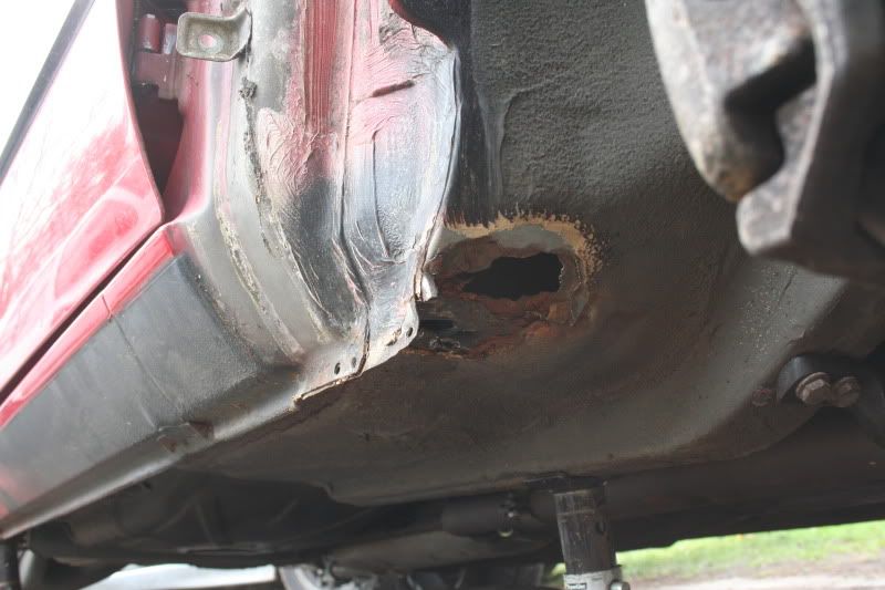

bang wollop boyo! its welded all up like.
I've not been 100% orgainised on the picture front on this so this is what we have......

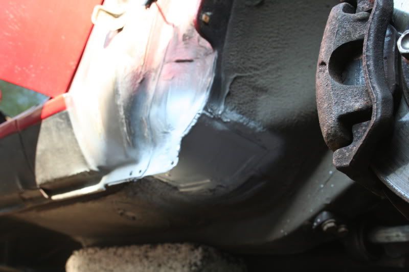

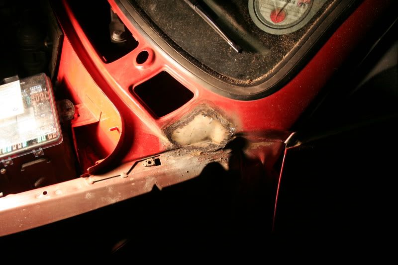

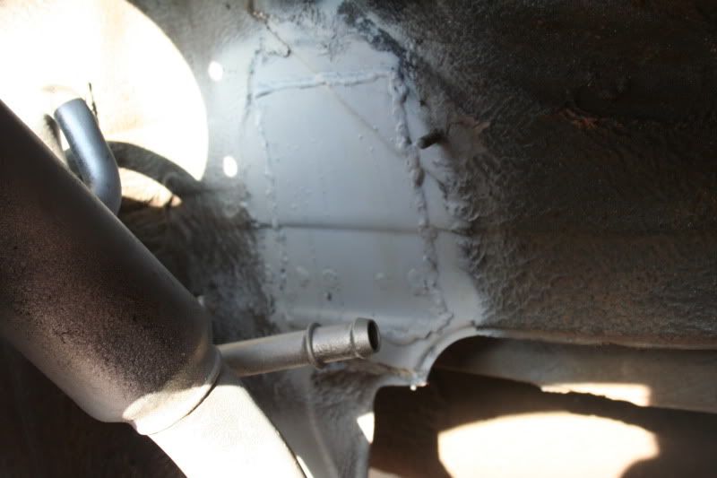

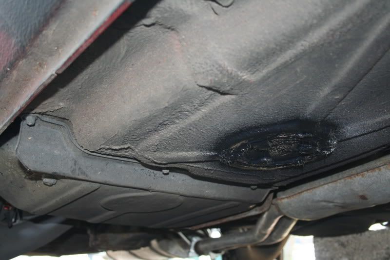

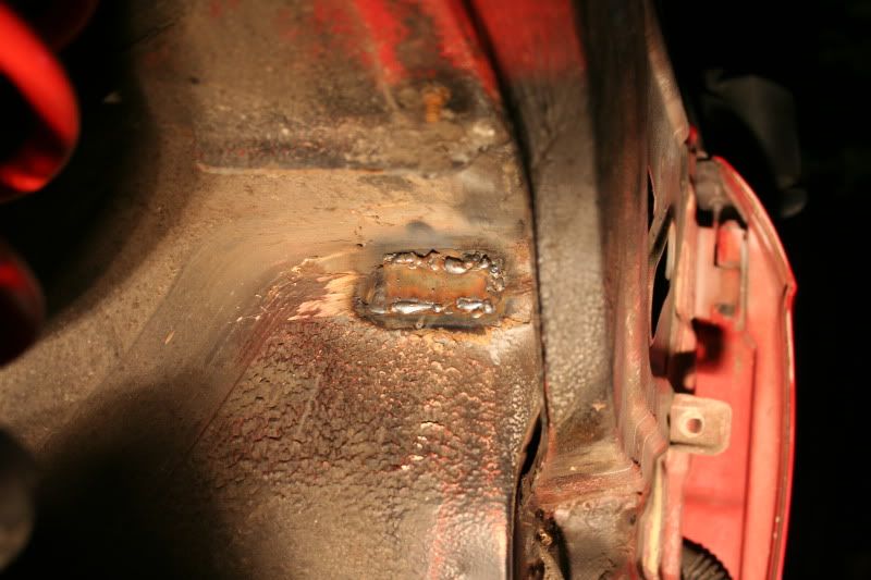

Jacking point delete alert, but with the right protection the grot will stay away for a long time

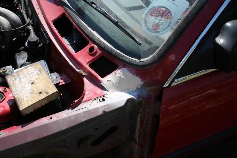

Annoying little hole, but none the less
another jacking point delete

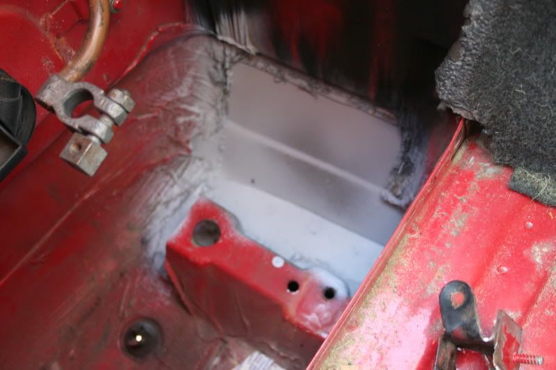

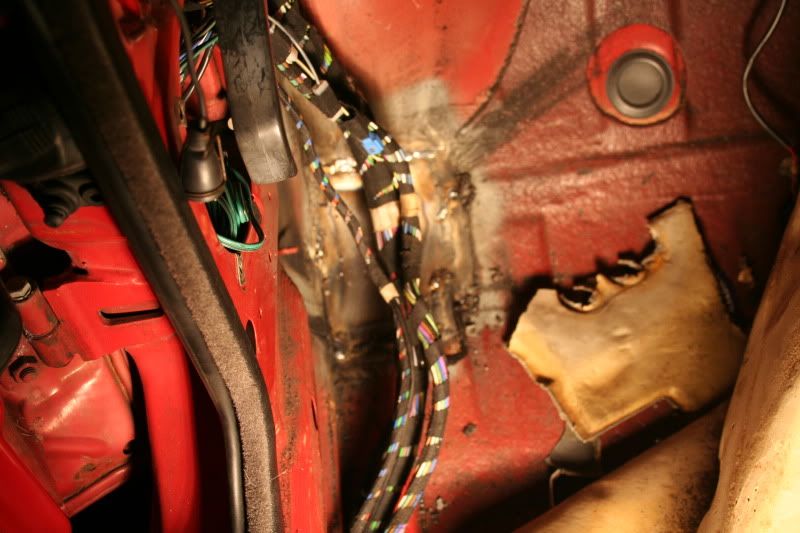

Another small hole needing attention now.

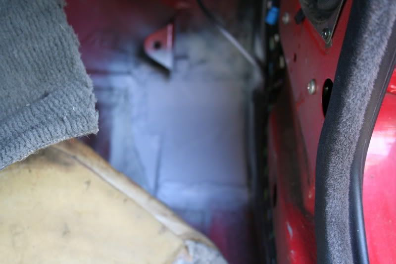

So the carpet should stay dry now! Mudflaps are a bit to blame on this car imo.

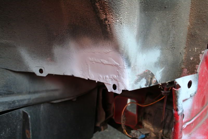

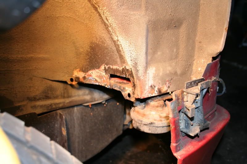

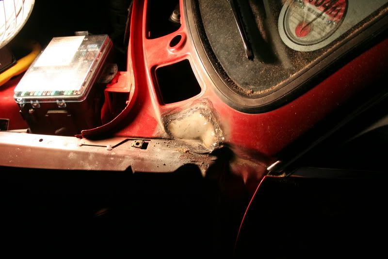

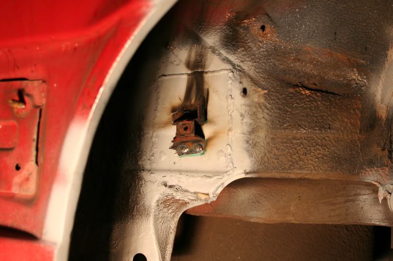

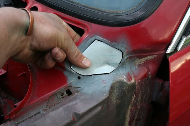

Don't they all rot here?! spot welds from the the factory with that little bracket that holds the filler neck up. I can't remember the last E30 i had that didn't need welding here, PYF, option miester, 2door pina, pina touring
Nice plate eh?

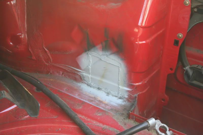

Pulled it out the bag here, i'm not expert but this is a nice repair imo

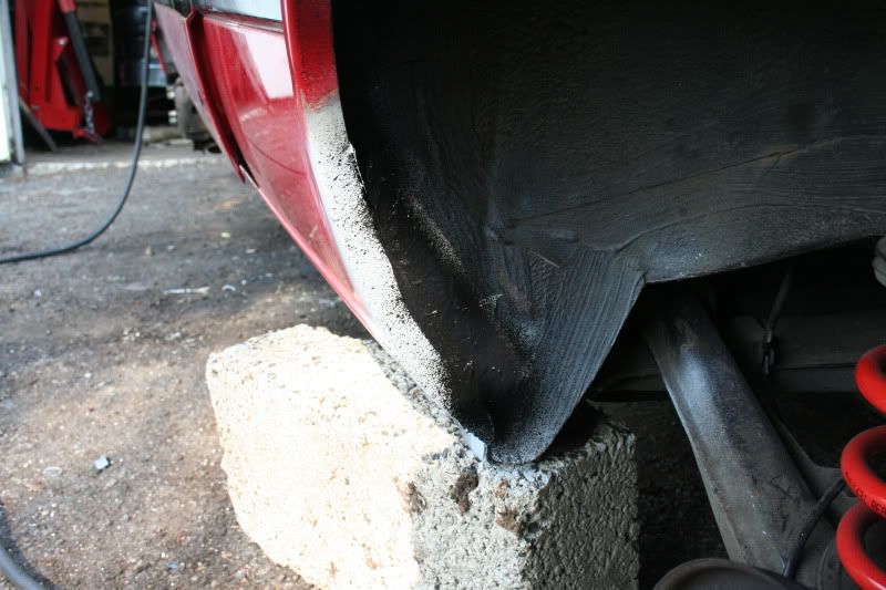

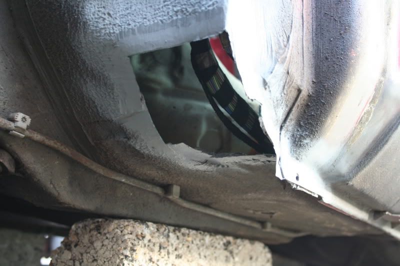

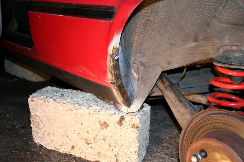

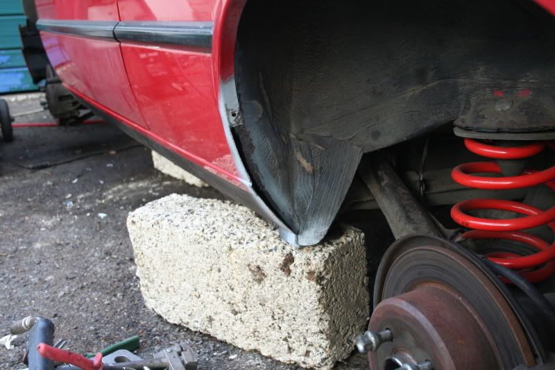

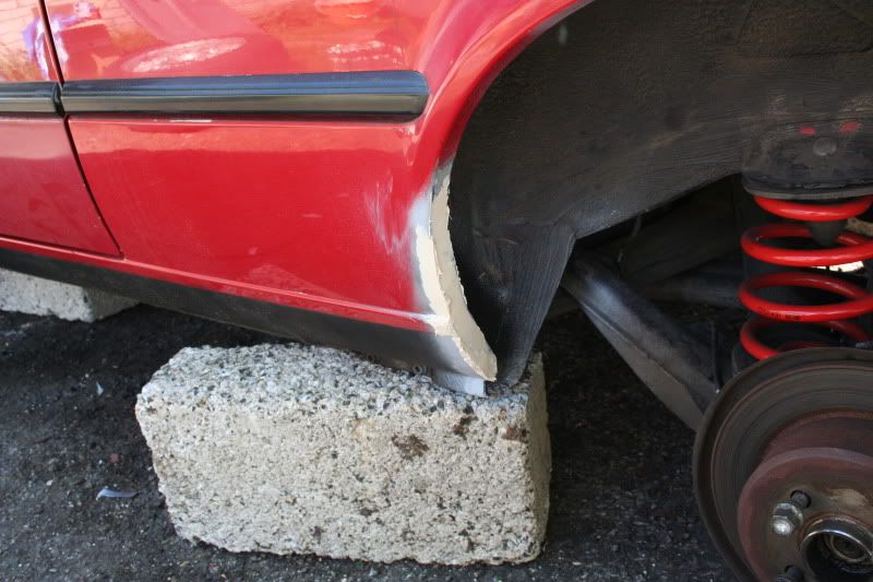

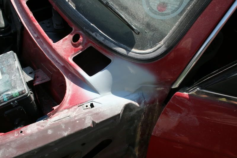

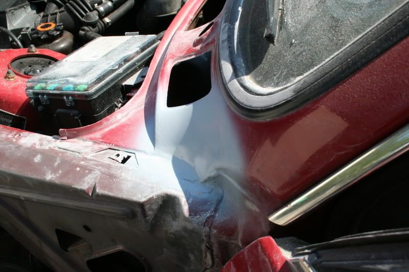

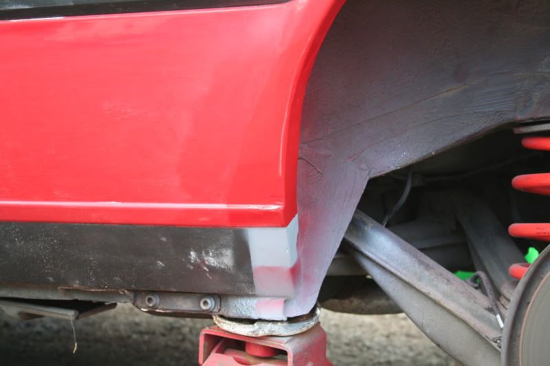

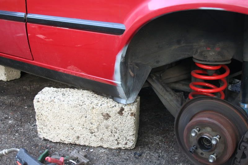

The outer lip of the arch wasn't very clever here, but it was creeping in on the inner. In order to the get to all the inner grot you have to cut away at the outer. None the less, Andy has made another nice job here. I can flood this from both side with the right gear
Again another nice repair imo. As this looked pretty sad before

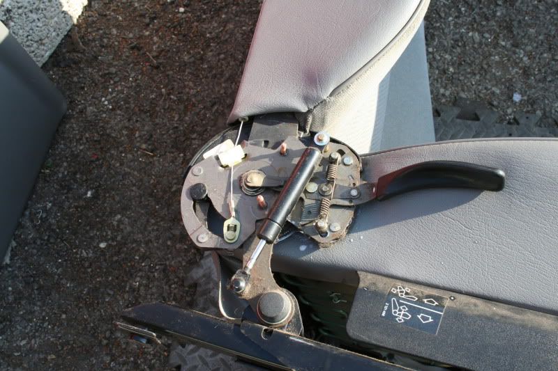

A lucky one this, the driver seat would stay up, so if you leaned it back or forth it wouldn't hold. No good for driving in general. we managed to get it to hold for the drive home but its been sad ever since. So i was expecting broken bits etc. After a few bits stripped off and a good fiddle it needed no more that a clean up and re grease. The kind of repair i like, so fully functioning seat again for 15 mins p!ssing about.
So its all on me again, Andy has made a nice job i think of the welding and now its all ASAP for MOT before the month is out is the goal. Seam sealer out 2moro ready for some shultz gun action and then getting her back together

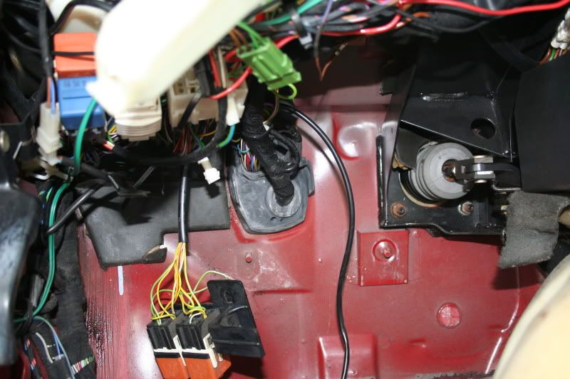

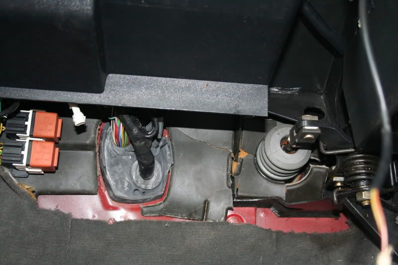

Very nice work on this Simon - have you checked the bulkhead behind the pedal box and round the wiring loom ? - seems to be a lot of cars poping up with rot spots there - you've done every other problem area by the look of it ! 8)

Fear not windscreen was covered John it was all well covered up! What with the lovely weather its been a great chance to crack on and get this show on the road

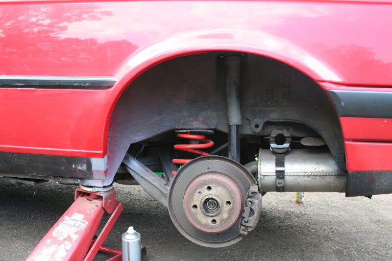

BMW's very own underseal, i had 2 part filled cans left. This stuff is the shizzle imo. Was under a £10 a can and it goes a very long way
Various areas given a good blast, don't worry every bit got a seeing to with this.

I'm pretty pleased with the overall result, considering the BOB the builder DIY effort

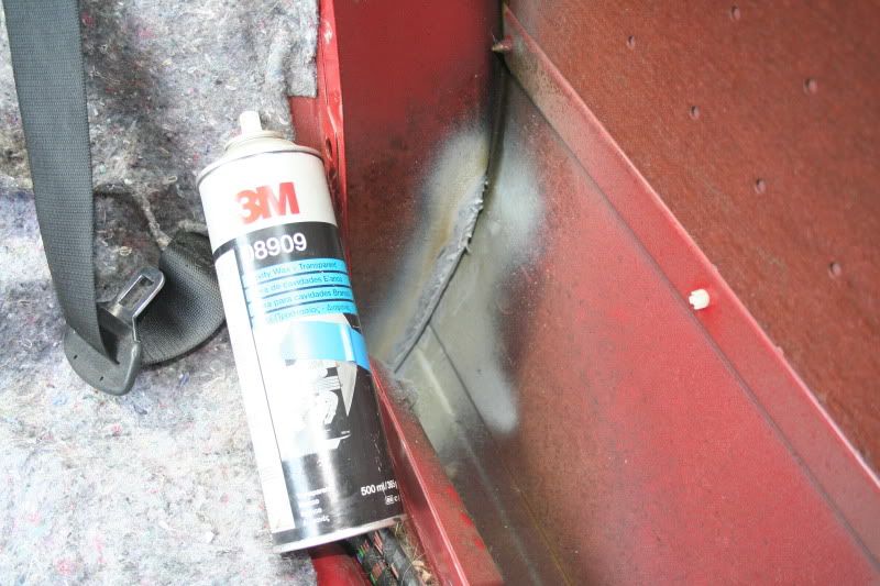

A liberal coat of cavity wax, this stuff is clear. so its hard to see sometimes where you've applied it!
That small plate is behind this lot....... hard to photo but some cavity wax behind it and were good to go for the refit
Glued the sound deadening back up and no more grot here on the bulkhead

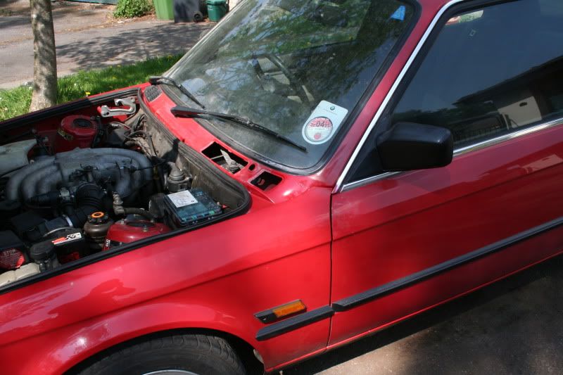

I think the paint job might need another go here to make it as good as the arch battery tray

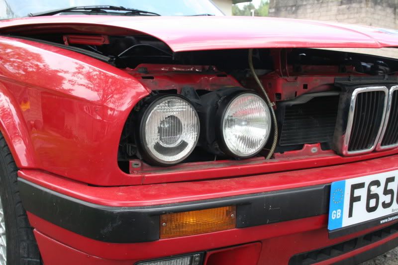

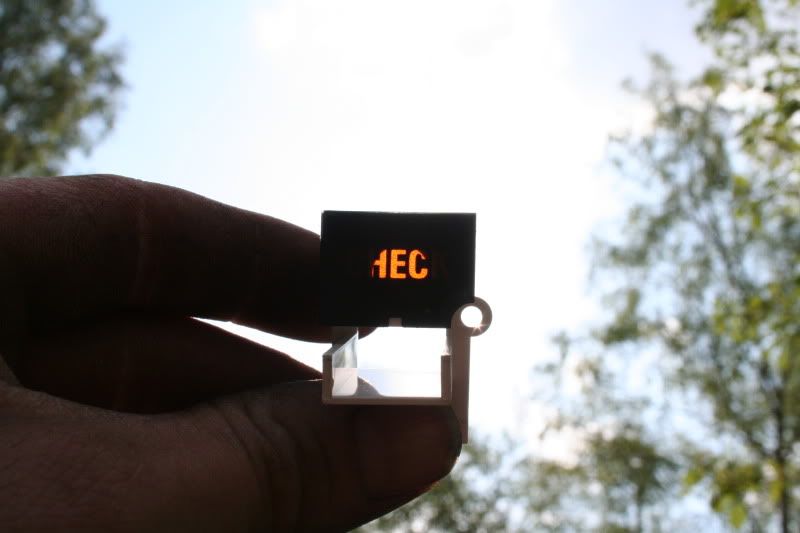

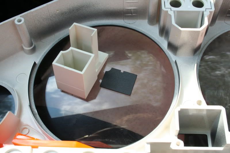

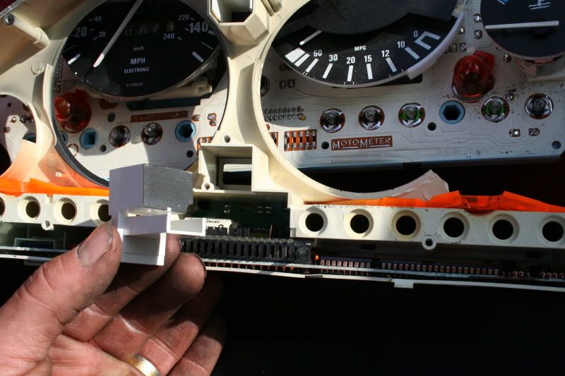

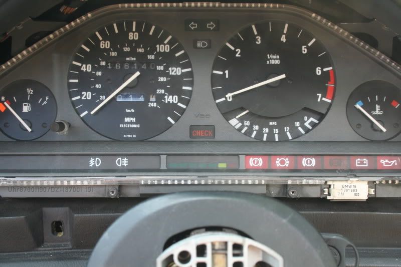

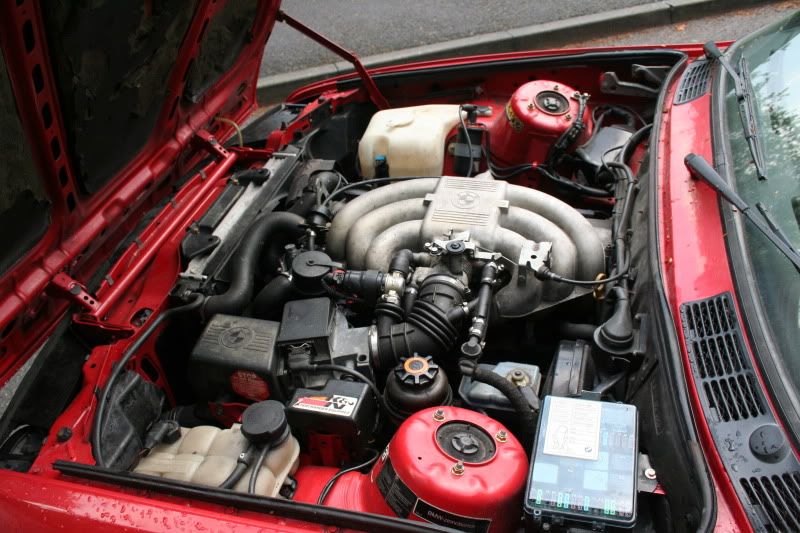

Had to change the clocks as the old ones were goosed. they came from a 4 pot so the coding plug was swapped but it didn't have the "check" bit. So a bit more tinkering
out with the 4 pot blanking plug as such
and in with the check one

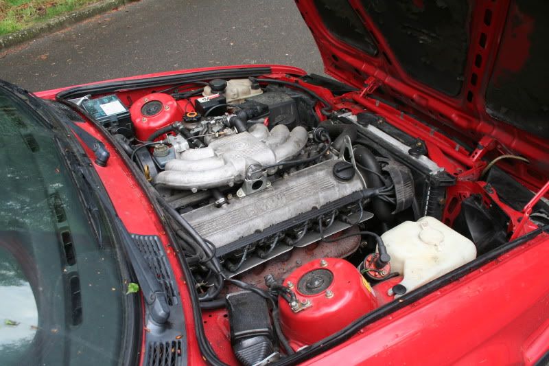

fuel breather system and filler neck back in.

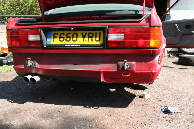

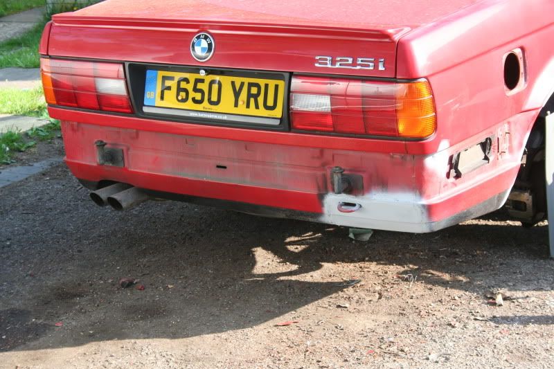

non headlamp wash wipe rings attained from the scrappy. I didn't have any silver paint and i've done this black thing before and thought it looks nice to my eyes
Along with a nice zinnobar red bumper

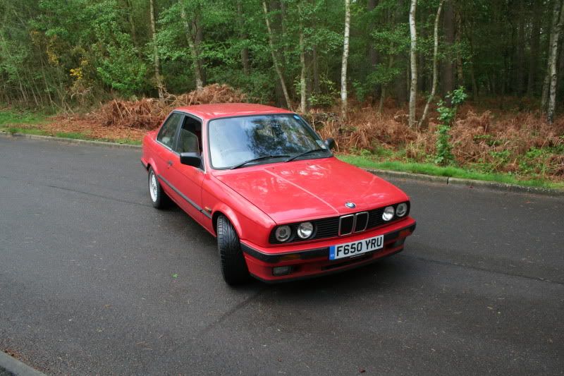

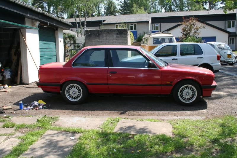

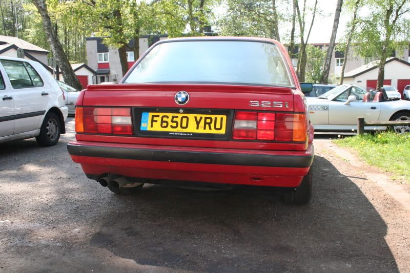

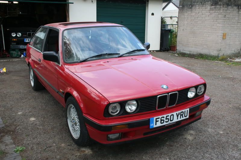

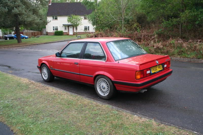

So all back together on the drive
ready for a quick spin around the block
every clip on in re fitted all zipped up here

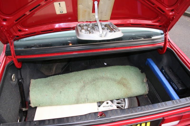

Check the morseled boot! tool kit, jack wheel chock first aid and all that sh!te. Even a torch in the glove box (doesn't work though!)
/\ my attempt at a good photo. Massive difference some colour coded bumpers make, thanks Steve for those
So there we are all back up together just needing a really good homo clean up. But the main point is its ready for MOT so thats booked for weds. Hopefully it won't be nit picked, done my best so all you can do is hope!
