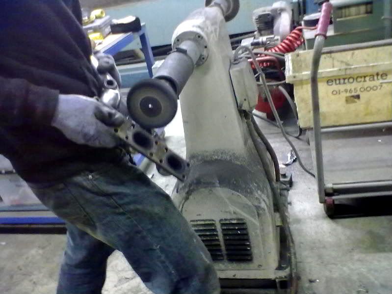

Got my modded M52 manifolds back this week too which I was planning on using untill I was ready to turbo it but these might be being passed onto someone else yet.
Cook318IS
Posts: 4586
Location: Torquay
Post Thu Dec 16, 2010 5:04 pm
Those manifolds look awesome as always! Chris certainly is an absolute metalwork wizard :cool:

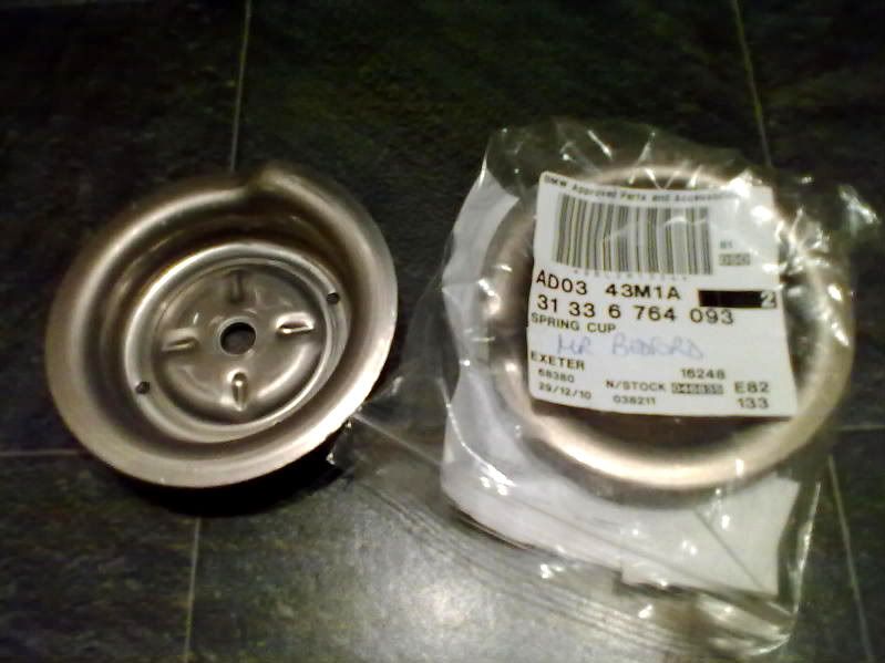

Oh while your here,can you confirm this part number correct for E90? or 92? tophats?
31336764093
Cook318IS
Posts: 4586
Location: Torquay
Post Thu Dec 16, 2010 10:36 pm
I think they are common between the two actually, but yeah you are correct - 31 33 6 764 093

How the hell do you get those manky old manifolds so shiny Tony? :o
eko
Old timer
Posts: 11531
Location: South Devon
Post Thu Dec 16, 2010 11:00 pm
DanThe wrote:How the hell do you get those manky old manifolds so shiny Tony? :o
eko
