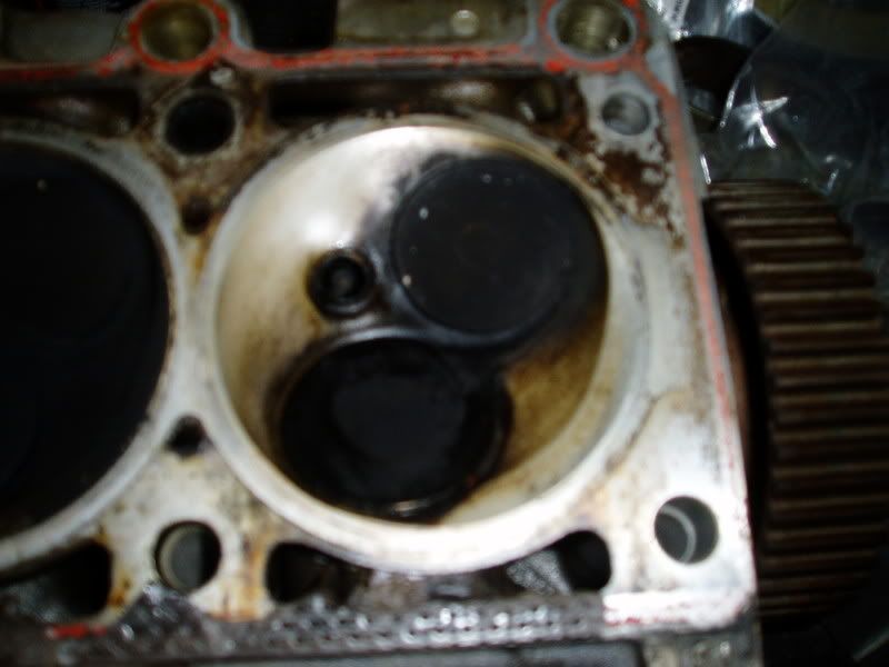

Bloody cars, i just had to look though. Engine will be more of a peach when done and ready for loads more miles. Heads off aswell i gave in to it! Interesting work by Alpina on the chambers also i can see

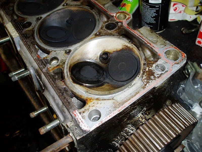

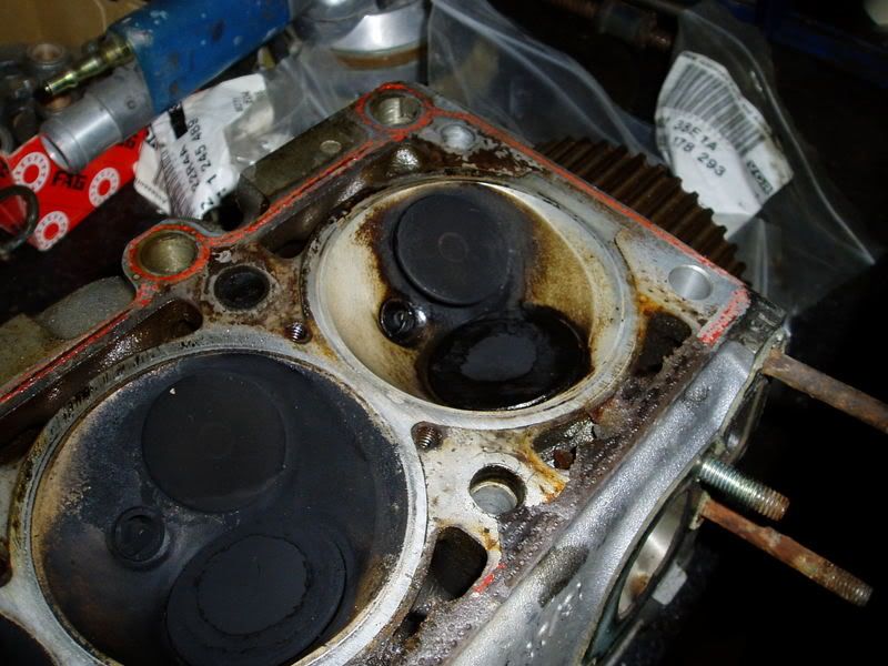

Comustion chambers reshaped though right?
Post Mon Jan 12, 2009 10:47 pm
yes fettled indeed! I'll take a picture in a mo

Post Tue Jan 13, 2009 12:34 am
Running rich on 2?!
Posts: 15846
Post Tue Jan 13, 2009 6:25 am
Jhonno wrote:Running rich on 2?!
Looks more like no.1 has had a bit of a clean up for the photos.
If it had bigger vlaves and was then returned to standard size vlaves, I would have thought the seat insets would have had to be changed as well or the valve would sit too deep in the head.

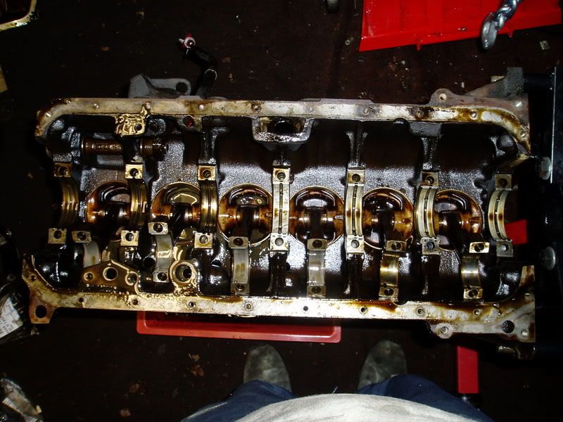

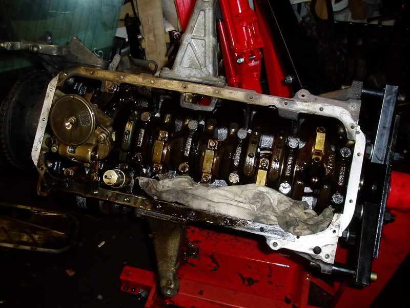

Well here we go next lot!

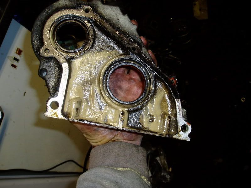

Me cleaning off the crusty useless reminants of the sump gasket

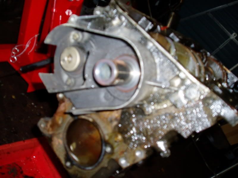

Nose bolt off and removing the cover
Mayo left over from when the head cracked years ago 8O Theres still a bit in the sump!

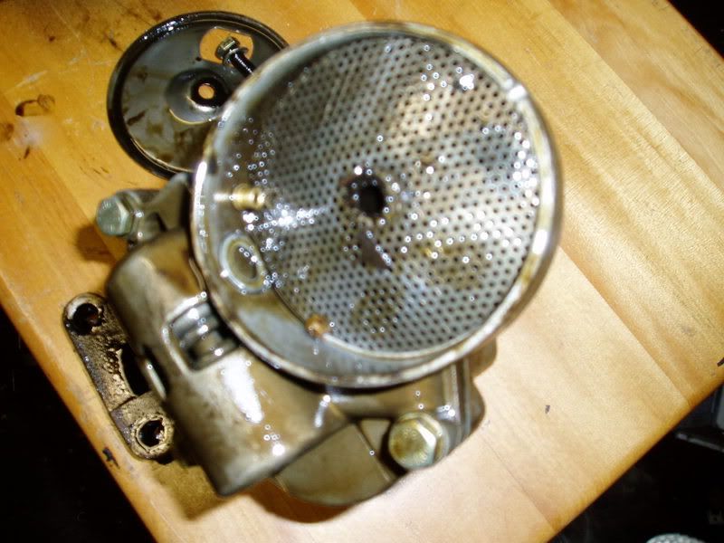

Interesting amount of shit caught by the oil pump filter!

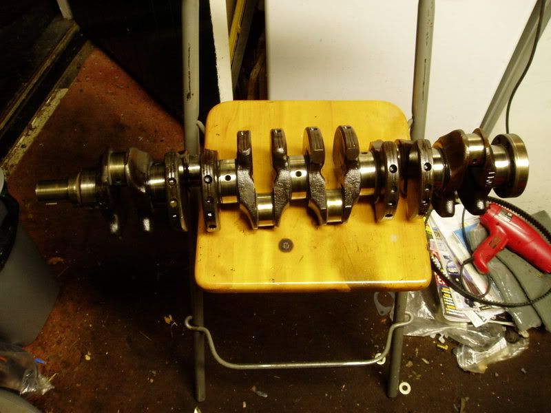

Crank out, my lord they are heavy these TD cranks

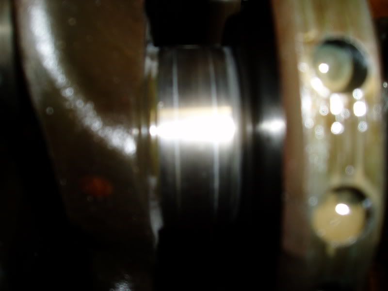

in all it's glory

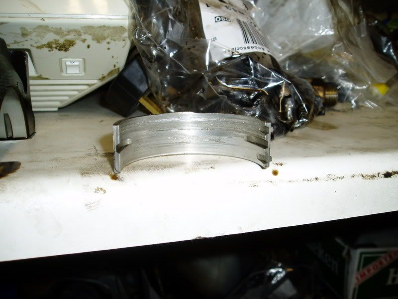

This is the worst on the crank, main end no.2 Now i thought it was a score but a closer look has showed it's actually the coating off the shell and should polish off a treat
No.1 main end cap shell, this is why i got into a flap!

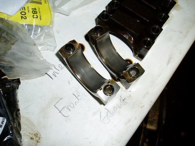

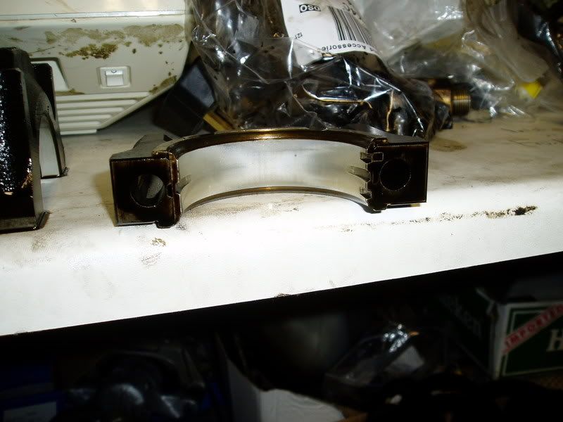

Couple of the big end cap shells. Worn
I've just got back from my dads and these are the measurements
Main ends are all exactly the same @ 59.97mm Standard shell size 60mm. So all is good here
Big ends vary between 44.983mm and 44.978mm, Standard shell size is 45mm
We are off the opinion this won't be needing a regrind and is raring to go still! My old man seems to think i may have caught this at just the right time as it could of got alot worse in the next few 10k or so......
I think we have saved major future dramas, happy bunny then
Post Wed Jan 14, 2009 12:11 am
It pays to do these things when its out, especially at that mileage.
