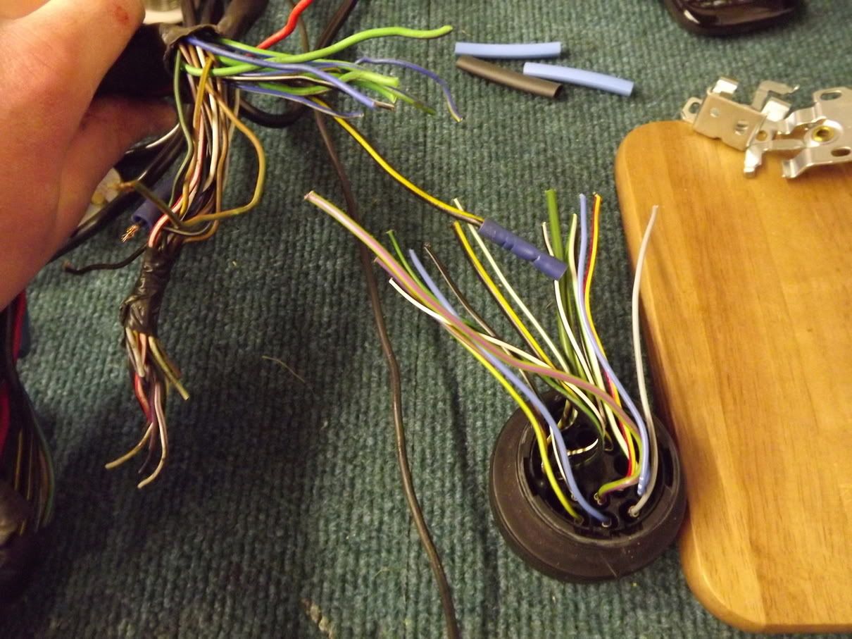

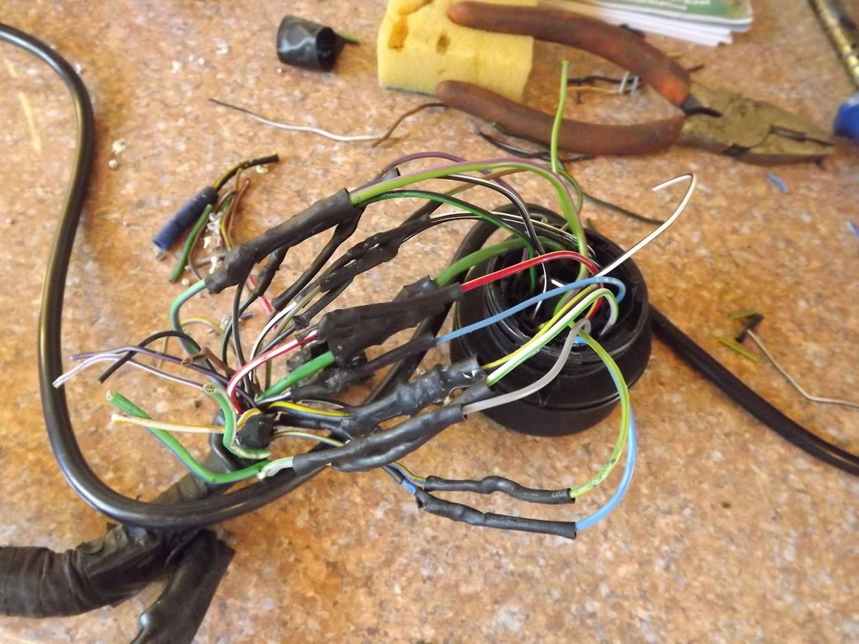

Right wonder if someone can clear some confusion up
ive got a decent c101 connector from an m20 however do i wire it up color for colour ? or does someone have a list of what colours go to what, the one in my other thread confused me as all the pin numbers and colours were different. i didnt want to go of the connector i cut off as i'am not convinced the wiring is correct as the rev counter didnt work and i had 3/4 of tank fuel but light was one. half the crimps just fell of and some had allready came apart, how it ran i would never know. might be half the reason it sometimes runs iffy and sometimes perfect
Reason i havent got a new loom is because i looked at my bank balance this morning and need to leave some money for the rest of the month
Got plenty of heat shrink and bmw fabric tape so shouldnt look too shabby when done

I would first identify what colours to what pins you have on the car loom side of the C101
The file I sent you has all these wires on it mate, Don't forget you only need 5 or 6 connected to make it run.

soldering it all together now and iam finding the wires on the m30 loom to be the same as that of an s38 no wonder iam confused
looking at where the previous connections it was also wired up to m535i colours

- Posts: 22665
ive done everthing colour to colour apart from the two oil level sensor wires which ive done as per s38 as there are no matching wires.
Ive cross referenced every pin number from here and the wiki
http://img.photobucket.com/albums/v102/ ... ing1-1.jpg
however i'am left with no abs wire on the m30 loom :S
according to this i think ive done the right thing with the oil level sensor

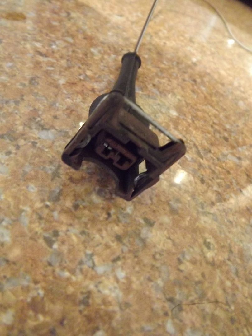

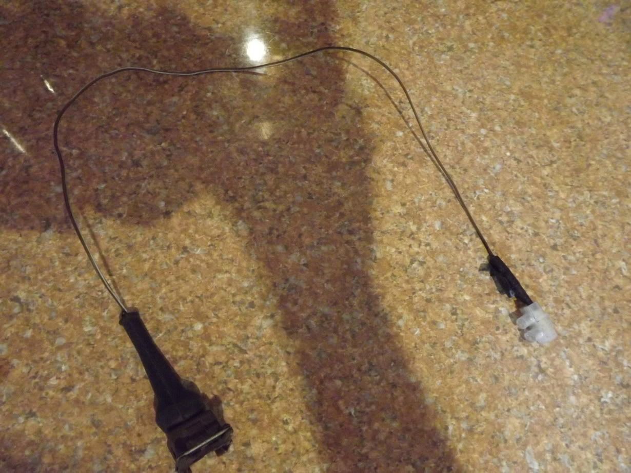

- Posts: 22665
i pm'd bristol_jr and it apperars ive wired it all correctly apart from the two oil level sensors (static and dynamic)
here what it looks like ive got some bmw fabric tape and will remove the unused wires.
these are the last bits i need to sort out
Green/black wire for underloaded relay what ever one of them is
and i belive this is the oil level sensor but i'am unsure where this connects to, not sure why it was removed originally
