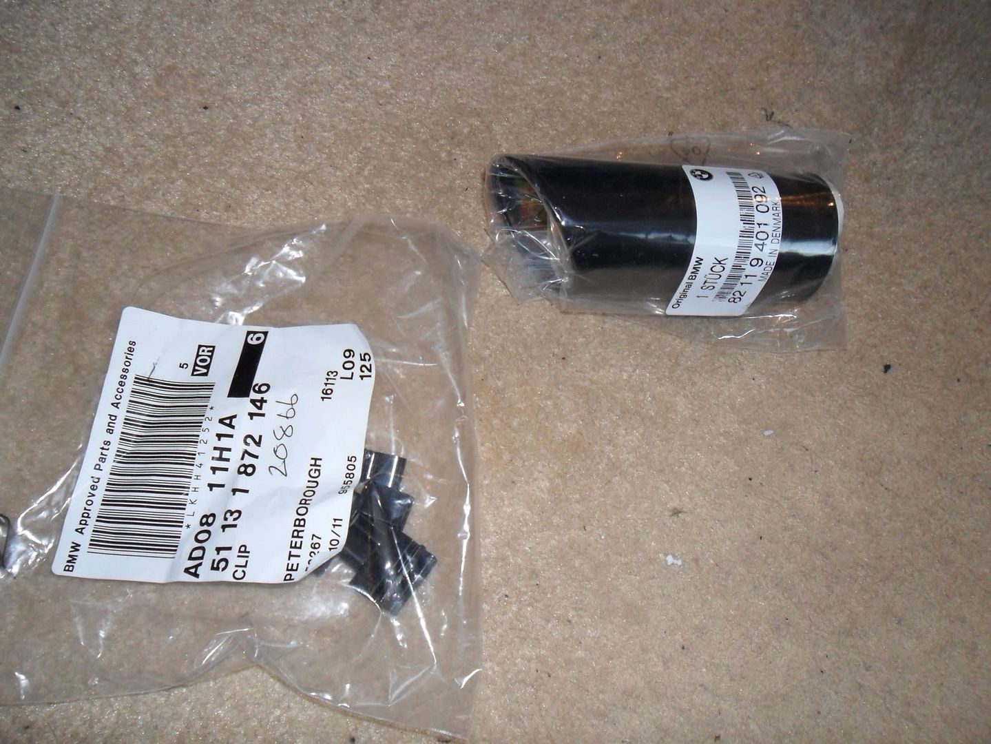

nice new exhaust trim and some new grill clips

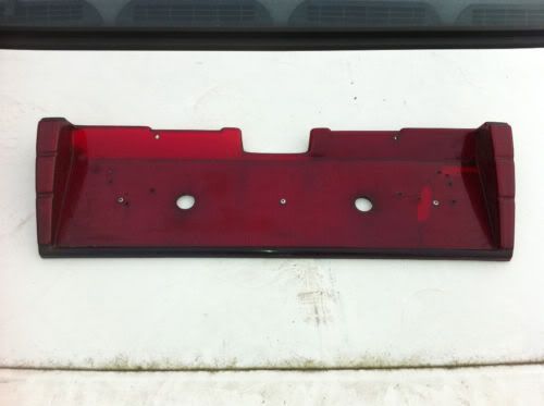

ive also got a heckblende on the way, need to think of a way to fill the lock cutout but might not be noticable when fitted.

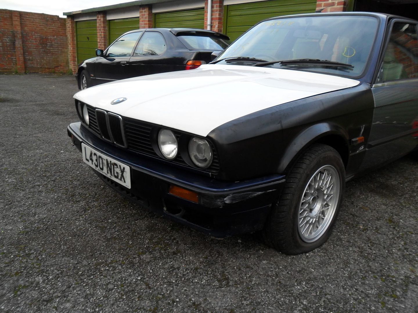

Car is off for paint on the 11th Novemeber should get it back the following Monday/Tuesday

How much was the Heckblende? I have seen these sell for stupid money before

£50 posted from germanyJim320i wrote:How much was the Heckblende? I have seen these sell for stupid money before
Has a crack in the reflective bit but its behind number plate so you cant see it. they certainly do sell for daft money

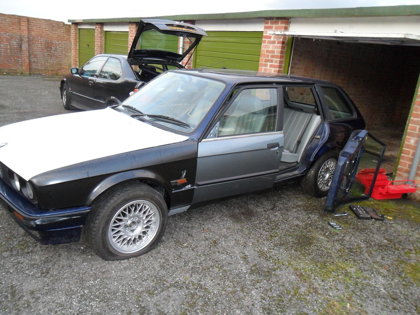

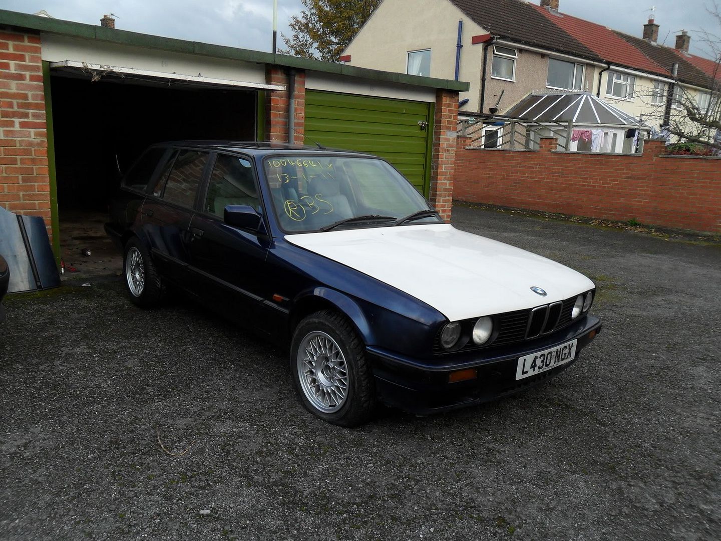

Going to get it ready for MOT tomorrow, and possibly get it MOT'd before paint so i dont have to clart about fannying on with getting it transported etc.
- Posts: 22666

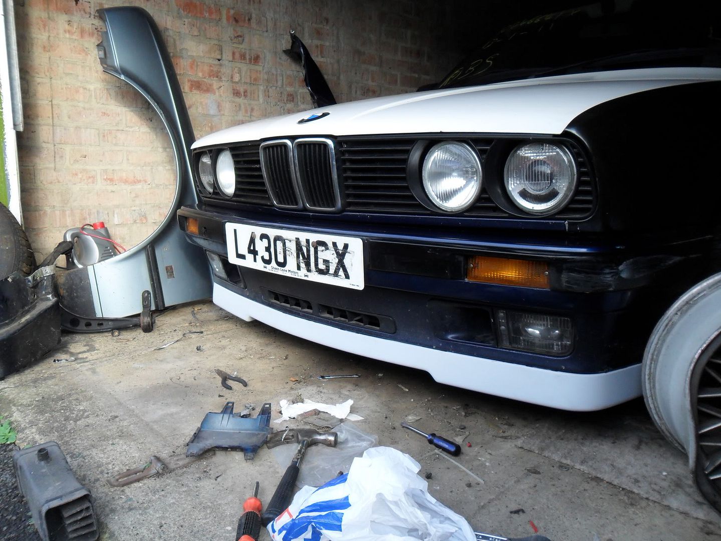

Nearly ready for MOT, going to tax it soon now i have log book, ive managed to fix my broken indicators, the wing indicator pins in the socket had come out and were touching shorting the circuit out.
I also fitted the new tie rod end, what a B@stard that was too do, the thing kept spinning when tightening and undoing the nut
for MOT i need to fit my washers, Fit an indicator bulb and fit new brake light switch and i'am confident it should pass

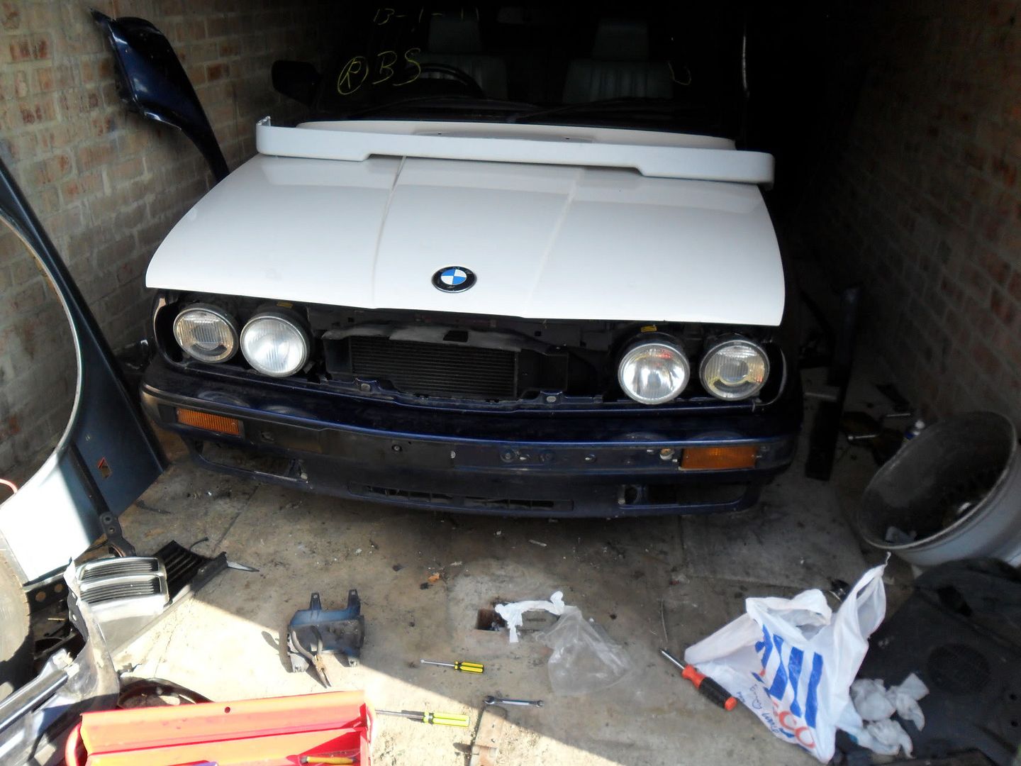

managed to get the front end all together today, going to order some new black trim that goes round the bumper i think, and will get some dealer plates made up.

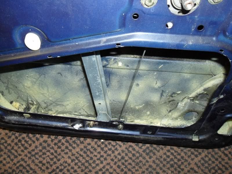

i also tried knocking the dent out the back door, the larger one popped out but the bottom was too creased / dented so need to swop all the internals into a new door which i have, bit of a pain in the arse, why do people remove absolutly everything when you buy a door
I'am hoping to get it mot'd before paint that way i dont need to fanny on getting it transported to the paint shop
still along way once the outside is done i can get stuck in with the interior

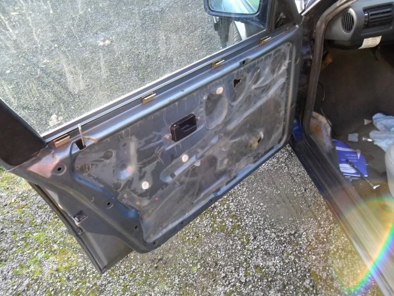

Easy,capri_rob wrote:I've got to swap the drivers door on my Touring - been putting it off for months because of all the internals needing to be swapped over
Take door off leaving body supports bolted in place - open door, unclip barsteward stop clips and remove pin - open wider (but not to wide), undo nuts on hinge pins and lift off (tricky with wing on but can be done)
Lay it on its back on suitable supports
Remove trim/gubbins as required
Fit new gubbins/trim as required - you will not find a simpler way to replace lock barrels
Re hang new door - do up nuts, clips etc
Then spend ages shimming and lining up -

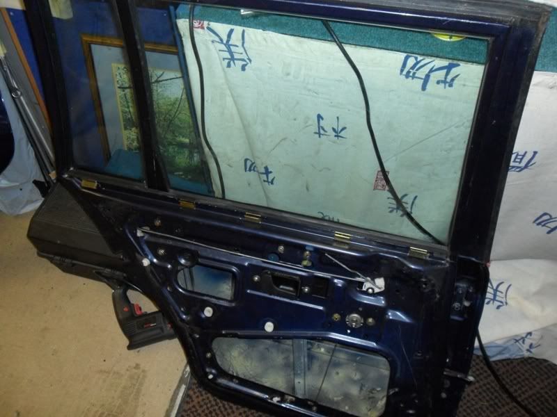

All finished and working as it should, all little odds and sods done.

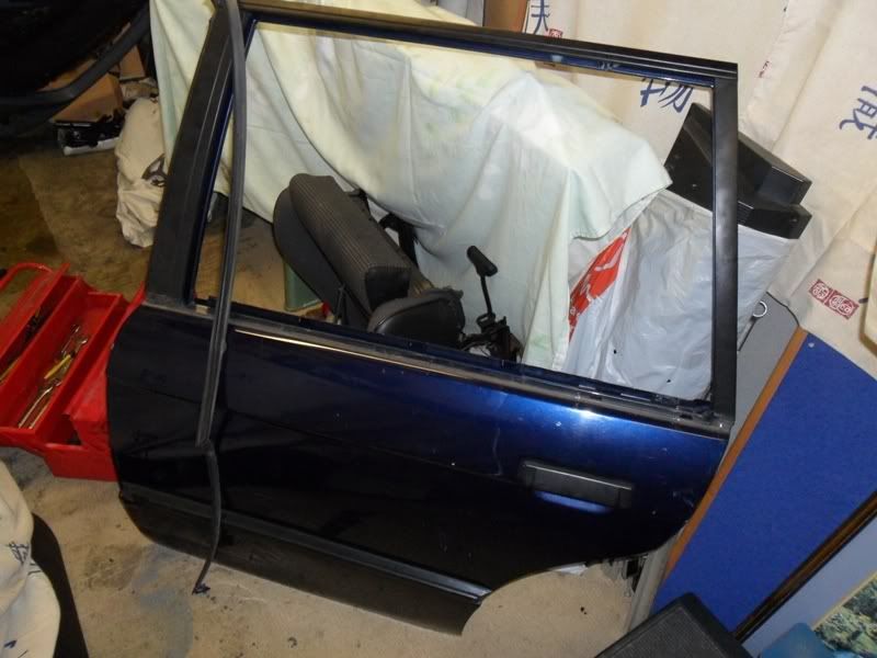

Swopped all the internals into the new door took a good hour and a half
old door, looks perfect in the picture but the lower half is crippled to death
new one, wrong colour like the rest of the panels, however to save cost ive said to the painter it wont need painting both sides like the rest of the panels, he was happy with that.

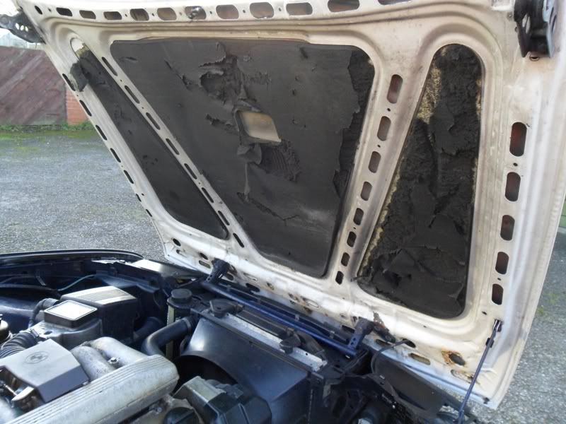

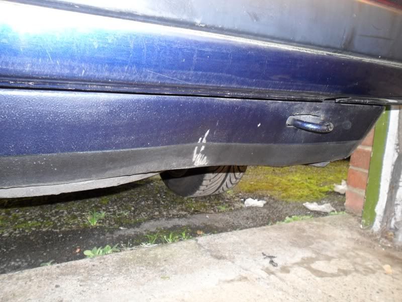

wanted to take some before pictures of the crappy areas.
Just a case of driving it down to the mot garage now, day off on friday so fingers crossed. its only done 2000 miles since last mot and no advisorys were given.
Getting a little excited now, cant wait to be driving a proper bmw again, the compact is shite.
