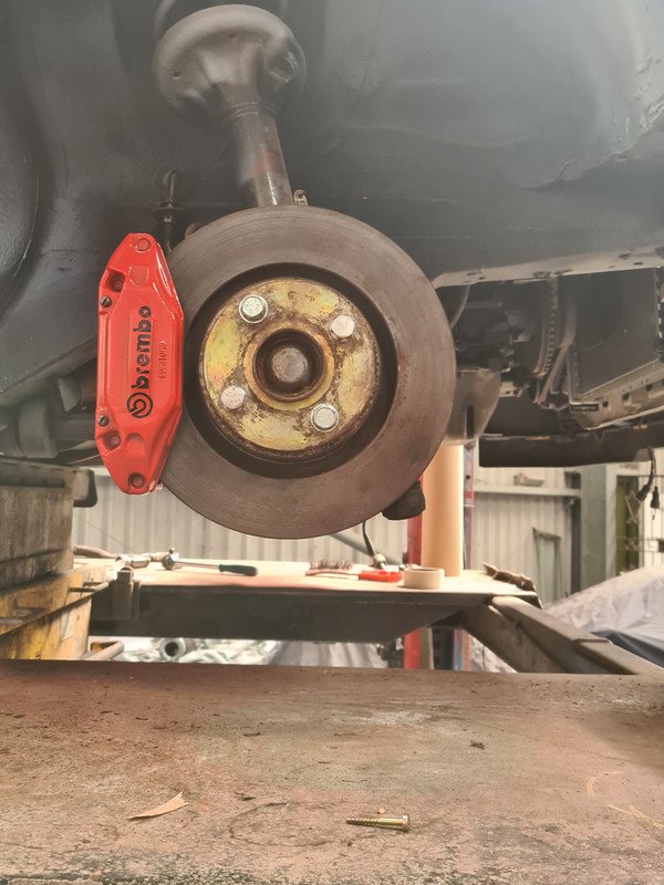

Not much of an update . Pre mot wash i noticed the rear brakes are binding and will need to get it sorted out before it goes.Fitting another exhaust system as the old one was teabagged and i will need to sort that out to get it sitting right at the rear valance but it's on and not blowing.

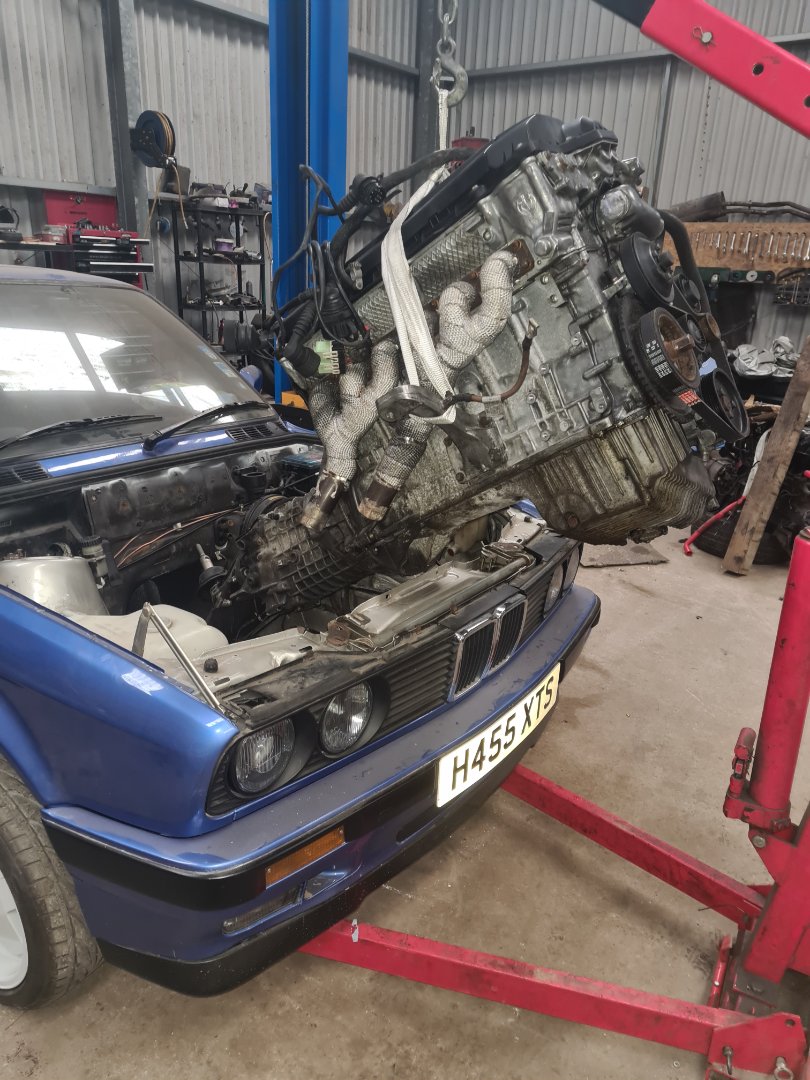

Work got in the way of getting this mot'ed before the winter . I did break my e38 728i so thought why not stick the engine in the e30 while the weather is crap.
Engine is about ready to go in after doing the water pump etc and getting the Danthe loom fitted .
I bought the loom off another member that was breaking his m52b28 e30 which was fitted to an e36 m52 .I might be missing something or e38 m52 might be different but i can't see a plug on the loom to connect the coil packs?Also the plug on the oil level sensor doesn't fit .
Anyone had the same issue?
Another think is are the e36 lambda sensors shorter? using the ones from the e38 the wires are tight against the block when i bolted on the rear manifold.

Those are the correct lambdas, the rear one is close to the block because the manifold has to be moved away from the steering linkage, the gap can be made smaller if you tighten the bottom row of manifold nuts first, and alternatively bigger if you tighten the top row of nuts first, its always best to use new gaskets

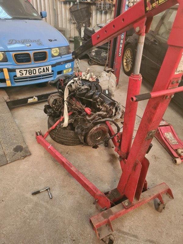

m20 is out and m52 kinda ready to go in tomorrow.

Had fun yesterday getting the m52 in and on its mounts not an easy task on your own .

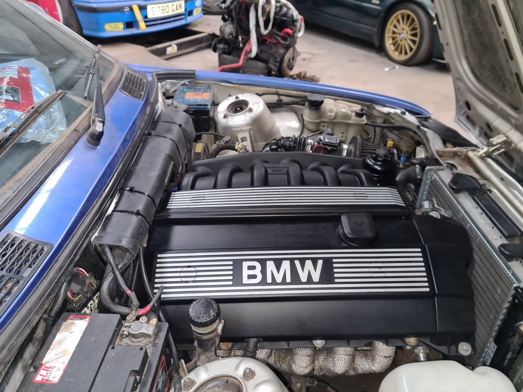

Wee tidy up in the bay and a wipe down of the plastics .
