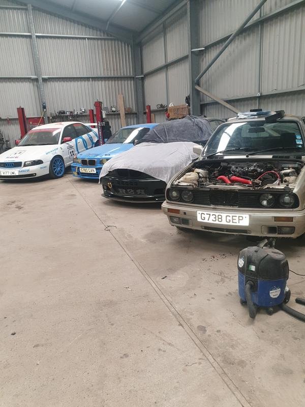

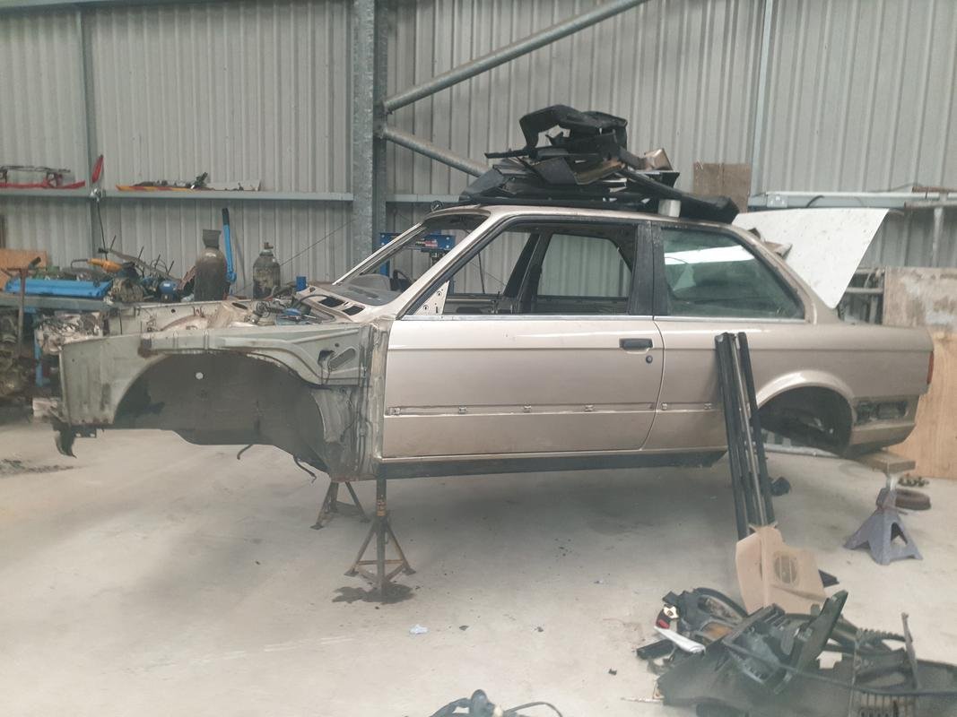

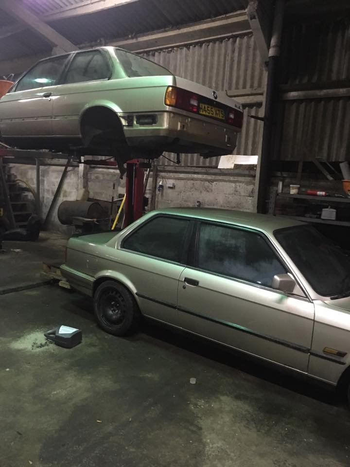

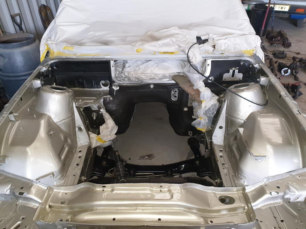

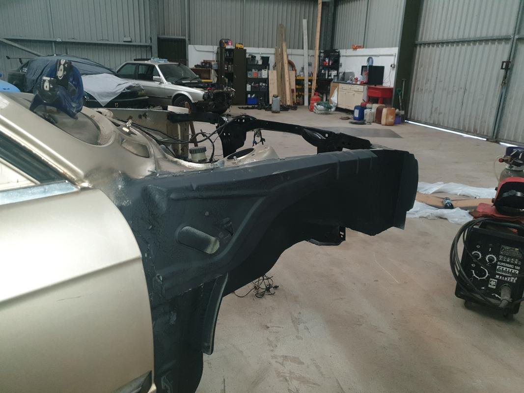

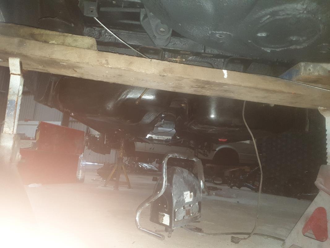

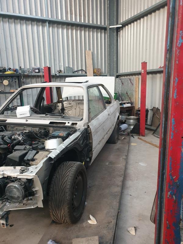

Bought these two with the intention of swapping everything into the shell which is i really good shape.
Got them back to the garage and made a start on tidying the shell up ready to start bolting bit onto it.Three very small bits of welding have been done ,a new slam panel (someone used it as a jacking point ) and all loose underseal removed seam sealed and stonechipped.

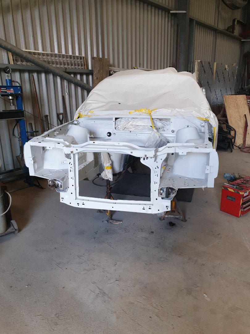

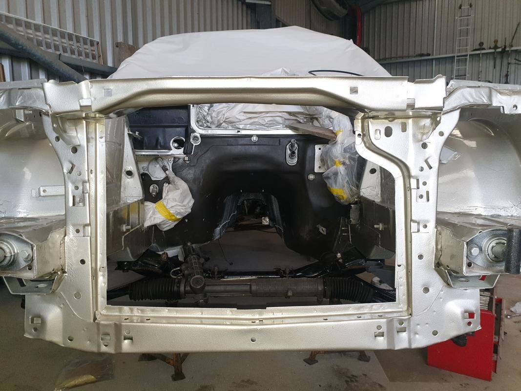

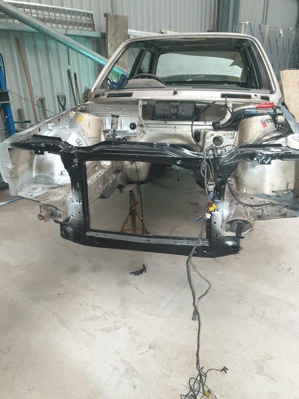

Engine bay primed

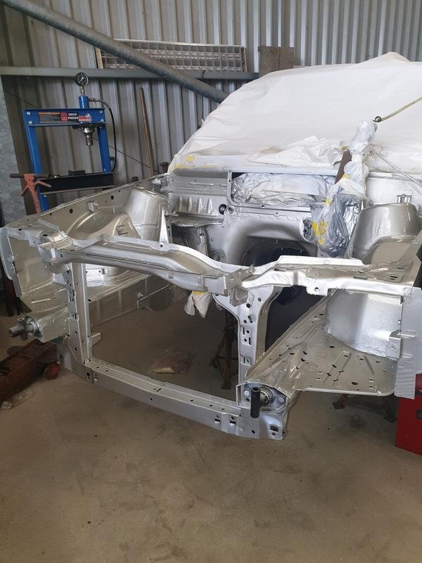

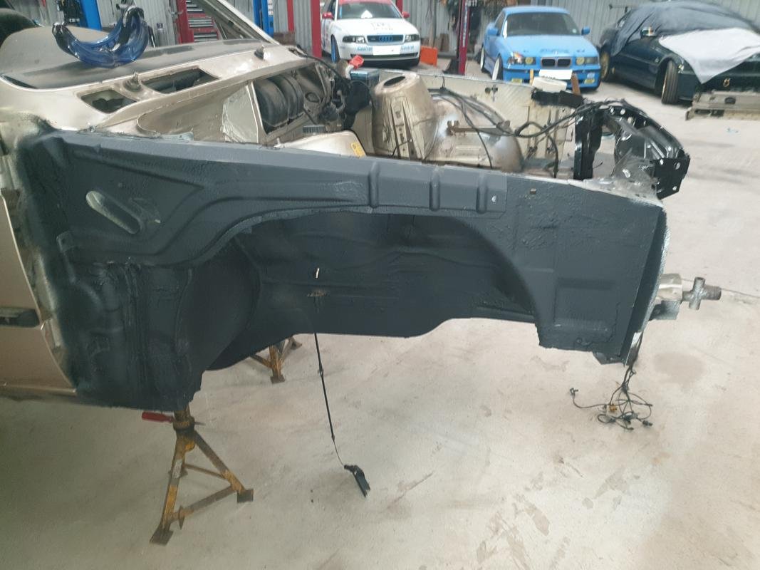

Bit of colour on the engine bay

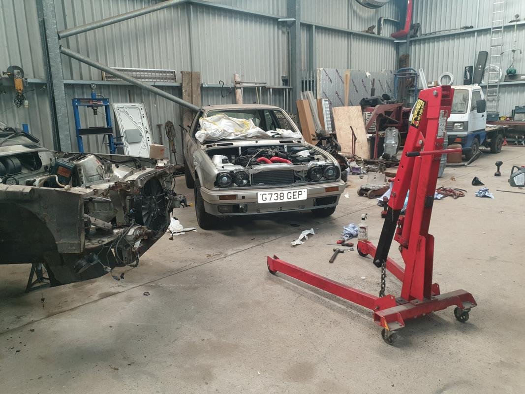

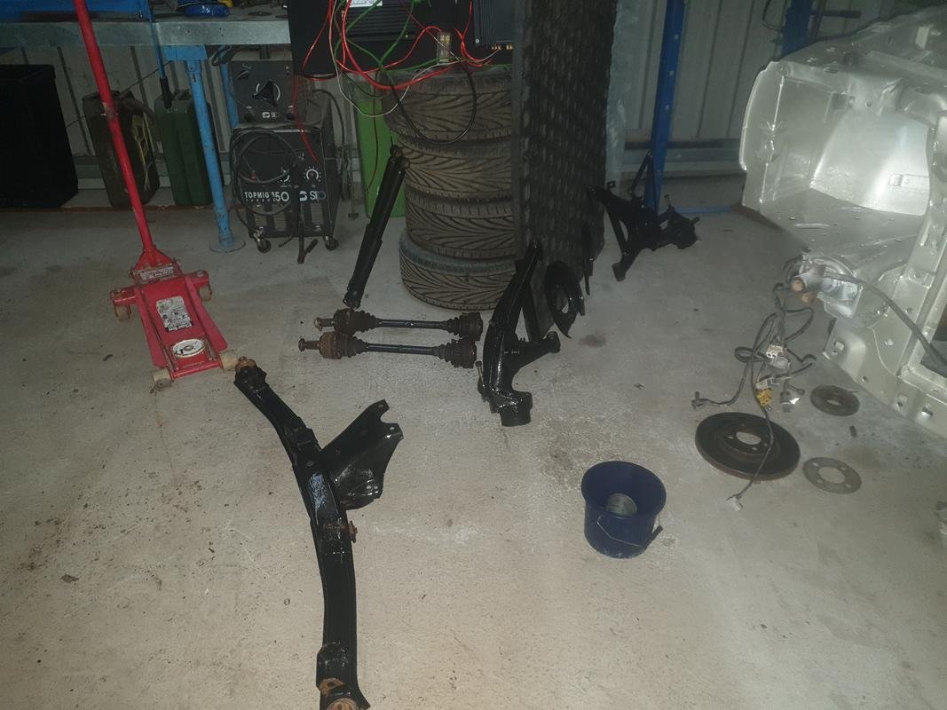

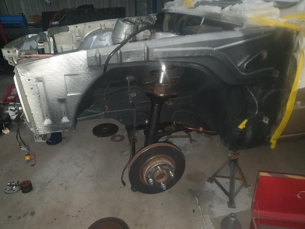

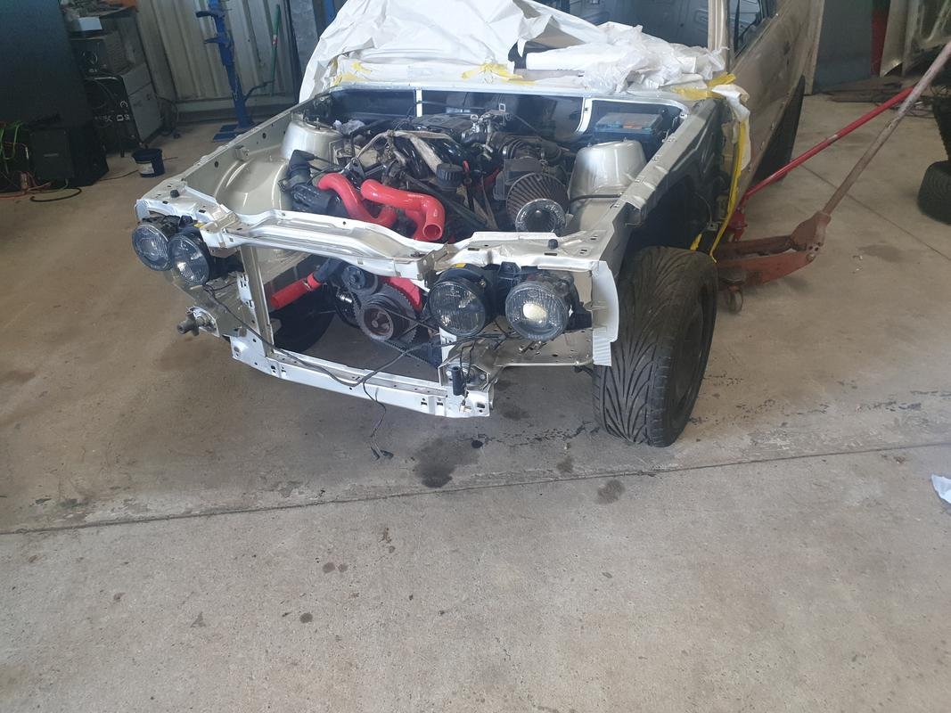

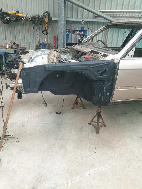

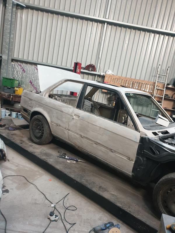

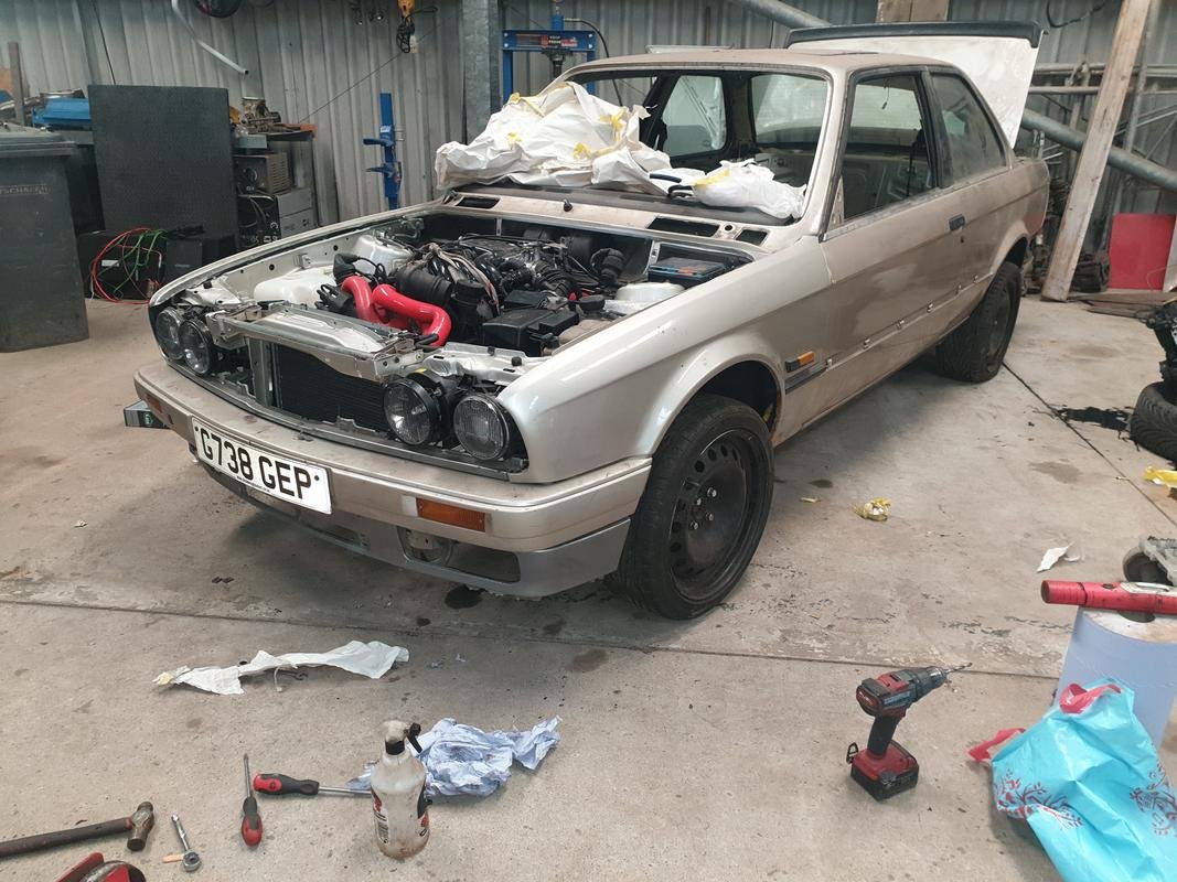

Donor shell stripping has begun

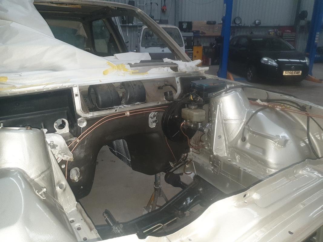

Bit more done as can do with this rolling soon.Few bits wire wheeled and coated in black hammerite.
Brake lines ,clutch line and fuel lines all done.
Petrol tank bolted into place and front struts loosely sitting in place .

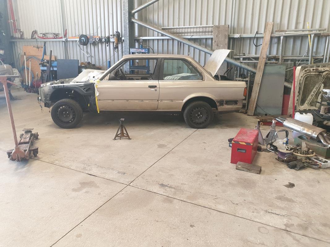

Back on its wheel for the first time in over ten years
Pretty decent suspension set up from the donor which is blistien b8 shocks front and back ,eibach springs and h&r arb.

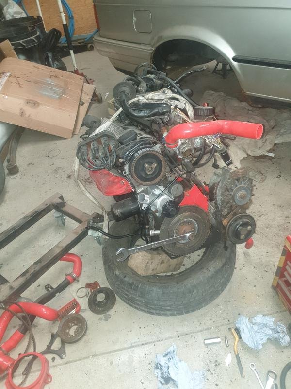

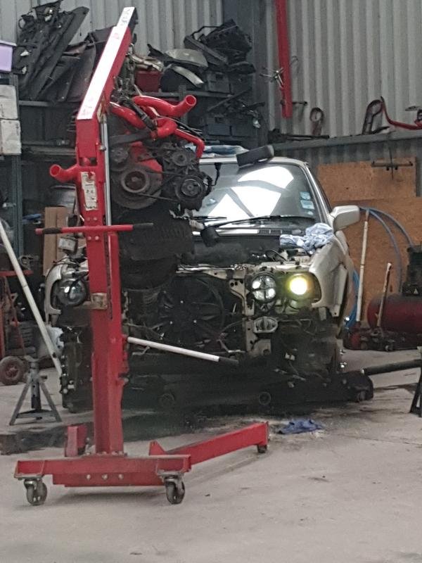

Water pump ,tensioner ,timing belt and thermostat done.(i did swap the broken rotor mounting bracket)
Engine back in the hole

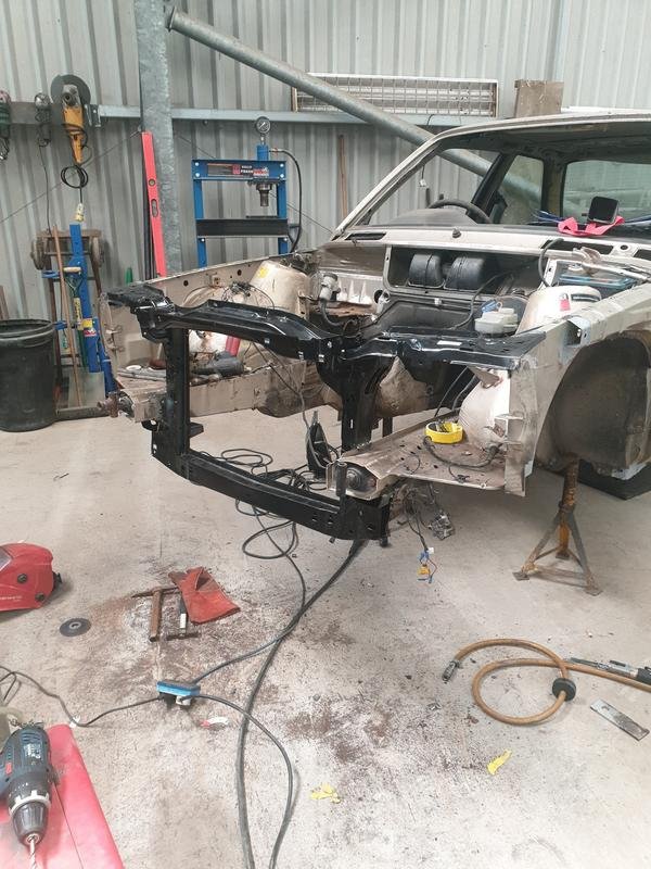

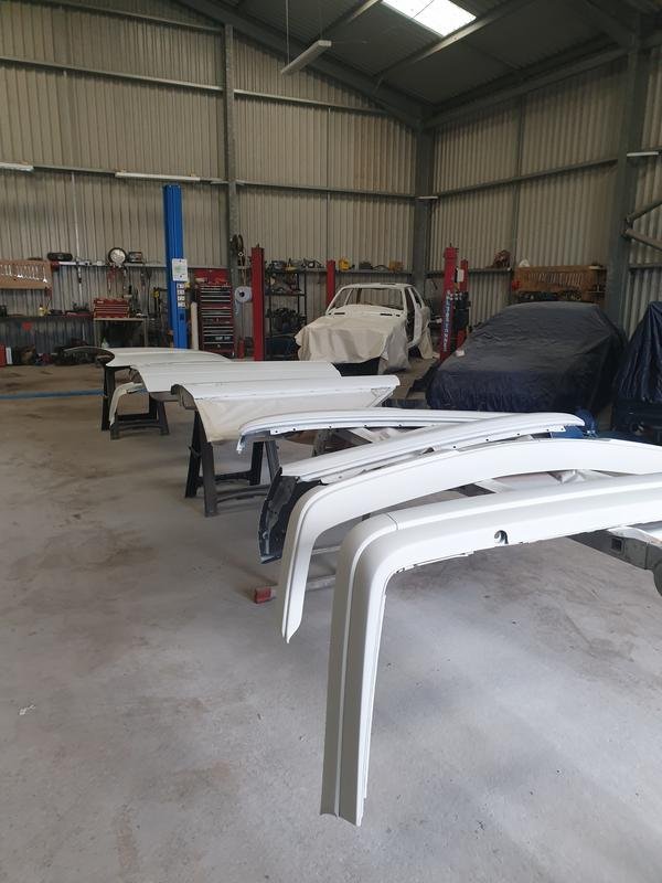

Loosely test fitted the front end and wings to check the front slam panel positioning was ok before i start prepping for paint. Glad to say everything looks like it will line up ok .

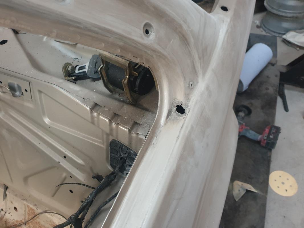

Started rubbing down in prep for paint and found another small bit of rust that needs addressed.

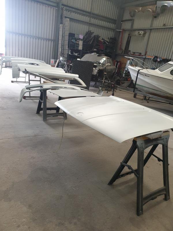

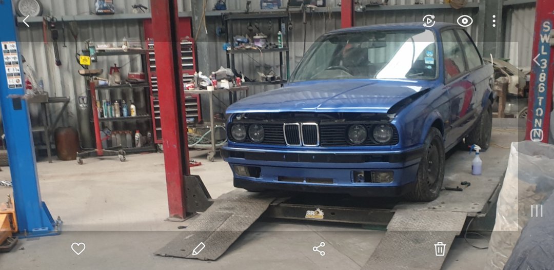

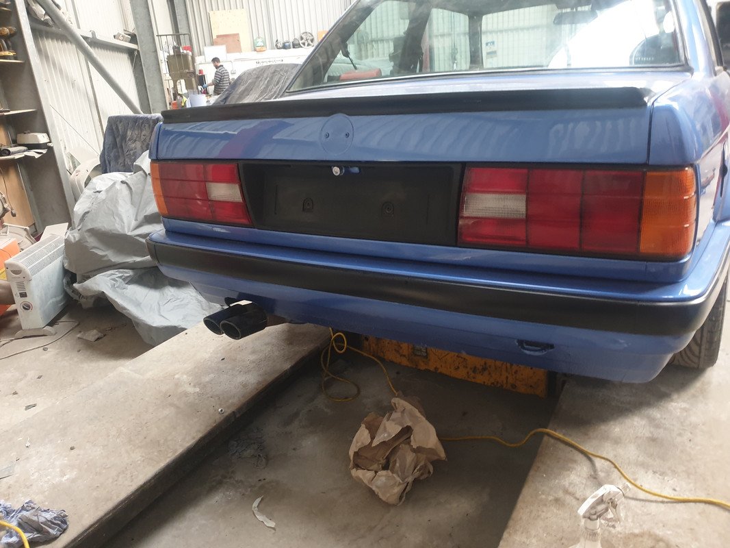

Finally got some paint on .bonnet has tiger stripes and not had it outside to see if the metallic is patchy (probably will be )
Lost the will to live painting this ,first attempt was a bit cold so rubbed back down ,second attempt got bad reaction in places so rubbed back down barcoated and re-primed whole car again .I should stick to plumbing :mad:

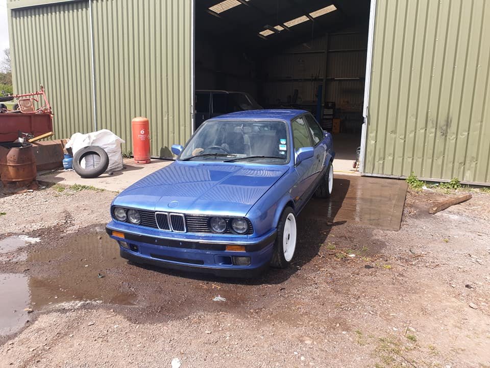

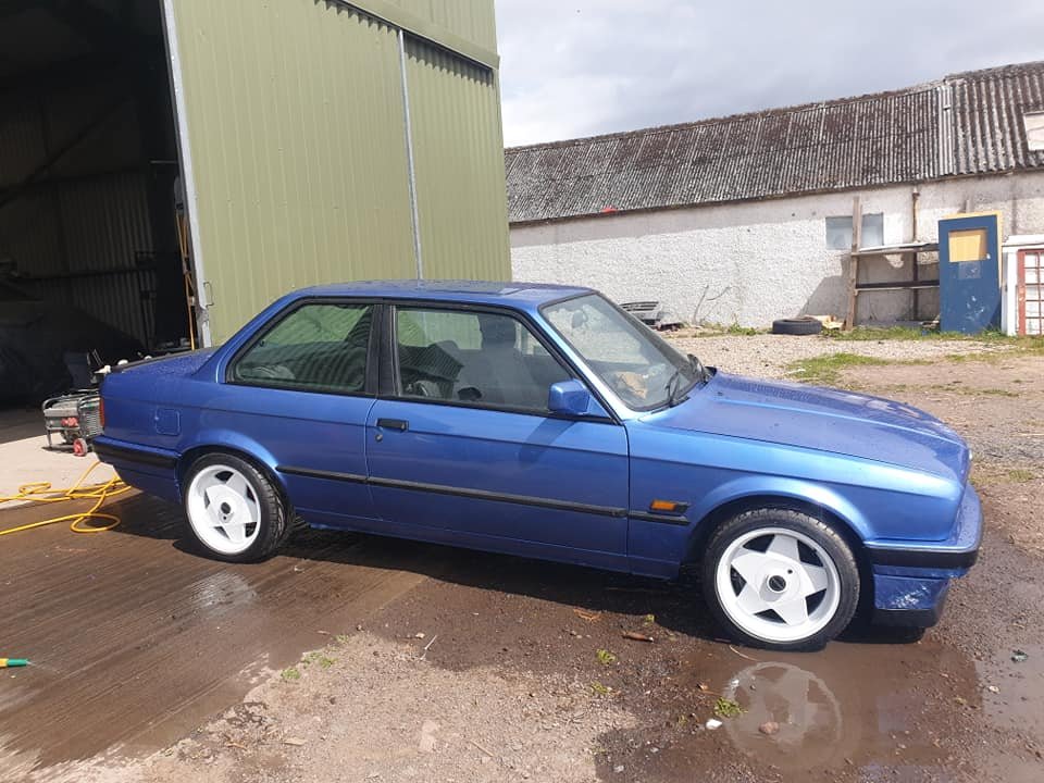

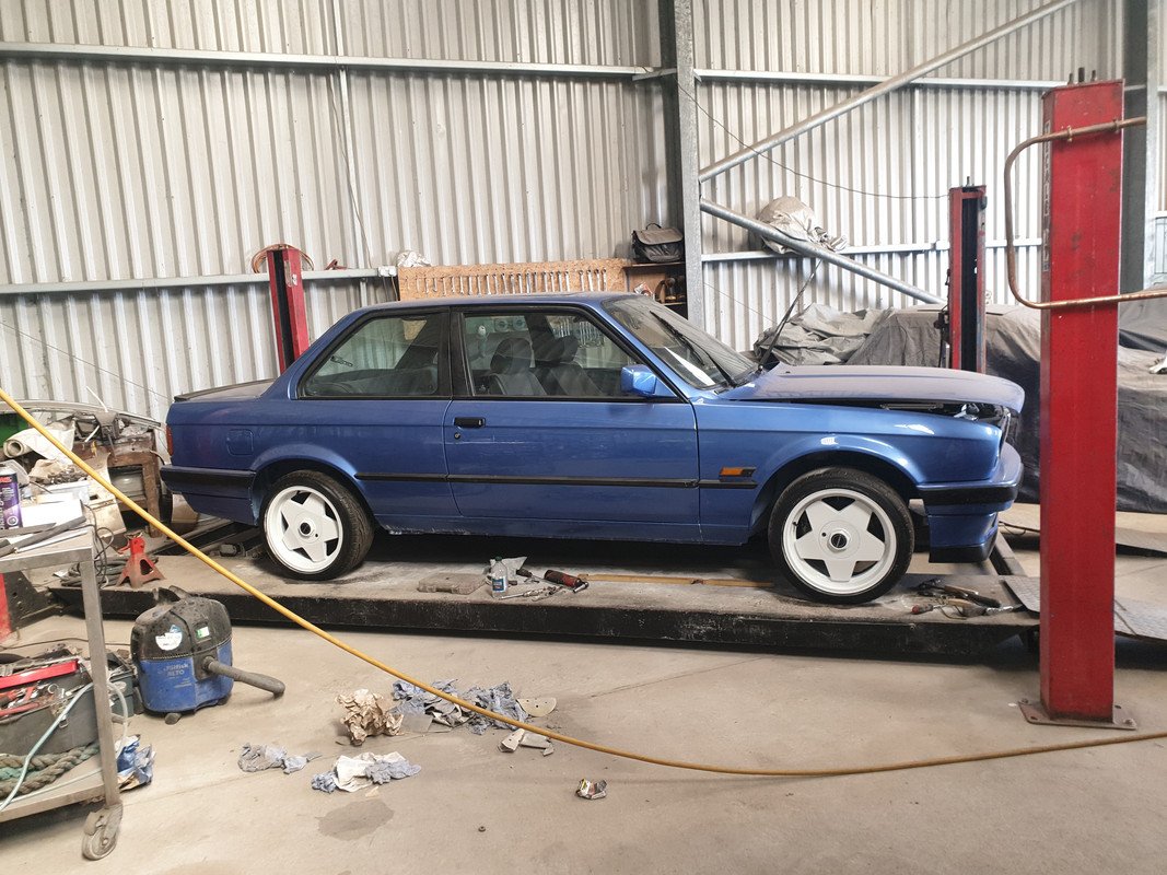

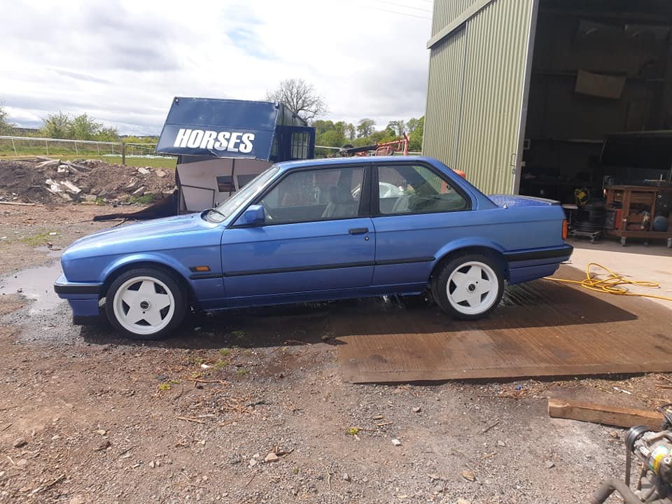

Thought i would try the borbet a in white ,but not sure tbh.
Ride height is way to high ,not sure why as it was fine on the other shell before i stripped it surely it would have settled by now if it had to settle at all.
Anyone any thoughts on the ride height ? Only difference now is there isn't a sub box in the boot .
SeanOB
Posts: 156
Joined: Mon Oct 12, 2015 11:00 pm
Location: North Wales. UK
Thu May 07, 2020 10:55 am
I think the blue and white combo looks great!
Did you put in new top hats and spring pads when you swapped the suspension over? My only guess as to what might have lifted it. That, and the low profile tires might exaggerate the gap.
Will look perfect if you can get her to sit down a bit winkeye

Everything off the old shell was put on to this nothing was changed as the suspension had under 2k mile on it . Even the tyres have been swapped over for the 16" steelies . I was wondering if a drive would sort it out as it hasn't left the garage but i reckon it won't.

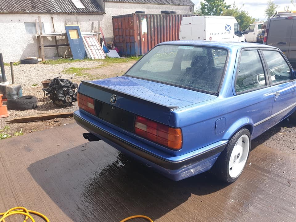

Got it outside today and apart from the bonnet having tiger stripes i'm happy .
