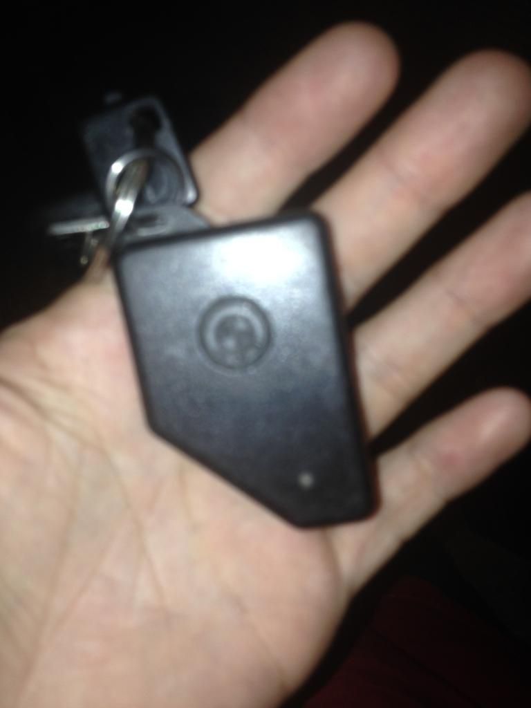

I may be wrong but I didn't think any E30's came with factory remote central locking so its probably a faulty after market part
Put a pic up of your central locking fob, I'm guessing its not OE.
If its not OE your best bet would be to rip it all out and get a new system

BROOMY
busy saving Clifford
Posts: 425
Sat Jun 28, 2014 4:40 pm
As I say it all works but not the BMW clicker.
pac1982
Posts: 5330
Location: isle of wight
Sat Jun 28, 2014 4:43 pm
BROOMY wrote:As I say it all works but not the BMW clicker.
ok that does look genuine so I'm probably wrong about E30's not having factory central locking but if it is its no doubt very old and probably just knackered BMW can probably supply a new one, but would be a lot cheaper just to fit a new after market system

Does the little LED on the clicker work ?
I have one of those clicker fobs available if you need it; they have a 145026 code chip in, and you bridge the appropriate pins with solder to create the required code.

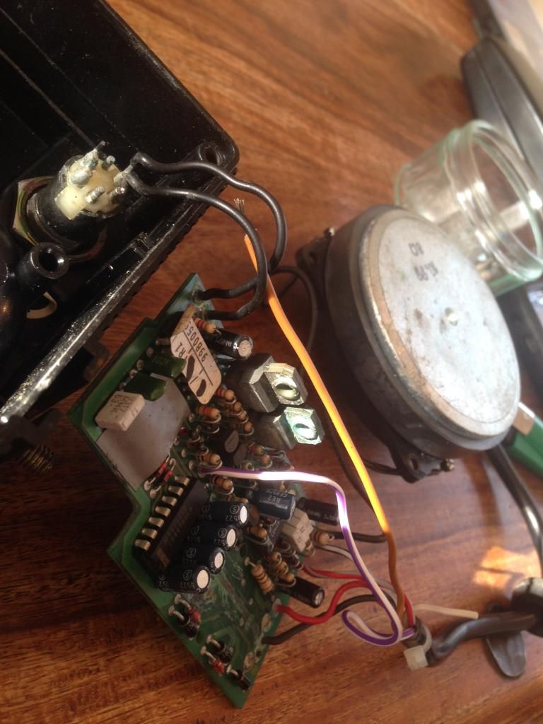

BROOMY
Posts: 425
Sun Jun 29, 2014 7:03 pm
Found out someone cut the wire for my alarm.w*nkers.
So all cool now . But the wire still off got all to lock n all sorts.
BROOMY
Posts: 425
Sun Jun 29, 2014 9:40 pm
And anyone got a picture of the alarm key wires so I can see which goes where? I got the 2 blacks on there

Posts: 14069
Mon Jun 30, 2014 1:01 pm
You could use a multimeter, or rig up a test lamp circuit, to find out which poles of the switch open and shut as you open and close the key.

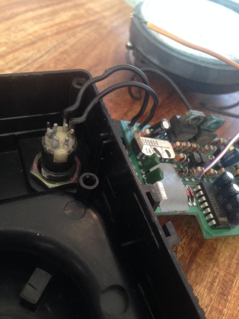

Posts: 14069
Mon Jun 30, 2014 2:11 pm
How many wires are you referring to? In the photo above, you have the two black leads going to the lock - surely, you can see which pins they are/were soldered to? :?
BROOMY
Posts: 425
Mon Jun 30, 2014 2:13 pm
Yes but I got a brown n a black wire that also go to the lock but not attached .
So I wanna reattach them so I need to know which go where.
Posts: 14069
Mon Jun 30, 2014 2:19 pm
Brown is usually earth (0V) on German cars. You can see the solder on the lock pins to which wires were once attached.
Sometimes, you can work it out by carefully examining the solder joints on both the wire and the item to which it was once attached, looking for a match in the shape of the remnants.
