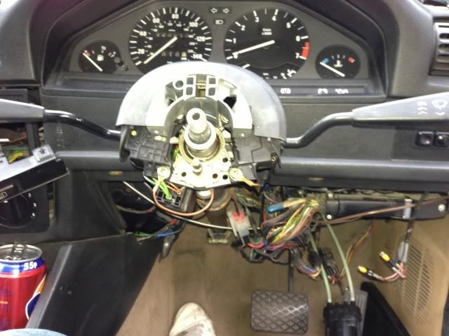

Popped down to see Mr andyp to get a replacement hazard light switch when I plugged it in it still did not work!!!
After explaining how the problem came about he wasn’t having none of it and whipped into action wasting no time "man on a mission" in a matter of minutes he took my steering wheel off and swapped out the relay and "hey presto" it worked!
andyp TOP BLOKE!!!
The offender:

Is the extra wire you are reffering to the brown one? I put that brown wire in to demontrate the right indicator works from the hazard light switch.

No, I was referring to that red wire with the yellow going into it, with the blue crimp connector.

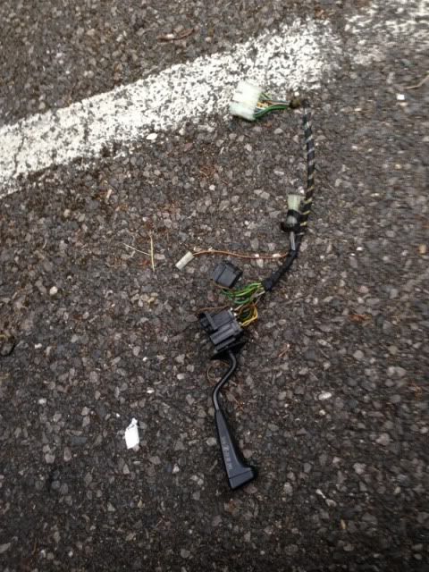

Dig a bit of digging around.....
Swapped over the indicator stalk now it's all sorted!
