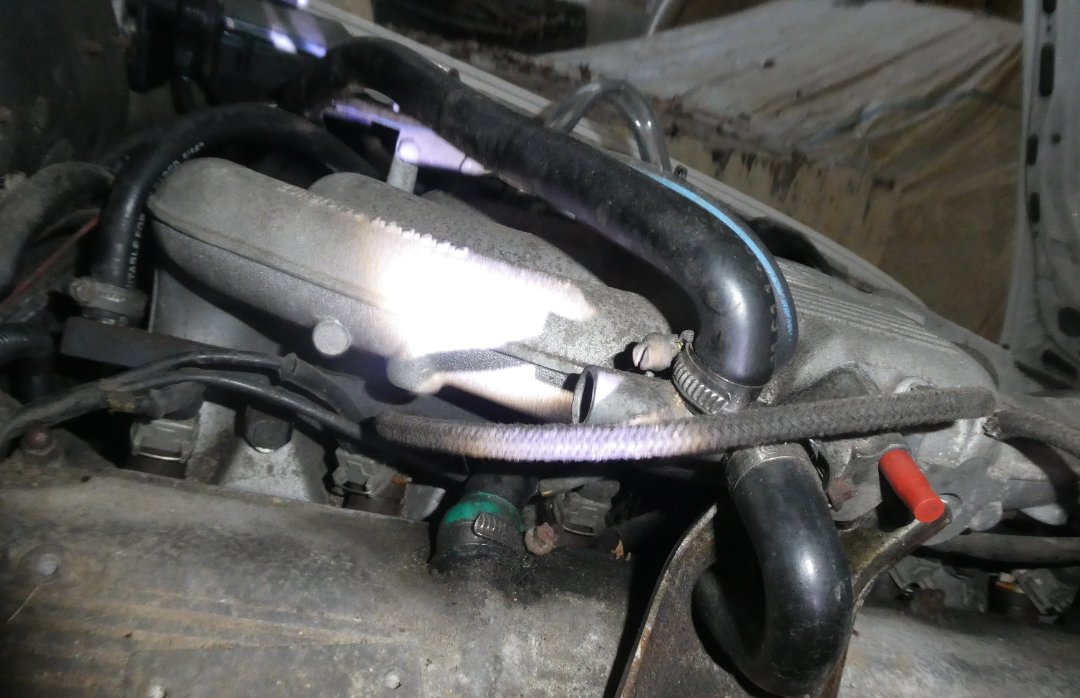

Yes, at least you've now had it running for a few seconds and it sounded quite healthy. What is what appears to be a half inch or so diameter inlet/outlet pipe under the rubber hose, and what is the red cap for?
riber3
Posts: 62
Joined: Mon Jun 09, 2008 11:00 pm
Post Sun Jul 06, 2025 9:35 pm
Speedtouch wrote: ↑
Sun Jul 06, 2025 8:56 pm
Not sure what you mean by the half inch inlet/outlet pipe or the location you mention? could you please clarify and the red cap you mention is fitted to the Idle Control Valve as a blank cover stop or bung and has always been there
Posts: 14127
Post Sun Jul 06, 2025 11:29 pm
The bit that looks like an inch or so long tube sticking out in the centre of the screen in the second video - perhaps there's supposed to be a breather hose attached?

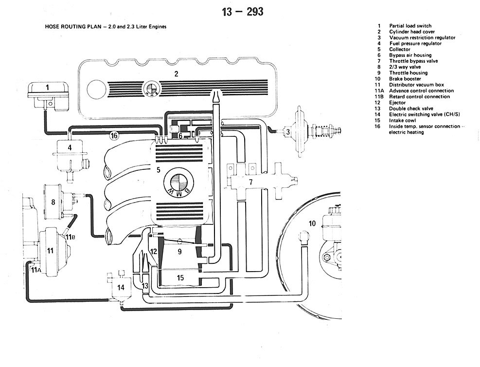

hennabm
Posts: 1395
Location: Edinburgh
Post Mon Jul 07, 2025 3:08 pm
Where the little red cap is - For reference the vacuum pipes on the cold start unit side on the manifold go to the fuel pressure regulator and the other to the partial load switch mounted on the NS, on the air cleaner box. See attached photo and diagram.

Posts: 14127
Post Mon Jul 07, 2025 5:13 pm
Useful to know - thanks for posting. I saw a similar version t'other day when researching this, but it was in German! Do you still own this immaculate example?

riber3
Posts: 62
Post Tue Jul 08, 2025 6:48 pm
Your car looks fantastic!!! Anyway thank you fro the information and diagram I looked at the pipe you mentioned and it goes into the side of the breather hose on top of the rocker cover (see photos) Not sure if there is a check valve here or not but does not appear to be a Partial Load switch as shown in the above diagram
