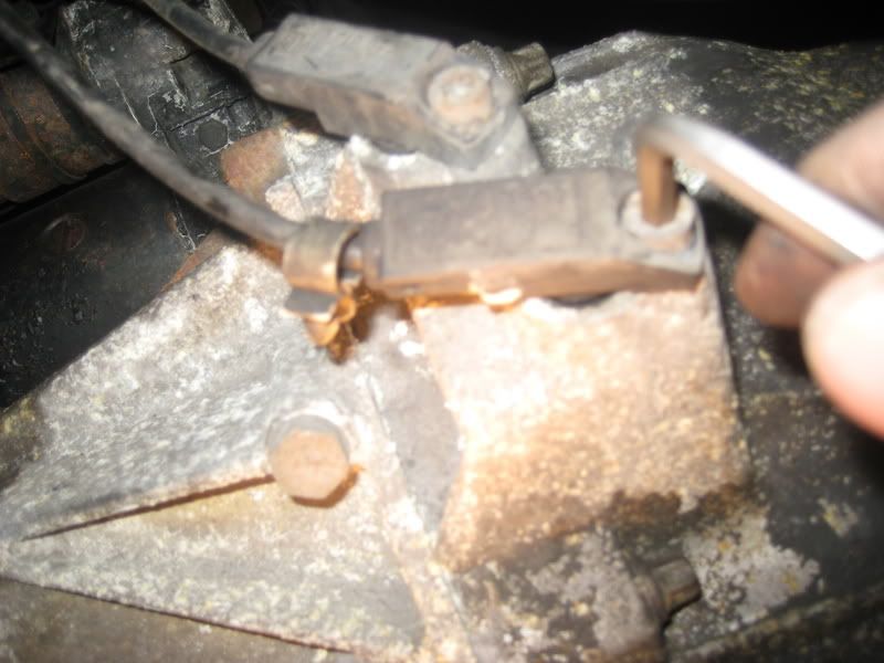

HELLO zoners what a weekend well i sorted the problem
IT WAS THE PICKUP SENSOR !! SO IF IT DONT START CHECK THAT TO !!
THIS IS THE SENSOR !
OUT WITH THE OLD IN WITH THE NEW!!! HA HA GOT HER STARTED WELL DONE SMALLTHING

If the CPS was the problem, you didn't do the pump test correcly! Pump would buzz, whatever state the CPS was in.SMALLTHING wrote:it a e reg theys no buzzying from the pump so i think the pump is f@$% so i will be getting a new one
- SMALLTHING
 - Posts: 38
 - Joined: Wed Oct 04, 2006 11:00 pm
 - Location: WHATEVER
 - Contact:
well i took the fuel line off and turned the key feul came out .they was no spark !!!!. ive bin driving it so it works fine thanks !Brianmoooore wrote:If the CPS was the problem, you didn't do the pump test correcly! Pump would buzz, whatever state the CPS was in.SMALLTHING wrote:it a e reg theys no buzzying from the pump so i think the pump is f@$% so i will be getting a new one
the m-tec 1 lives loving it !
