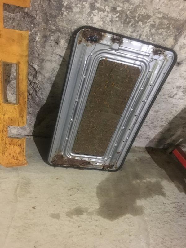

Finally got round to doing a job i have been avoiding for a while now.
The manual sunroof didn't want to open and there was signs of rust on the panel.
Eventually got it opened enough to remove the panel to find what i already knew.
After i got the panel out i can now see why it didn't want to open (apart from the rust that is).
The guides either side seen to be out of sync.(anyone know how to sort this ?)Also how do you remove the sunroof headlining panel ? (the wee metal arms)
Next was the head lining to come out and clean off the old crap ready to retrim.
Also put inners and outer tie rods on the newly purchased purple tag.
Brianmoooore
Posts: 49358
Wed Jan 03, 2018 6:57 pm
shedrool83 wrote: The guides either side seen to be out of sync.(anyone know how to sort this ?)Also how do you remove the sunroof headlining panel ? (the wee metal arms)
Sync. by removing the motor and gearbox assembly, manually pull each side of the mech. to full tilt (I think there's a couple of holes for pins each side that line up when this is achieved, but I've never used them), connect the electrics back to the motor, use the switch to set the motor to full tilt, and refit.
More importantly, how did it get out of sync in the first place? Hopefully no damaged gearbox cogs.
IIRC, the small metal arms just pull off. It's definitely not difficult, or I would remember.

It's does look like the arms just pull off put they weren't coming easy so thought i'd check rather than break anything.
Its a manual sunroof and the handle was slipping now and again when i tried to get it open.
Brianmoooore
Posts: 49358
Wed Jan 03, 2018 8:33 pm
shedrool83 wrote: Its a manual sunroof and the handle was slipping now and again when i tried to get it open.
Well, that explains how it got out of sync. Hopefully, no damage gas been done to cables or gears.
Be very careful of the large stainless steel plates when you dismantle the mechanism for cleaning and lubrication - the edges are razor sharp.
Pull the cables out of the tubes, clean off all the old grease and apply new.
Synchronising the cables is much the same with a manual roof as with an electric. Just set the manual winder to full tilt before refitting it.

Had a go at the sunroof mech today and thanks to Brian's instructions it seems to be back in sync and moving freely.
I'll stick the new panel on tomorrow and hopefully it still works as it did today .

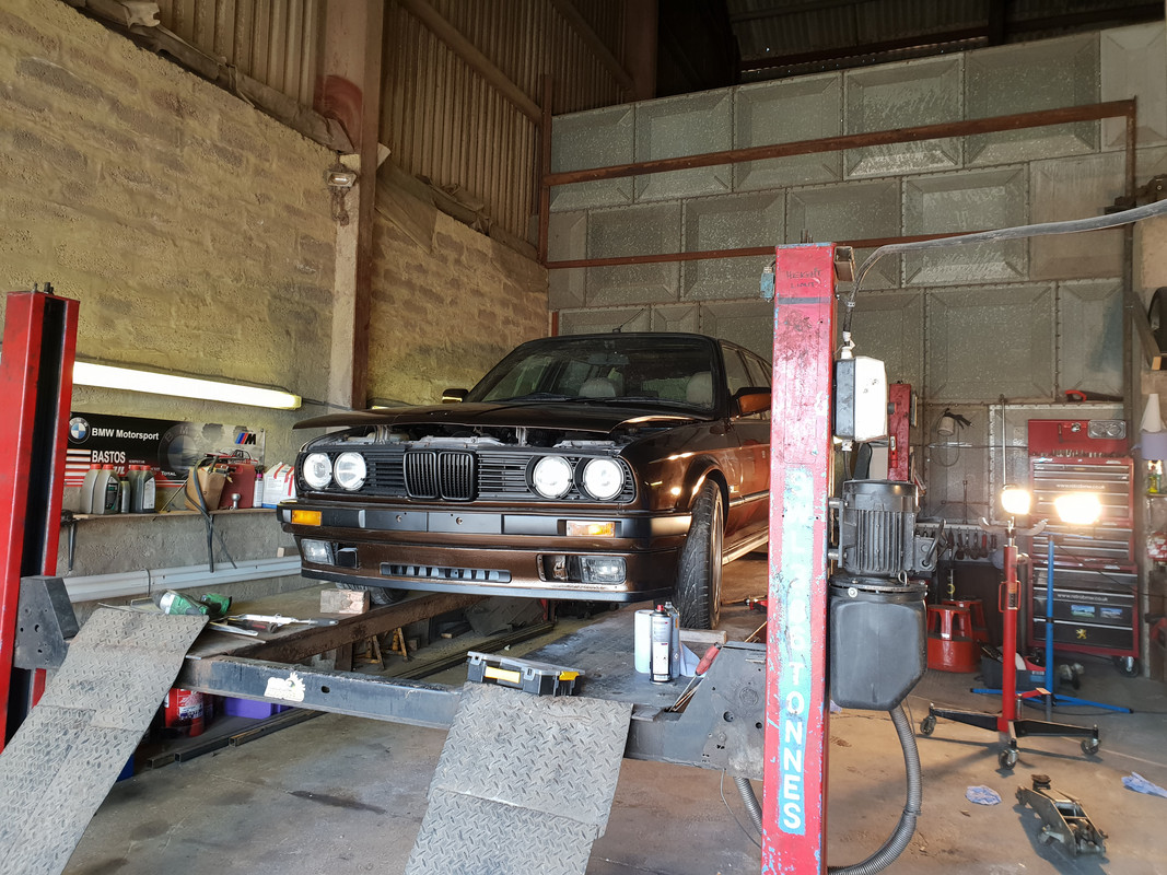

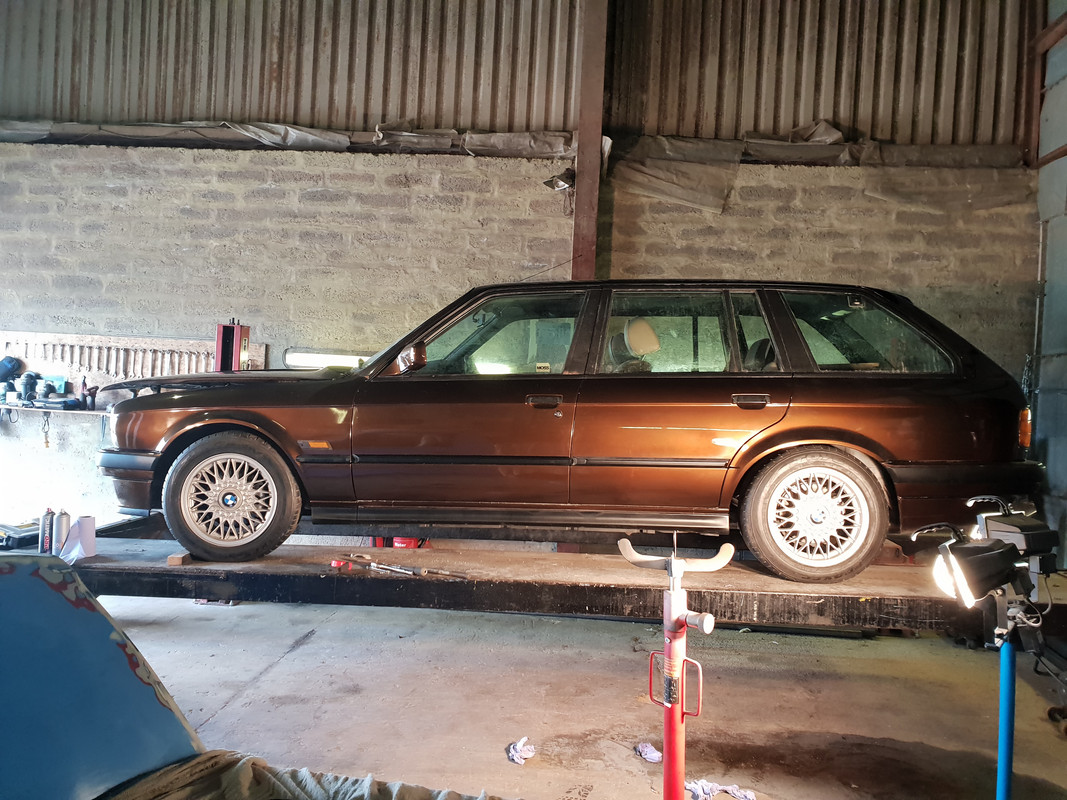

Sun Sep 09, 2018 5:02 pm

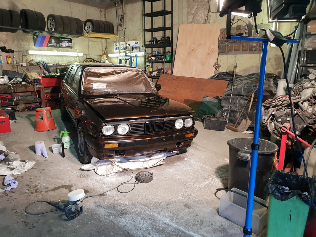

A year nearly to the day got i posted this and its finally in paint.
Wee summary since most of the pics have disappeared
My first attempt of painting a whole car from start to finish.Few runs in the clearcoat to sort out and a colour sand but quite happy with it . I'll do the door checks and the engine bay when the engine comes out again .I did plan to keep the car silver but marrakesh brown came out my mouth instead of silver at the paint suppliers.:mad:

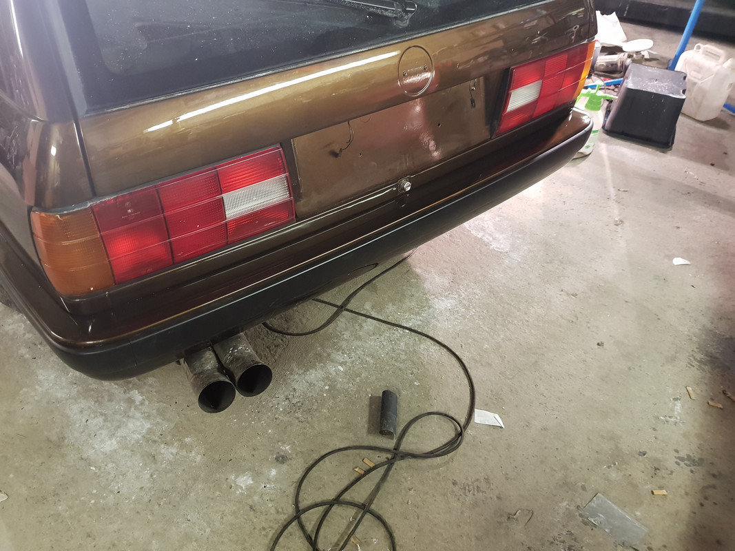

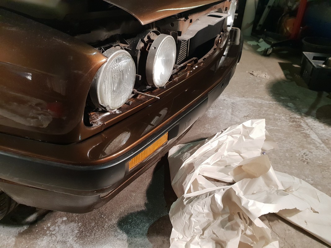

Tried colour sanding the top panel of the tailgate to see how it came out. Not to bad in my opinion.

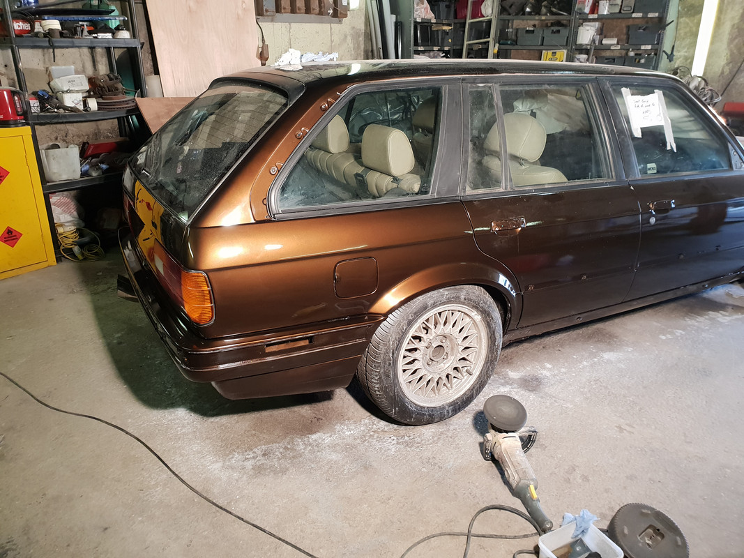

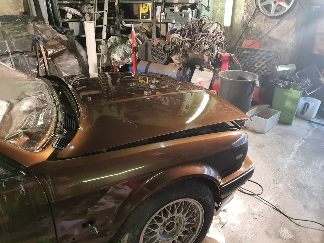

Sun Sep 16, 2018 8:13 pm
More sanding and polishing done over the weekend until i ran out of polish and my arms couldn't take anymore .
Still have 2 doors and roof to do plus a machine with finishing conpound then polish and wax .Hope to have this finished by the end of the week it's tediuos work.

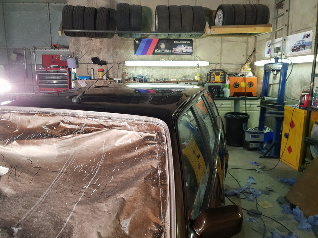

Just the roof to do now , can finally see the end as far as sanding goes.
shedrool83
Posts: 4395
Location: Dundee Scotland

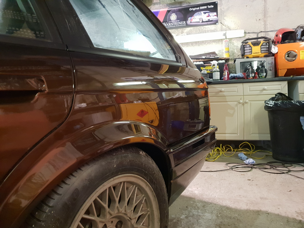

Tue Sep 18, 2018 8:41 pm
Roof is done .

Probably looks better in the pics Ronan tbh. I can still see scratches which i hope is just from compounding and have my fingers crossed the polishing stage will remove them. There is a decent reflection tho just from the wet sanding and compounding .

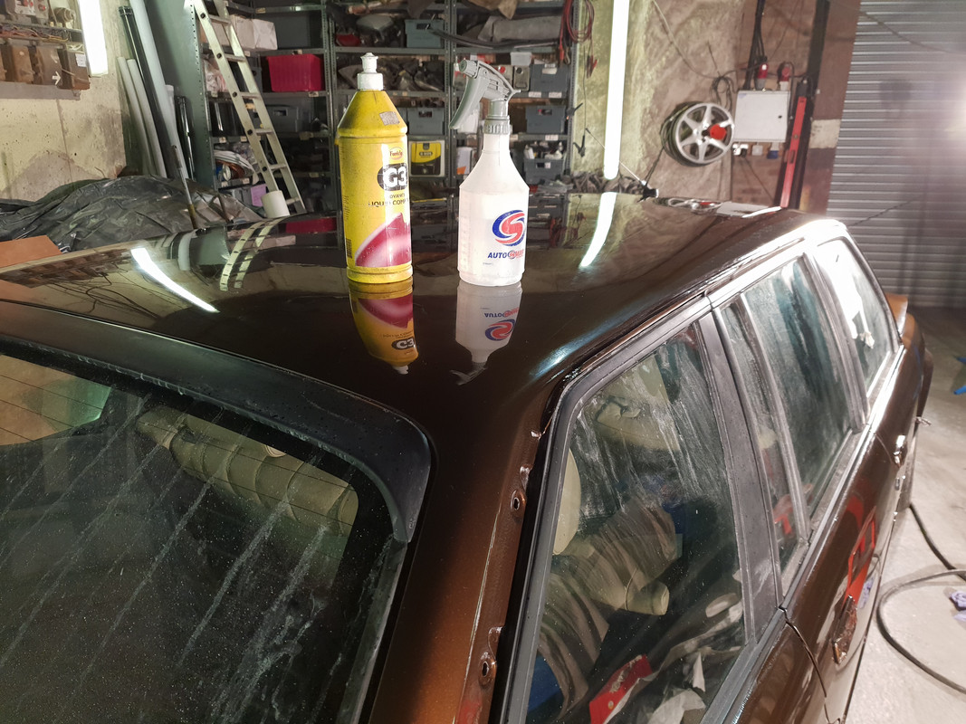

Sun Sep 23, 2018 3:08 pm
Getting there slowly but surely .
