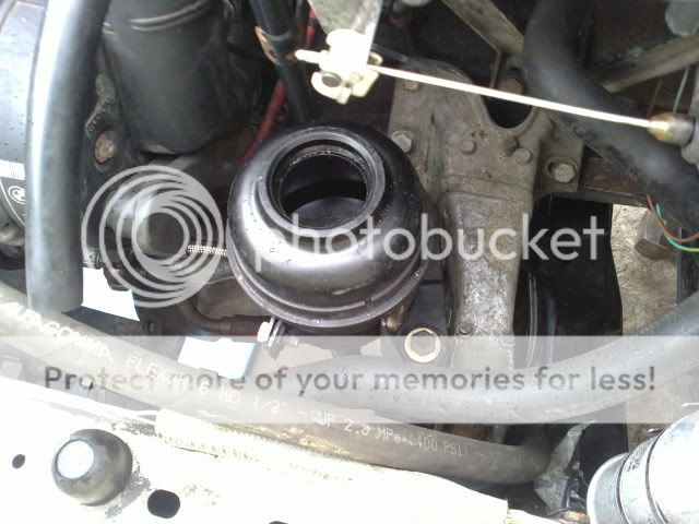

you don't use the e30 p/s fluid bottle with the e36 rack you just mount as it sits in an e36 on the engine mount using the e36 bottle and bracket.another lesson learned :mad:
that's all the pipes in place an mounted up.
glad i kept this bottle now when i bought the rack :D
Image :mad:

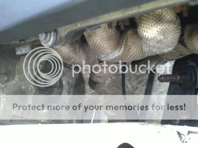

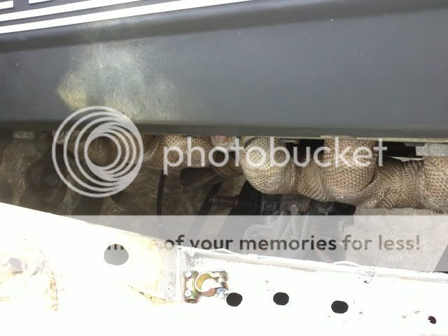

Wed Apr 06, 2011 6:15 pm
these arrived today :banana:
shame to wrap them really
straight on with them ,
just look at all my lovely linkage clearance 8)
can't wait to finish it off tomorrow :D :D
