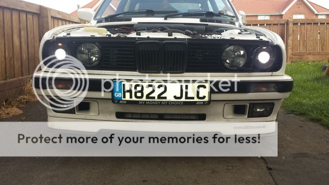

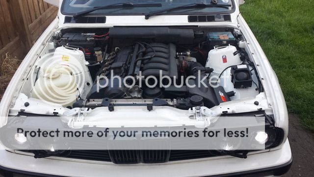

an hour in the morning will see it ready for the mot once the bonnet is on and the panel gaps lined up ....... lovin the bullseyes 8)

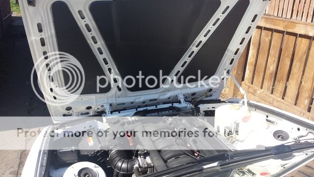

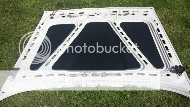

cheers lads , got round to some bufty action today >>>>
cleaned all the grime off and fitted the new insulation , great improvement :D
