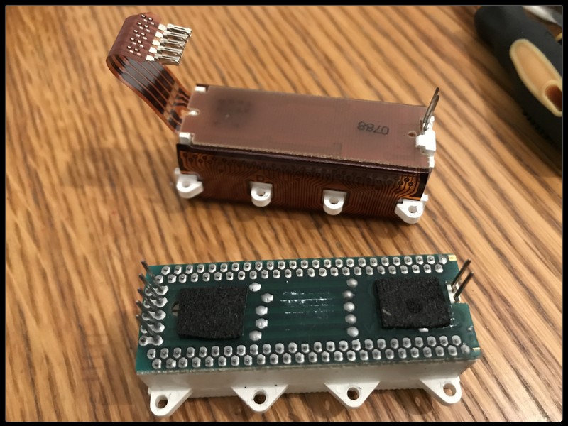

Really don't know to be honest - have had the OBC's apart a good few times without issue. The LCD casing from my OBC was different to the one in the instructions - my good OBC doesn't have a ribbon connector, I had another unit with the ribbon connector - see below, not sure if that caused a problem. The website says its not suitable for US OBC's for some reason.
The casing wasn't overly tightened when being screwed down. Clipping the backpiece of the OBC back on shouldn't have caused any problems, but there was an audible cracking noise when it went. Potentially the LCD hadn't sat into place correctly or something.
