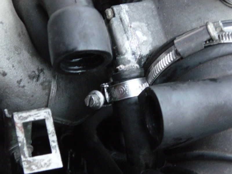

Its the two hoses under the idle control valve right?
(yes i am VERY special!!)
Yes mated6dph wrote:Can i just check i have done it right.
Its the two hoses under the idle control valve right?![]()
hi buddy can you give step by step instruction.... you know for the thick tw@ts like mecharlE30 wrote:For anyone considering this little mod Focus sell 10mm straight brass couplers (found in the plumbing section) for £1.79 and use a bit of old hose looped around to bung the holes on the TB![]()
No prizes for guessing what I've just done
All I did was remove the ICV to get access to the two hoses that run water in/out of the TB, disconnect the two hoses and join together - I used the 10mm straight brass coupler from Focus with two jubilee clips. I then used an old bit of hose to block off the inlet/outlet on the TB. Refit the ICV and hey prestoTW166Y wrote:hi buddy can you give step by step instruction.... you know for the thick tw@ts like mecharlE30 wrote:For anyone considering this little mod Focus sell 10mm straight brass couplers (found in the plumbing section) for £1.79 and use a bit of old hose looped around to bung the holes on the TB![]()
No prizes for guessing what I've just done... photo's would be good too mate... thank you very kindly sir
thanks buddy pictures would be a great help cause for a moment there i thought you were speaking in german.... im a bit like trigger when it comes to engine parts if you get mecharlE30 wrote:All I did was remove the ICV to get access to the two hoses that run water in/out of the TB, disconnect the two hoses and join together - I used the 10mm straight brass coupler from Focus with two jubilee clips. I then used an old bit of hose to block off the inlet/outlet on the TB. Refit the ICV and hey prestoTW166Y wrote:hi buddy can you give step by step instruction.... you know for the thick tw@ts like mecharlE30 wrote:For anyone considering this little mod Focus sell 10mm straight brass couplers (found in the plumbing section) for £1.79 and use a bit of old hose looped around to bung the holes on the TB![]()
Tomorrow I'm going to shorten the hoses to tidy it up and will do some photo's.. just for you TW166Y
