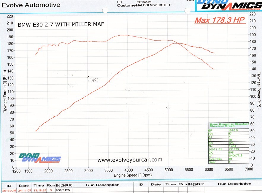

I fitted a Miller MAF unit which has given a partial cure but in the main I have learnt to live with the issue. With regards to the Miller MAF, this does give better throttle response and aids fuel economy,but their after sales sucks!! I gave Miller my engine spec and they required mr to send my ECU and Zone Chip for them to modify to run their MAF. They did lend me an ECU whilst mine was off on its holiday. However, a rolling road day(178.3bhp and 180ftlb torque from 2000rpm!!) established that the ECU was over-fueling above 3000rpm. Despite Miller's claims to be able to write and supply extra chips to suit problems encountered or further engine developments they have failed to supply a corrected chip to me.I am currently saving my pocket money for a Unichip and a live rolling road session.
Since installation of this engine I have covered some 30,000 miles without dramas and generally I am delighted with my work. Earlier this year I added a Hottuning exhaust manifold, this has been the best £200 I have spent so far. As I accelerate through 3000rpm the exhaust note deepens and I get shoved back in the seat. I am running a 3.64 Open Diff which gives 75mph at 3000rpm. Used on my normal 400 mile week the car returns 35mpg, which improves with gentle running (rarely) to a best ever figure of 38mpg. You can build a more powerful 2.7 than mine, but these engines are more about the huge gains in torque that result in greatly improved 'driveability' and make a good car even more of an 'ultimate driving machine'.

Dyno plot
