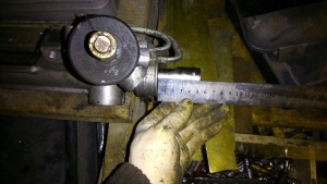

Racks from newer BMWs are extremely similar to the original E30 units, and are almost a direct bolt-in replacement. However, you will need to work around a few small technical issues.
For starters, the original rack is physically taller than the newer ones. This means that you need a pair of small metal spacers so that you can bolt the new rack in exactly the same location as the original rack. The pikey solution is to use a pile of washers, but a sturdier solution is to fabricate your own spacers or buy them ready-made. They need to be 14mm tall, at least 14mm wide, with an internal hole of 10mm diameter.
You also need to customise your steering linkage due to the shorter length of the new rack. We've outlined some options to fab your linkage later in this document, but you can also buy a custom linkage from Zone member DanThe.

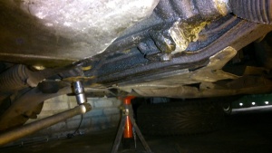

First thing to do is separate the tie rod ends from the suspension struts. For better access, turn the steering to each side. A 17mm thread lock nut holds the tie rod end to the strut so get this undone and then drop the tie rod from the strut. These two simple tasks can often be fraught with hassle due to parts being seized. If the balljoint spins while undoing the nut, place your jack under the ball joint and take the weight of the strut on the jack and try again to undo the nut. Failing that, another trick is to use heat such as a blowtorch, which can also work for removing the tie rod from the strut. A good balljoint splitter will speed things up immensly, but if you don't have one then a hammer and block of wood is a common alternative:
Depending on their condition, you may want to salvage the inner and outer tie rods. If you do, then you need to remove them while the rack is still bolted to car; they're a real pain to remove otherwise.

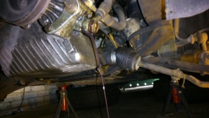

Now we need to disconnect the pipework. If you have access due to a post-lift, then undo the banjo bolts (19 & 22mm) on the rack itself and drain the fluid there. If you don't have access, it's worth undoing the two pipes on the steering pump first. Because these are much easier to access, you can drain all the steering fluid out of the reservoir with relative ease, without it dripping all over your face while you work underneath the rack.
Now all that is left is removing the rack from its mounting on the crossmember. The rack is held to the crossmember by two 15mm nuts and bolts; simply undo and remove these. Then to remove the rack the bottom tabs need to be bent out of the way which will provide the room to simply drop the steering rack off the car.

Straighten the rack. It needs to be set to point straight ahead, which means turning it so that the rack is of equal length on both sides. Use a ruler, and turn the input nut with a 13mm spanner until both sides are the same length:
You're now ready to offer up the rack. Slide it up into the space under the subframe, and get the steering linkage onto the rack's input splines. It probably won't slide on smoothly, but some wiggling will at least make them mesh by a few millimeters, which is a good start. You can bend the lower subframe tabs back now to stop the rack dropping out of the car.

Now is a good time to get your pipes connected. If you've ordered custom pipes, you'll need to fit one hose to your PAS reservoir and the other to your PAS pump. Don't forget to use new crush washers to prevent future leaks.
If you haven't got new pipes, you need to bend your old ones to fit. This is a very delicate operation, and it may make sense to buy a few scrapyard hoses to practice on first.
Take a look at how the pipe holes on the new rack are in a different place to the originals, and plan your bends accordingly. There will be lots of trial and error here, so go slow, take your time, and be prepared to bend things multiple times. Once you can see in your head how the pipe needs to bend, you need to find a way of bending it. A handy trick is to use the wheel hub.
Using a suitable bolt and a few aluminium washers, bolt the pipe to the hole in the wheel hub where your steering tie rod usually bolts. Tighten the bolt so that the pipe end is secure. Now take a small blowtorch or heater, and warm the steel pipe, taking care not to melt the rubber hose. When the pipe is warmed, *gently* bend or twist the pipe as required. Don't try too tight a bend, or the pipe will kink, making it useless. Go slow, take your time, and repeatedly offer the pipe back to the rack to see how your bends are progressing.
When you're completely happy, connect the pipes to the rack using the correct banjo bolts and washers, and connect the other ends to the PAS reservoir and steering pump.
