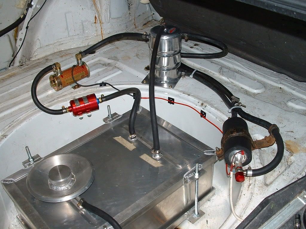

Found this on my PC if it helps at all!

what are all those pic in the pic above its all so confusing to me

That pic shows the fuel tank, the big box
The swirl pot, the smaller ally cylinder
2 pumps and a filter
All you need to stop fuel starvation is the swirlpot one pump (your tank already has one) and a filter
The tank is not needed to stop the fuel starvation
I'll chase up the golf part numbers as thats the simplest fix for fuel starvation we've found- Robin Welsch tested it and run the car empty with no starvation- empty as in he had to coast into the pit lane

ohh so a swirl post can be fitted witha normall tank and pump ??? why are there two pumps above who makes these swirl ports ???sorry for all the questions matey thanks

Theres 2 pumps above as the original tank with built in pump has been removed from the car, you need one pump to pump fuel into the swirl pot (the one in your original tank will do this), then another one to pump from the swirl pot to the engine.
Allyproducts on here does swirl pots at a good price, think a pump recommendation is above in this thread somewhere.
The fuel starvation occurs when the fuel in the original tank moves away from the pick up on cornering, due to the size, shape and pick position, means that when this surge happens the swirl pot keeps a constant supply, then after the surge the pick up continues to fill the sswirl pot

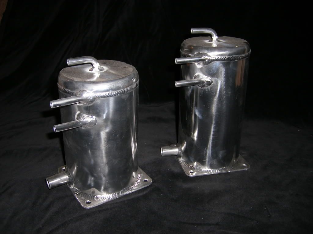

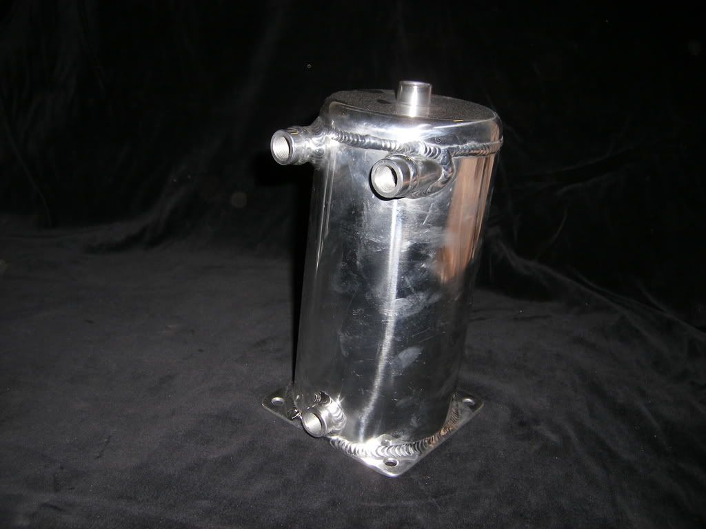

heres the pics :)
