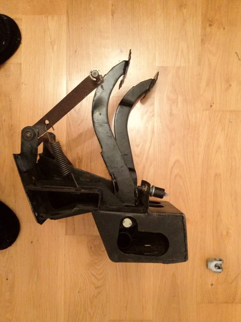

Hi, i am currently in the process of building an e30 with a m60b40 , As is well known braking can be a hassle so i have decided to install a pedal box thats for a mk1 escort rally car,
Its the bias setup which will allow to adjust braking from front to rear,
I am after a bit of info on the setup please, has anyone here done this install?,are there any photos that could give me a heads up ?
Any info would be appreciated
Cheers Mo
mk1 escort pedal box

Hi,thanks for the reply,
Yes this is for a mk1 escort,yes fabrication is required and will be done,
I have chosen this one through advice from rally car builders here in northern ireland,It will involve a bit of faffing about so that's why i am after a few pictures of someones else's ideas,

Hi Ross, thanks for the reply, I have purchased a pedal box already,a very good rix motorsport version if i am correct, For what reason don't you recommend for road car use ?
I have no problem in modifying the bulkhead in a proper way to accept the pedal box tho will not modify the pedal box to fit the car,
The pedal's may need a tweek so that to me is not a bad comprise,
