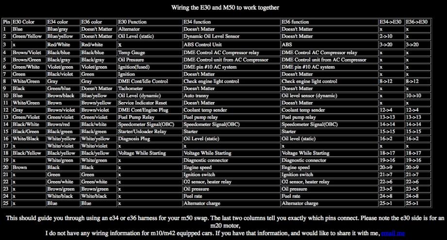

3/ Pin 15 is for the mirrors, heater fan, windows and sunroof. Nothing to do with the running of the engine.
Pin 18 is the starter signal. Black/yellow wires.

here is a link to the pin out i used as it has info on the e34 loom:
http://www.r3vlimited.com/board/attachm ... 1220114259
