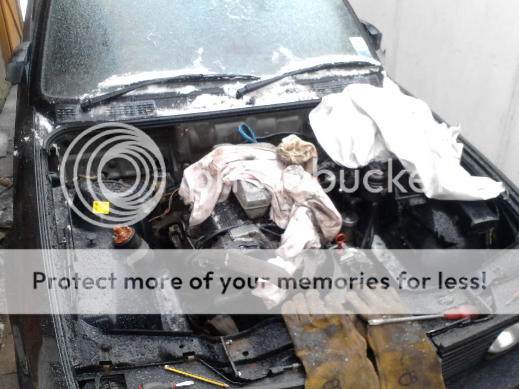

Earlier this year my brother brought his second E30 after he wrote his cab off.
He brought a rebuilt M40b18 to replace a suspected failed hgasket m40 lump that was in when we fetched it.
So in the not so warm months we changed it.

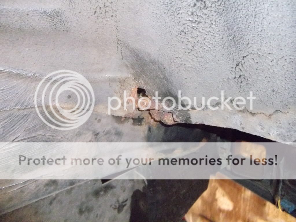

It was then that we found the odd bit of rust.

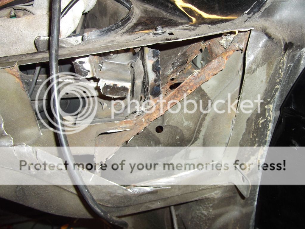

Then a bit more and so on,Image

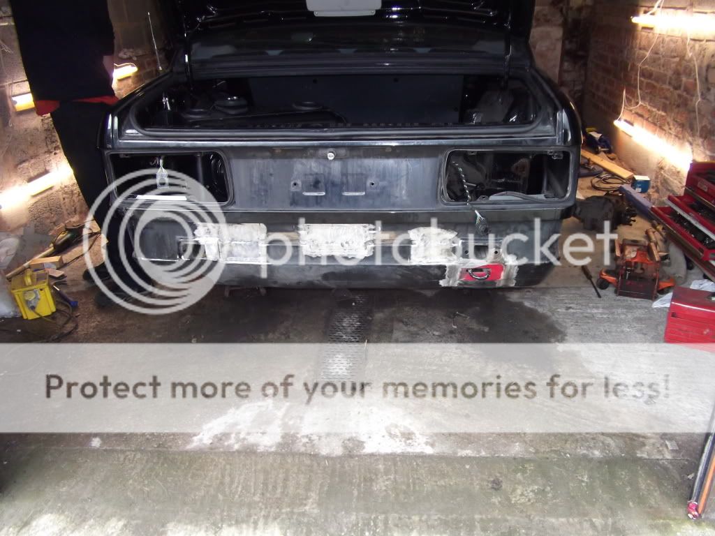

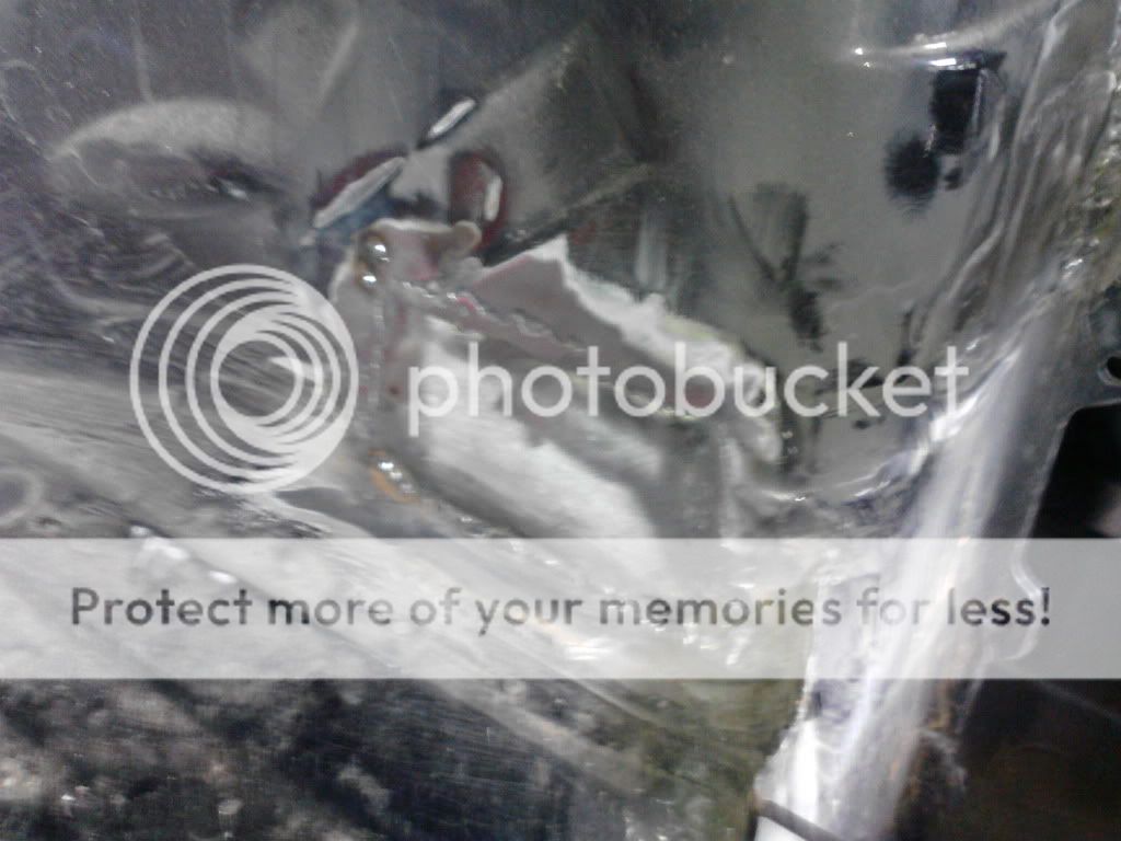

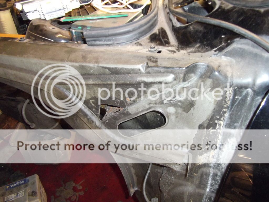

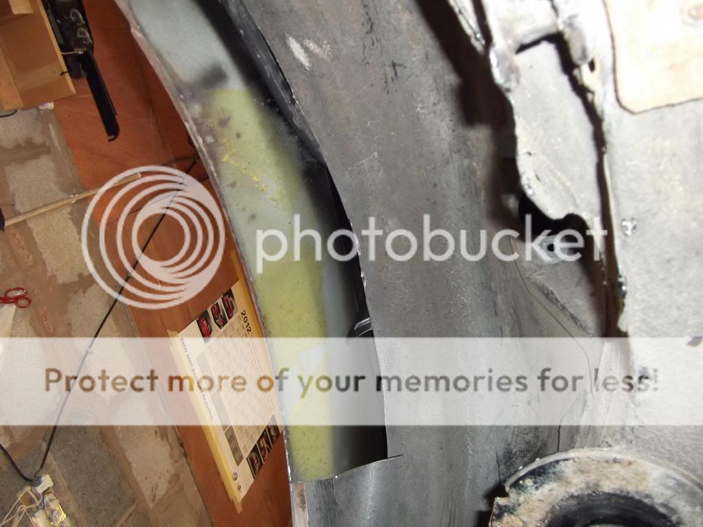

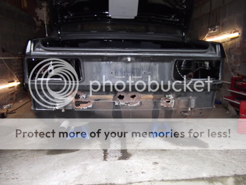

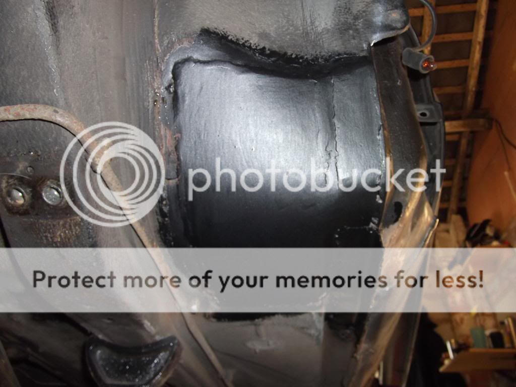

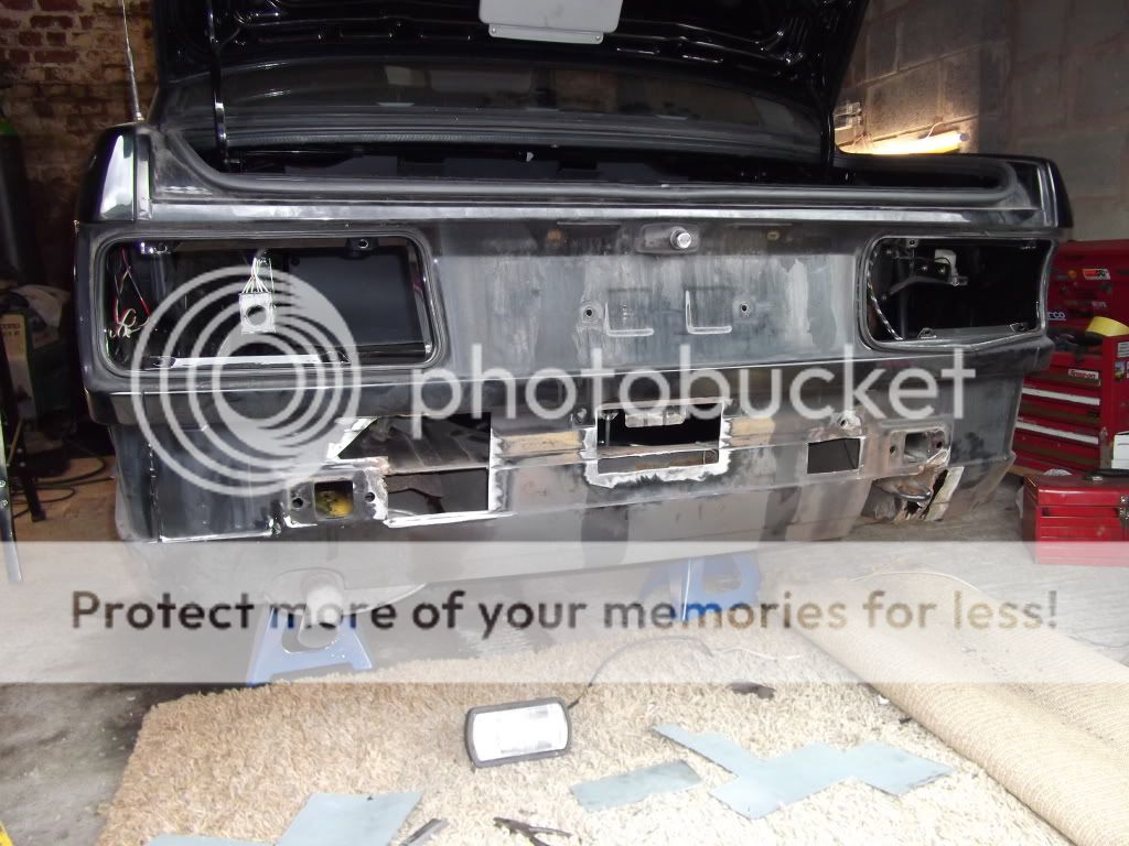

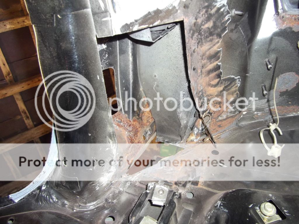

Removed the bumber and found this,

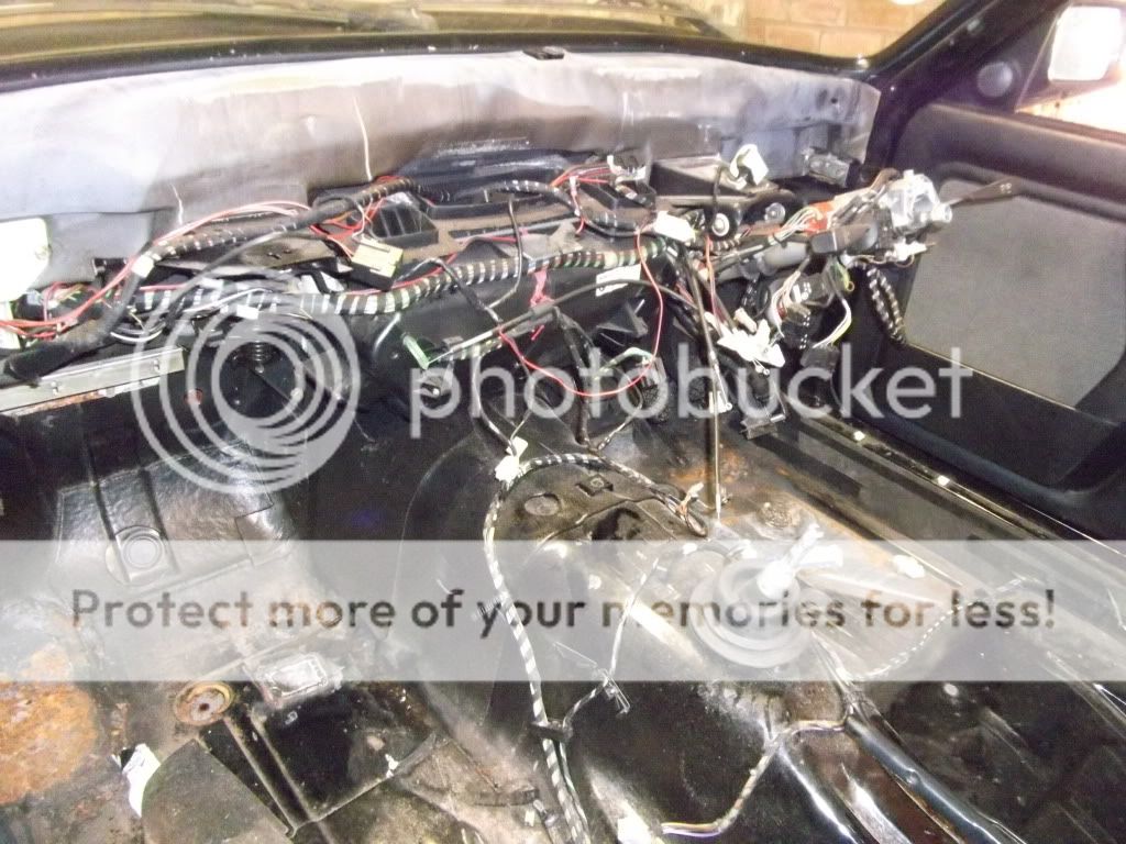

we had already decided to change every bush on the car and fit a rear disc upgrade,so we started stripping it back to the bone,

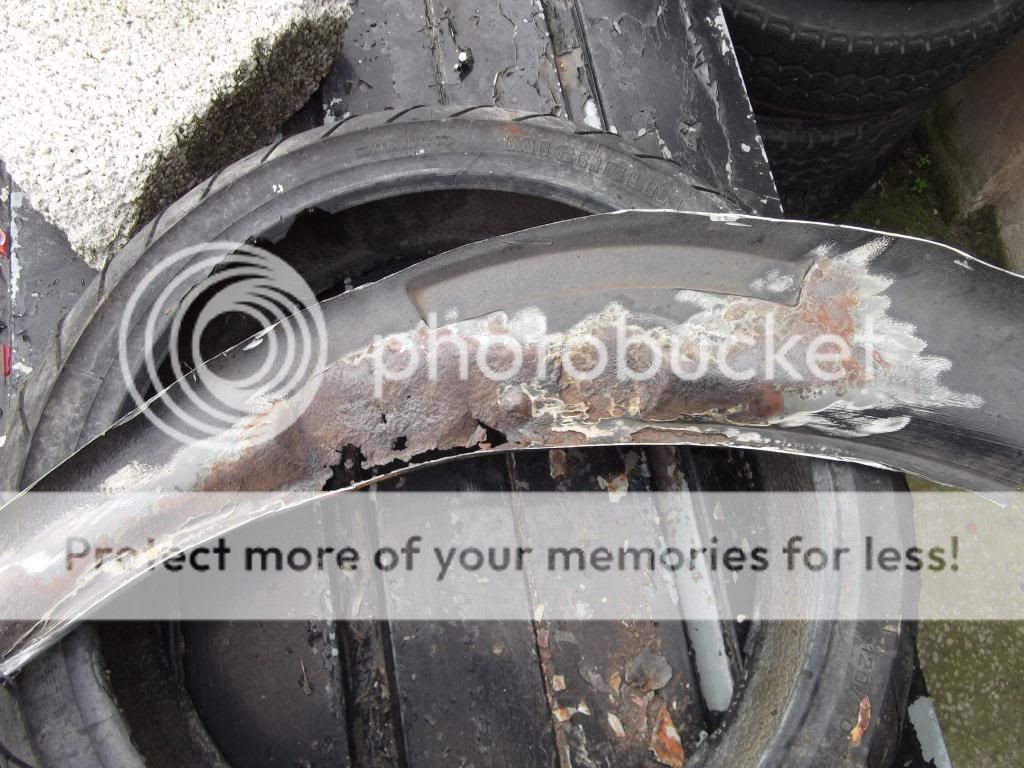

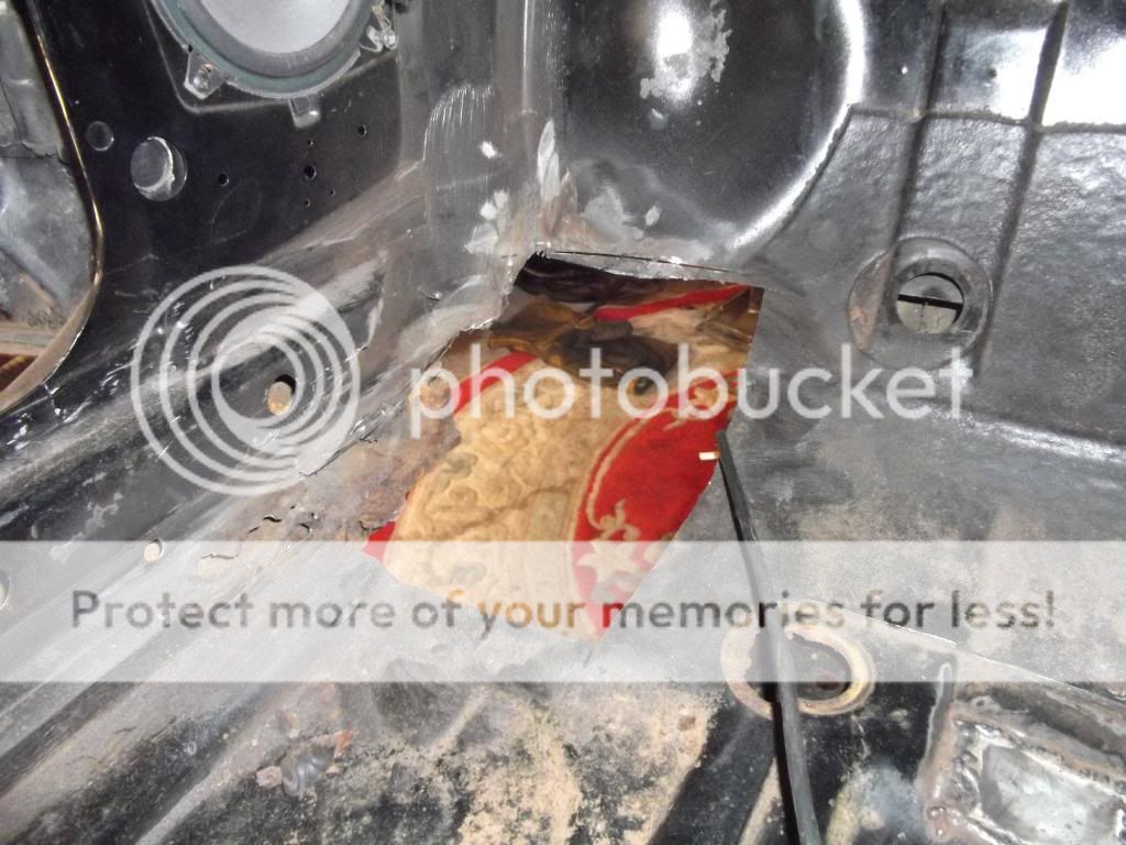

Which just led to more surprises where someone had already `attempted` to repair some holes,which failed miserably.There idea was to slap some patches over the hole on the inside of the car! :-x
So out with the grinder and do some cutting,
What comes out has to go back in,
There are a lot more pics of veldering thats been done need to get the camera of my brother.
We`ve doing this over the last few months nearly every weekend
Just got the nsr outer inner arch to do this weekend and then a couple of little holes in the outer cill and then start putting it all back together lol

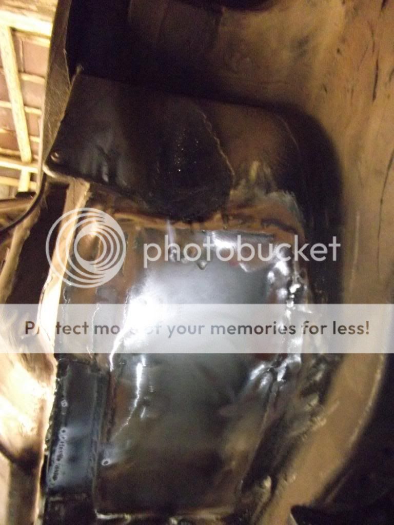

Managed to get the other pics of the things ive already done.

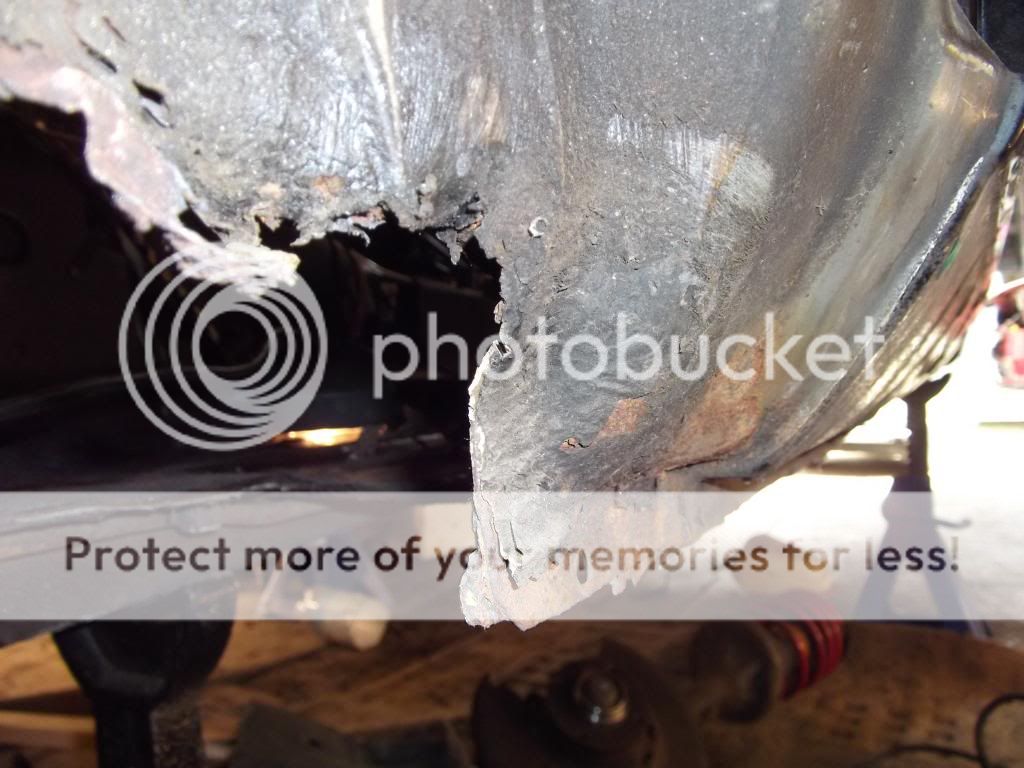

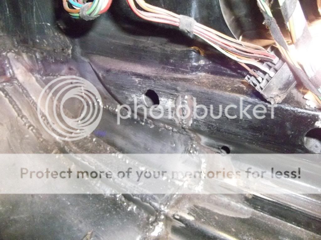

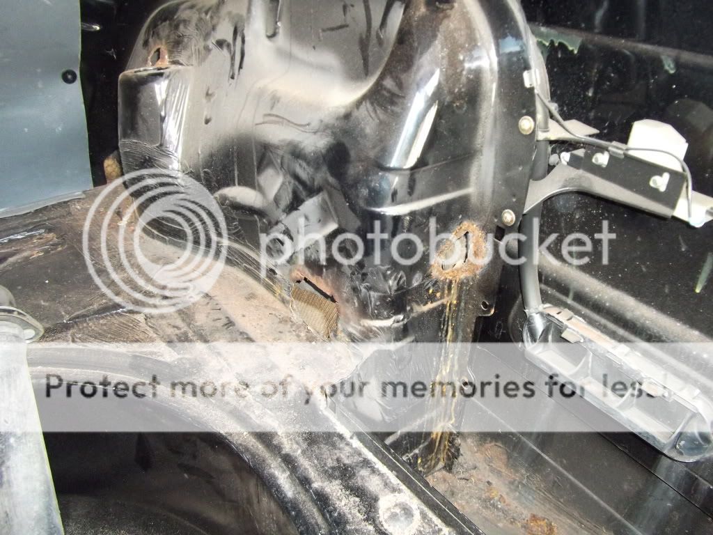

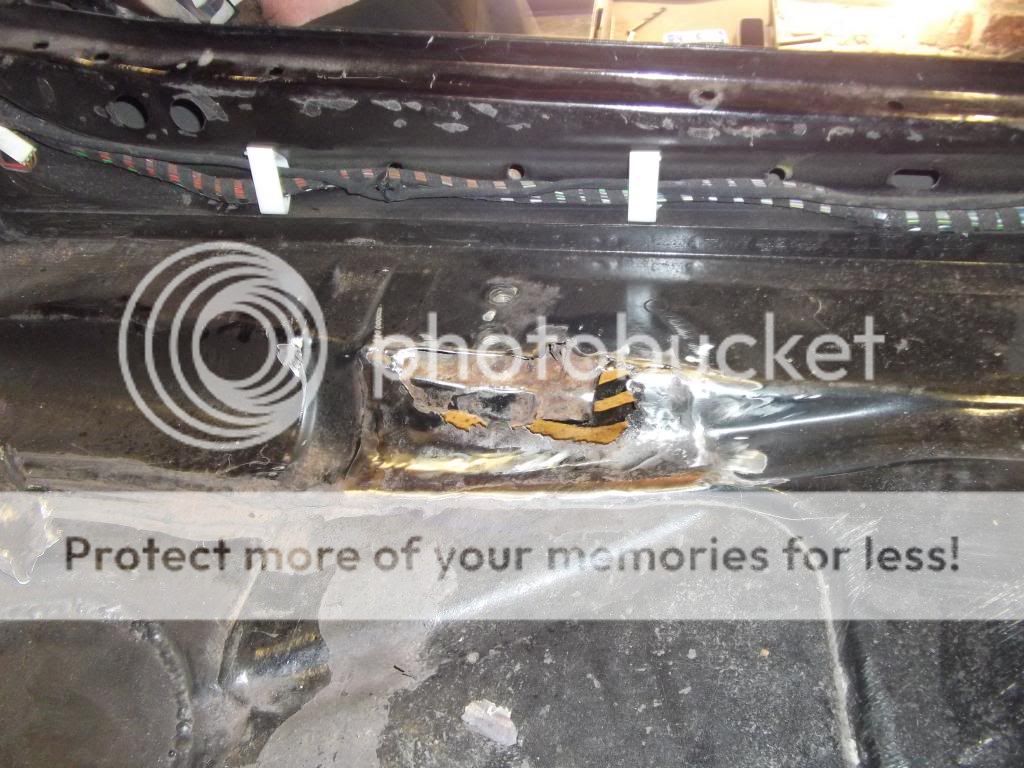

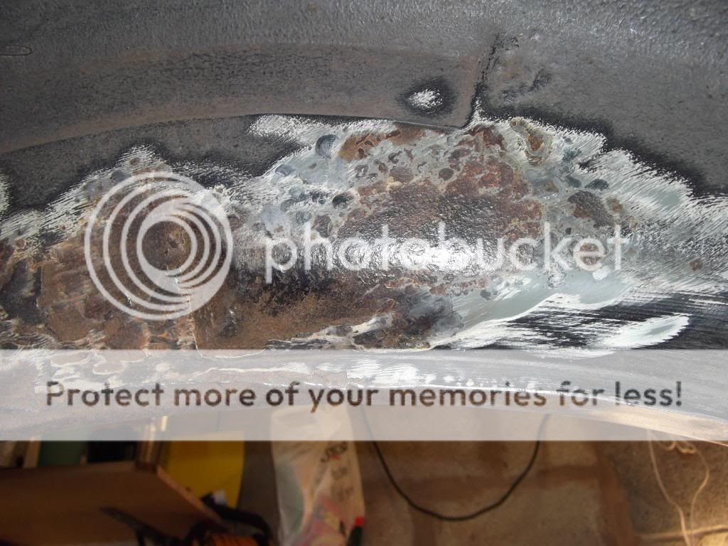

Here is what someone thought would be a good job,they should be slapped hard in the face with a pair of welding gloves.
Both footwells looked like this..
Started chopping it out to see how bad it was

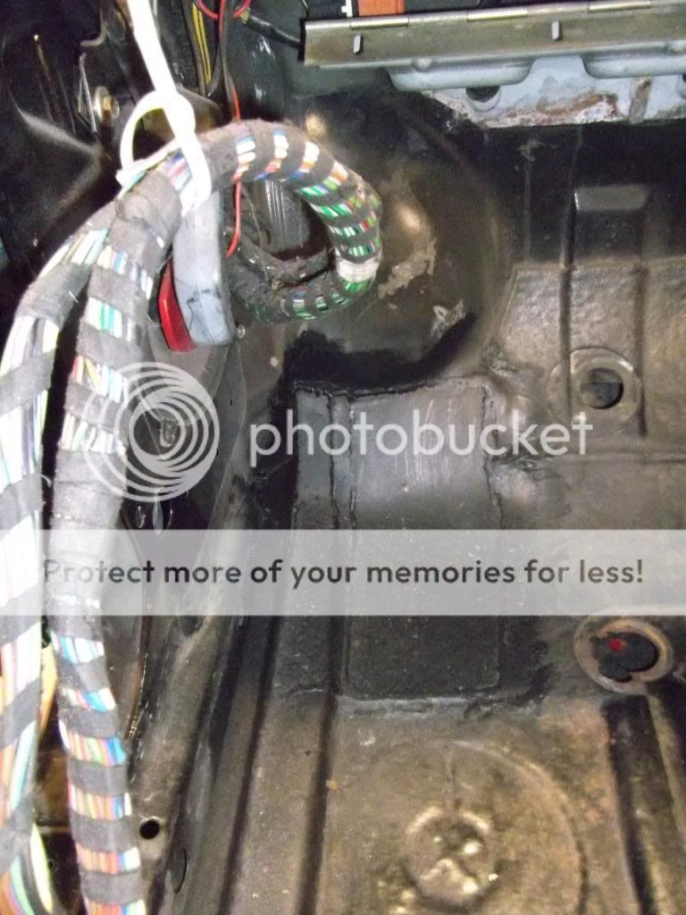

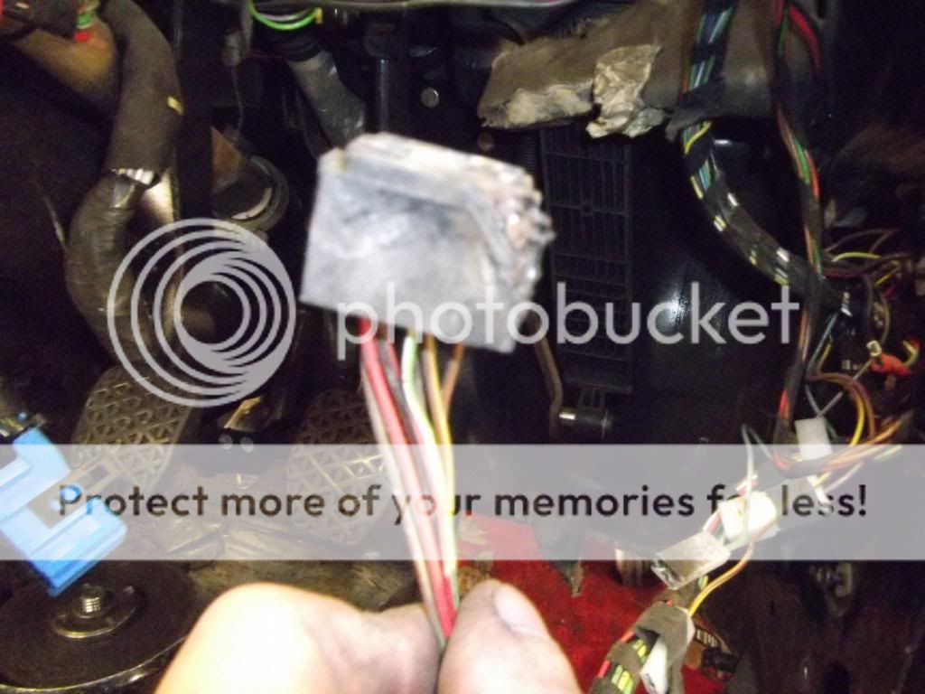

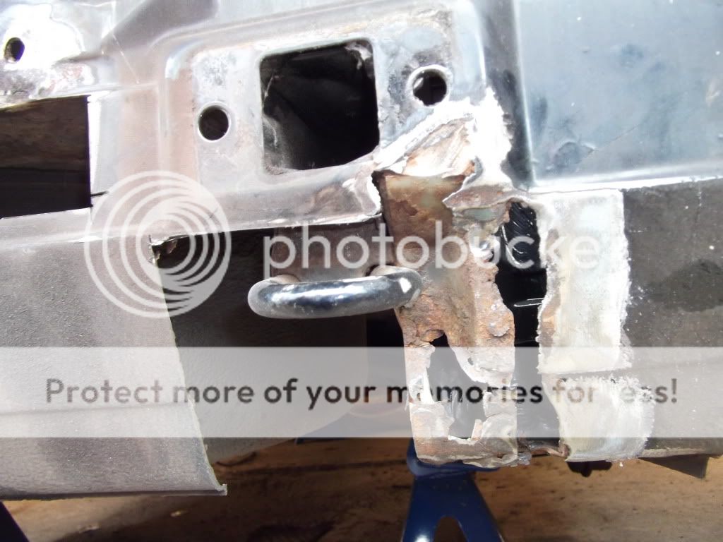

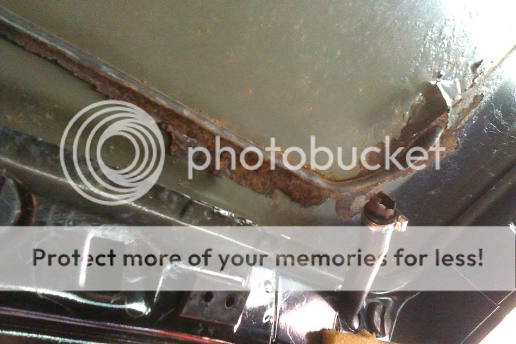

Does anyone know what this would connect to?i found it in this state down the inside of the cills.

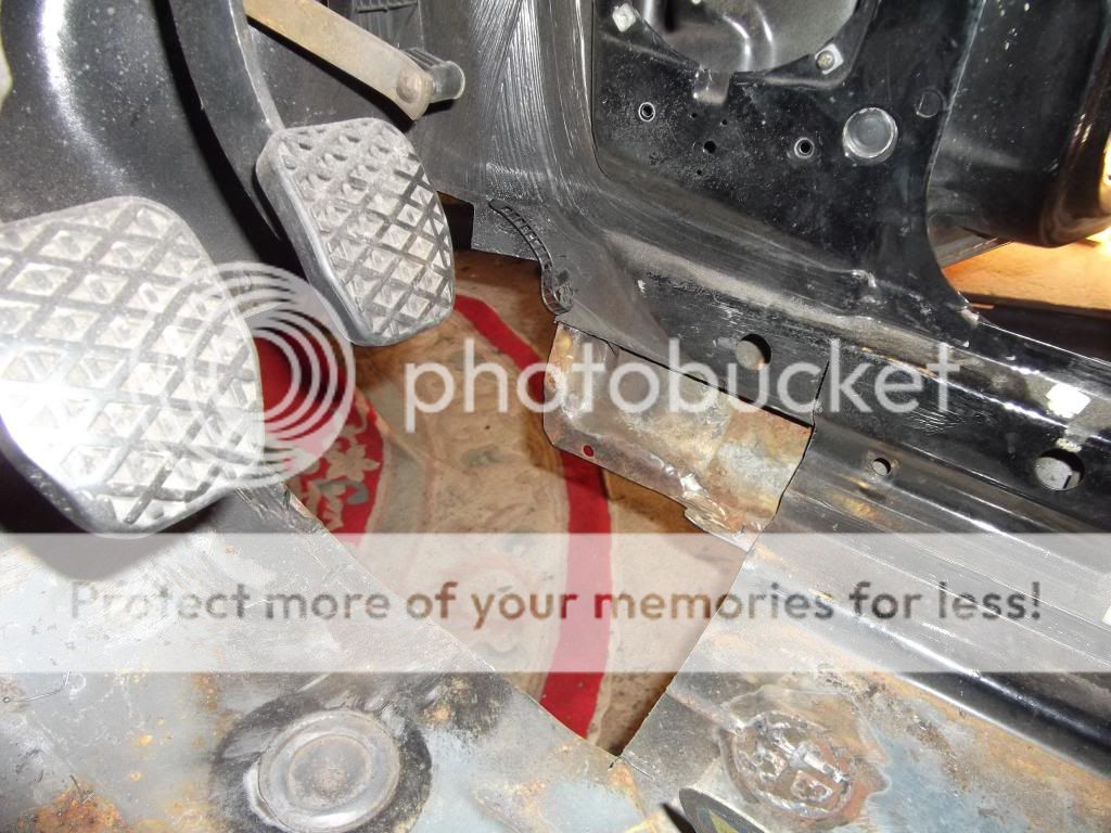

The other footwell

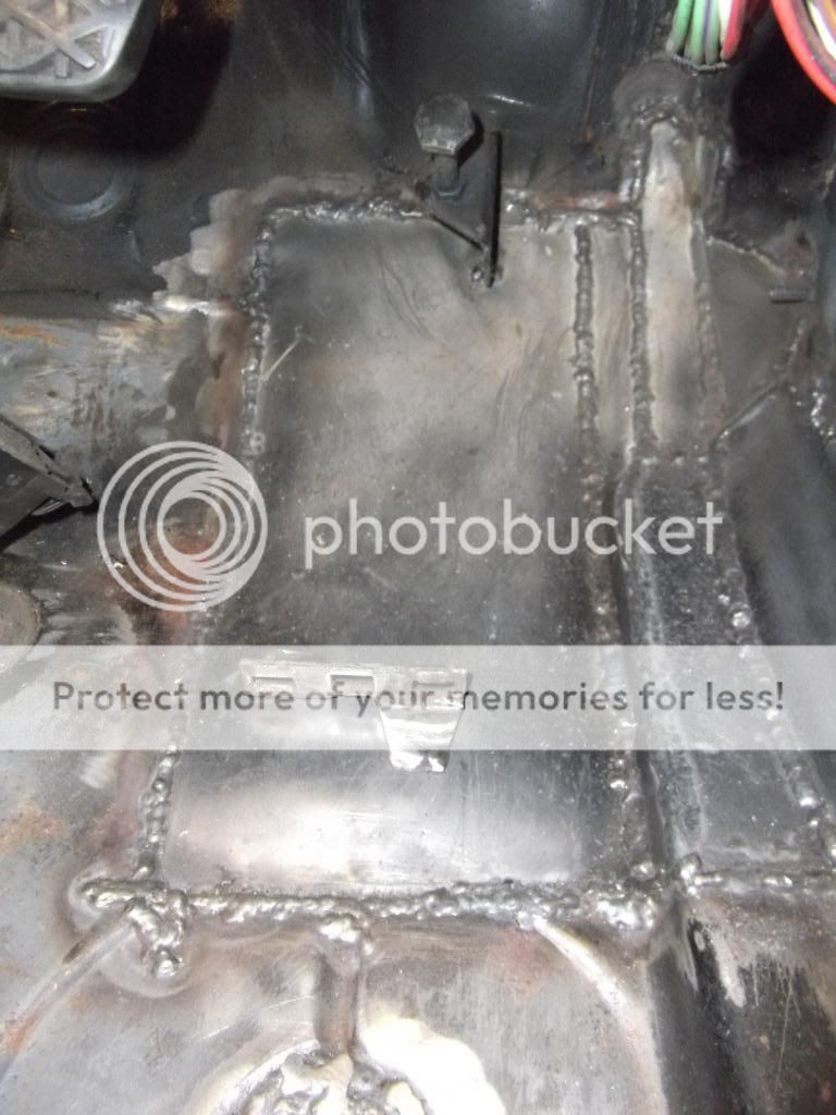

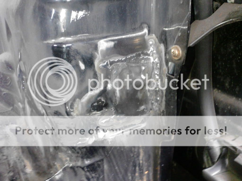

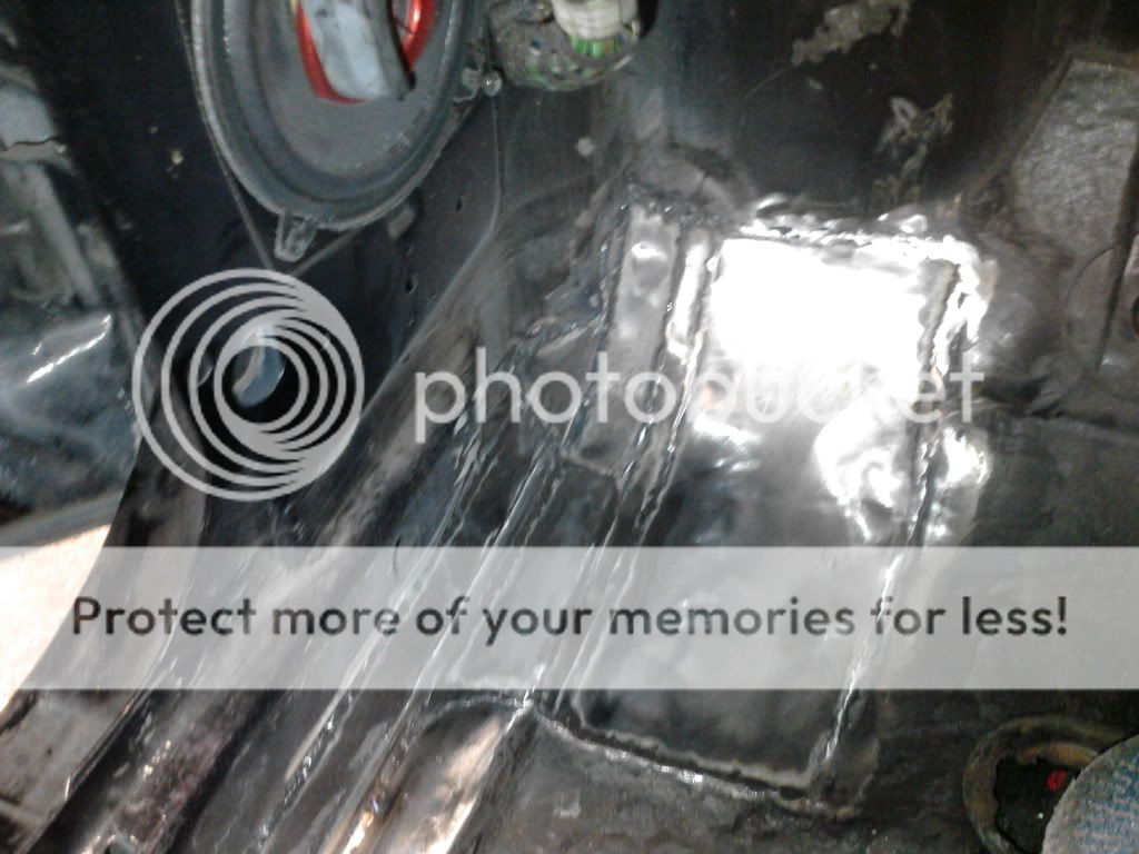

Slowly built them up peice by piece
Still got the mount for the peadal to fix down yet,ie decided to leave that until i mark where the cut out in the carpet will be.I dont want to find out i got it wrong and have to cut it off and do it again.
I didnt bother rebuilding the pads,didnt see the point except for asthetics.

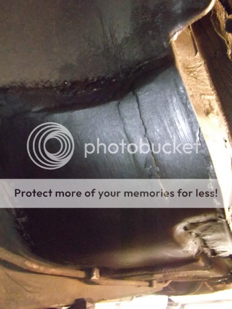

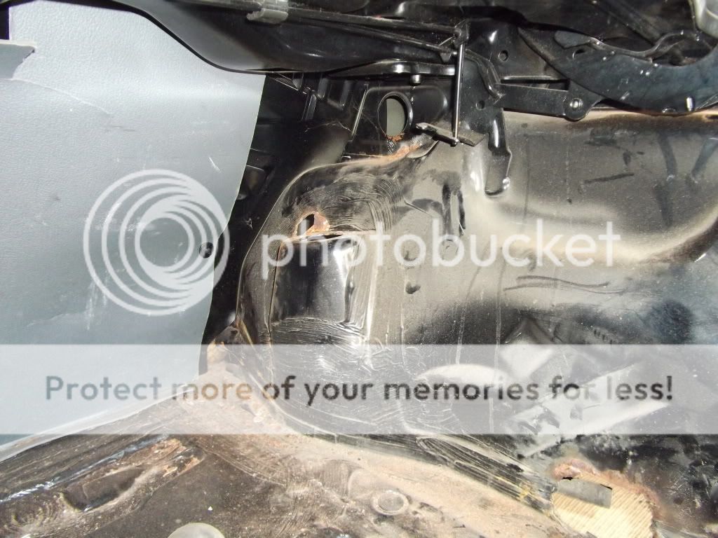

Then we moved on to the seat runner anchor point at the rear, cill side on both sides of the car.
Same sh*t,a plate was slapped over the rot from inside.Didnt take any step by step pics of this as i just plodded on with it.I just pieced it up bit at a time and completley welded every part to each other and fully welded the anchor plate to the floor.
Will get some pics of the finished artical

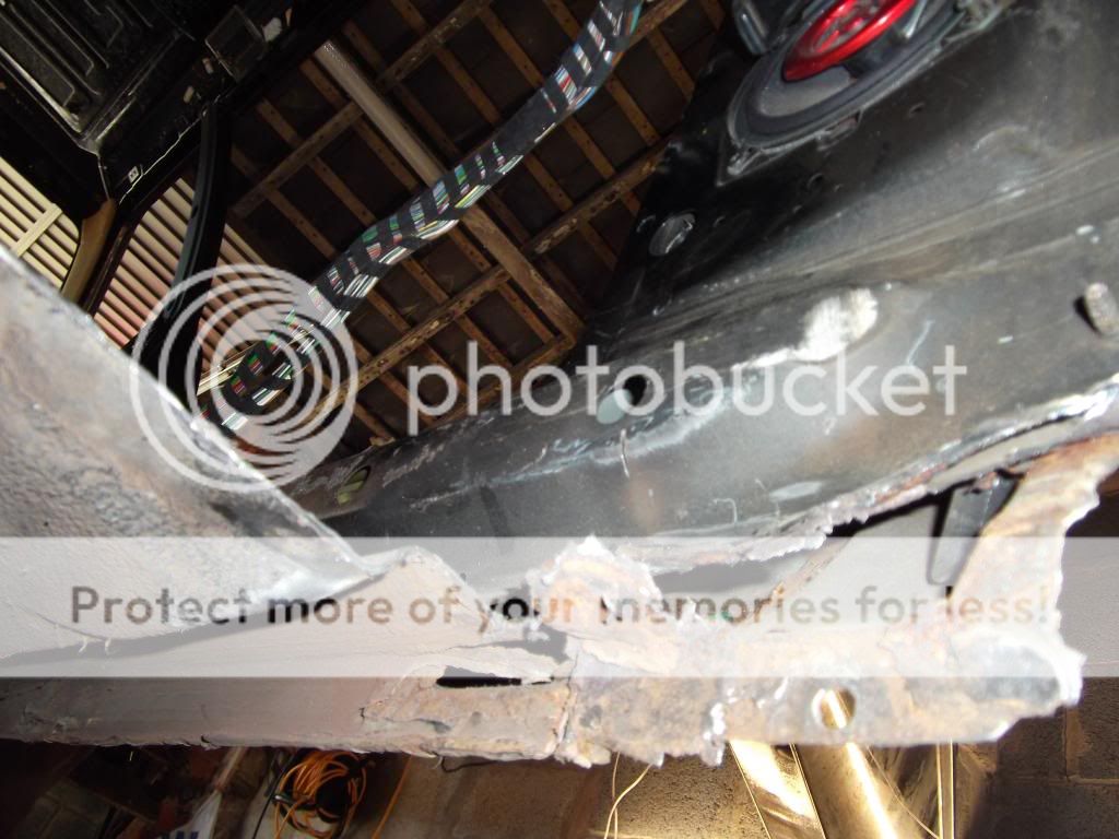

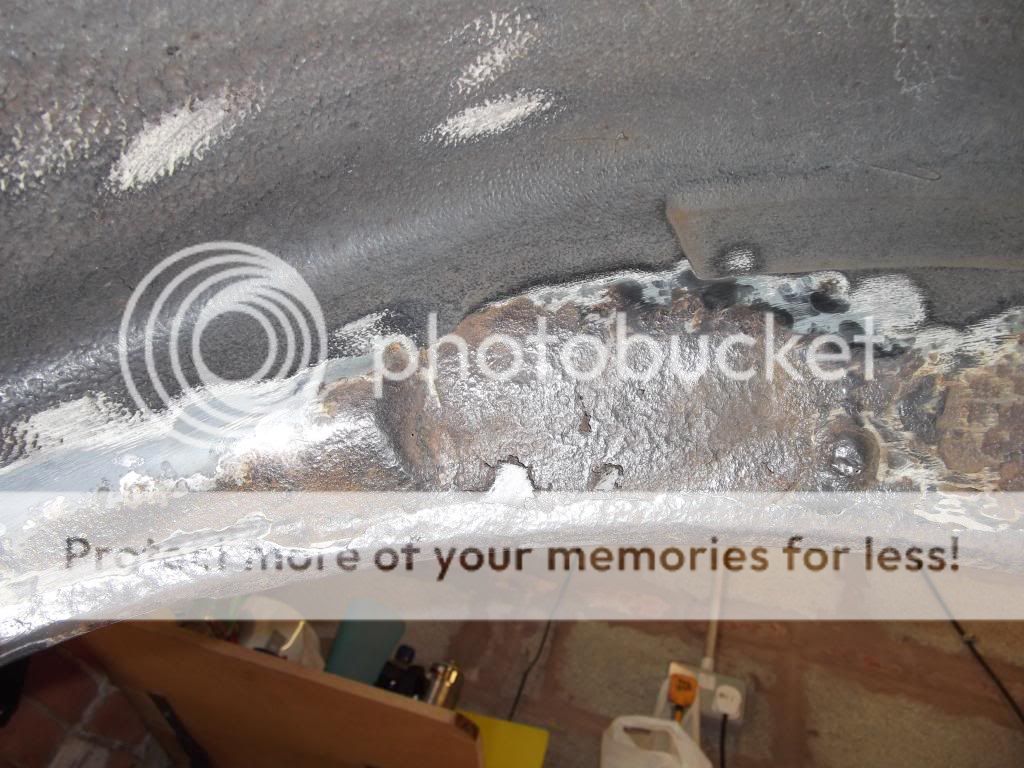

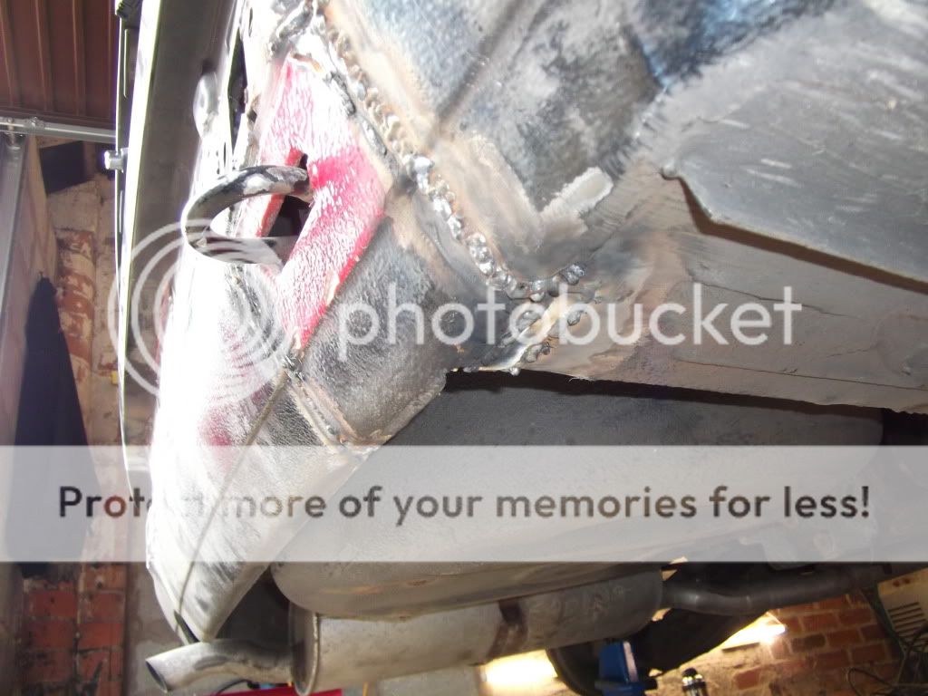

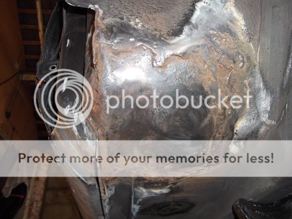

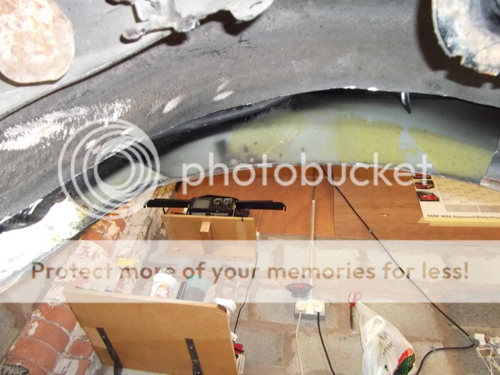

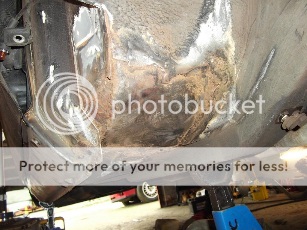

Then came the bit that i kept putting off cuz i didnt know if i could do it or not,whilst i was welding my brother was hunting for tin worm and found this
So bit the bullet and chopped it out
Ended up with this

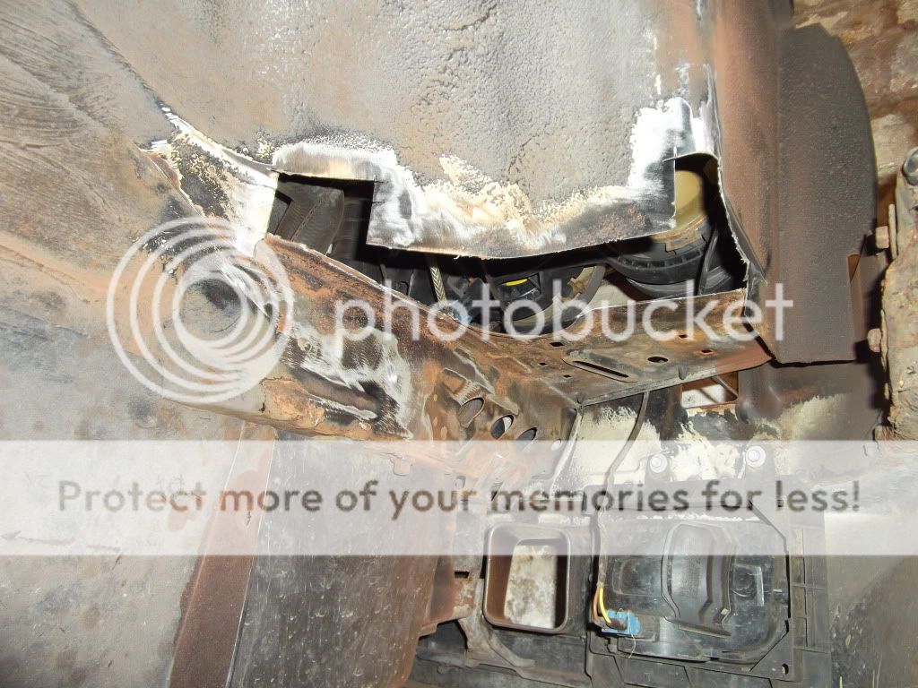

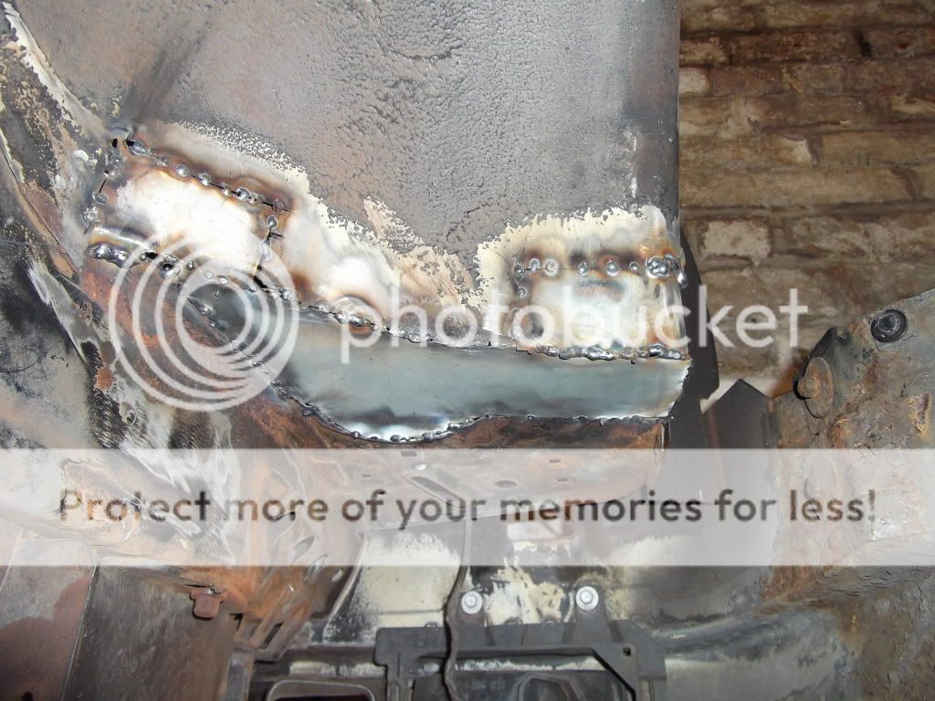

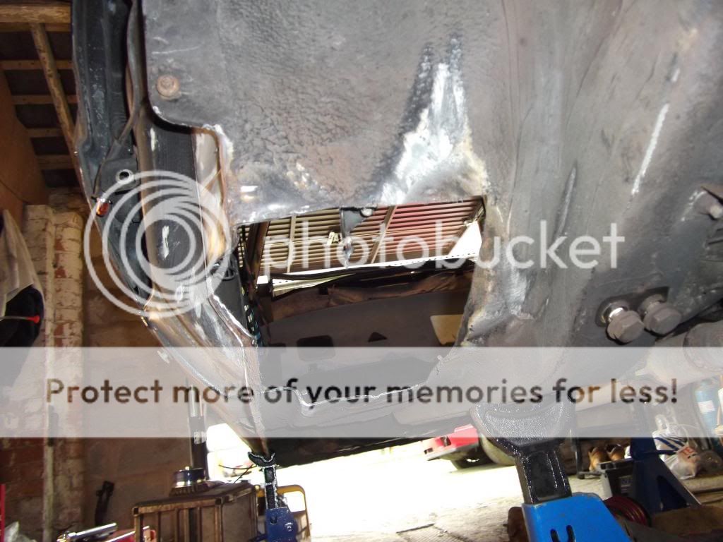

So i borrowed a bit of metal off this that was brought as spares for my brothers tourer

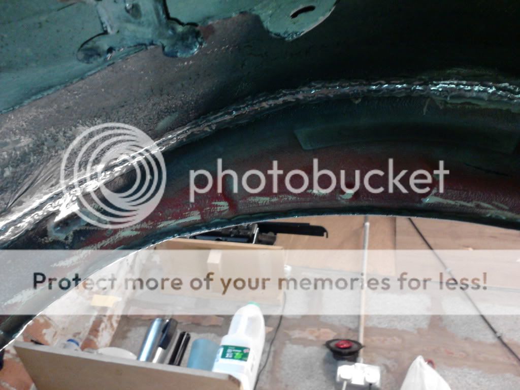

So heres my attempt at doing it yesterday afternoon
Just got to clean up the edges where ive welded the two panels together and build a lip for the arch then clean the weld up a bit.
Fairly happy with the out come so far.
To be continued....

Nice progress. Not that I'm any sort of expert; but the welds all look nice a tidy.. cracking work.
I always thought it a good idea not to put the factory(/jacking) pads back on as they're a heaven for the notorious tin worn that likes to haunt most E30s..

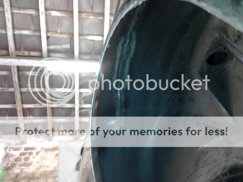

Thought it was time to update progress...
After doin the arch we attacked the scary part of were the scuttle panel was replaced by someone before they didnt bother sorting the rot out underneath.

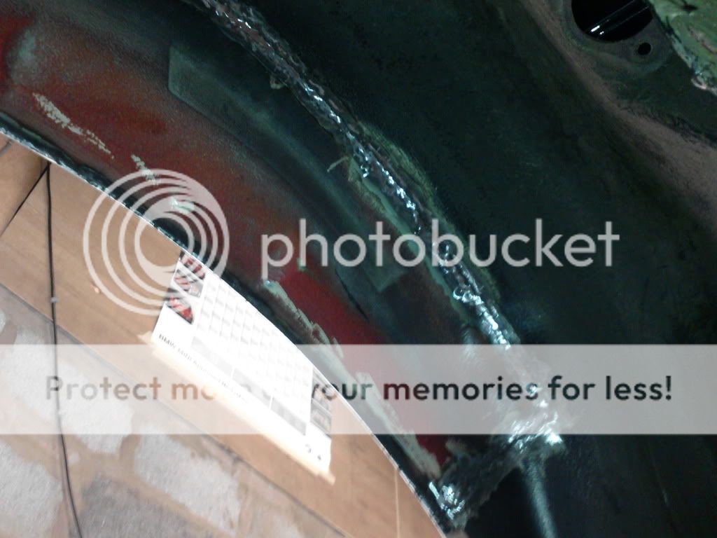

Post Sun May 19, 2013 5:56 pm
Thats now been done,just need to take some pics of finished job.
Didnt take any during the job just got stuck in.

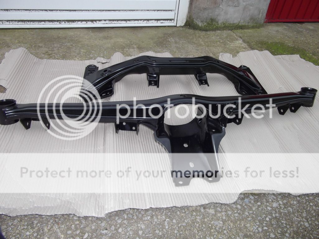

whilst that was goin on a couple of shinny bits turned up from powder coaters 8)

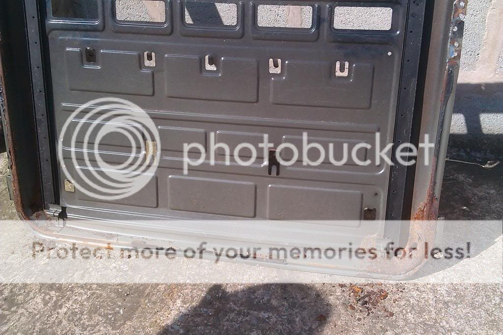

Then we moved onto the sunroof cartridge,
What a pita this was we followed the wiki to get it out but where it said there was five spot welds on the front we had four in different places.
A couple of little horrors were found
Just goin to remove the cartridge from the tourer as its in ok condition.
