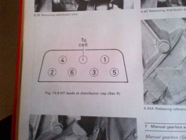

This is the cap I have ..
and yes I know I should have marked it before I removed it :o:

If its a genuine cap IIRC if you clean all that shyte off it the connectors are numbered.
Failing that :
Take the top off the rail that holds the leads together and make sure they are all correctly routed.

Perfect!! Thanks Alot :D
