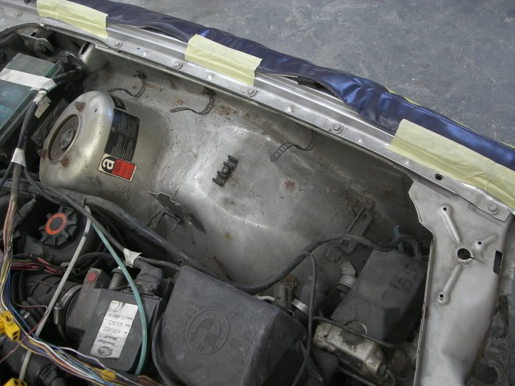

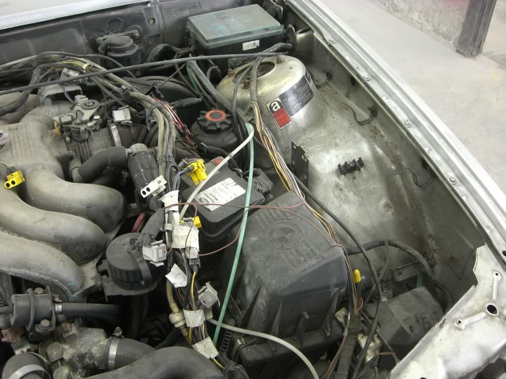

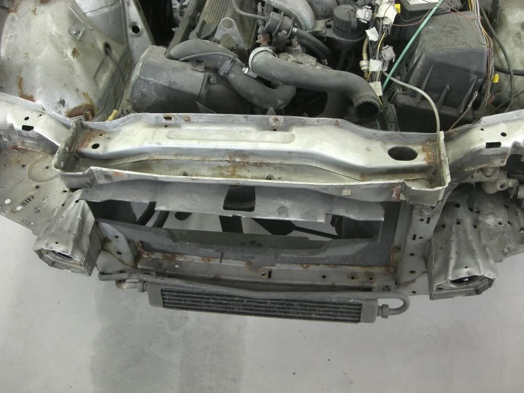

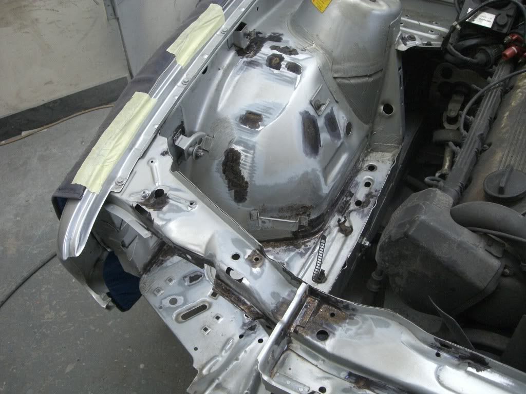

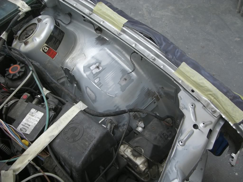

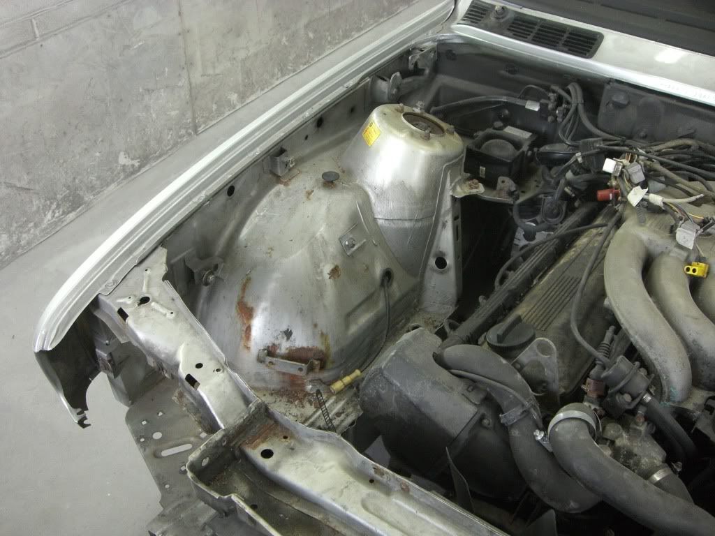

Yes! I managed it lol heres some pics of the engine bay as it sits right now i've stripped alot of it already. Radiator, bottles, etc. Still got to remove the airbox and other various parts for cleaning and painting.
I've done alot of work to the front panel, front bumper, front valance, rear bumper and side skirts already so i'll get pics of them up shortly, now i've figured out how to do it. winkeye

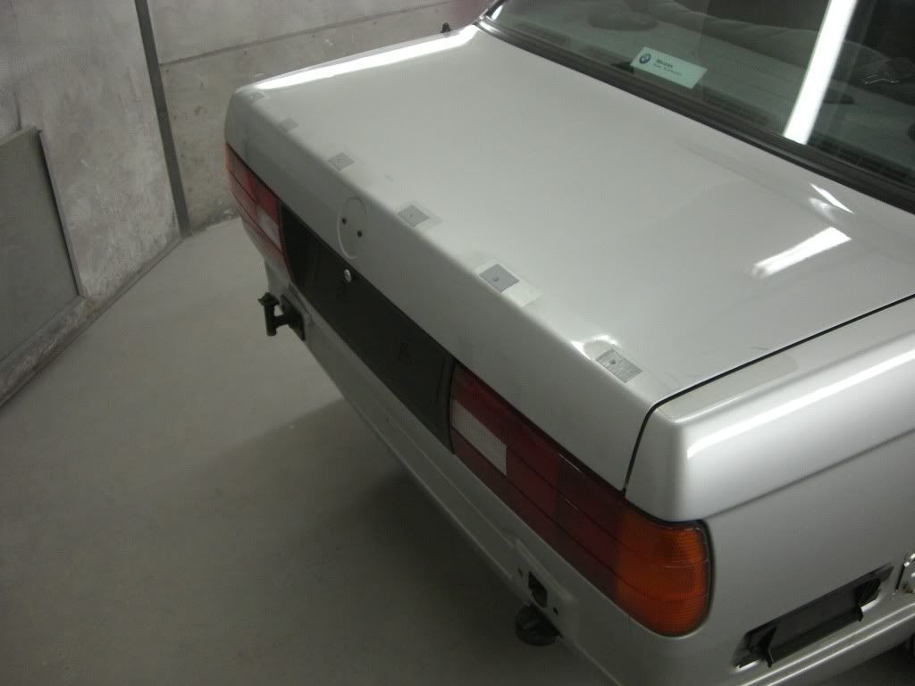

I threw in a random pic of the rear end aswell dono why but there it is minus the rear bumper and spoiler.

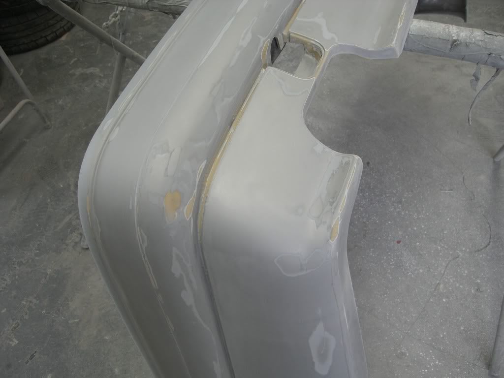

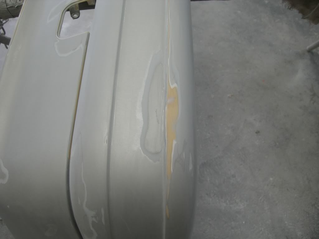

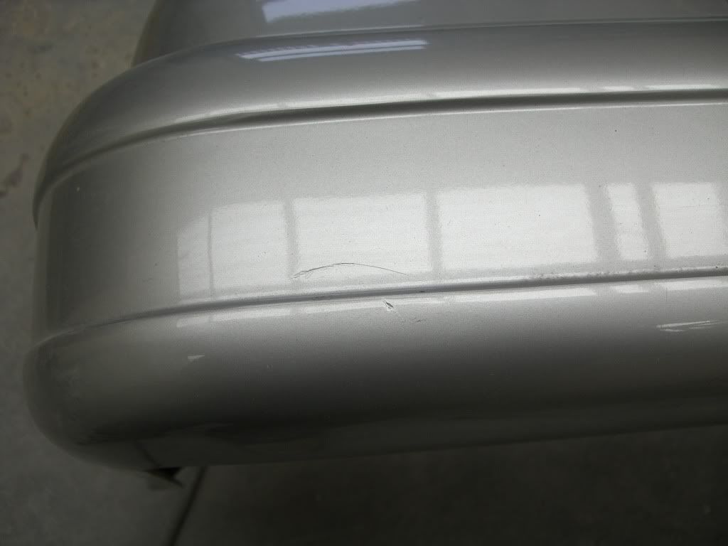

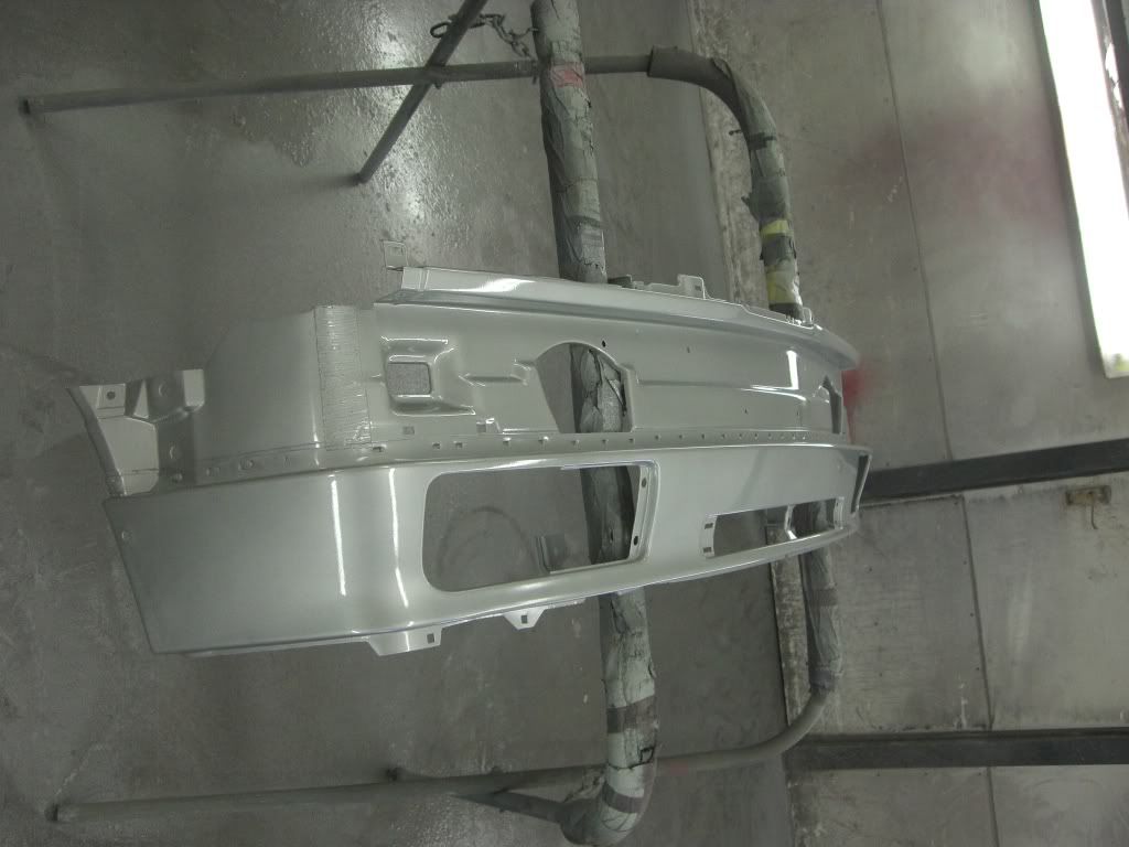

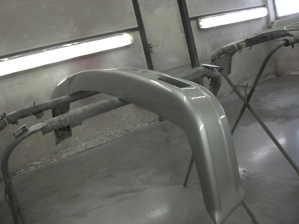

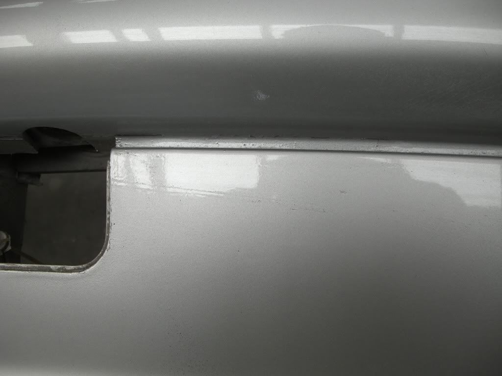

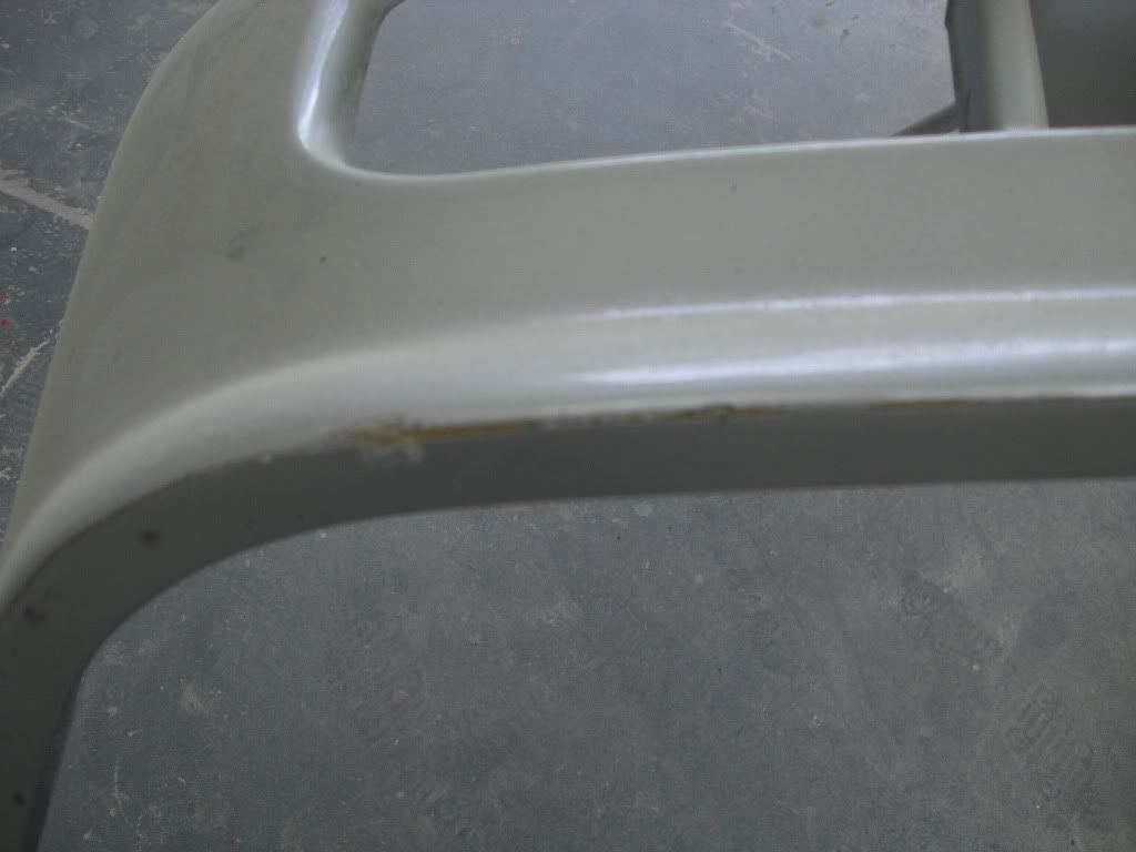

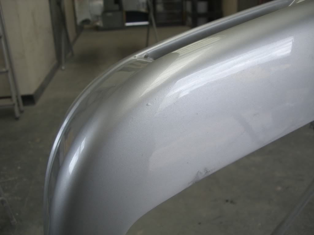

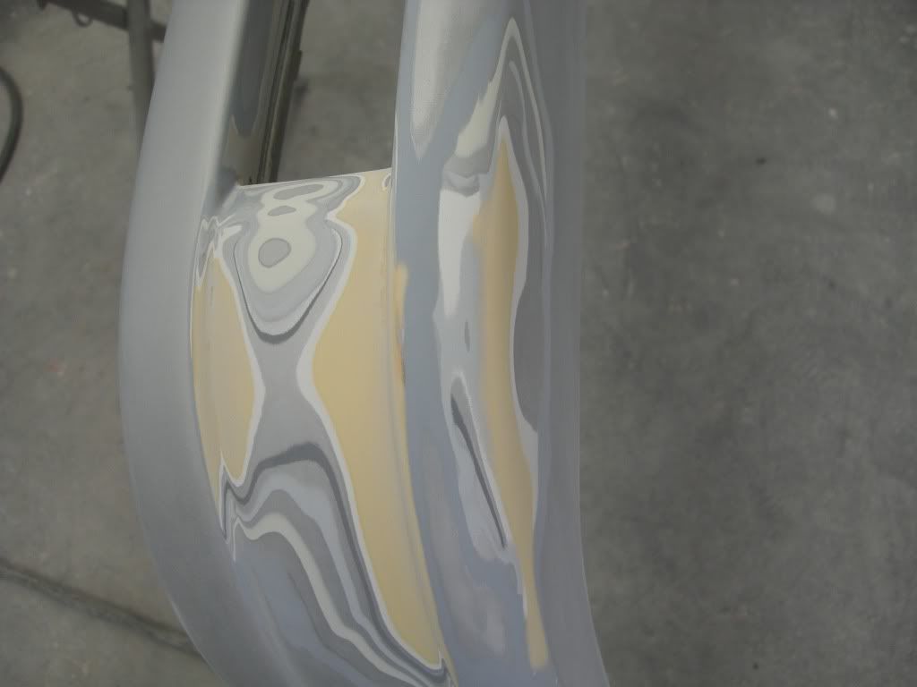

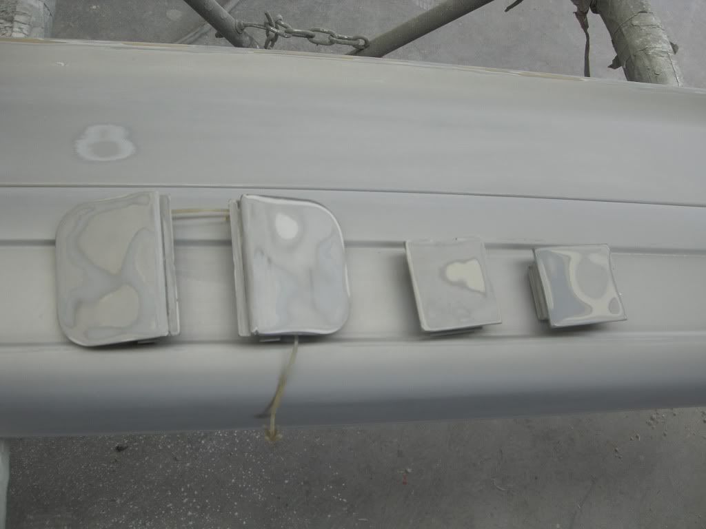

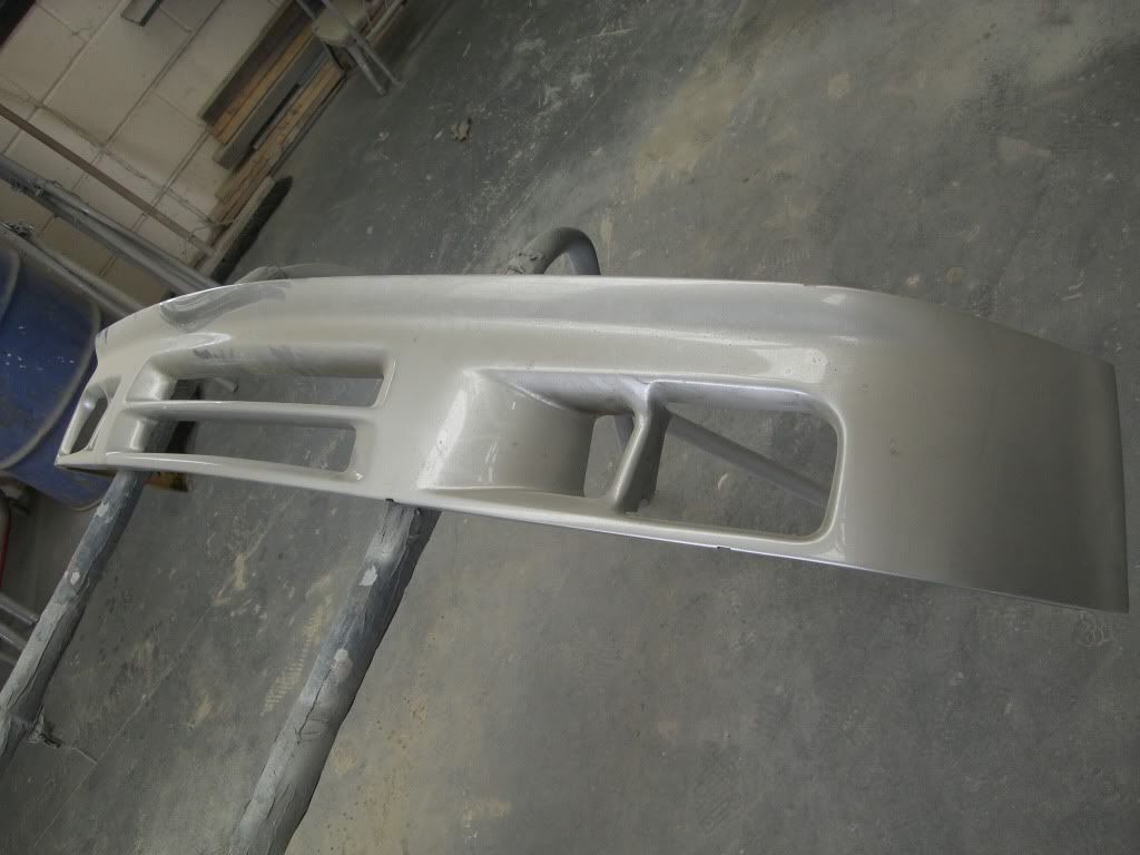

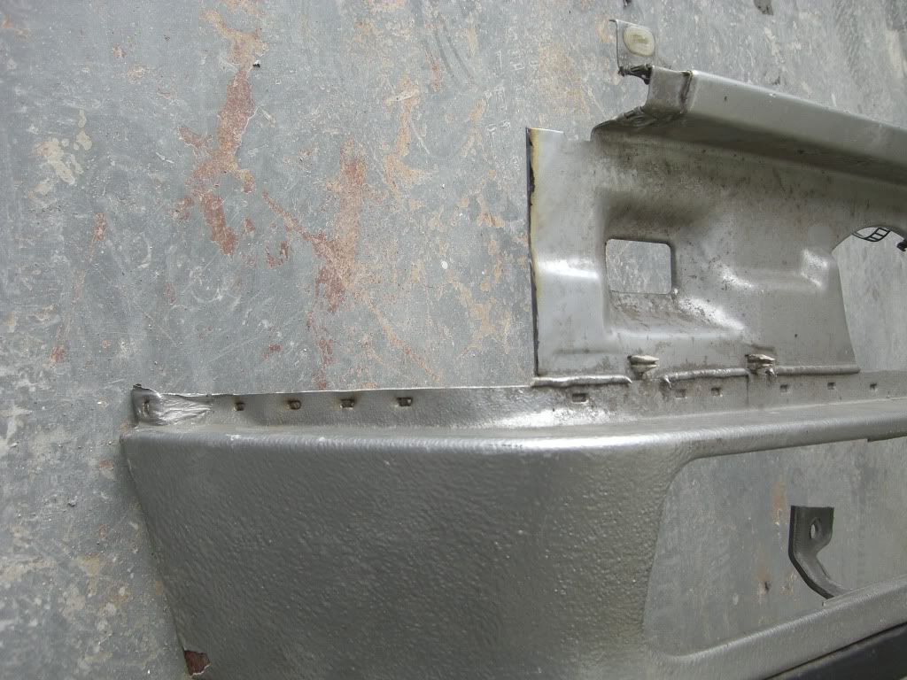

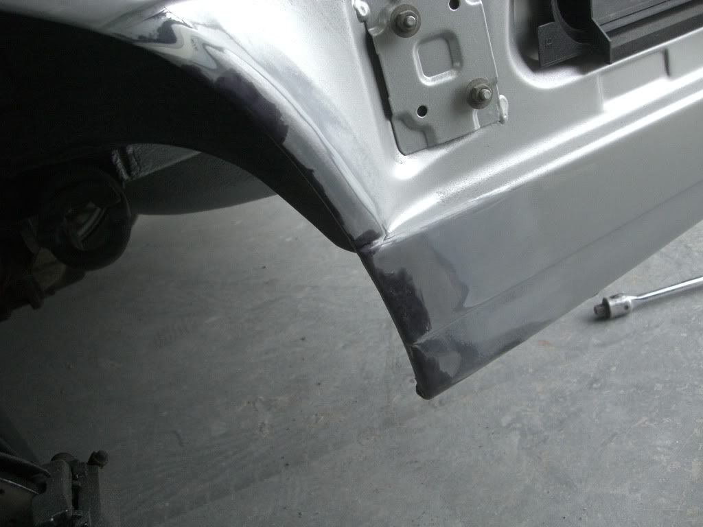

Front bumper before repairing: It actually looks ok in the pics but there were a few marks, chips, etc that needed rectifying.
After all the repair work was carried out it was now ready for the primer stage: The front bumper had 12 coats of various primers, paints and lacquers applied to it during its life. Thats a hell of alot of material on one panel!

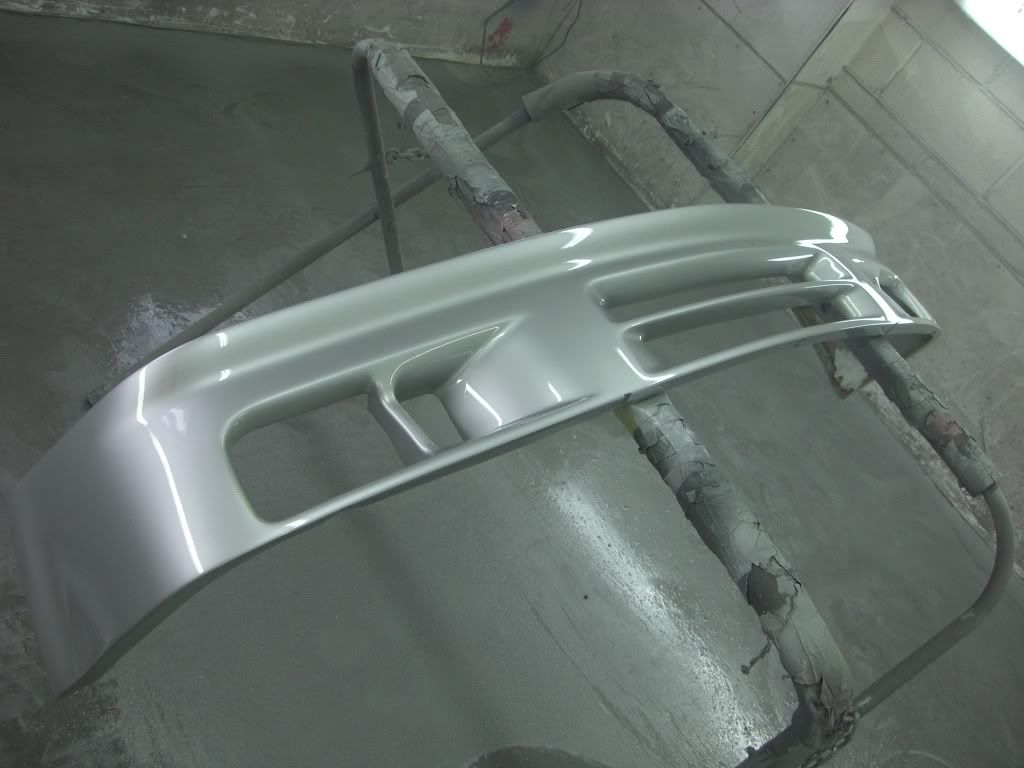

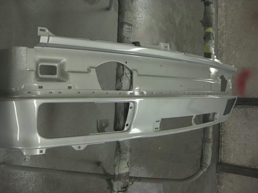

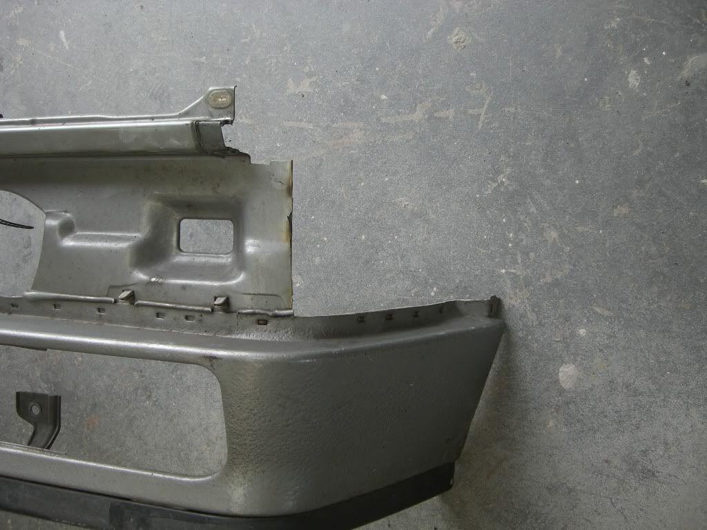

Now the same for the front valance:
Ready for primer:

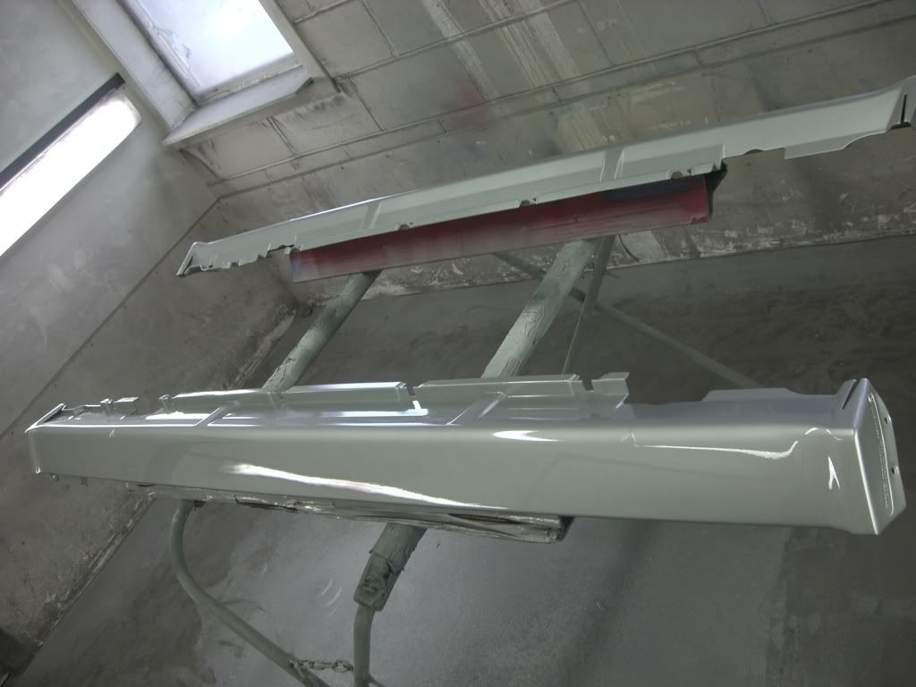

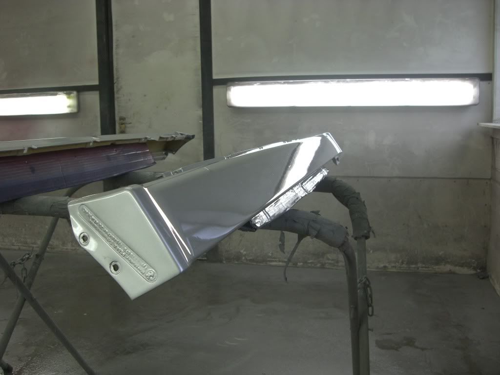

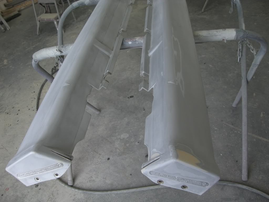

Side skirts:
Ready for primer:

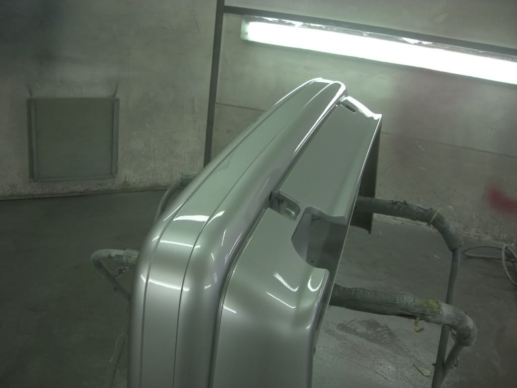

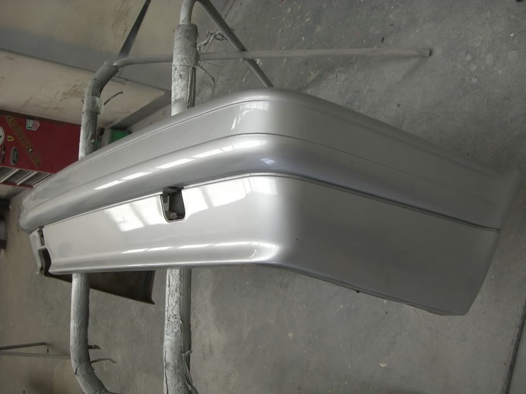

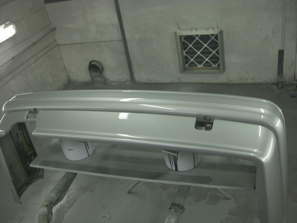

Rear bumper and toe eye covers:
Ready for primer:

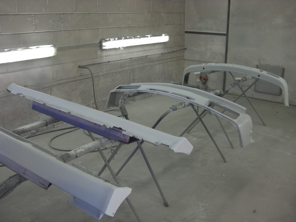

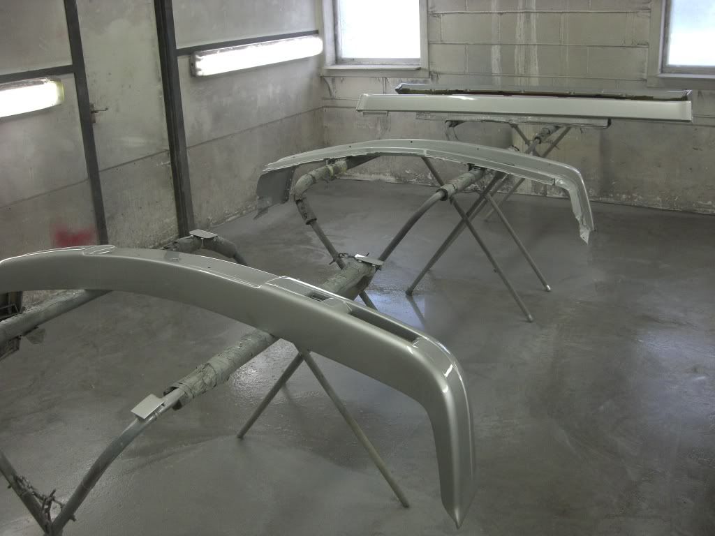

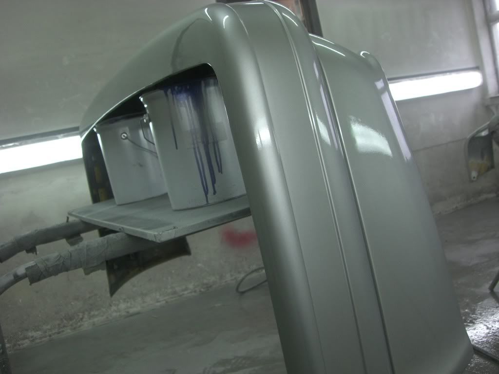

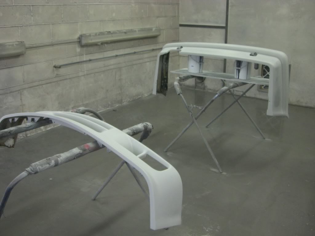

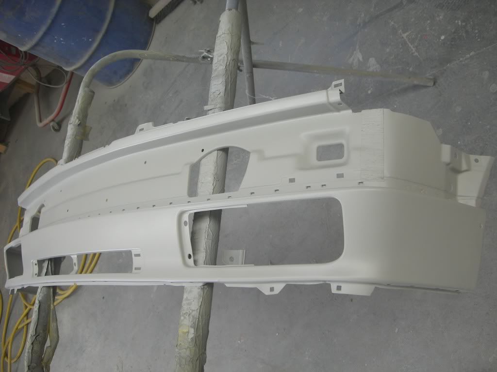

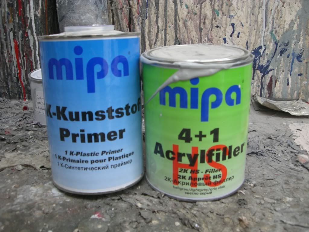

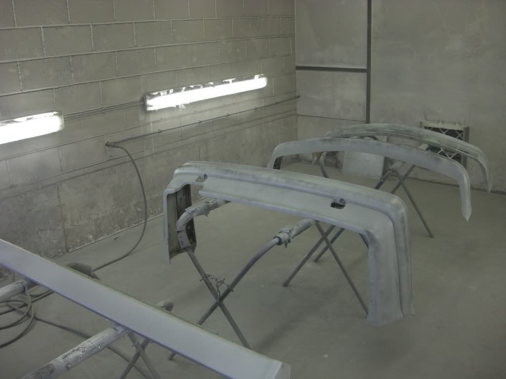

heres a pic of all the parts in the spray booth ready for primer:
time to prime lol. plastic primer on the left which goes on first then light grey high build primer
all primed up :D

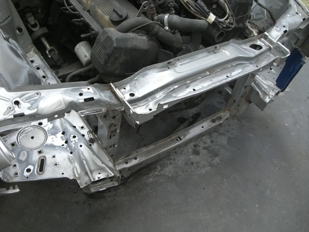

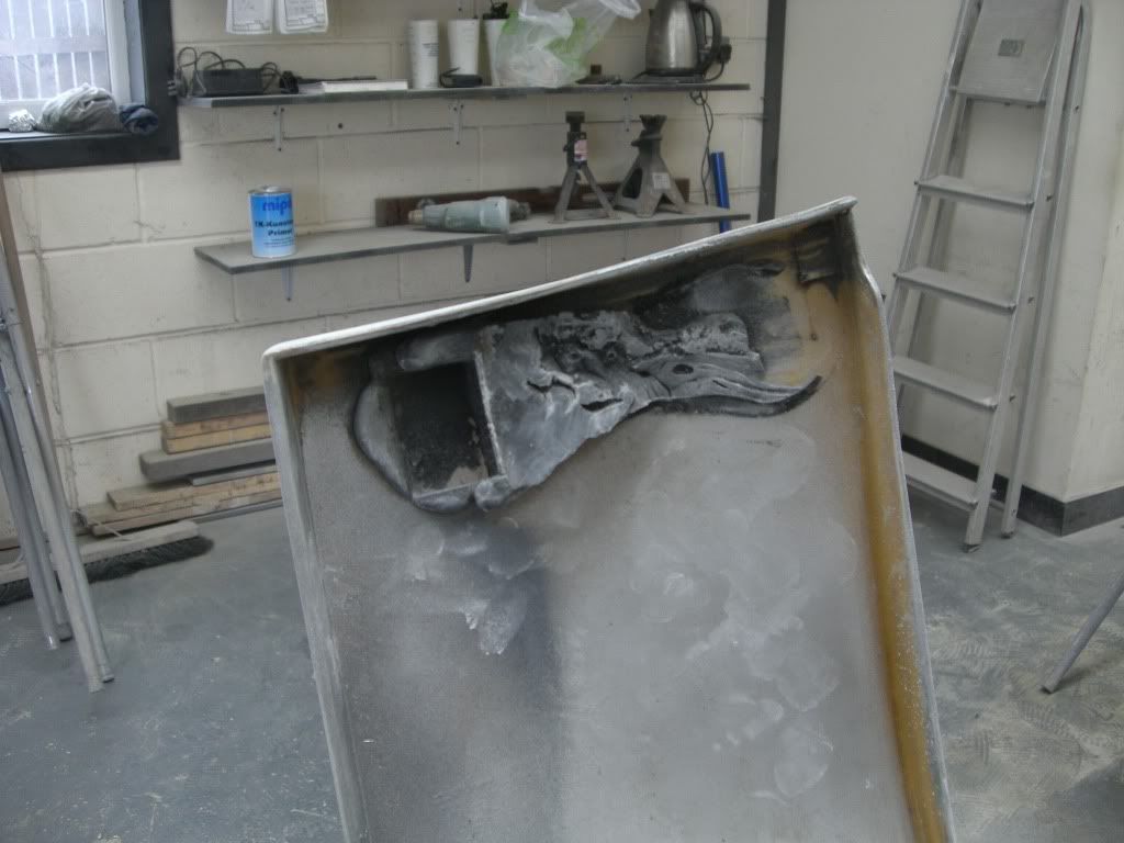

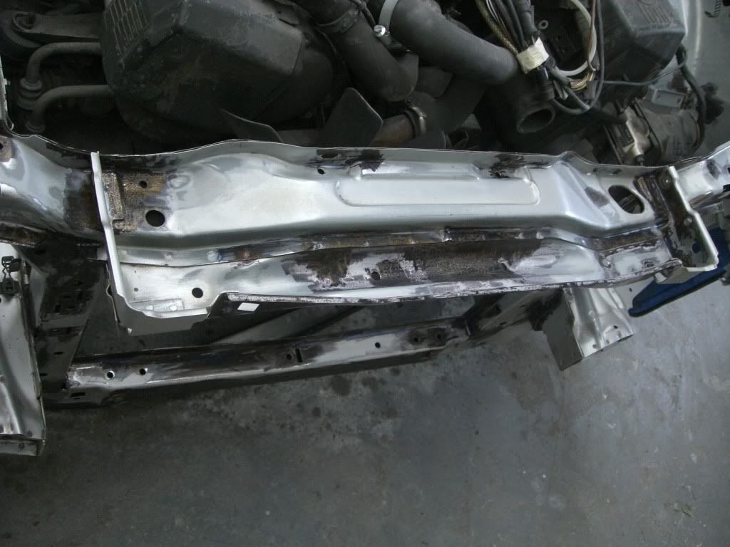

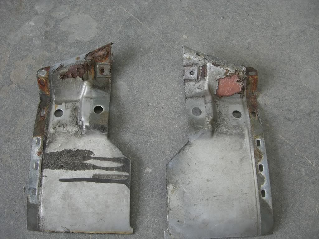

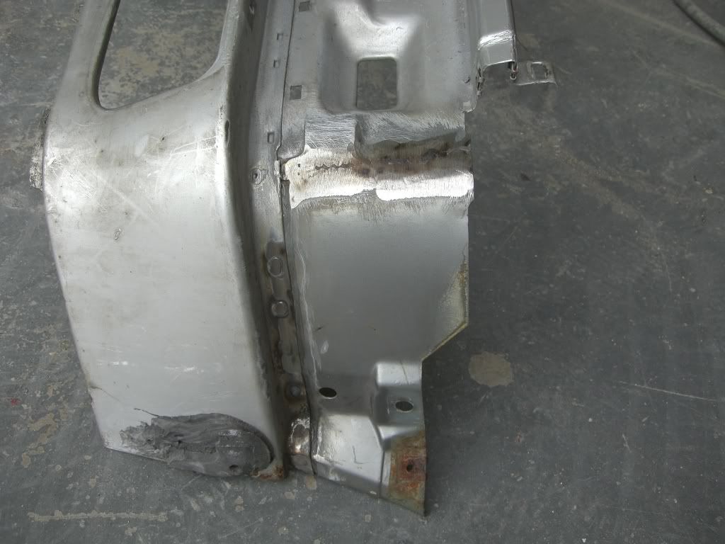

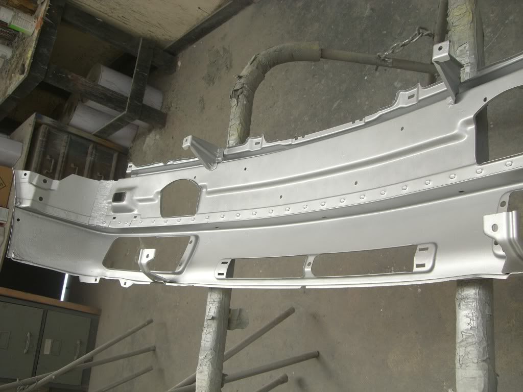

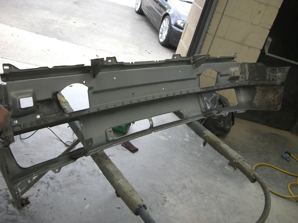

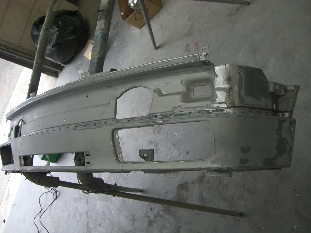

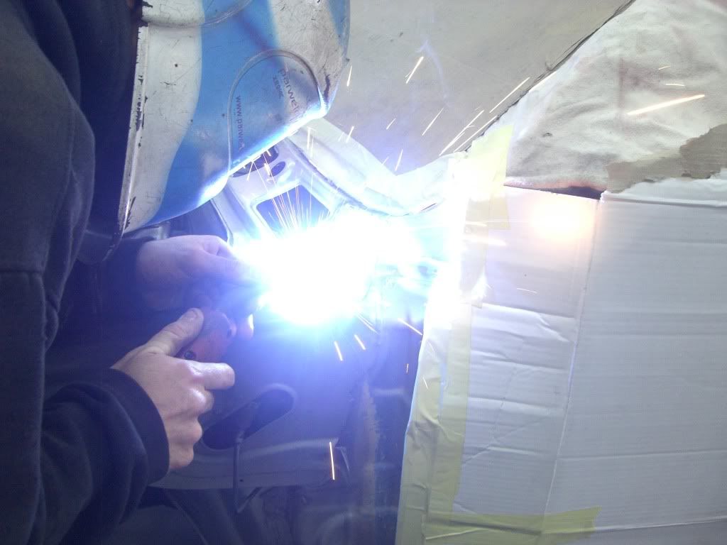

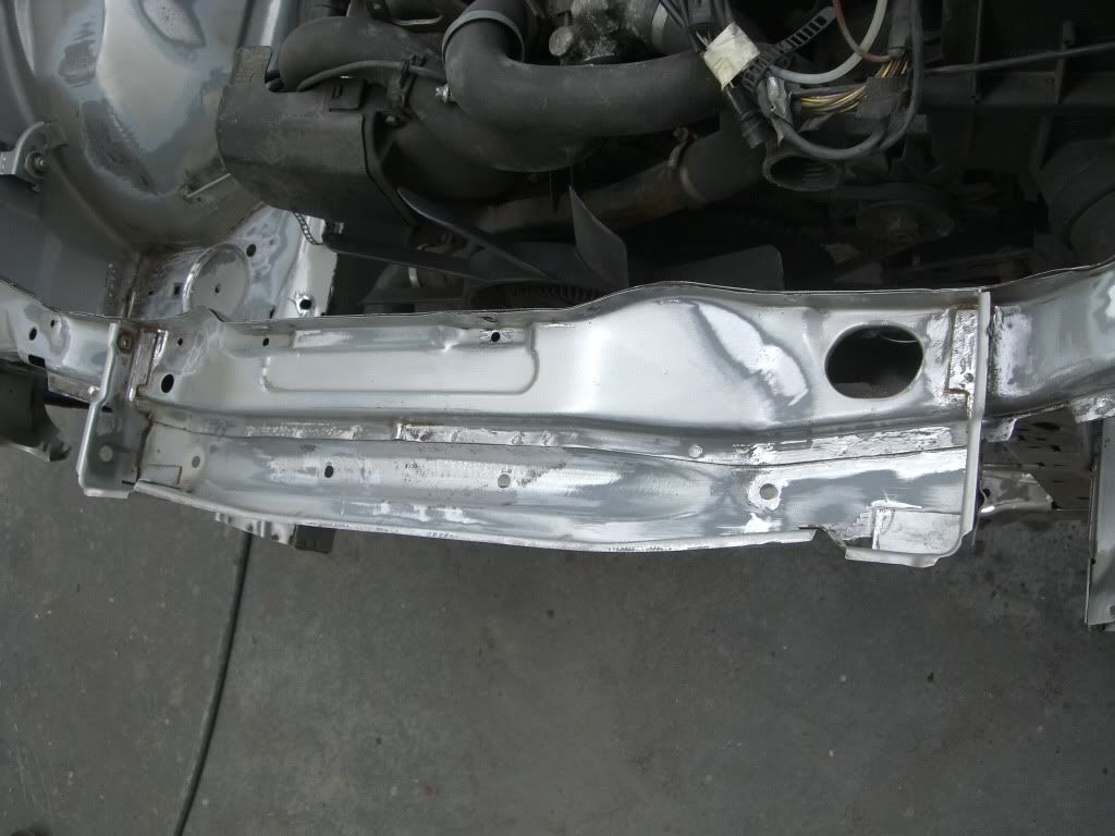

next thing to get treated was the front panel which was rather rough and needed two corner sections removed and replaced with better sections from a donor panel kindly given to me by my mate.
heres the rotten corner bits that got removed:
time to cut off the good bits from the donor panel:
new bits welded in place by my good mate kyle at chizfab, his workmanship is truly top notch!

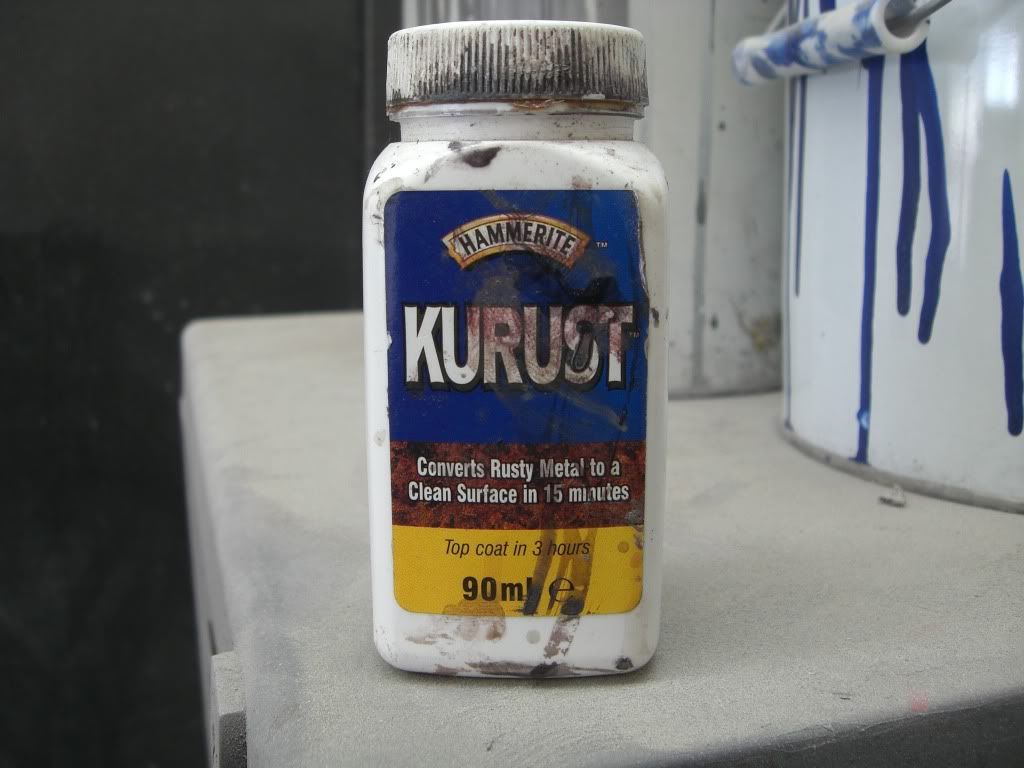

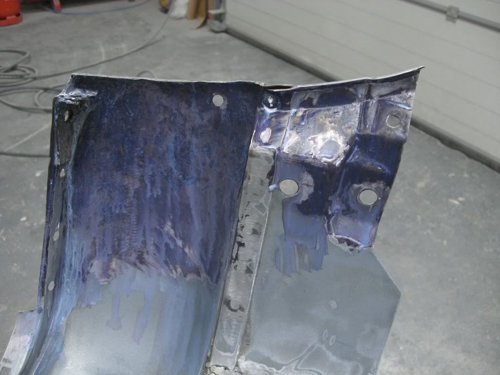

next thing to do was scotchbrite the whole panel with petrol and rub out any rust on the rest of it with the orbital sander and a 120grit disc then a 320grit disc.
now all the rubbed out rust was ready for this stuff to stop the dreaded brown stuff from returning in the future.
it goes on white and turns purple blue with it bites into the treated areas.

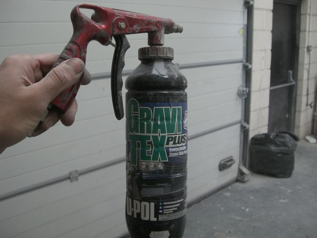

now thats dried its time to put some brushable seam sealer over the welds and then underseal the bits that require it.
now thats done its time to prime the whole thing and paint the back of it just now as the front of it will be getting painted at a later date.

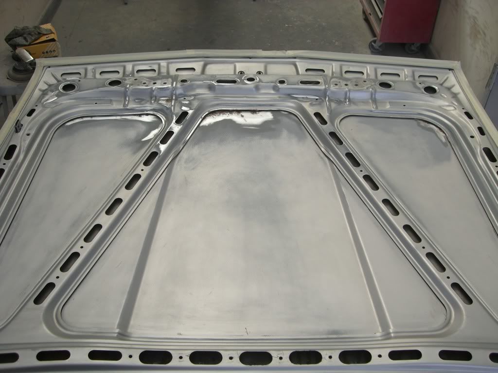

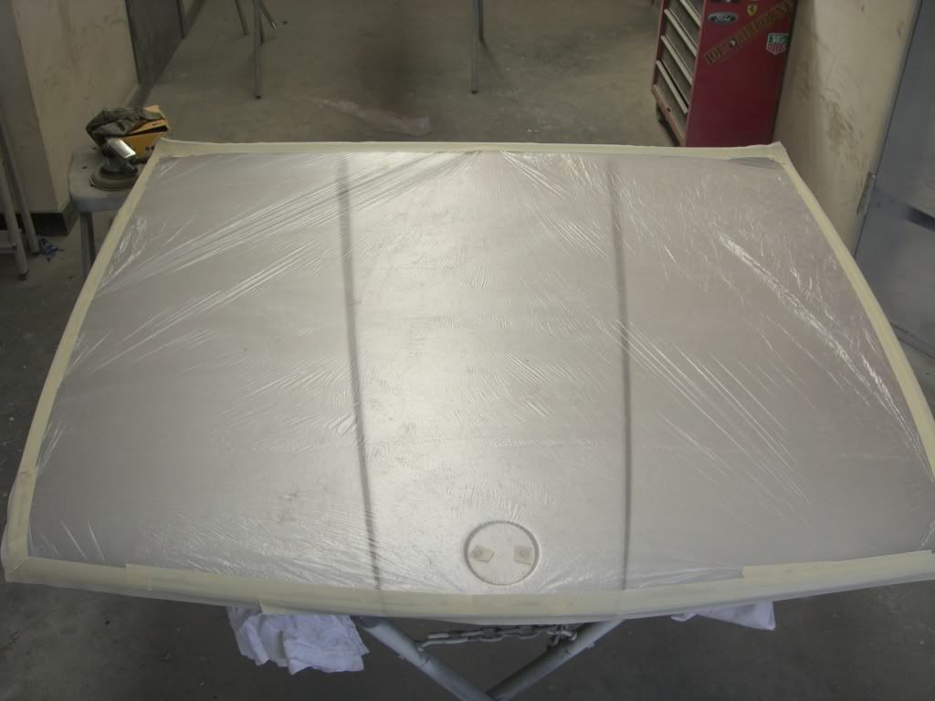

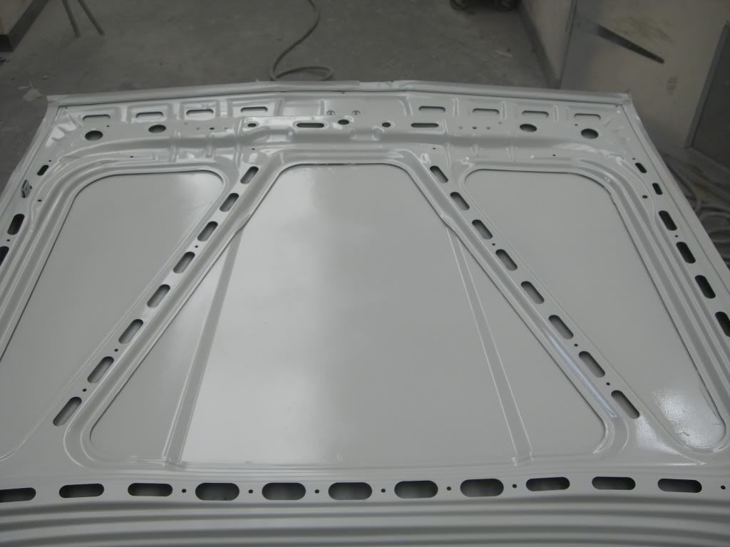

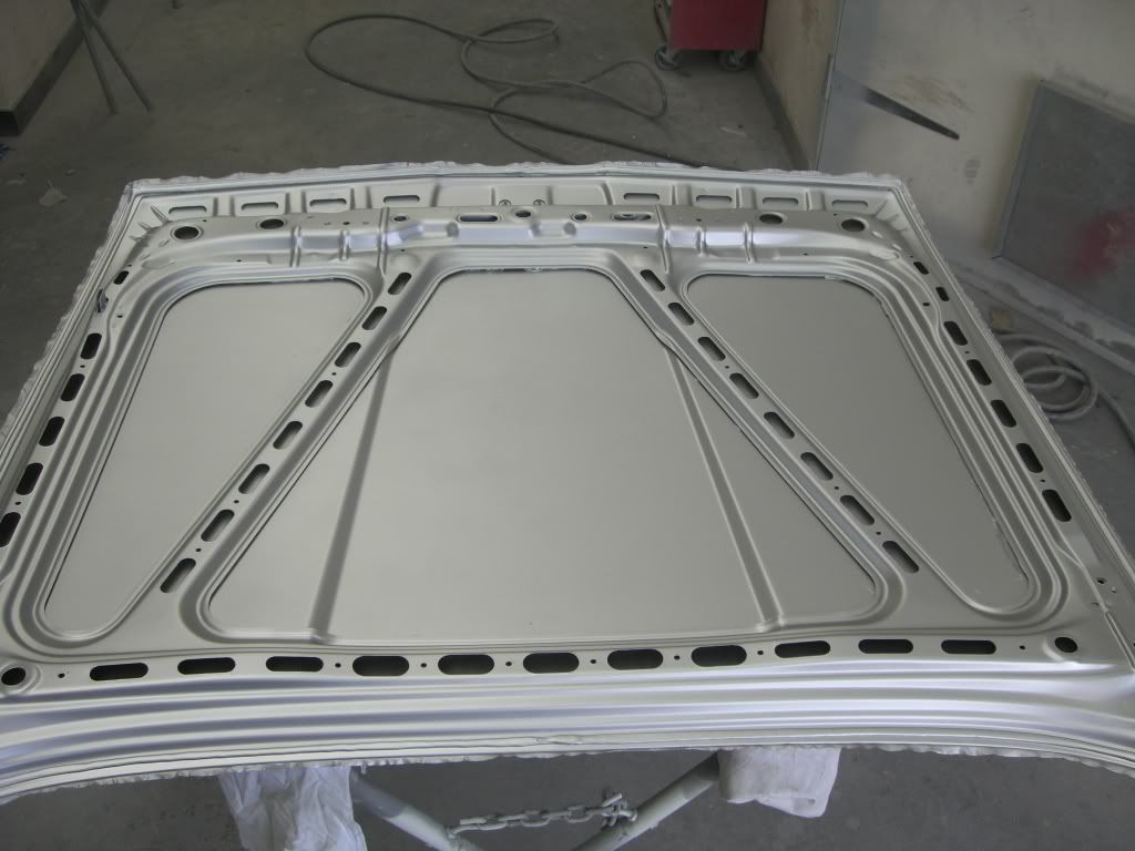

with that out the road for the moment it was on to the back of the bonnet.

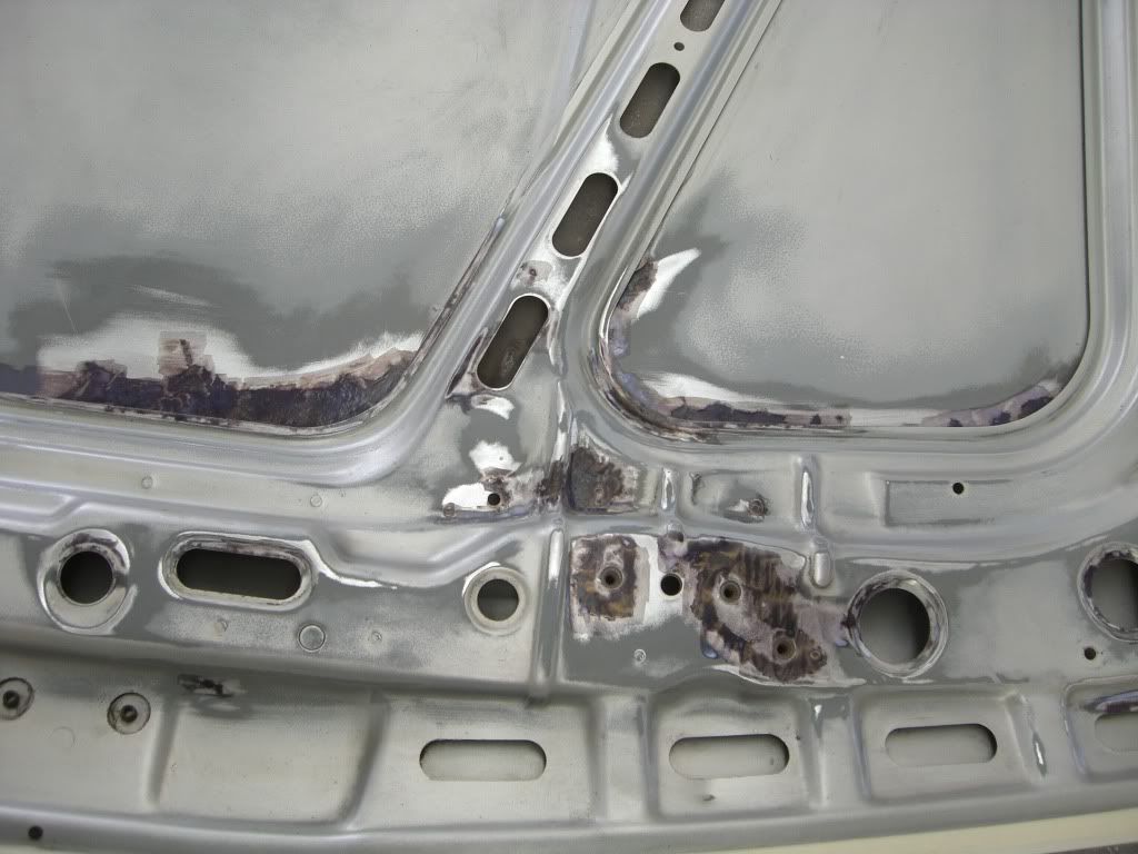

as you can see its in need of some work :?
i removed all the glue left by the old tatty heat insulation then scotchbrited the whole panel with petrol and rubbed out all the rust, again using 120grit and 320grit disc.
time for the rust treatment again.
after that dried it was time for primer and paint. but first i had to mask up the front of the bonnet to prevent it from getting covered in overspray.
primed then painted.
with that done i ordered brand new insulation from my local bmw dealership phoenix in kirkcaldy along with some other bits n bobs aswell as a full inspection 2 service kit minus the diff oil which i'll order later on.
been rubbing all the primed bits today. great fun! //// just about done. I'll get more pics up tomorrow of progress made today,

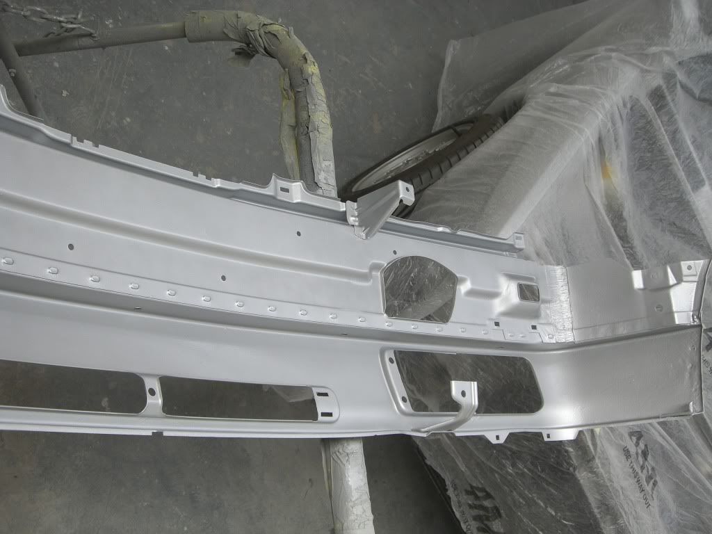

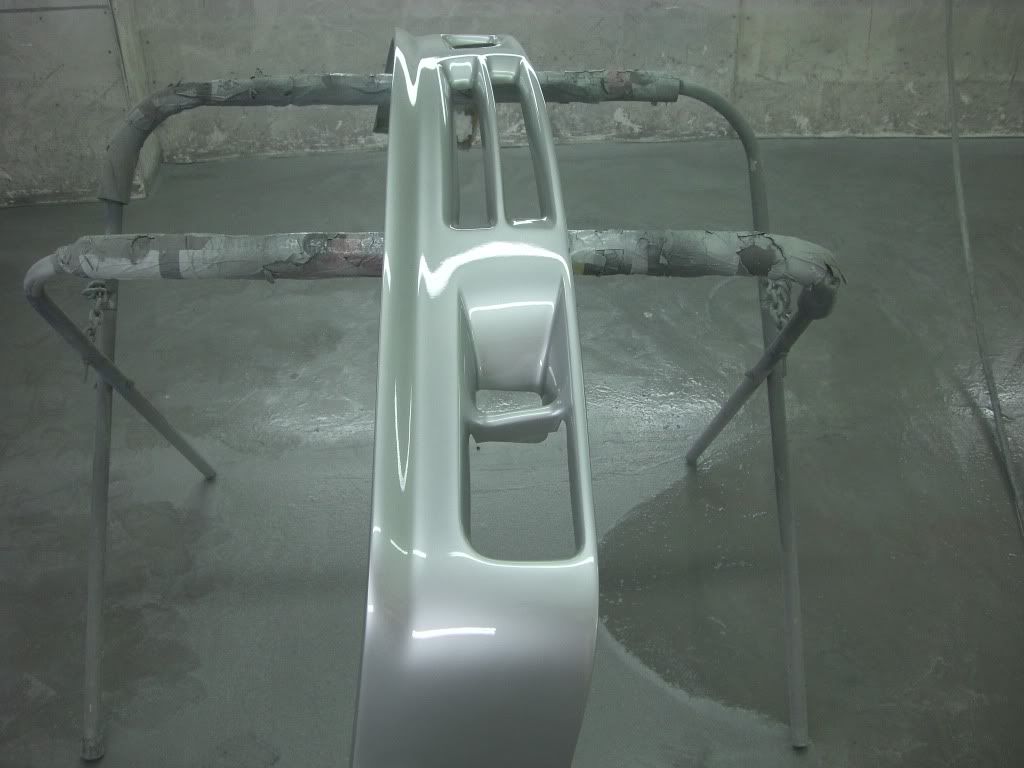

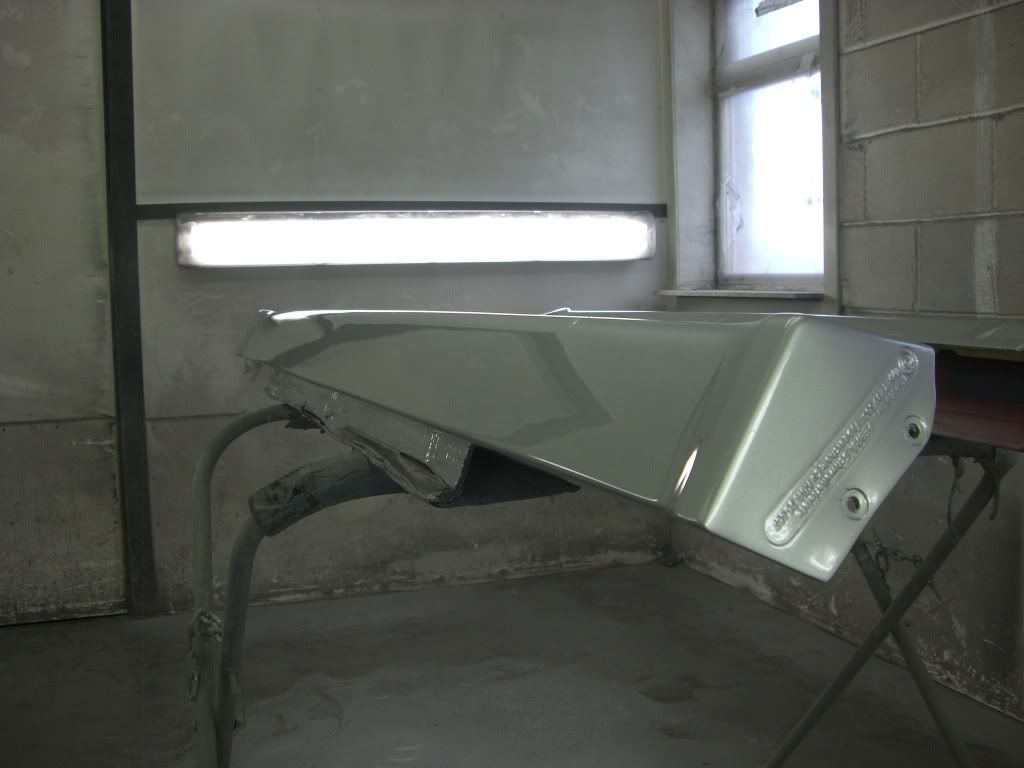

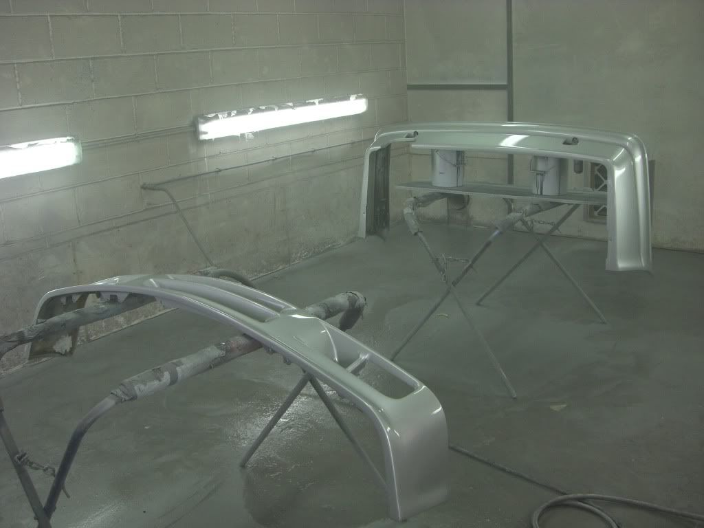

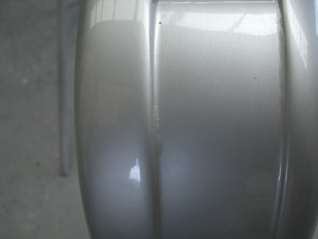

Quick update of further progress made today.

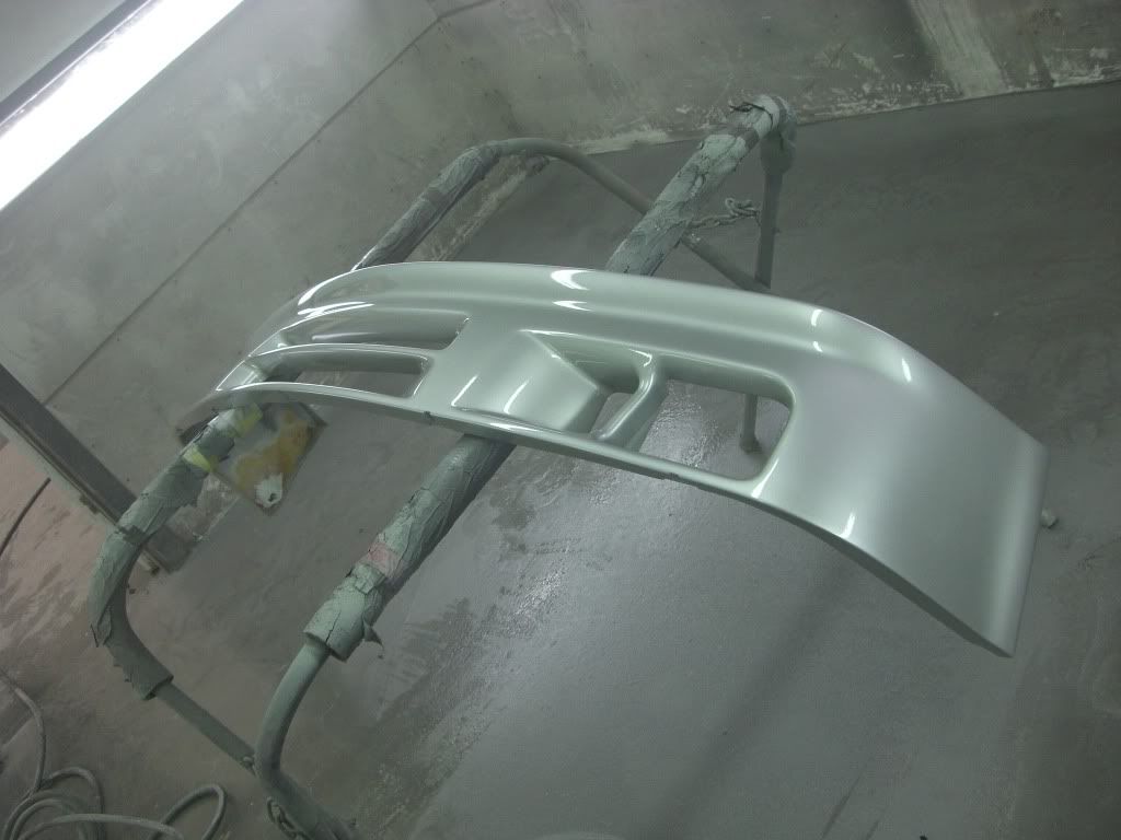

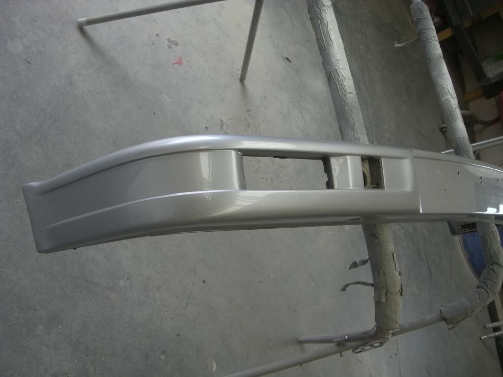

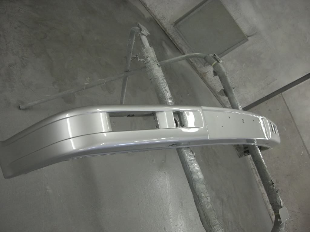

sideskirts, front panel, front bumper and toe eve covers. Primer all rubbed, panel wiped and ready for some sterling silver and lacquer. :)
Here's the results after the paint fumes were extracted.
I'm delighted with the finish i achived today :D
Same treatment for the front valance and rear bumper tomorrow.

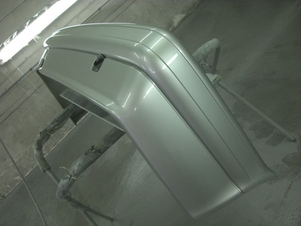

Quick update of further progress made on saturday.
front valance and rear bumper, primer rubbed, panel wiped awaiting paint and lacquer.
All done :D

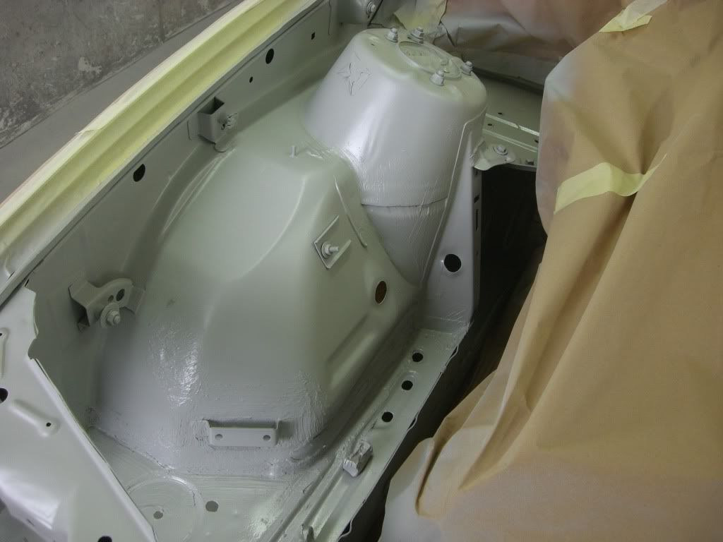

Been a busy week so heres an update of the progress made.

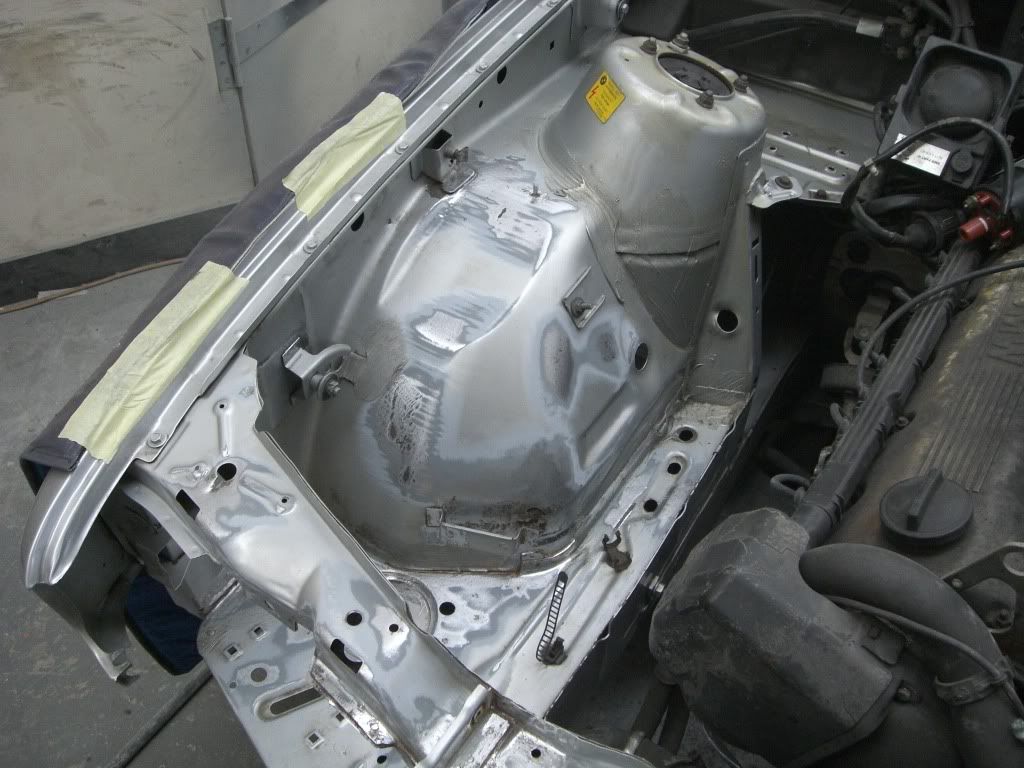

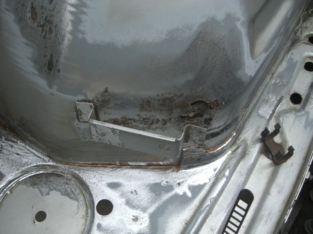

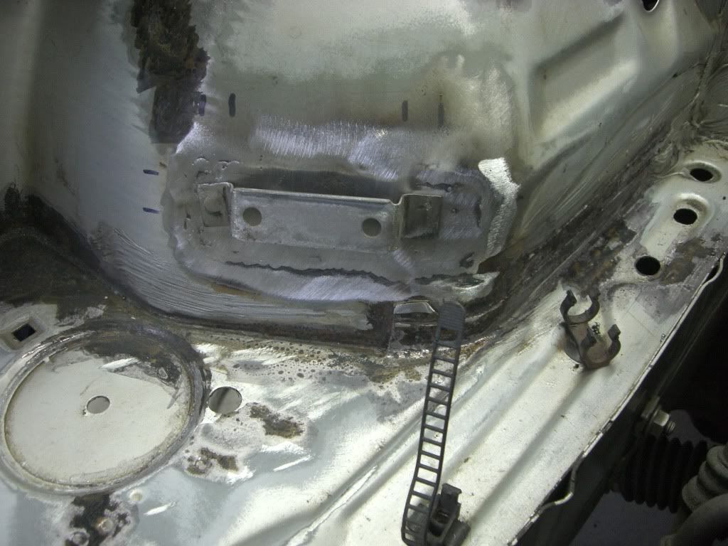

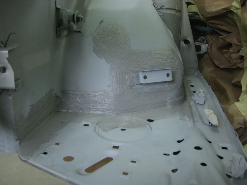

First thing on the cards this week was to rectify all the rust on the engine bay/slam panel.
After a whole day of scotchbrighting with petrol, cleaning it with petrol and alot of grinding and buffing with 80grit heres what i achived.
now thats done it was time for some rust proofing again.

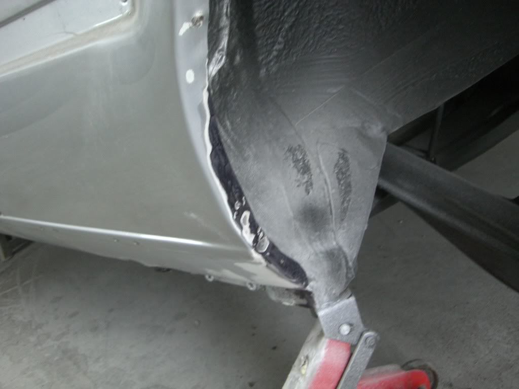

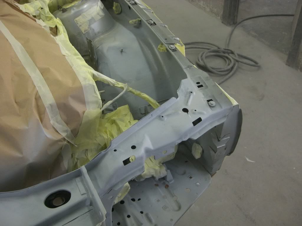

Now the engine bay was ready for primer it was time to move onto the sills and wheel arches

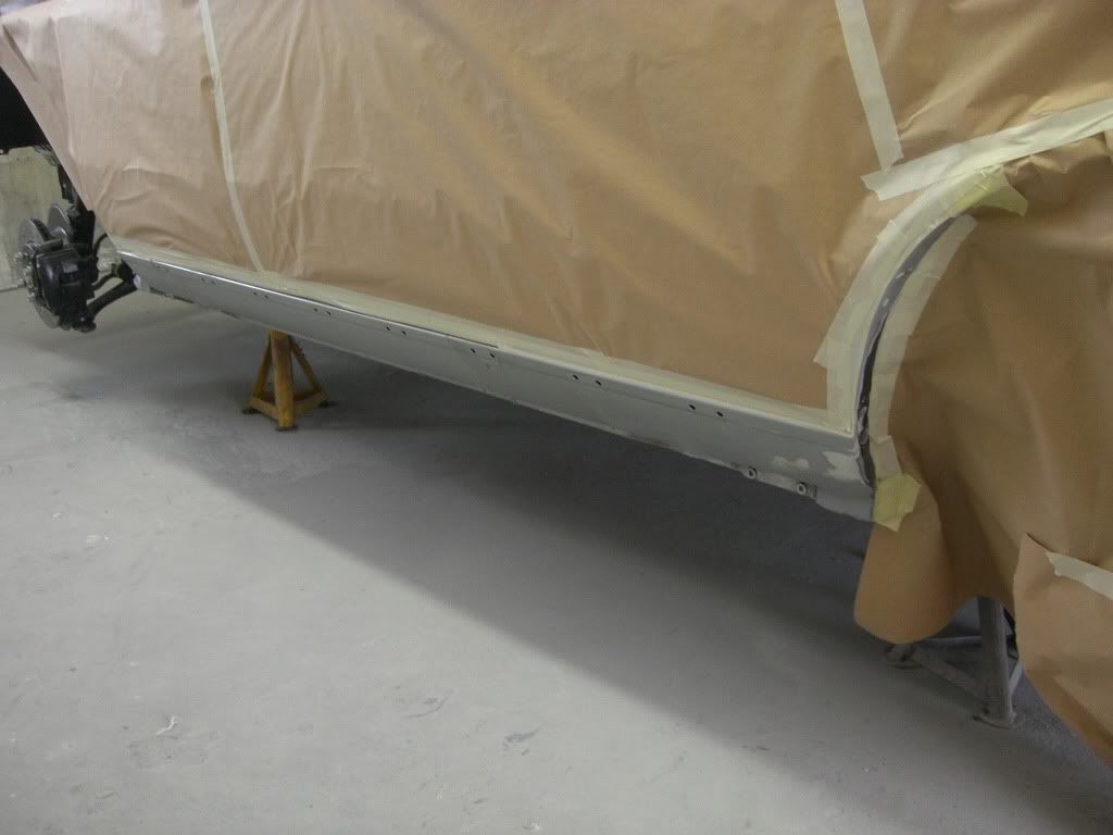

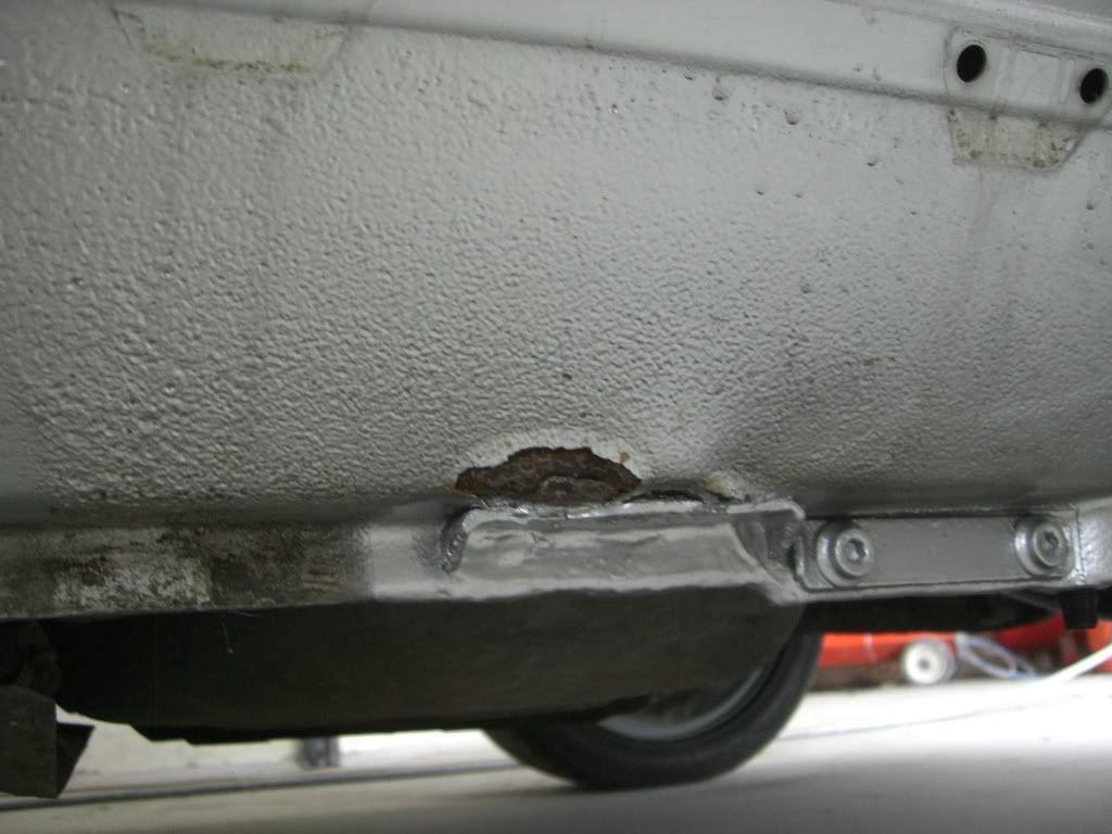

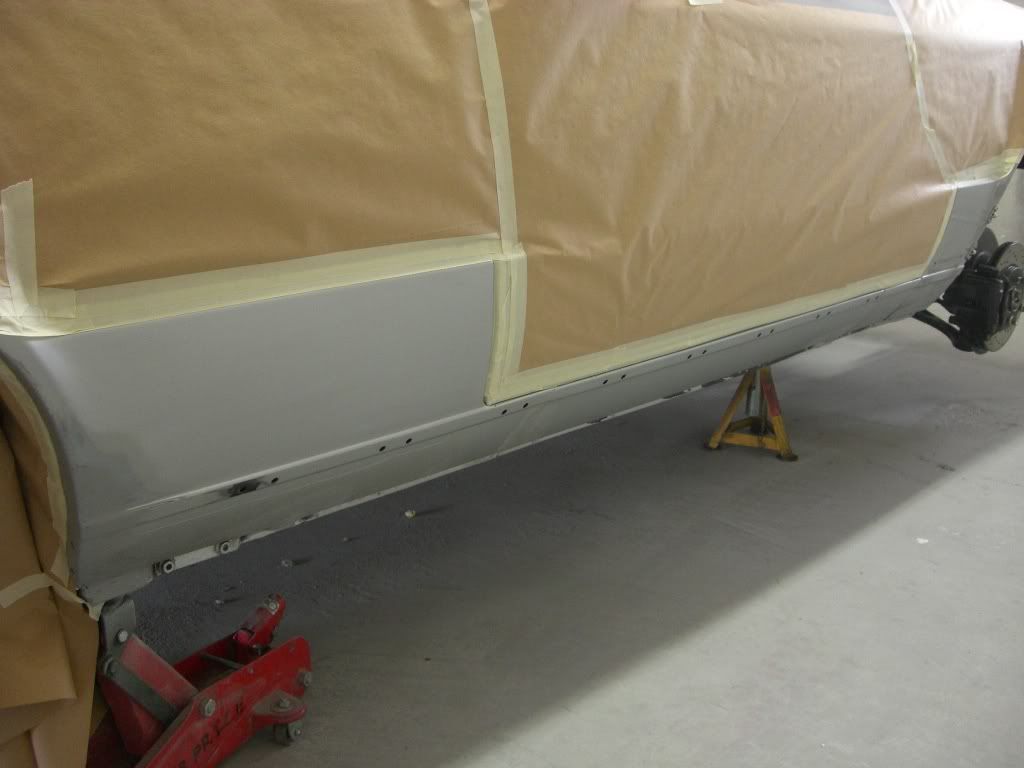

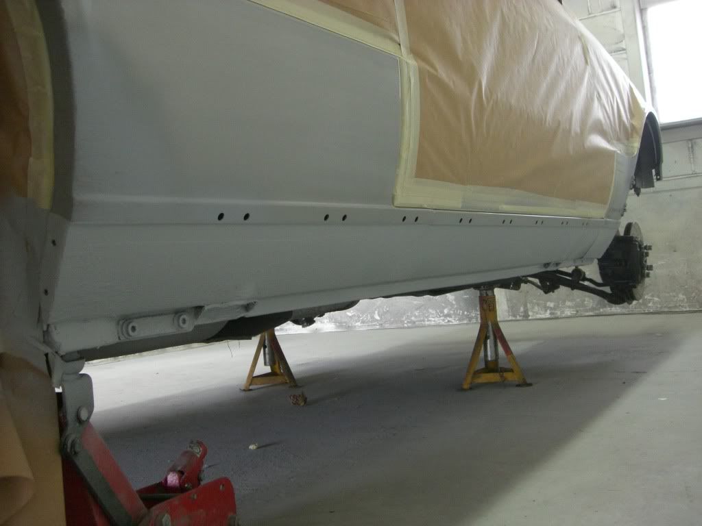

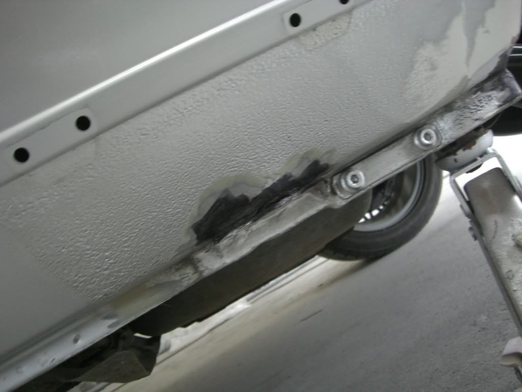

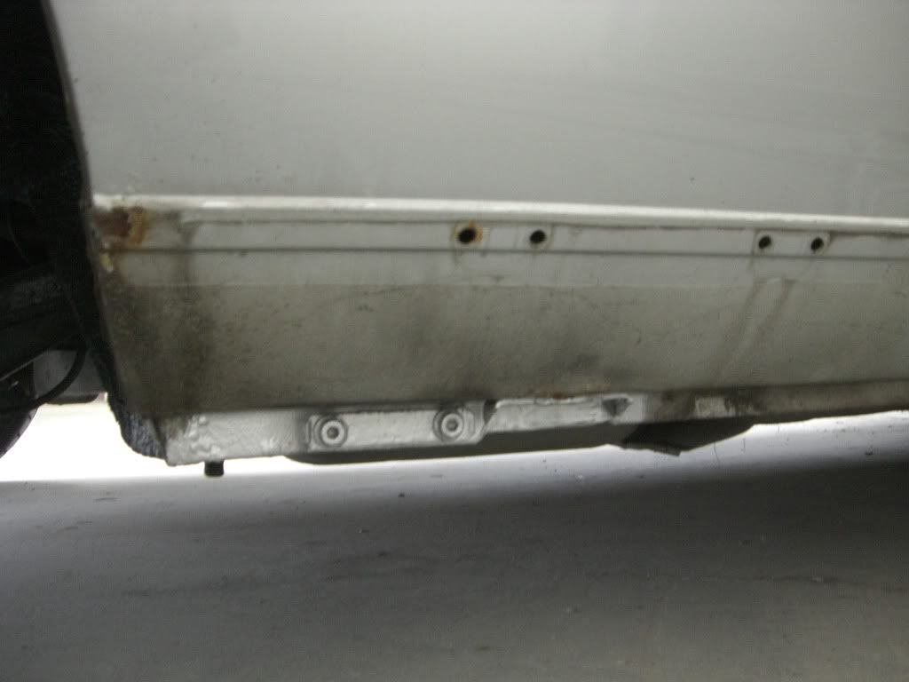

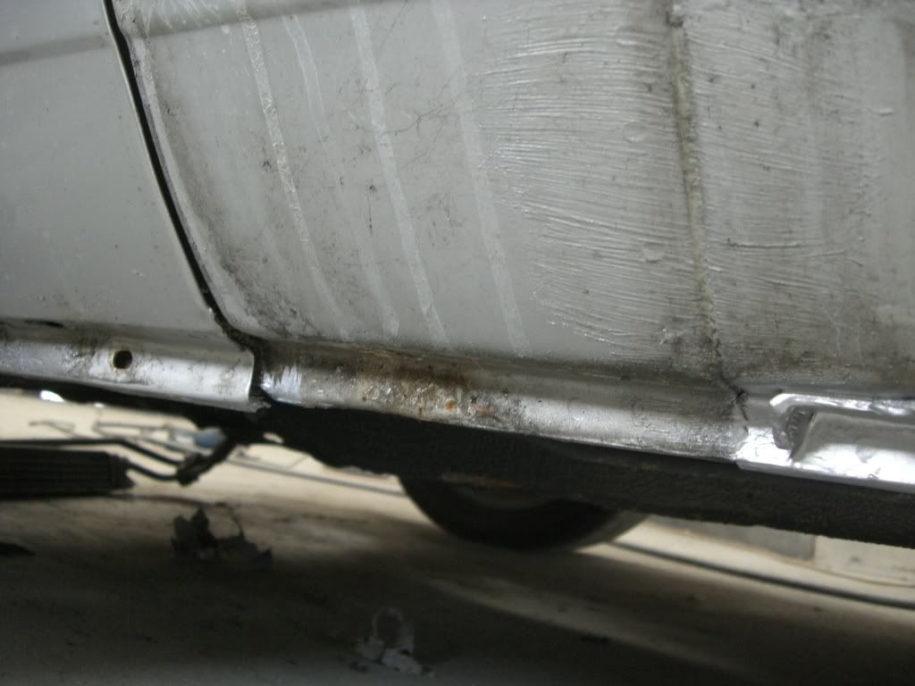

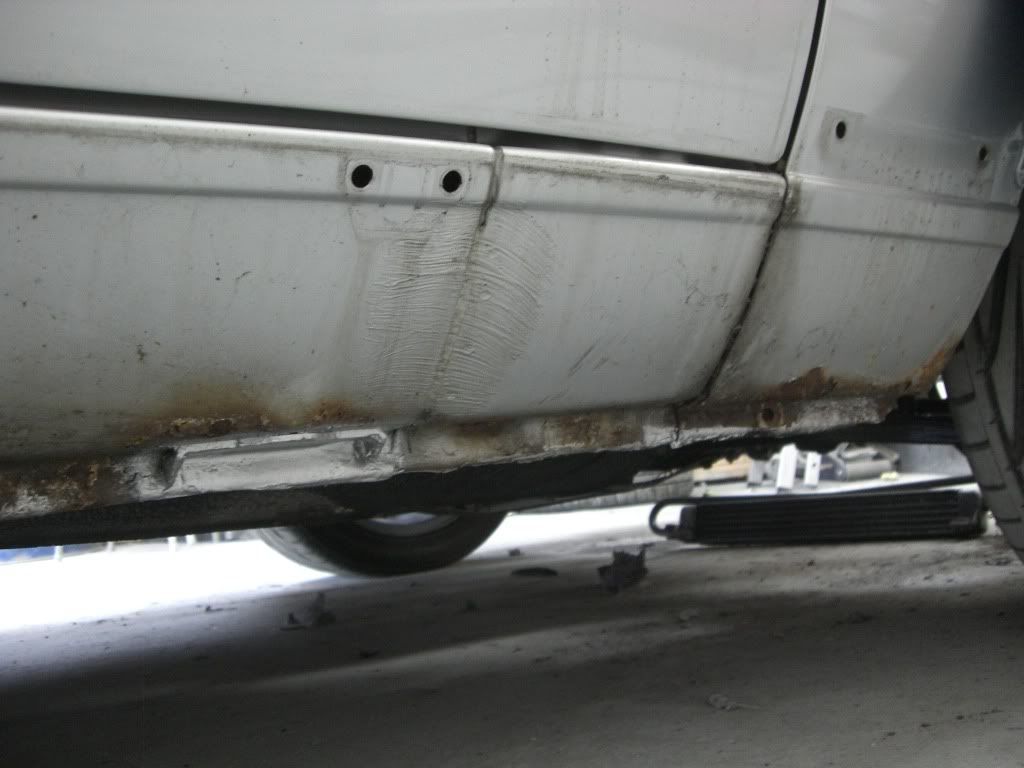

heres pics of the passenger and drivers side sills before i started

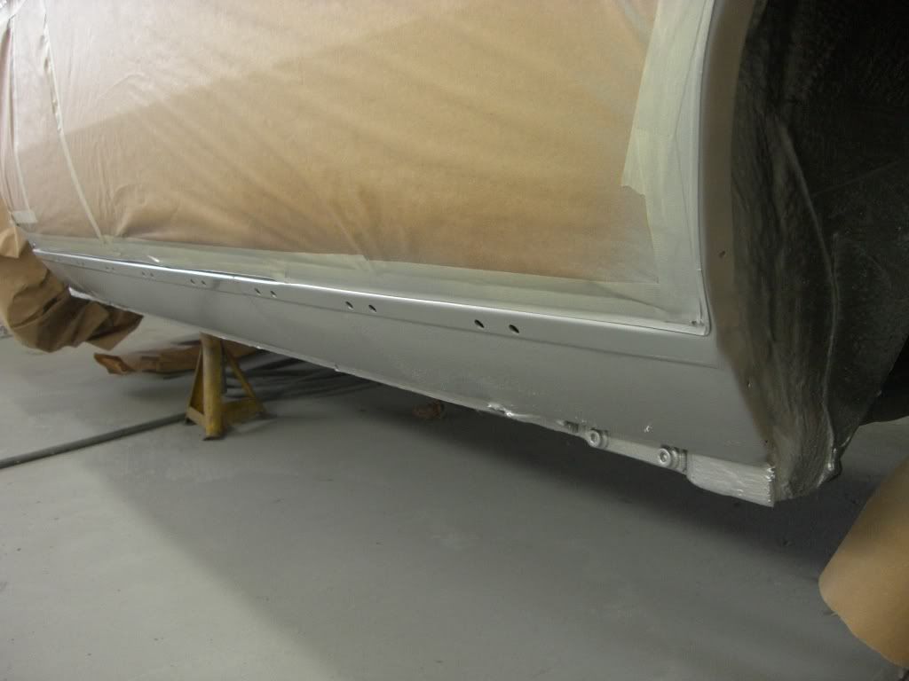

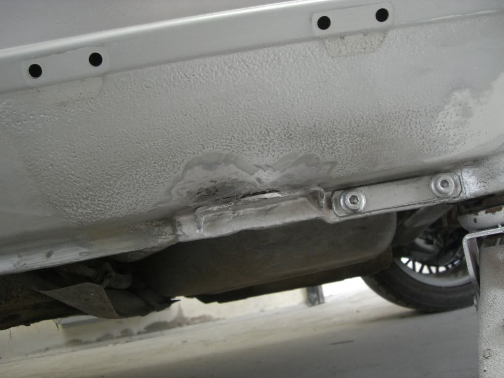

So i ground all the rust back and scotchbrighted the whole sill on both sides.
Then i applied the rust proofing then the seamsealer.
Same drill for the wheel arches.

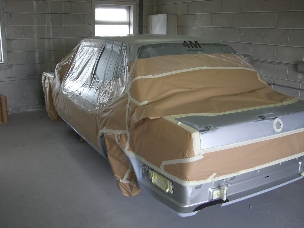

Got lots more done today so heres a round up of whats been happening down at toole design HQ!

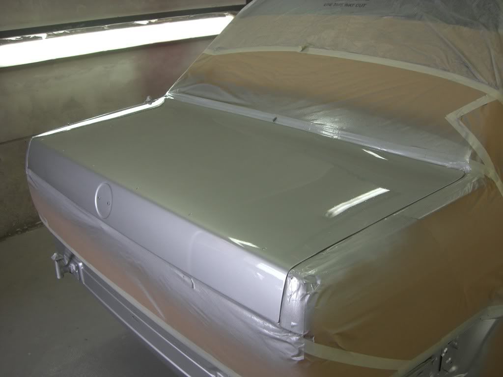

First thing for today was to repair the nasty bits on the bootlid.
Rubbed all the bad bits out and applied some rust proofing.
Time to mask it up for primer and paint.
Then i undersealed the sills and rear panel.
Now it was all masked and sealed it was time for kyle at chizfab to work his magic again.

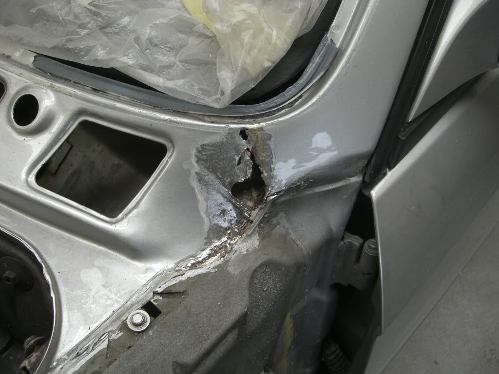

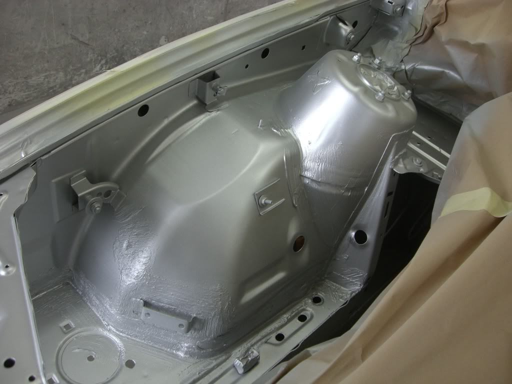

First thing to get some new metal was a rather nasty bit on the engine bay.
Kyle cut out the rot replicated the section needing replaced then welded it in. Mint!!
While he was doing that i had some time to tidy up some of the bits to go back in the engine bay after it was painted.

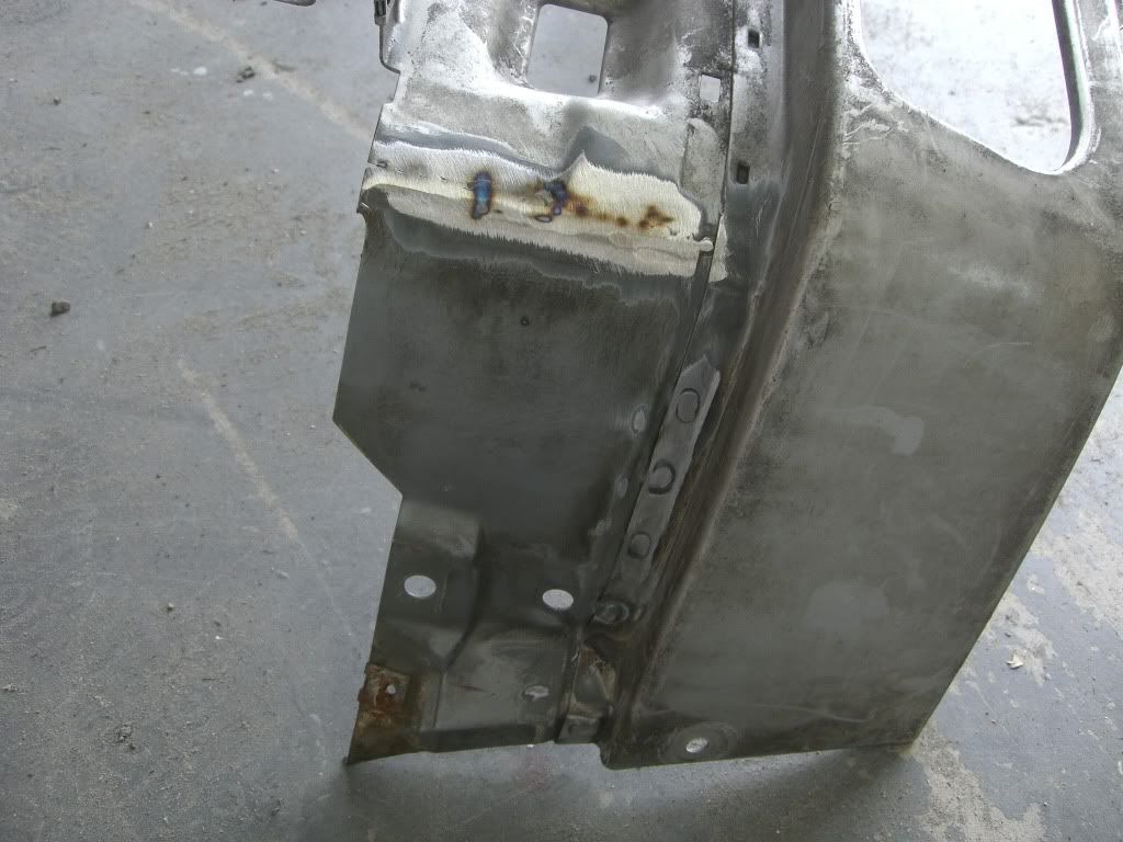

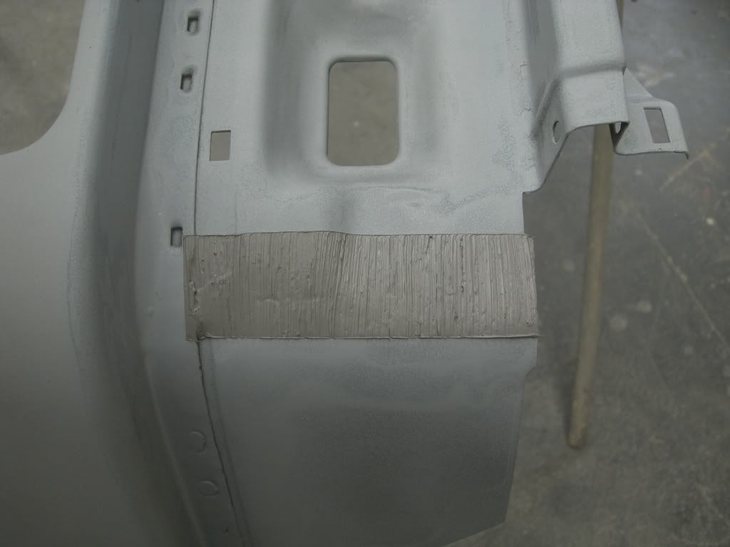

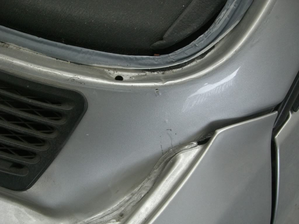

With the engine bay section done kyle was ready to move onto the scuttle panel.
It doesnt look to bad in this pic but it was!
We proceeded to dig out alot of fibre glass from a previous repair. there was alot of it but we got it all out eventually. :)
Now we had good metal to weld on kyle proceeded to work his magic.
With the new section welded in place and buffed down all it needed now was a light skim of filler.
With all the prep work complete on the car its time to prime and paint all the parts shown tomorrow.

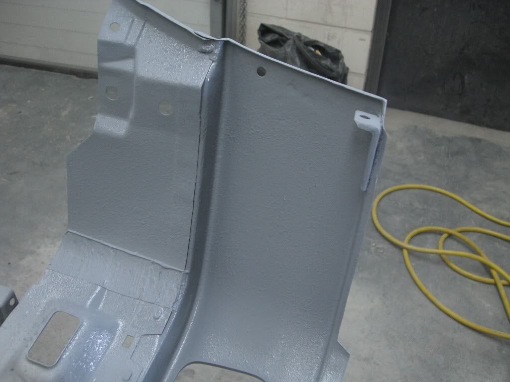

What a day! i'm knackered, had to go in at 6:30am today so i could get all this done before kyle could get a shot of the booth tonight to paint his drift car. Anyways heres what went down today.

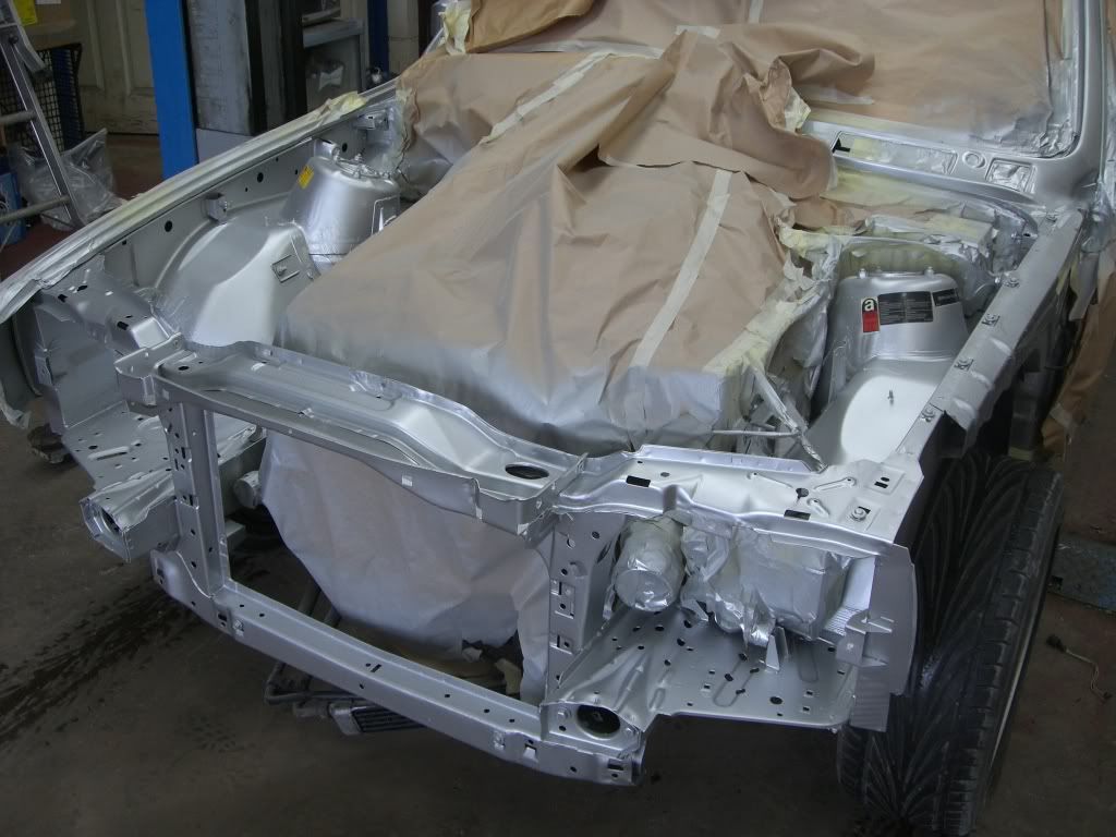

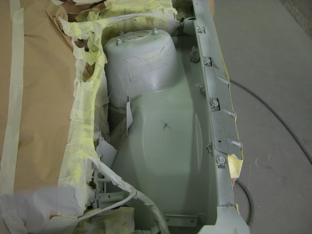

First of all i finished the rest of the masking from yesterday
The engine bay took flippin ages!!!!!!!
I then etch primed all the bare metal.
Then i seam sealed the bracket kyle welded in the bay and some other bits.
Now thats done it was time to shoot some 2pack primer.
Once the primer was rock hard it was ready to be flattened using 320grit discs then 500grit discs then all panel wiped and painted.

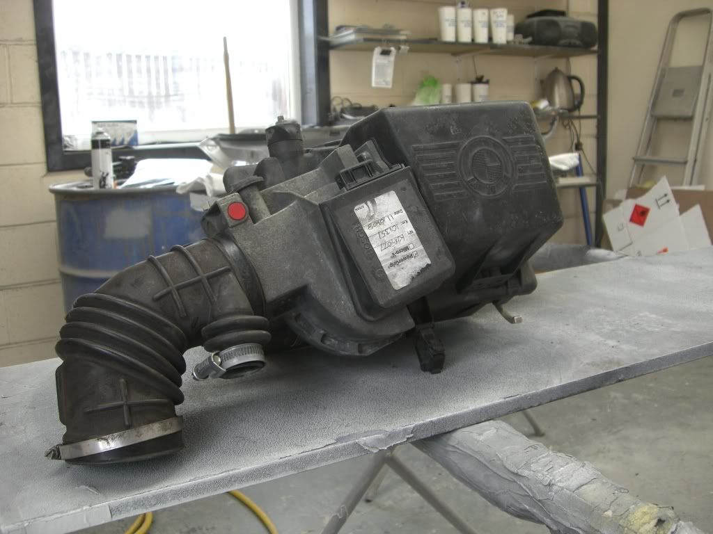

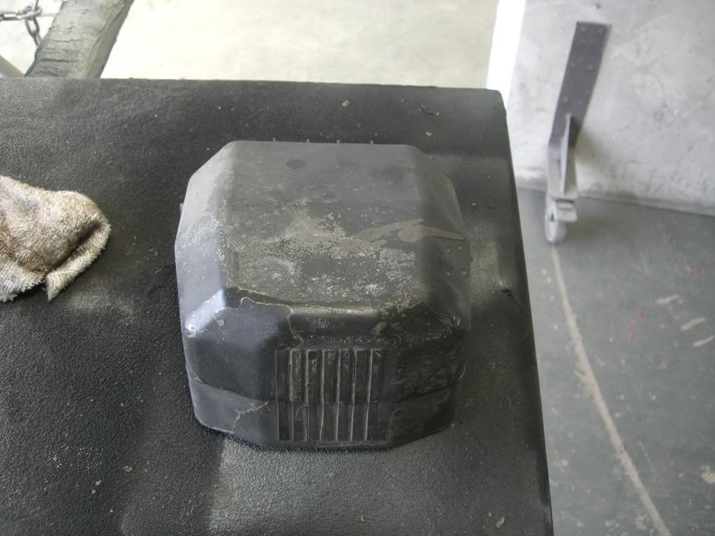

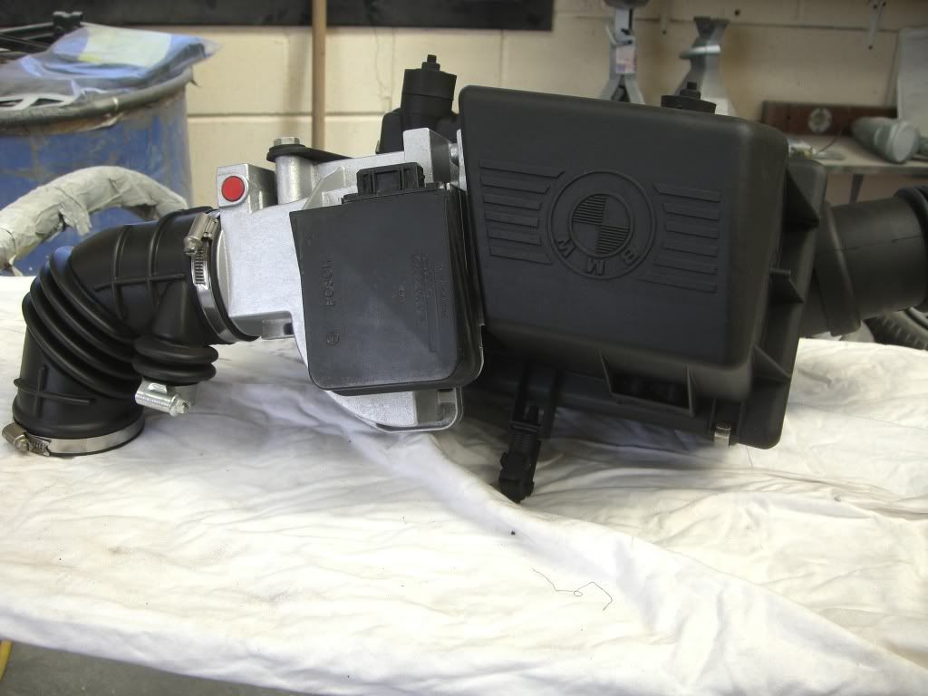

Quick update of todays progress

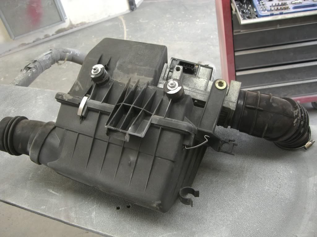

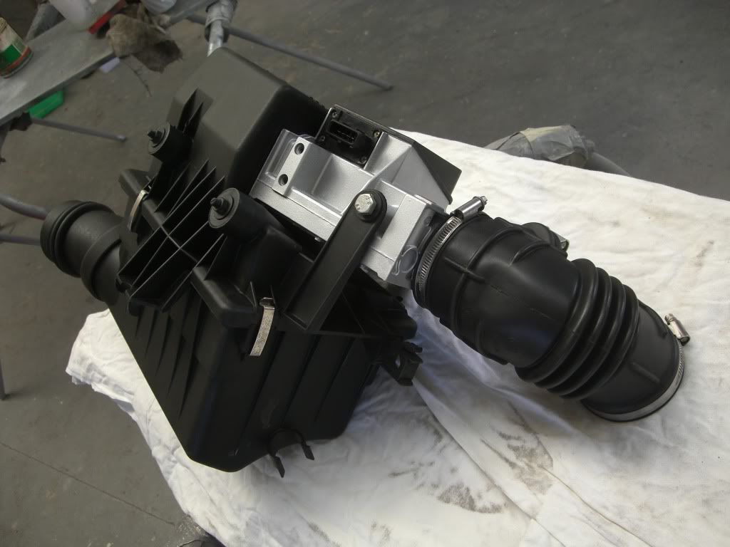

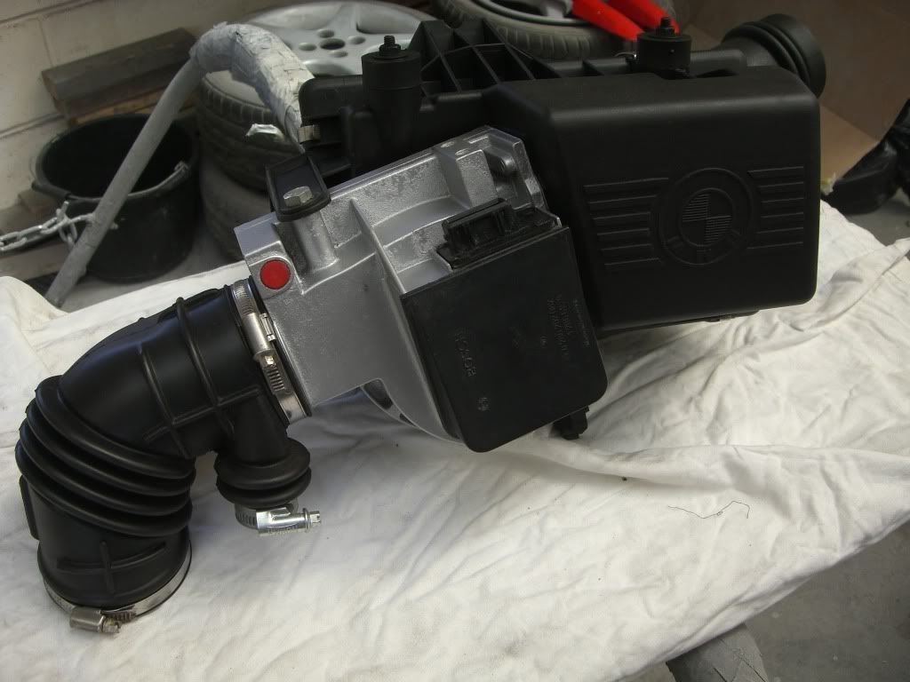

Airbox and other bits before and after.
Got loads more done to the rest of the engine bay today so i'll get some more pix up of it when its all done.

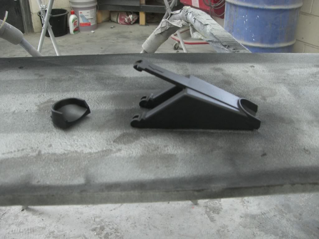

Post Wed Jun 01, 2011 7:41 pm
mrjonchandler wrote:How do you get the plastic parts looking so good?
Where are you based, the level of work looks amazing, nice one.
Jon
I scotchbrite them with petrol to get all the crap off them then give them a light haze coat of matt black aerosol.
I'm based in lochgelly fife just outside edinburgh.
Thanks for the comments mate :)
What is scotchbrite? The airbox and metal parts come up like new! Any particular brand of aerosol?
Would be keen to do this to my engine.
Jon
Jon
Its like a brilo pad mate, you can pick them up at your local halfords in the paint and car bodywork section. Im just using halfords own brand matt black its great stuff but the key to success is light haze coats, put it on to thick and it'll just flake off.
Yeah, go for it! Its time consuming but so worth it my engine bays nearly done now so i'll get some new pics up of it tomorrow.
mrjonchandler
Posts: 832
Joined: Sun Sep 06, 2009 11:00 pm
Location: Warks
Post Wed Jun 01, 2011 10:41 pm
toole325i wrote: I scotchbrite them with petrol to get all the crap off them then give them a light haze coat of matt black aerosol.
Jon
Brilliant, will check it out. Thanks for the advice.
Jon
toole325i
Posts: 110
Joined: Sun Mar 23, 2008 11:00 pm
Post Wed Jun 01, 2011 10:48 pm
toole325i wrote:
mrjonchandler wrote: What is scotchbrite? The airbox and metal parts come up like new! Any particular brand of aerosol?
Jon
Jon
Your welcome mate.
